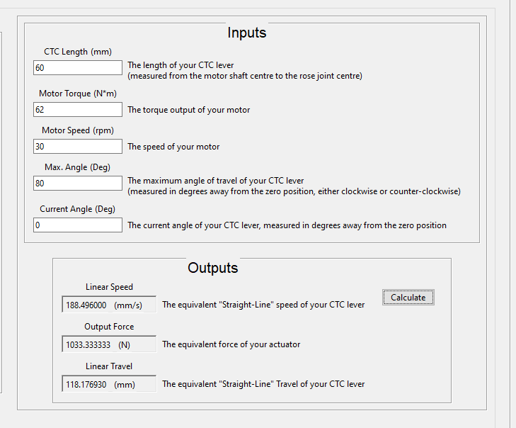

    I suspect a CTC of around 40-60mm is likely more in the ballpark, depending on rig design.
    Effect use of torque with a levers drops off rapidly after about 38-40 degrees up and down, so 80 degrees max.
    To move 100kg at 0.7 m/s needs 70 N. It takes 9.8N per kg to counteract gravity. Keep in mind there is significant mechanical loss in things like the gearbox, depending on the ratio you may want to allow between 10% to 50% loss for worm gears and the greater the gear ratio the higher the % loss is: http://www.meadinfo.org/2008/11/gear-efficiency-spur-helical-bevel-worm.html

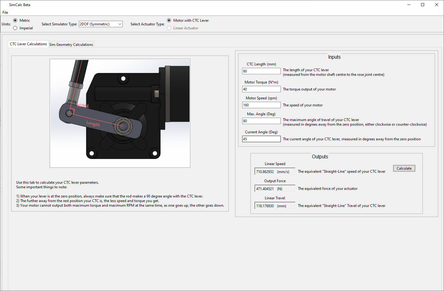

    thanks boss. I dont understand very good the last parameter "Current angle"
    Is the angle of the ctc respect of the floor?? I try that poibilities. It is ok with this parameter??
    21,724
    152,057Coins
    +11,064 / 56 / -2
    Maximum lever efficiency, in both directions, is when the lever starts at 90 degrees to the rod when the rig is level. So design plays a major role.
    If the motor is directly under the seat, like in a compact design, then the lever would parallel with the floor, with the rod 90 degrees pushing the base of the seat.
    But if it is a shoulder mount design, with the motors well behind the seat, the start position of the levers would be an angle so as to position the levers at 90 degrees to the rods when the seat is level, as the rods are normally on a 20-30 degree angle to the seat.
    So the 'Current Level' would be 0 degrees in a compact design and perhaps 30 degrees in a shoulder mount design.

    CTC- 60 mm
    Engine torque: 62 Nm
    Motor speed: 30 rpm
    Maximum angle: 80º
    current angle- 0º
    Results:
    SPEED: 188.4 mm / s
    Output force: 1033.3 N
    Linear travel: 118.17 mm
    CTC- 40 mm

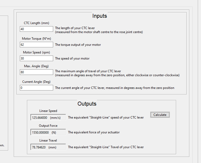

    Motor speed: 30 rpm
    Maximum angle: 80º
    current angle- 0º
    Results:
    SPEED: 125.66 mm / s
    Output force: 1550 N
    Linear travel: 78.78 mm

    That is more like it, and keep in mind that in a compact design the torque is more important than the linear speed, as the perception of the latter is multiplied by the height of the seat back.
    In a compact design you still should try to squeeze ever design mm distance in the length between the pivot ant where the rod mounts to the lever, this is my compact rig as an example: https://www.xsimulator.net/community/threads/dx-compact-simulator.5866/

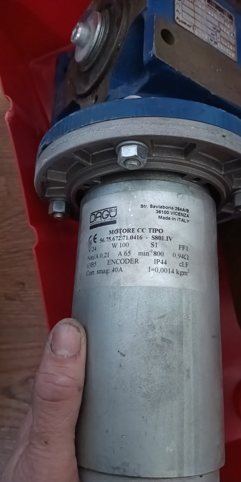

    I have good news for me. check the motors today with a good power supply and the motors has 45 rpm at 62N.
    Iamtinking in to buy this motor driver Sabertooth 2x60 https://www.generationrobots.com/en/402809-sabertooth-2x60-motor-driver.html It´s a good option??

    Sabertooth 2x60 on way. I have a power suply but I dont have the specifications. But the power suplly was working with two motors same of the pictures. Ok, the power suply has two diferent outputs, one for motor, one for othher motor. I am sure they are diferents outputs. Can the power supply works with the Sabertooth 2x60? I hope you can understand, is dificult for the language :D

    Today checking the motors, they works at 2,2 amp with nothing, when I brake with the hand the motor, I had, 7,5 amp. Maybe when works with other the structure and me, I have 20 amps max.
