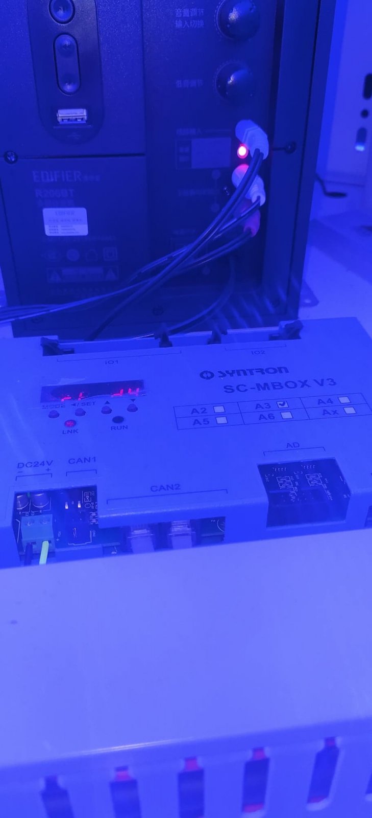

    after buying my stewart hexapod sold with its software, I find myself totally restricted in the configuration and I would therefore like to finally overcome this thanks to simtools, flypt (according to the first research I did ), after several unsuccessful attempts I turn to the community to understand where the problem comes from (if there is one) and understand a little better where I stand. First of all I would like to know if it is possible to interface an sc-mbox v3
    (http://www.syn-tron.com/index.php?m=content&c=index&a=show&catid=181&id=47&mid=85) with simtools or flypt if below
    It works with the ethernet port, I tried to understand the communication by reading the documentation (in Chinese, even using the translation not obvious to me...)
    and using wireshark for packet reading.
    I admit to being blocked when I have to enter information on simtools or flypt software.
    Can anyone help me out, or give me a clue?
    Thank you everyone

    Unfortunately the Syntron MDBOX ethernet interface protocol is unknown. I made controller in the past to interface to these servos via the analog input 0-10v but it only had 4096 positions, the max available with the specialized DAC chips you could get at the time. It was discontinued in 2018...
    My suggestion, look on Aliexpress for AASD-15A servo drive with 80ST-M02430 servomotor kits to replace the MDBOX. The AASD-15A servos can be interfaced with the AMC-AASD15A motion controller plug and play with resolution 65535 positions scalled to the entire available stroke of the actuator...

    Noorbeast servomotors are HS3035a from Syntron.
    The card is an sc-mbox v3 which communicates via ethernet udp with the PC.
    Currently the Dirt4, Projectcars1 and 2 games are working because configured by a technician from whom I have no news...

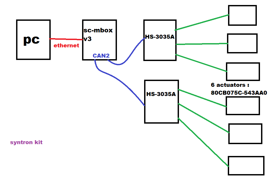

    hello. Thank you for your quick response and the time you spend with me. I'm sorry for the late reply, I have a lot of work. I made you a diagram representing my installation because it is difficult to take pictures. all the elements are from the syntron brand, the links between pc and sc-mbox as well as between the sc-mbox and the HS-3035A are RJ45. finally it seems that the connections between the HS-3035A and the actuators are serial connections.

    So the drives you have are the MDBOX 3in1 then, that have either CAN or Analog voltage positioning inputs only... sorry, there was a older generation controller for them (AMC-MDBOX) but is now impossible to build because of chip shortage...
    I was hoping you had the individual HS drives that have Pulse/DIR digital inputs, and would be easy to interface to the AMC-AASD15A controller, like on the video:

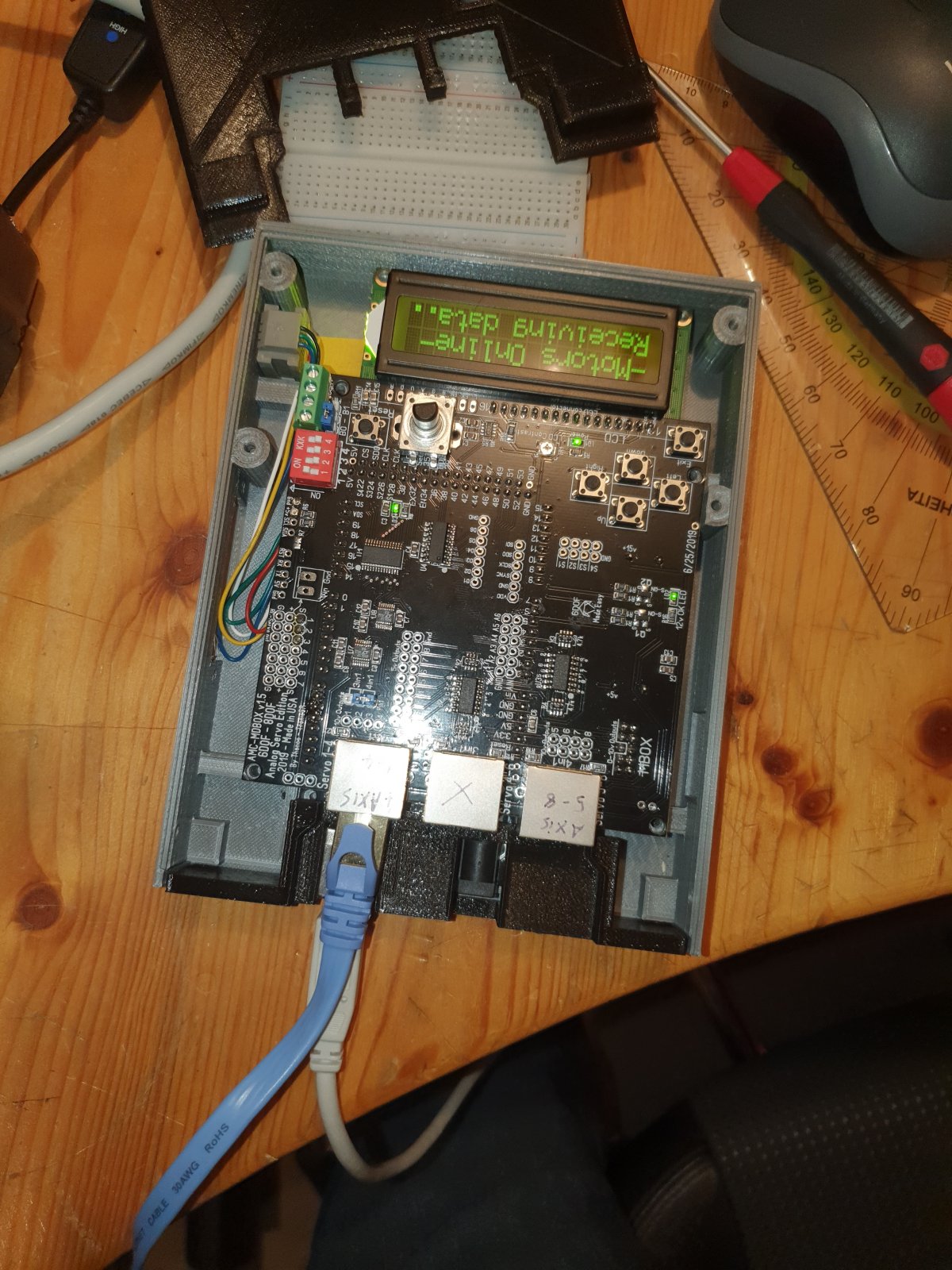

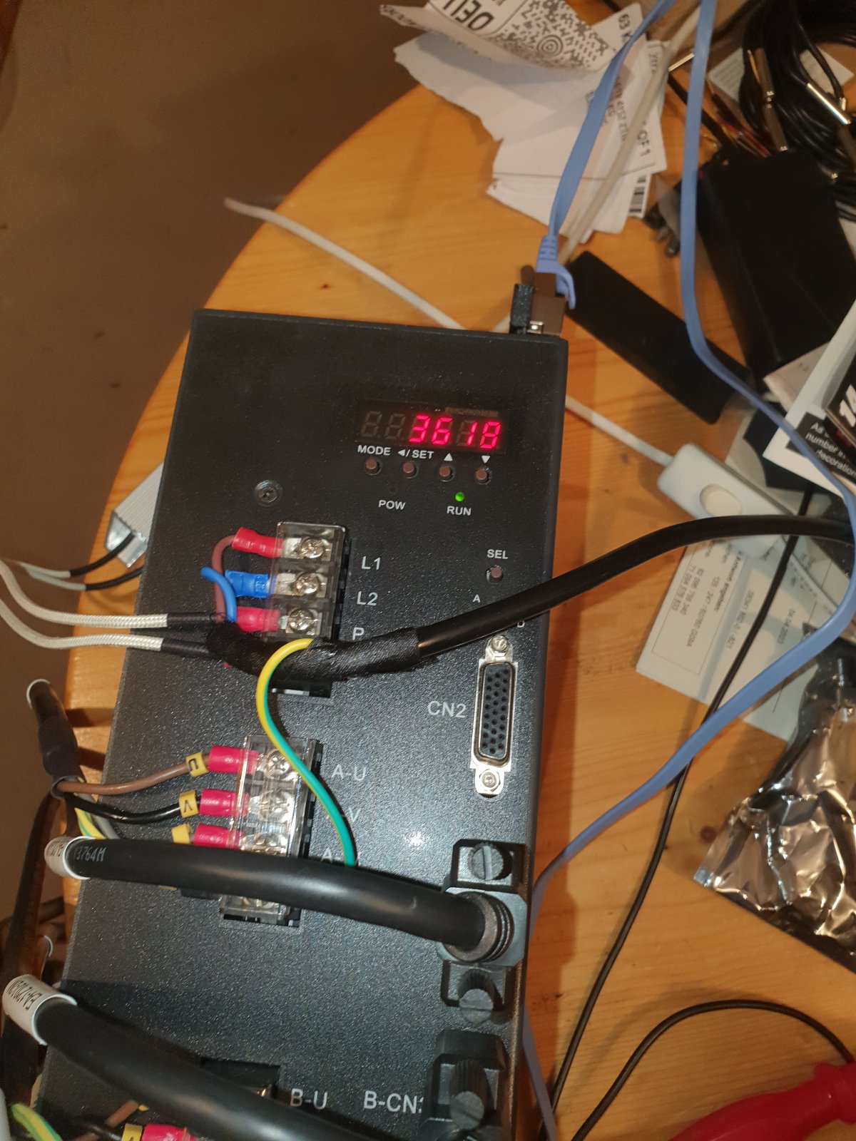

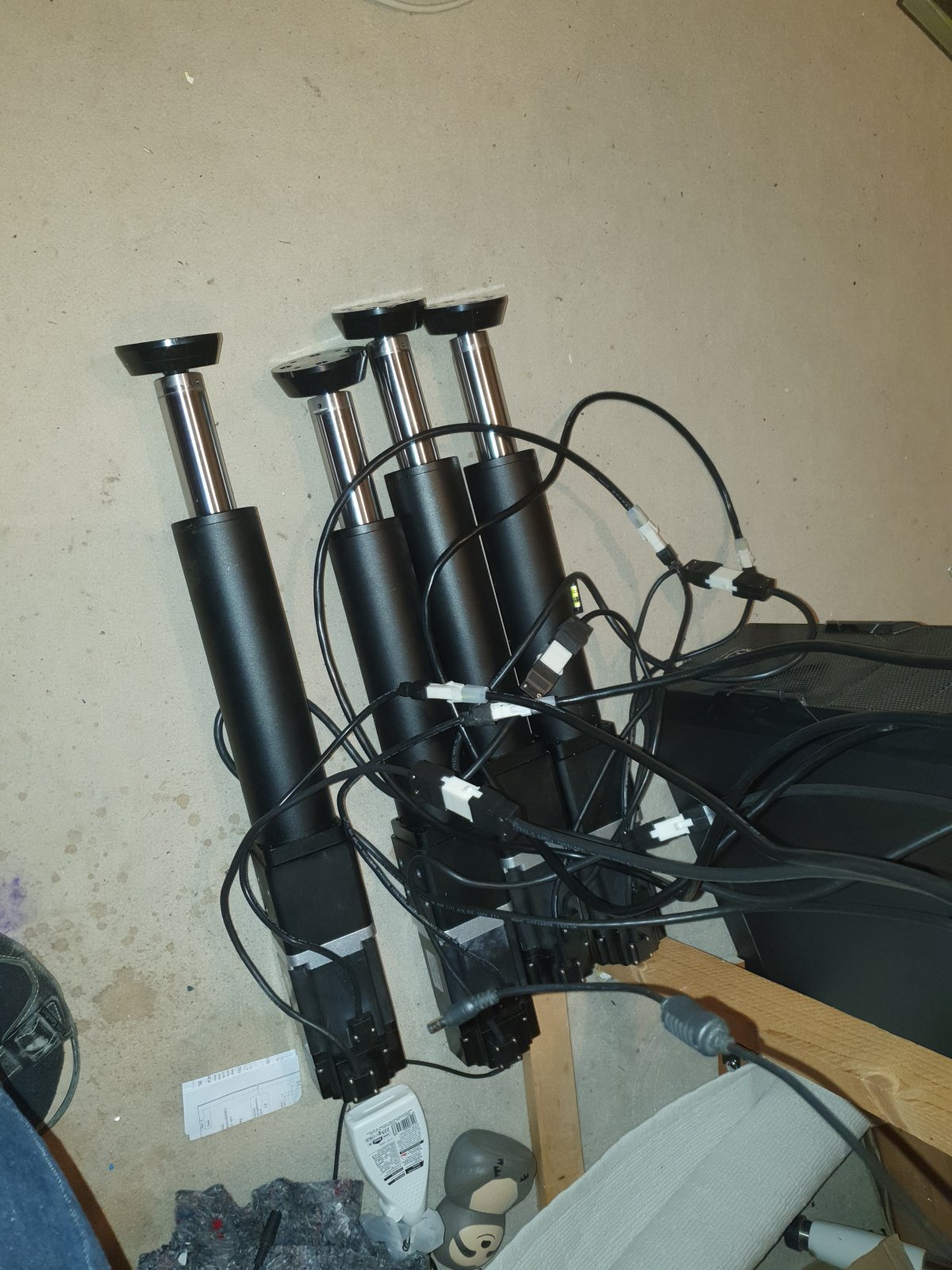

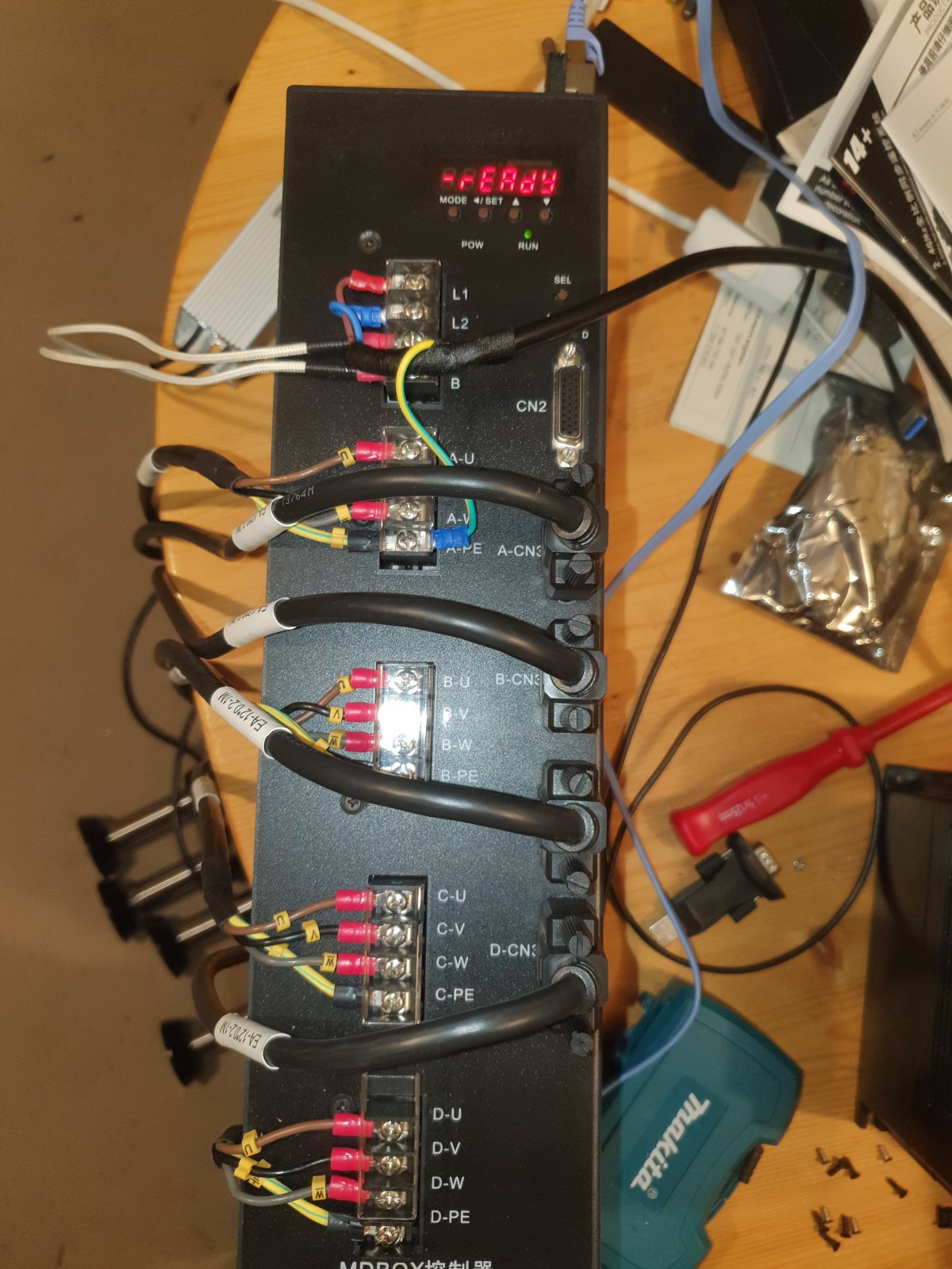

    Hey Together, I can't get my MDBOX-NV4025ED up to running.
    I also have an AMC-MDBox v1.5 Controller.
    When Powering up, the MDBox is calibrating the Actors and going back.
    But the Analog Input is not being played :( The Status is "-ready" :(
    Have setup sim tools and measured the adc output, it is acting fine.
    Do I miss any steps to start the dbox for listening the analog inputs?
    I also checked the analog input read values of dn56, dn57, dn58 and dn59 ... they are updated very well to the movements in sim tools testing mode.
    Thank you very much

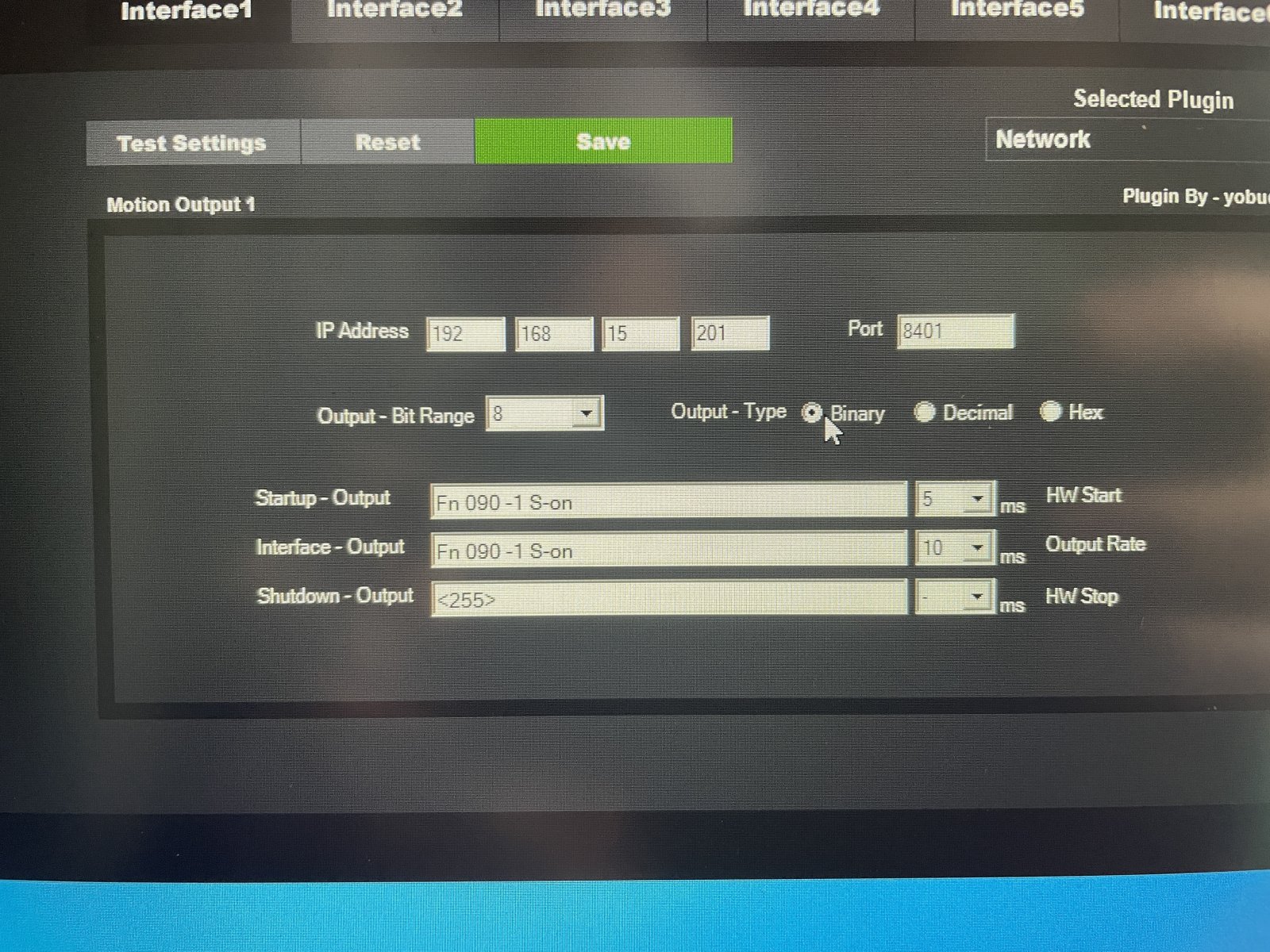

    I finaly got it working. The axis settings (fn009 has to be set negative -4 .... )
  19. pmneo
    pmneo New Member
    May 16, 2023
    11
    76Coins
    AC motor, 4DOF
    Fn 008= 3721 Password (Power cycle to take effect)
    #Fn 009= -1 Enable only 1 Servo Motor
    #Fn 009= -2 Enable only 2 Servo Motors
    #Fn 009= -3 Enable only 3 Servo Motors
    Fn 009= -4 Enable all 4 Servo Motors
    Fn 0FF= 10 in ms, Filtering Analogue
    Fn 100= 10 in ms, Sampling
    Fn OC2=10 in mm, Lead Screw Calc (how much the rod advances for a full motor rotation)
    Fn 00D=5 in mm, Initial position after calibration
    Change S-ON (servo ON) input behavior
    Fn 090 -1 S-on enable
    Fn 091 1 stop behavior
    Fn 09D 1 Inversion of S-on
    With this settings, the mdbox now works like expected.
