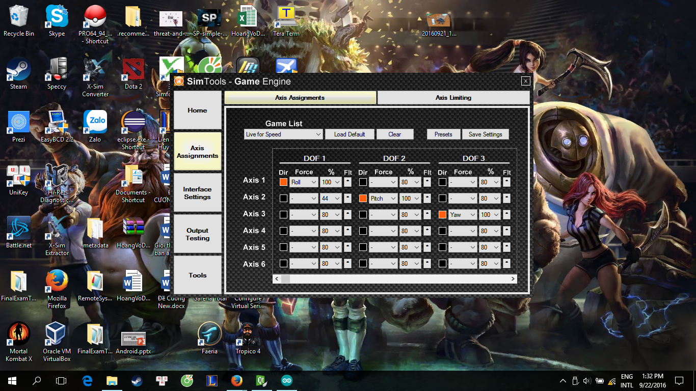

    I already have the way to control 6dof mini with Roll, Pitch, Yaw, X, Y, Z by using Controller(QT).
    Now all i want to do is get that data from the game.
    Then i push it into Controller (QT).
    With my configure about 6dof mini (Servo arm length, Angle at which the servo arm lies(Degrees), Platform Radius....), i control servo's degree depend on data that i just get.

    OK, thank for your help. I already solve my problem, but i still wondering about "Axis Assignments" in Simtools. I finding a document to use that. But look like it not easy to understand ( like how to configure Dir , Force, % , Flt, ... ), so can you help me with that.

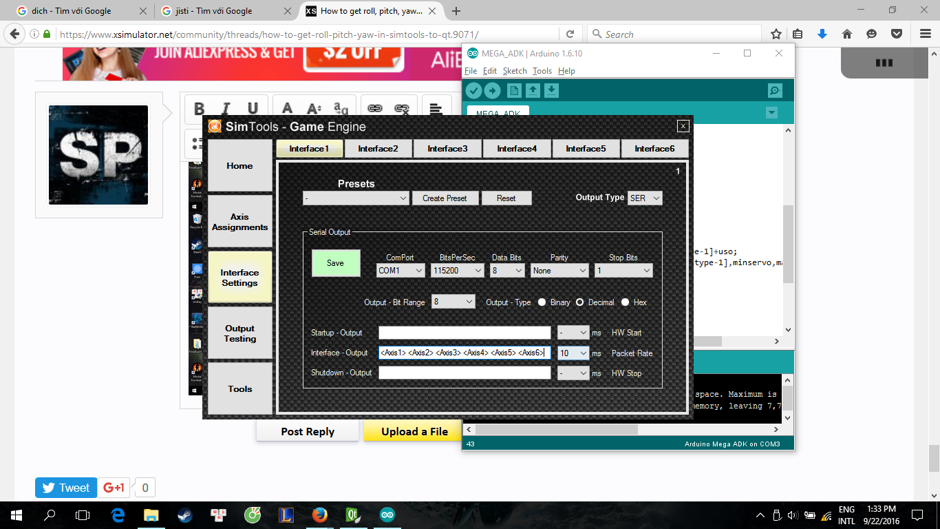

    I also have the question,so it is no way to get the original roration data form simtools interface?

    My motion seat is control by roll, pitch, yaw,so i want to get the data ,not asix data,tks

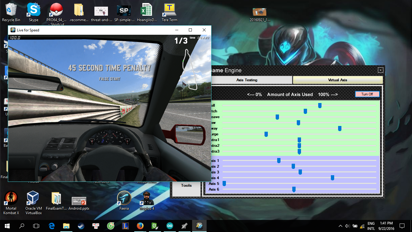

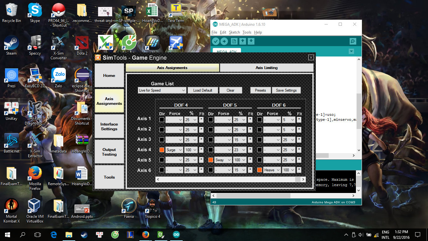

    I put my simtools setting this way.
    so basically the axis 1 = roll, axis 2 = pitch, axis 3 = yaw ... and so on. And then now all you need to do is take those data to your motion seat control. (~^w^)~
    As you see axis1 symmetry with roll.

    You are It's Very Kind of You ,Thanks!!!:)
    I had try it ,it work.
    I found a bug,if i select "Binary" or "Hex" format ,I only get half data, (-100% -- 0% always get "0"),"Decimal" mode is OK.
