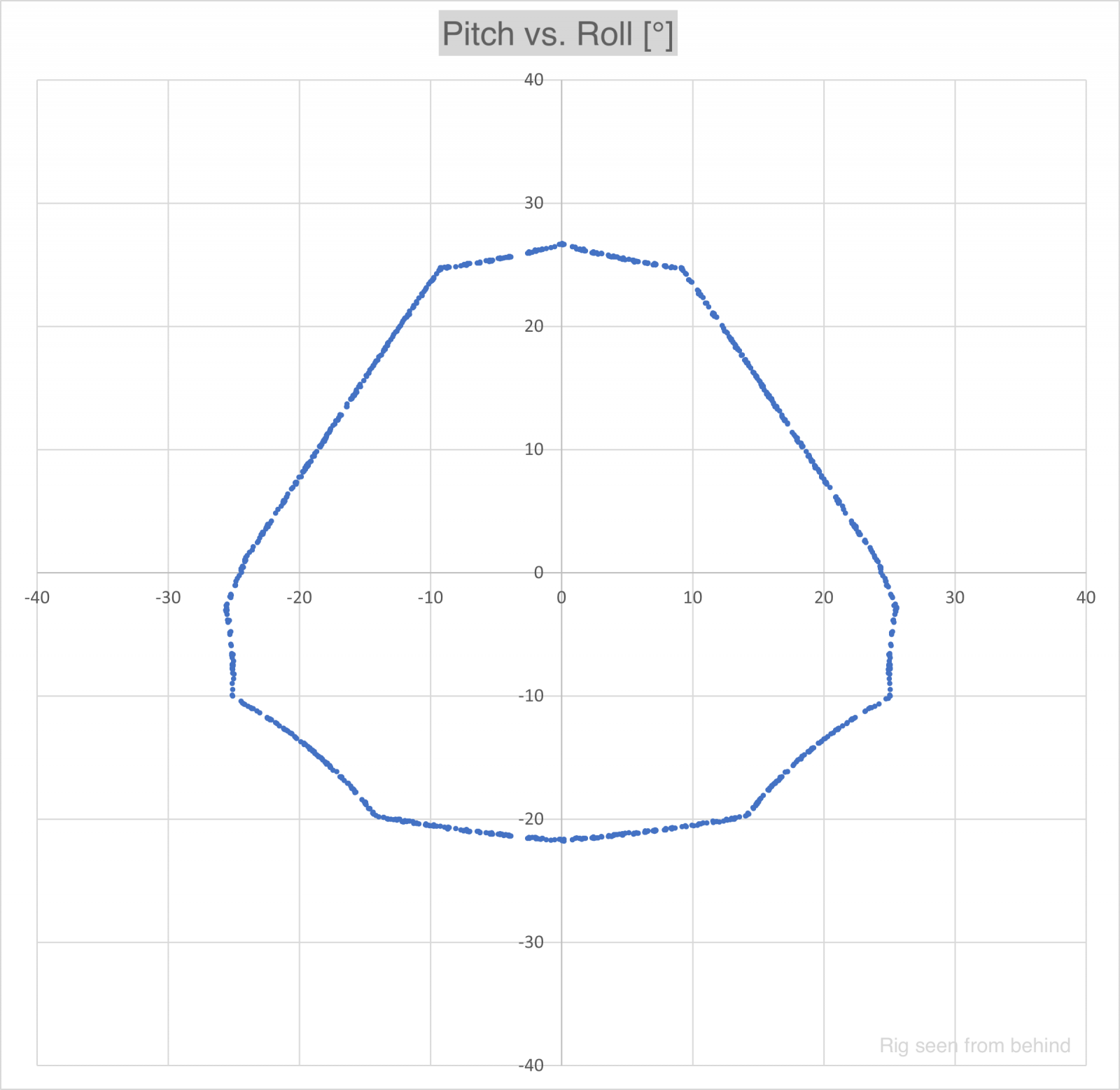

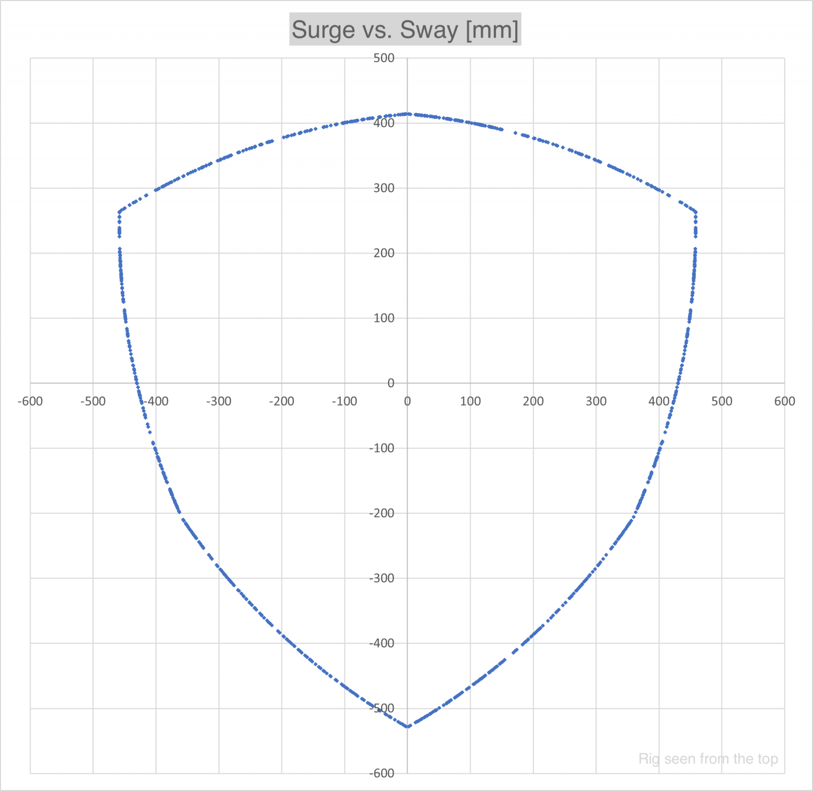

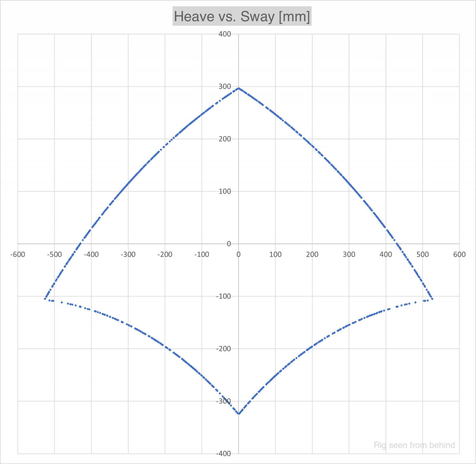

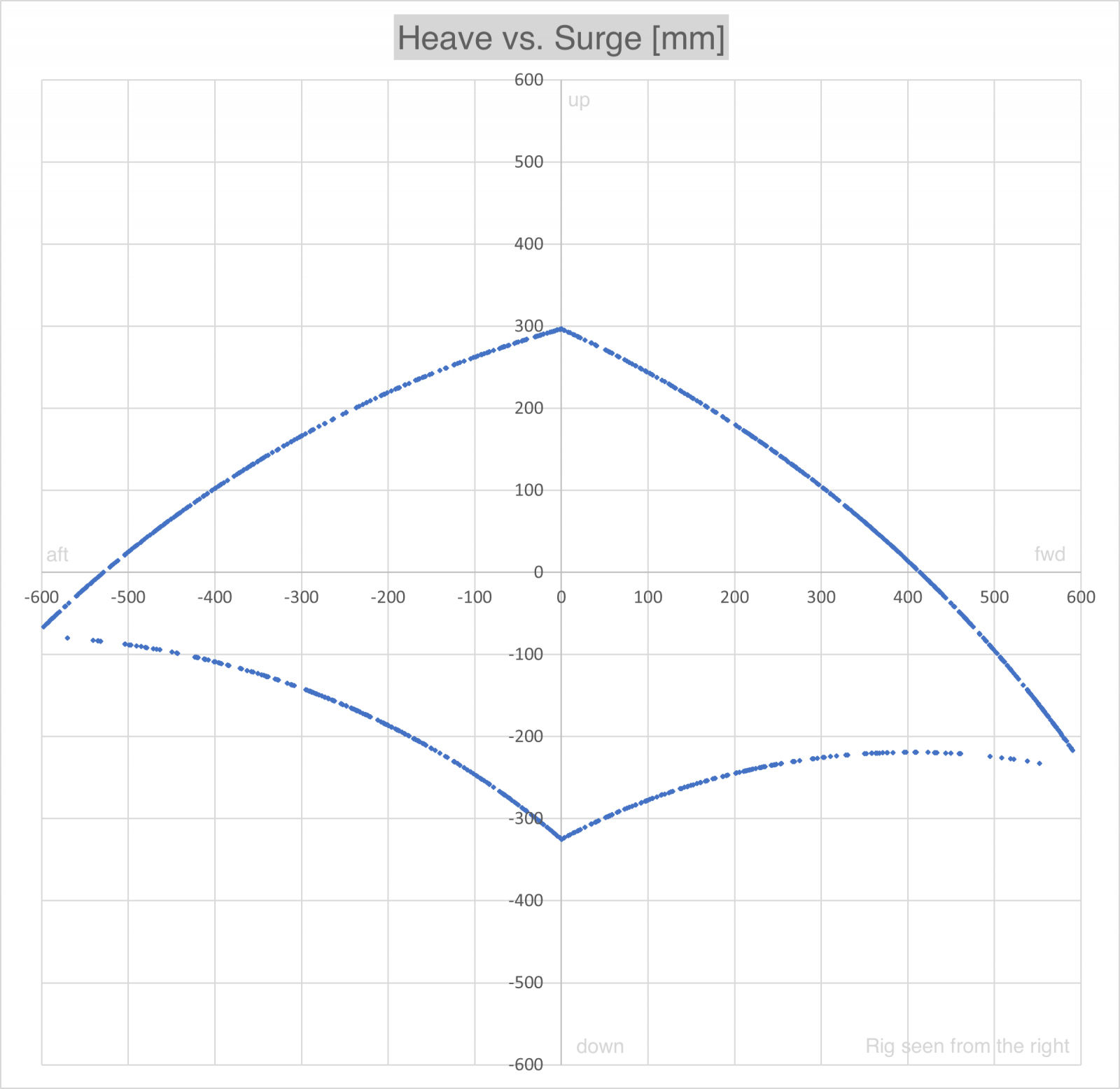

    Hello
    I want to know how to figure out the maximum movement my platform can do, to determine how my upper platform needs to be build, so that they don't bump into my actuators.

    I wrote a little program that calculates the operational envelope of 6DOF platforms with linear actuators. However, it does not take into account collisions of the upper frame with the actuators, but only those points where the actuators themselves reach their max/min limits.
    Here's what these plots look like for a typpical rig:
    Heave vs. Surge.png Heave vs. Sway.png Pitch vs. Roll.png Surge vs. Sway.png
    I am working on a module that checks the clearance between the upper platform and the actuators to stop the rig from slamming into them, but the sticking point here is that the user has to provide a 3D model for the collision check. If that model is off, all envelope information is basically useless :-/
    I tried to parametrise the shape of the upper platform, but peoples rigs are diverse and do not follow a clear design guide. Might be a dead end...
    Cheers, Dirty :)
