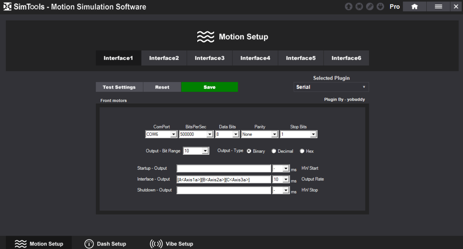

    i can make a copy of smc3 and add the correct ports to each but if i double click on one when the other is running it wont run 2 simultaneously?
    is this normal?
    if i make a copy adding the correct port so i can set up the motors does it just run both n the background when needed by simtools?
  5. Rico Mortis
    Rico Mortis New Member Gold Contributor
    Jul 7, 2022
    29
    84Coins
    +8 / 0 / -0
    i have 2 copies of smc3 on desktop one for com 4 and one for com 6.
    interface 1 on com 6 works fine in interface set up testing and in plugin.
    interface 2 on com 4 which is set up identically in interface settings bar com port number wont work at all..
    motors are working fine in smc3 set up.
    i have allowed the firewall access as requested when firing up smc3 for the 1st time..
  6. Rico Mortis
    Jul 7, 2022
    29
    84Coins
    +8 / 0 / -0
    if im reading it correctly should i be using the same smc3 but saving under a different file name when i set up the ini port number
  7. Rico Mortis
    Jul 7, 2022
    29
    84Coins
    +8 / 0 / -0

    I believe you are correct and i had already done this at the start and all the motors worked as they should while in smc3.
    its not my first build either, this is my 4th but this one is obviously 4 dof.
    i set up the new interface correctly as its the same as the first assigning the 3rd and 4th axis.
    interface 1 worked fine in yest settings in simtools, interface 2 didnt work at all.
    i have stripped all the wiring back to bare bones now and going to go back to 3dof on one arduino so i atleast have a functioning rig and add 4th axis on a single arduino.
    hopefully i have some success..

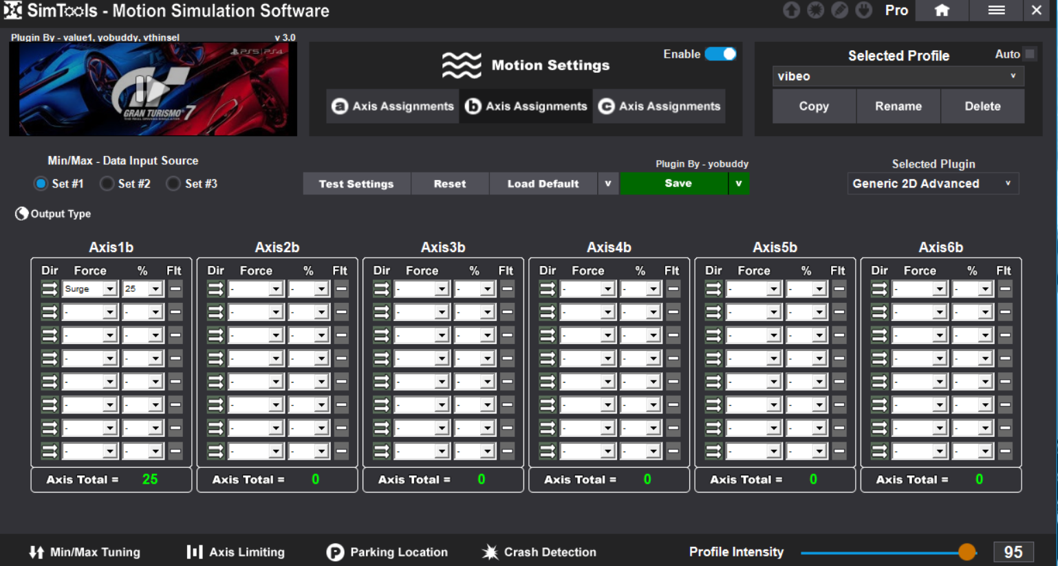

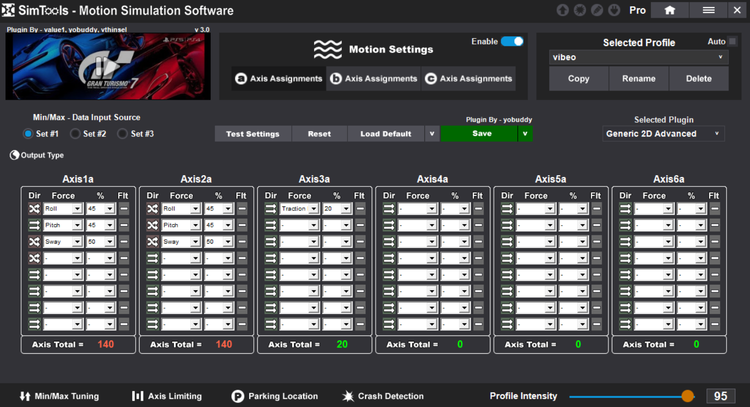

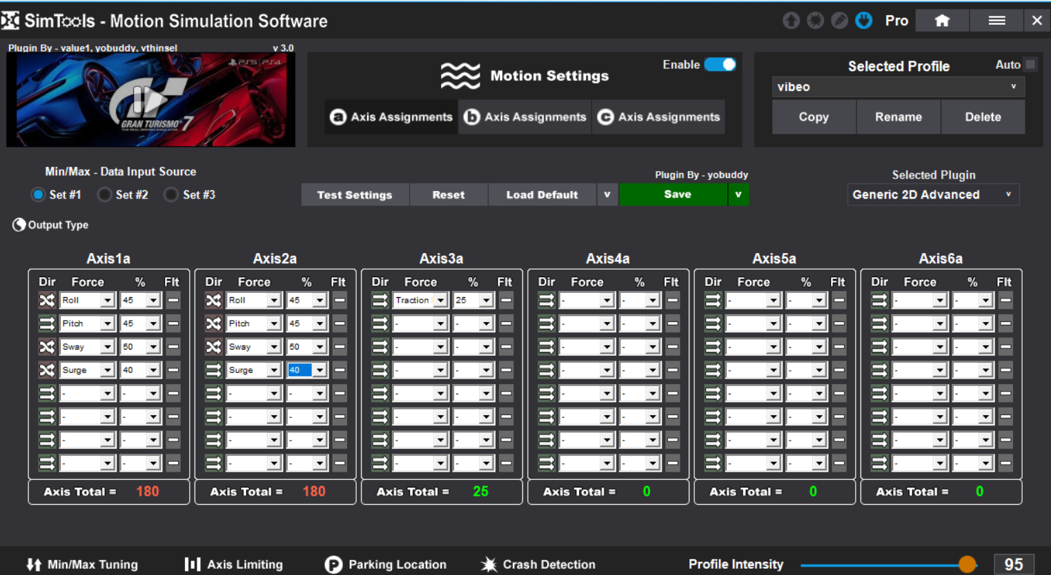

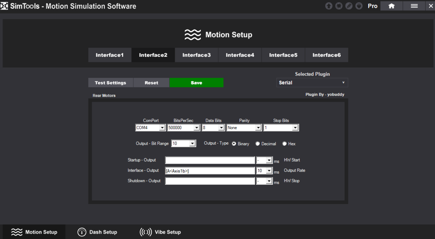

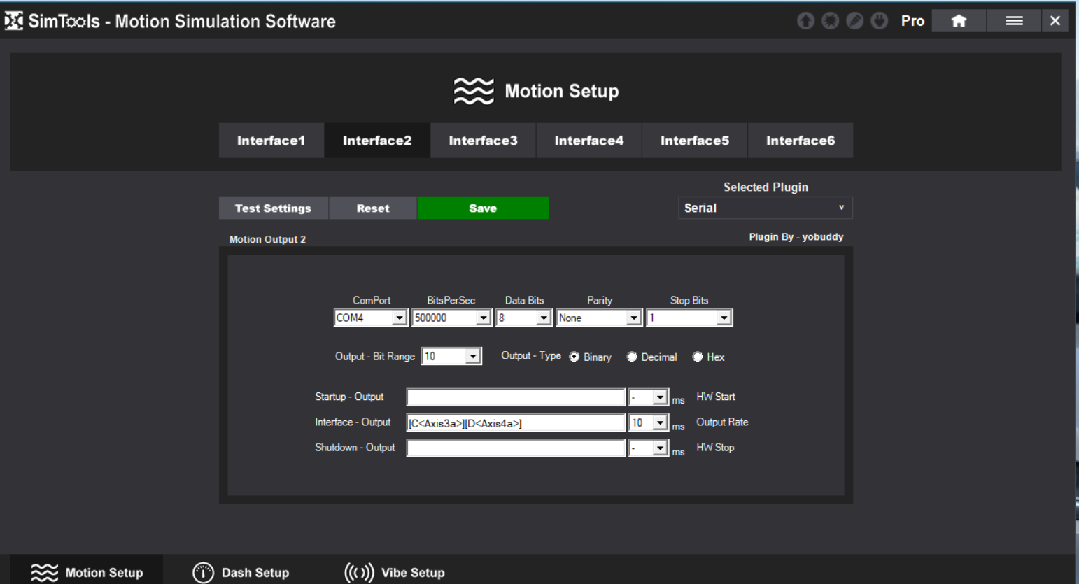

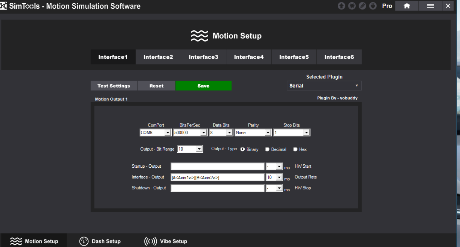

    HOLY CRAP FIXED IT !!!!!!
    I decided to revert back to 3 dof as mentioned and just run the one motor on the one Arduino.
    rewired the system back up with 3 motors on the board and got that working again.
    The 2nd board i got working in smc3, all good but still nothing from Simtools.
    I deleted all interfaces and set one up for the sole motor board set axis as Axis1a and it worked, I then set axis as Axis4a and got nothing. tried 2a 3a still nothing.
    it appears that the system senses how many motors are connected to the arduino so you cant add Axis motors that aren't there..
    i then set up a new interface using Axis assignments B, put sole motor on AxisB1 Voila it works!!!!
    you can only use Axis A,B and C on an Arduino as there are only 3 outputs.. so set 2 motors on assignments A and 2 on assignments B and you should be good
    In test settings on either A assignments or B you can still test all 4 Dof's from there..

  17. Rico Mortis
    Jul 7, 2022
    29
    84Coins
    +8 / 0 / -0

    @Rico Mortis. This is great news Rico! Thanks for sharing your findings. I am just in the middle of testing all my motors with SMC3 today setting up all their PWM and PID allocations. I hope by the end of the day I will be able to test in Sim Tools. I will read through your experiment again to better understand what you are saying and what you have found. Thanks so much for posting the Sim Tools interface pictures. Very helpful person you are! Hey Rico, I would love to see a picture or a video of your 4DOF. That would be great to check it out.

    just remember Axis assignments A represents one Arduino and B another, C would be a 3rd
    you can only use axis 1 2 and 3 on each as Arduino only has 3 outputs
