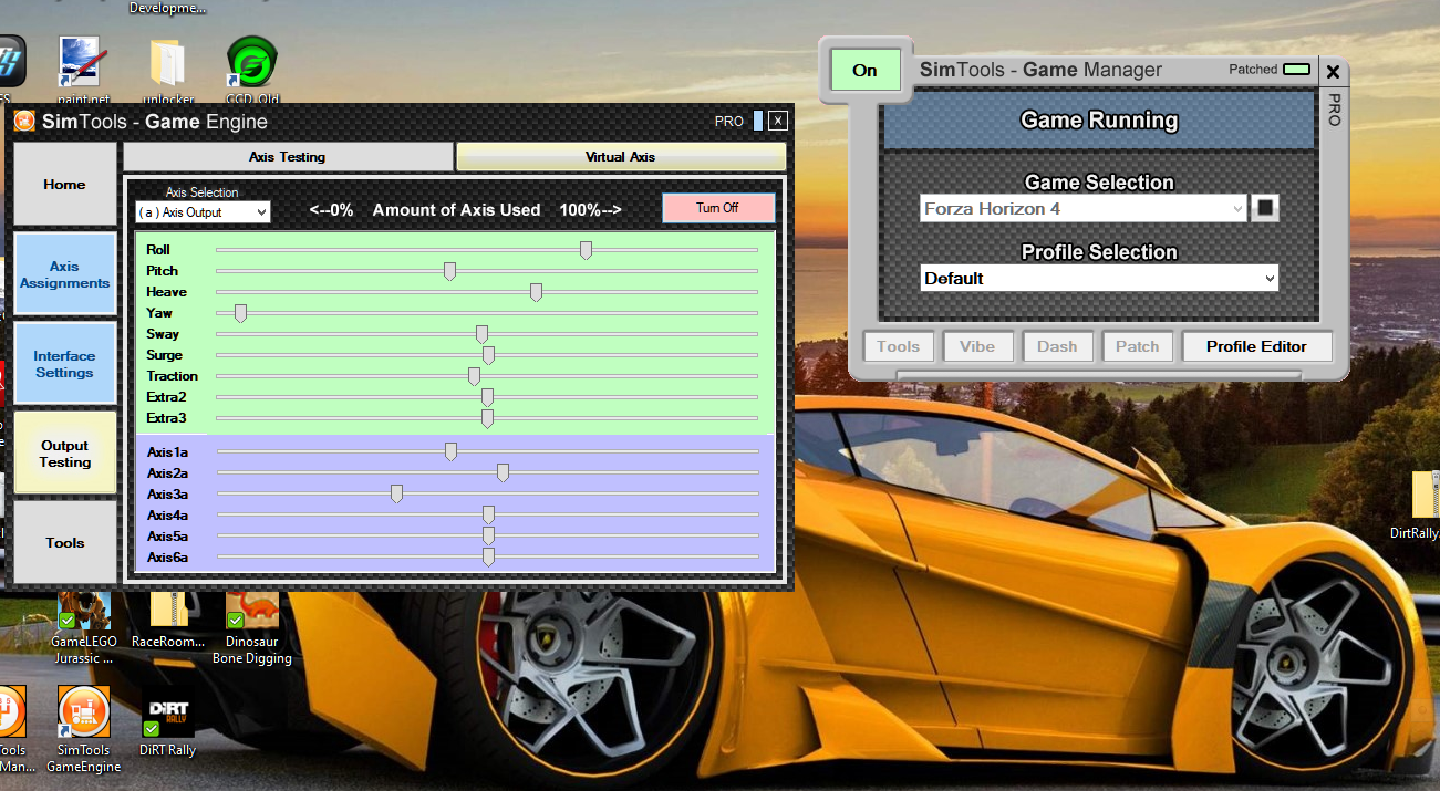

    Now launch the SimTools PluginUpdater, Drag and Drop ForzaHorizon4_GamePlugin.V2.0.0.2.zip
    Launch SimTools, change the IP addresses on both the Game Manager and Game Engine to 192.168.0.101. This is your PC address as per the UDP Sender/Receiver.
    Once you have ensured that FH4 is patched and the Axis etc are correctly set up, when you run FH4 on Xbox, you should see the motions.

    Here is the screen shot of the Forza Horizon 4's motions on the SimTools PC while being played on Xbox One X Console connected via a Crossover cable.
