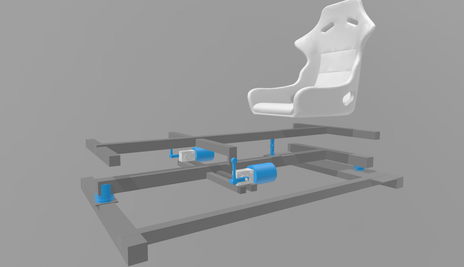

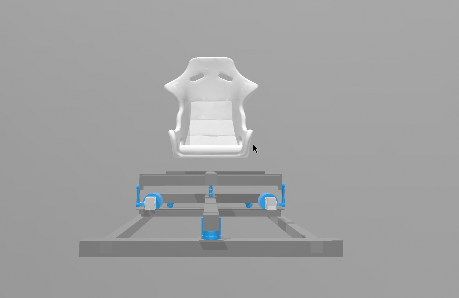

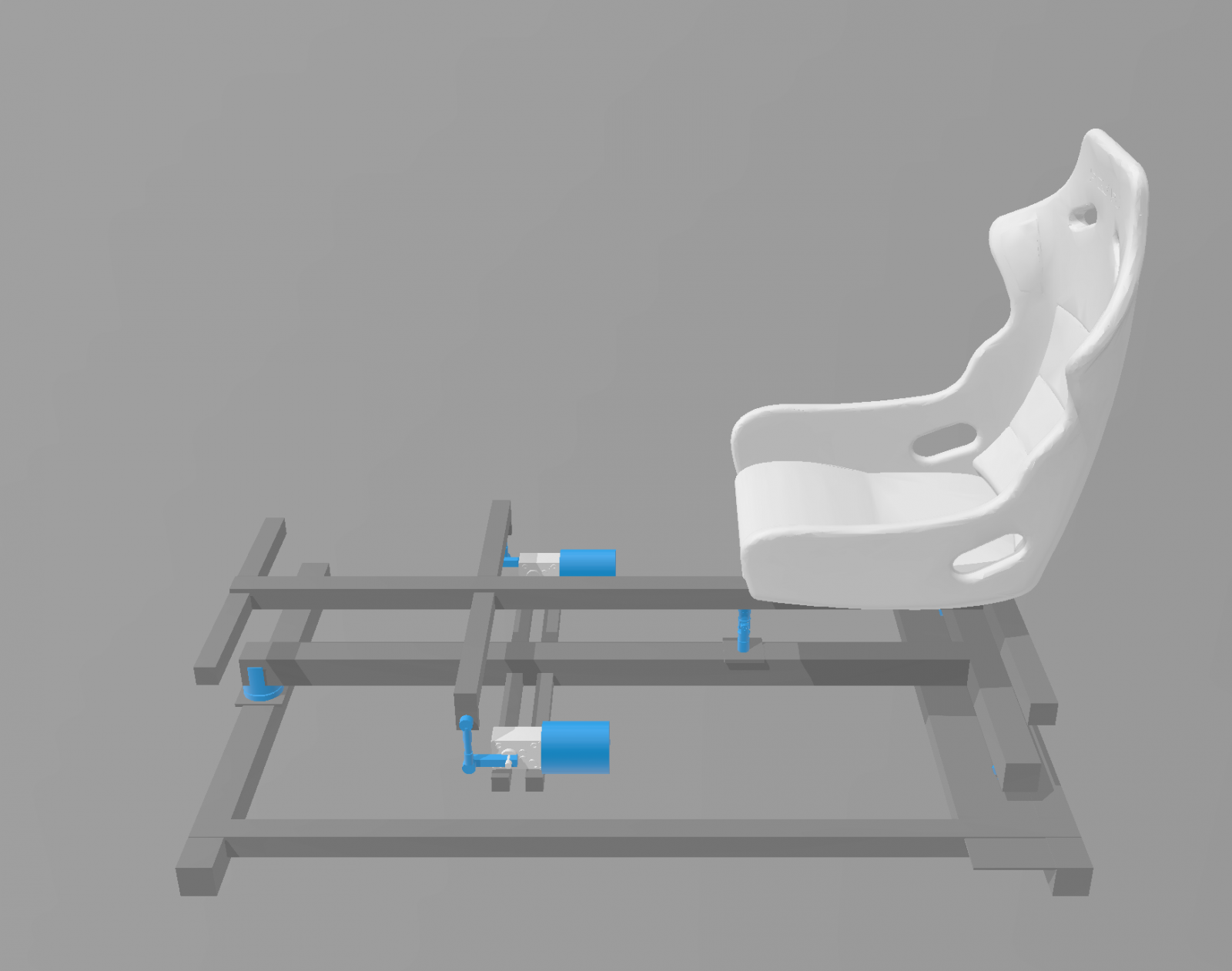

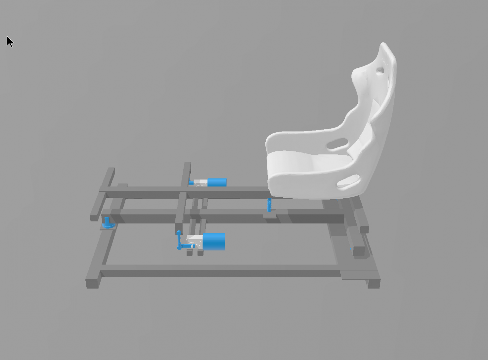

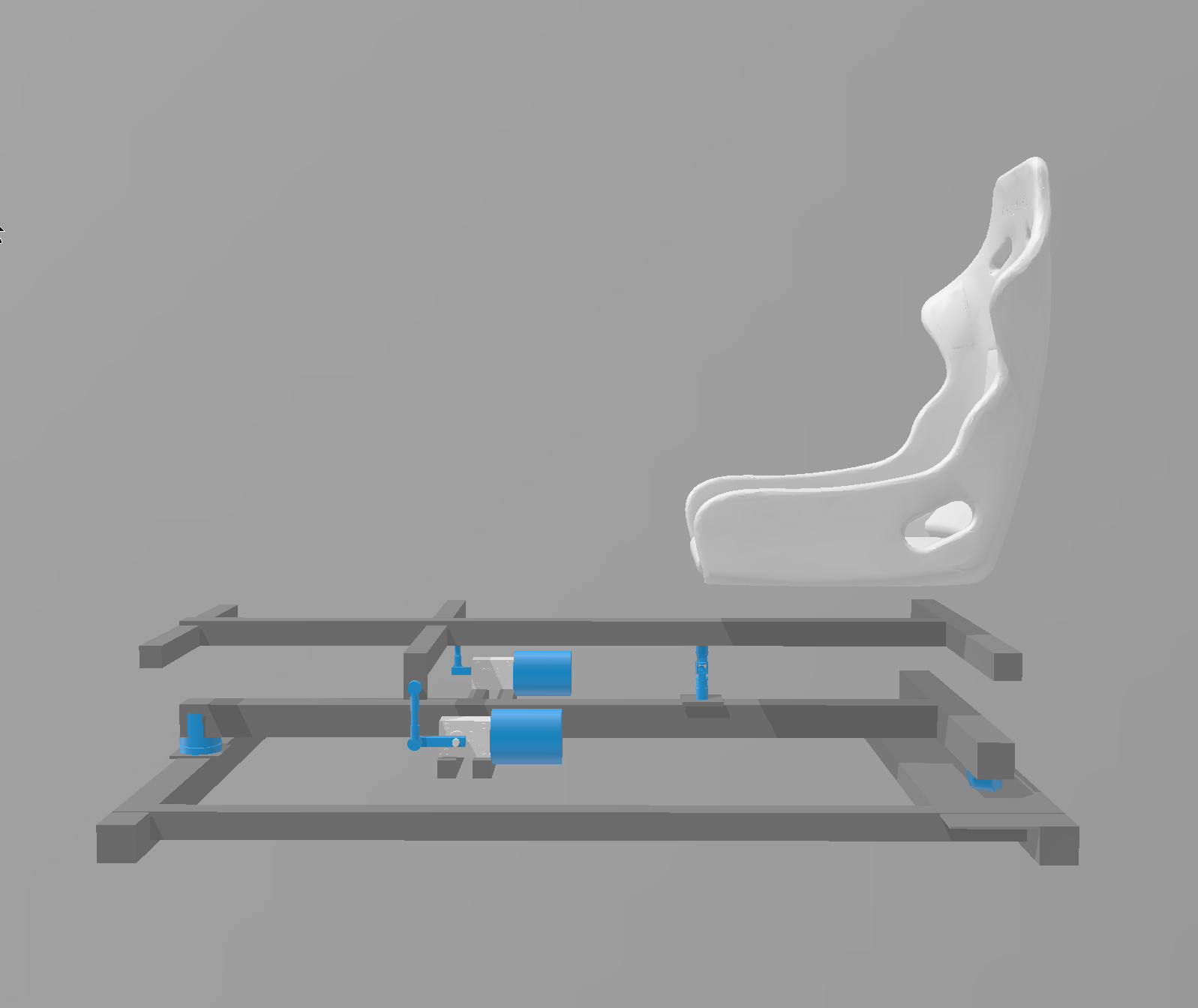

    Good morning,
    I'm tring to build a 3dof dynamic simulator. I've read a lot of conversation but I have some mess in my head so I have some questions to ask to you.
    In the attached images you can see what I have tought for my design (it's a very basic draw but I maked it to give you an image of my idea and I still have to think where put the 3rd motor for the yaw ).
    My main problem is choose the motors. My idea is to put the two motors for pitch and roll in front but, how much power they need?
    On the web I found a lot of gear motor (or worm motor?) but I have no idea how to choose:
    - Torque (NM)
    - Power (Watt)
    - RPM
    - Supply 12V or 24V (maybe 12V is more compatible with a lot of controller boards?)
    I'm trying to spend less money as possible so I don't want make mistakes to choose my actuators.
    Another think is the controller board, arduino is a good choice? With with motor driver shield? Moto Monster?
    If you have a good tutorial that explain the difference between various motor or how to choose them, recommend it to me!
    Thanks in advance for giving me your experience

    Thanks for your reply, I had already seen that tool but my design it's quite different from that one represented inside SimCalc (my version is SimCalcV0.1_BETA), so I'm not able to understand how to choose motor. For example, this can be a good choice? I have some dubts because the price is low. https://www.ebay.com/itm/WG88BD82-3...5U-min-Kran-Seilwinde-Brauanlage/323492413439

    Just try with wiper motors! I have a frame more heavy than yours and works great. All depends where you put the motors...

    ITA Ciao Diegocom, i consigli dei posts precedenti sono ottimi. In linea di massima per una struttura come la tua (in ferro e senza supporto monitor), se ben bilanciata rispetto al fulcro, puoi considerare che la coppia necessaria sull'albero lento del motoriduttore sia di circa 10 Nm con 50 g/1'. Questo significa un motoriduttore di circa 60 W di potenza in c.c. (12 o 24 V, è questione di alimentazione e schede ponte H per il comando dei motori; a 24 V la corrente è una metà che a 12 V).
    A queste condizioni vanno bene i motori tergicristallo di camion o autocarri (24V) con un buon alimentatore da 20 A e batteria 24V (12V+12V in serie) per sopperire ai carichi di picco.
    Questa soluzione potrà darti movimenti veloci ma limitati nell'escursione. O viceversa movimenti meno veloci e più ampi.
    Se vuoi qualcosa di più performante devi andare su motoriduttori da 150 W (12 o 24 V 3000 g/1' C 0,4 Nm) con riduttori rapporto 60 (es. NMRV025) e ingranaggi in metallo.
    In ogni caso ti consiglio di impostare bene la staffa motore e mettere un cuscinetto sull'albero in modo da non caricare il peso in modo radiale sul motoriduttore.
    Spero di esserti stato utile,
    a disposizione
    micma
