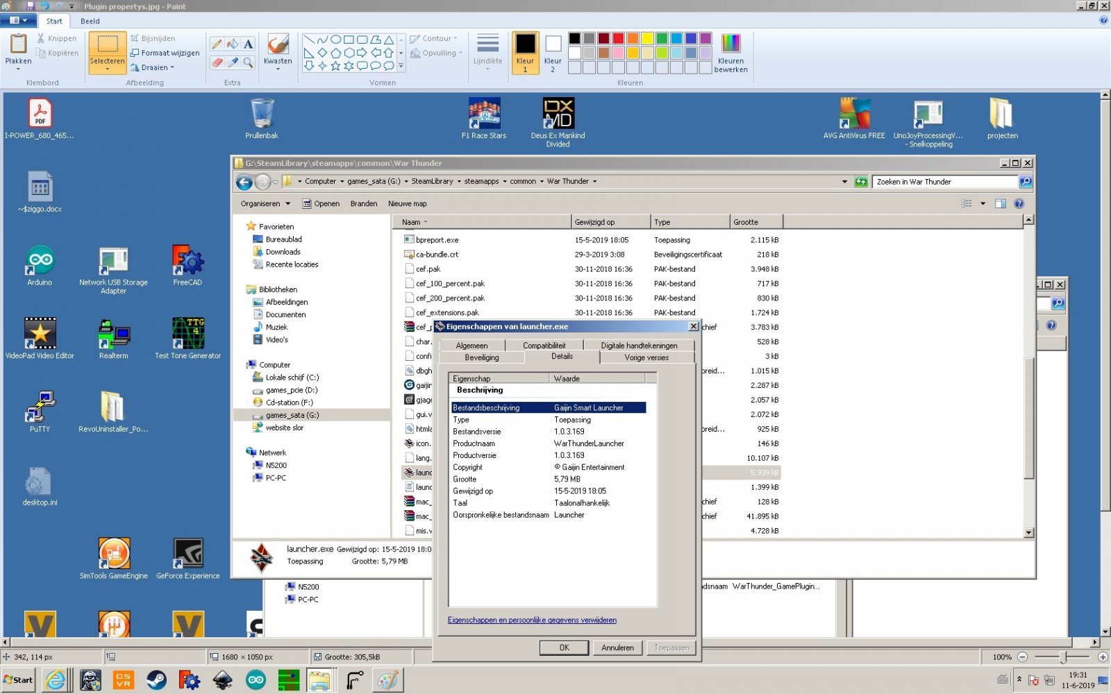

    Are you running the current version of both SimTools and the War Thunder plugin?
    Did you get a confirmation dialog window that WT was correctly patched for motion?

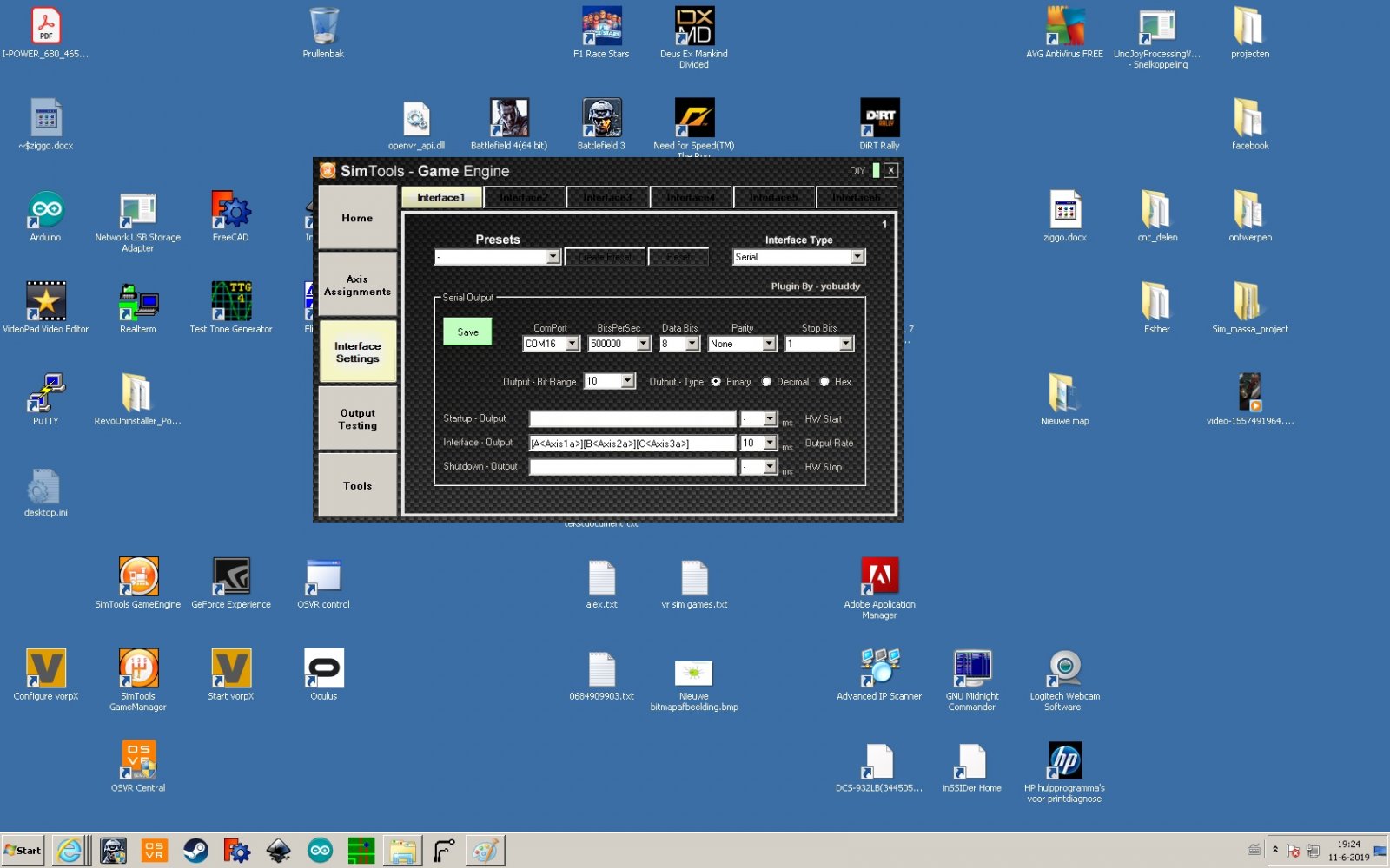

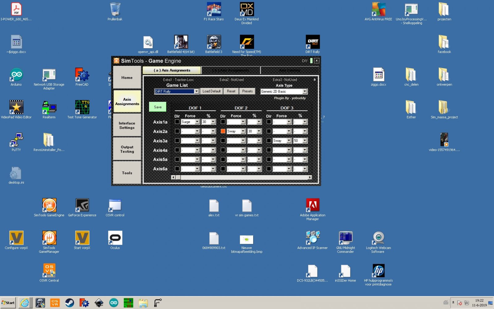

    Screen shots of my simtool settings. First disabled simtools. I uploaded the file to plugin installer. Installation success full like all plugins.

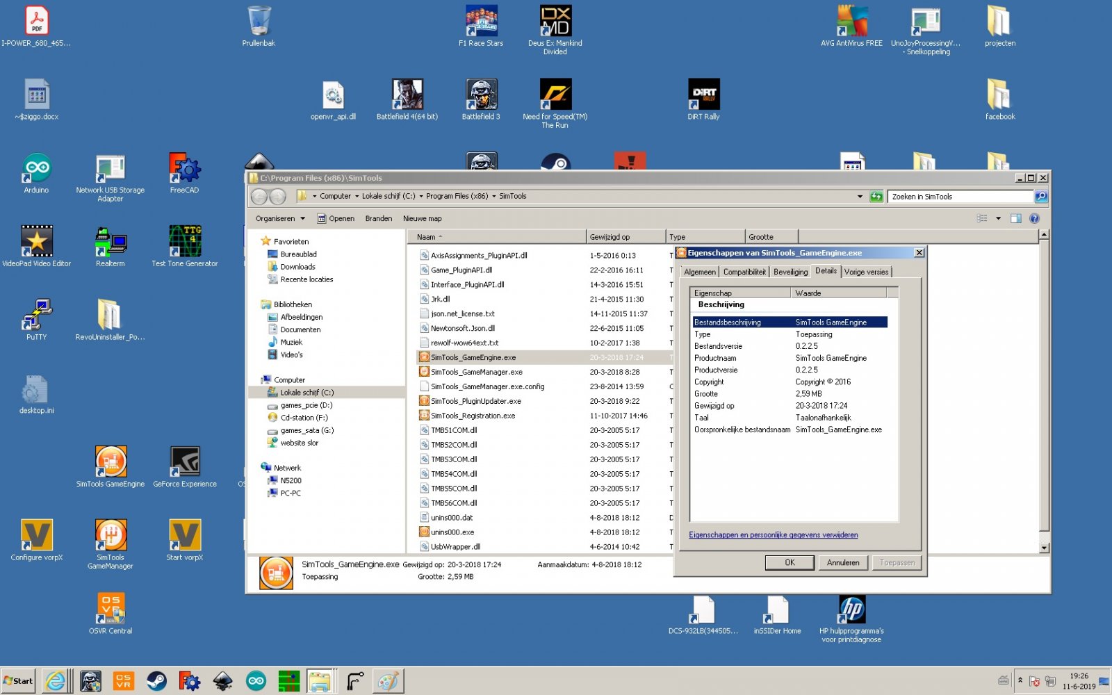

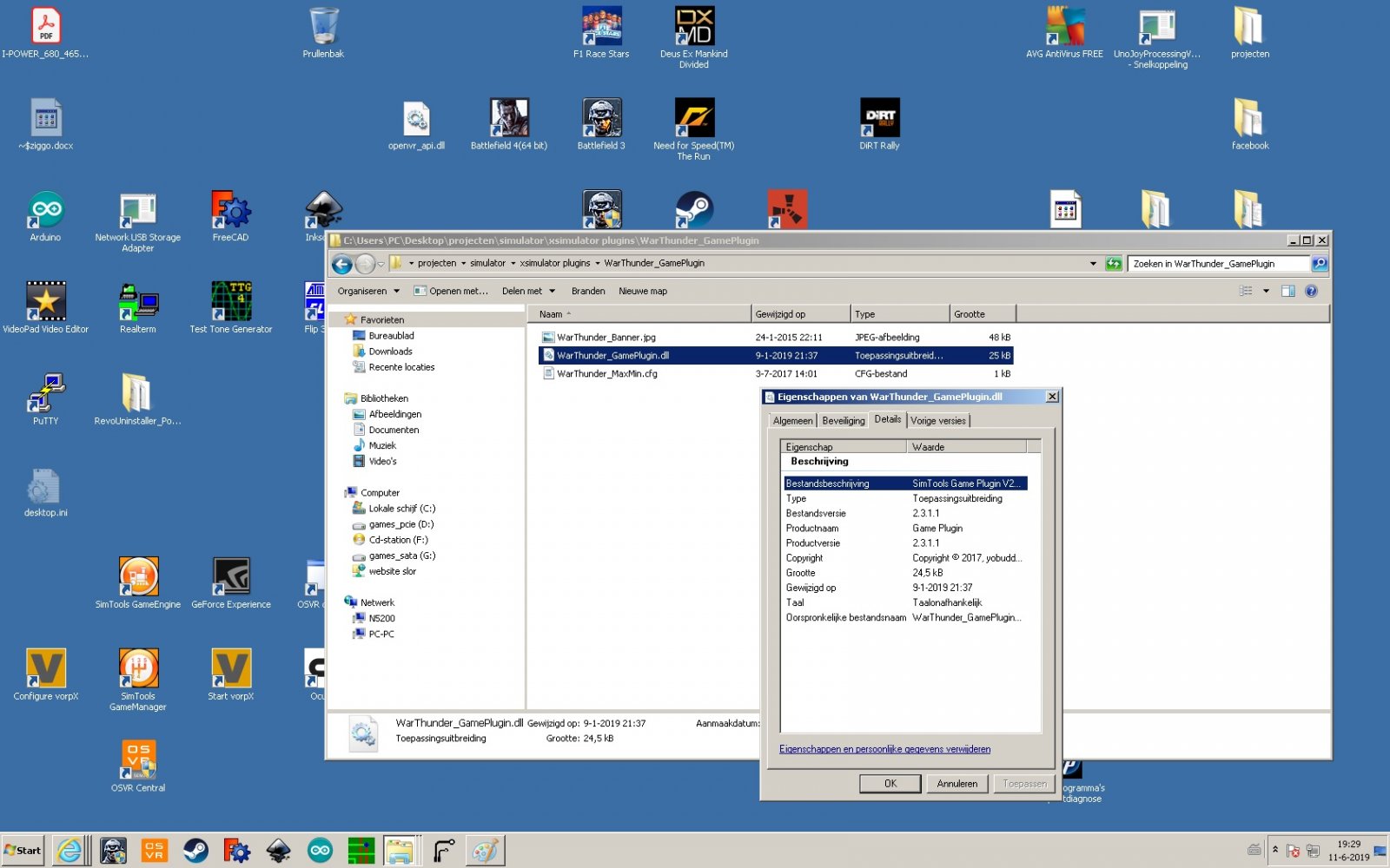

    Found wat is wrong. I have simtools 2.2.5 and need 2.3.1 I think :(. Now I need to update simtools and I don't like that! :( . I think then I lost all my setting again for dirt rally :( . And don't no the way to go. Last time it cost me a day are 3. To even install a plugin :( . Was reason 2 times simtools installed. I think I leaf war thunder and just drive dirt rally as long as the simulator go's doing it :) . I not good doing installations.
    21,594
    151,227Coins
    I thought that may be the case.
    You should be able to just install the new version over the top of the old without issues, but to be certain you can take a backup first, see here for details: https://www.xsimulator.net/communit...thout-loosing-your-profiles-and-settings.160/
    What version of Windows are you running?

    I installed update xsimulator. First uninstalled the old en then installed new version. New need setup axis perfect and go again. War thunder is differed. I have disable yaw. Because my simulator complete rotate that way! I not need that! Need to find the right settings my self ! Thnx for your help!

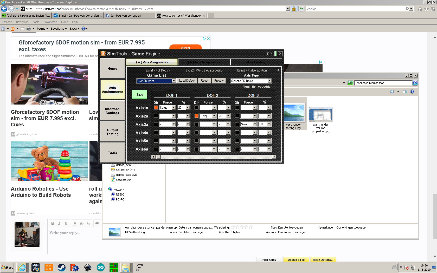

    I get war thunder working! Only one thing thing is a problem. My simulator is not 360 :( . So I use surge 30 + pitch 10 on axis 1. It points the simulator up and down. Then axis 3 is rotating axis. This I place sway 30 and yaw 10. Most logical. Now my problem is here. Sway is the feeling I thinks rotation like yaw. I need to de the roll axis of my simulator. Axis 2. What is the feeling of roll? My simulator has sway for feeling roll? That not good! I need the feeling of roll? How do I fix that?
  11. grooste_lwd
    grooste_lwd Active Member
    Nov 20, 2015
    123
    Nederland => Friesland => Leeuwarden
    123Coins
    +91 / 0 / -0
    Extra axis for motor 2 solved the problem :). Now have a good rolling plane :) Marvel :). Love simulator ! (my rudder in war thunder game is very hard to control!!!!)

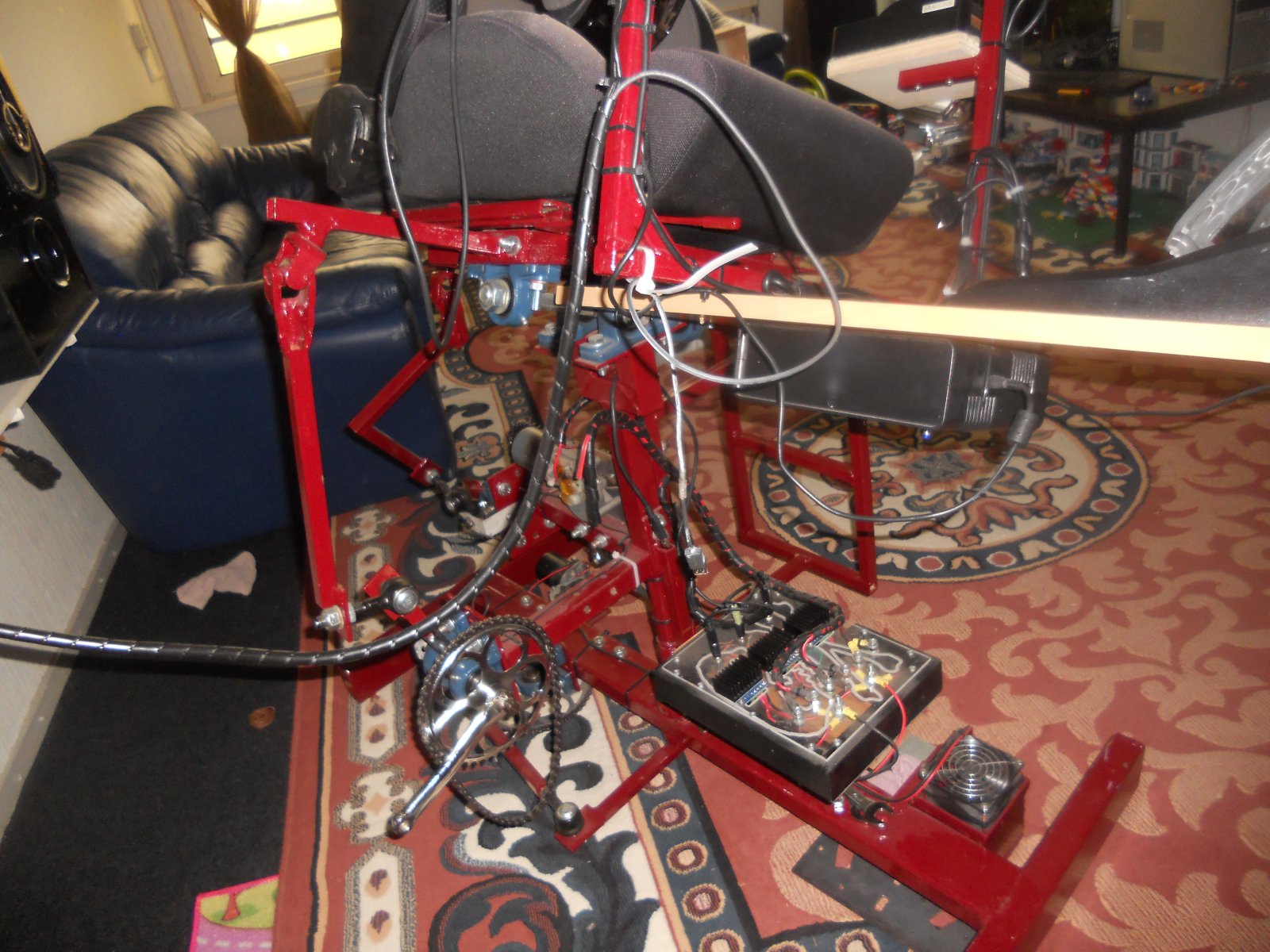

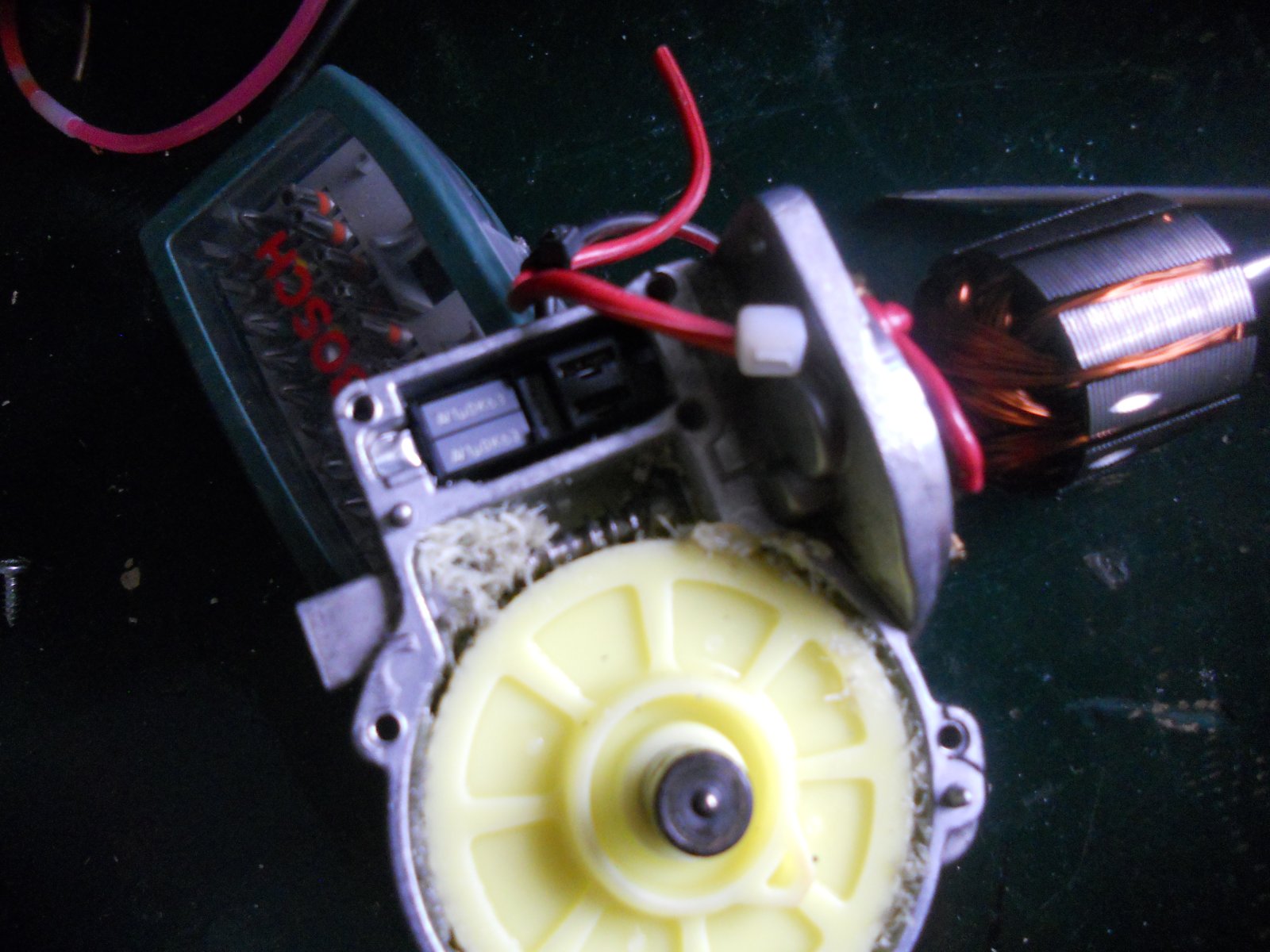

    Snik, Me crying! Motor wormgear broken! (after my friend used the simutor 120+ KG :( )
