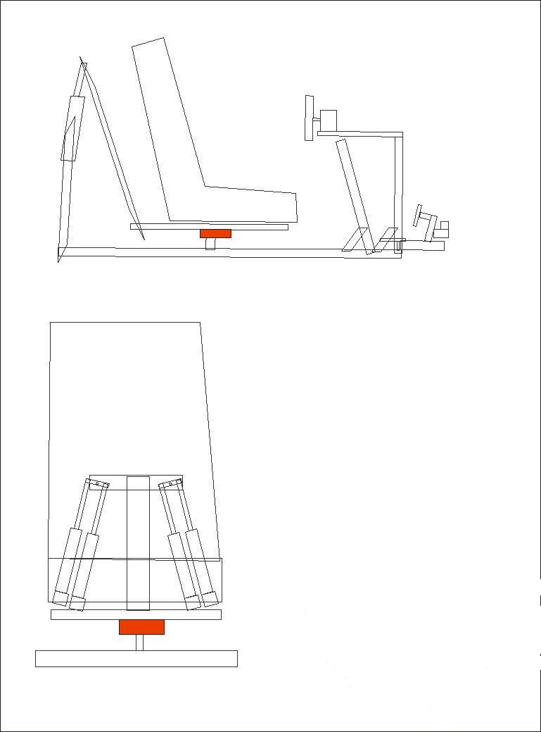

    i have use the degree programm on the iphone.the red points are the iphone.
    the degree left right by me old sim is on this place 30 degree 15 left 15 right.

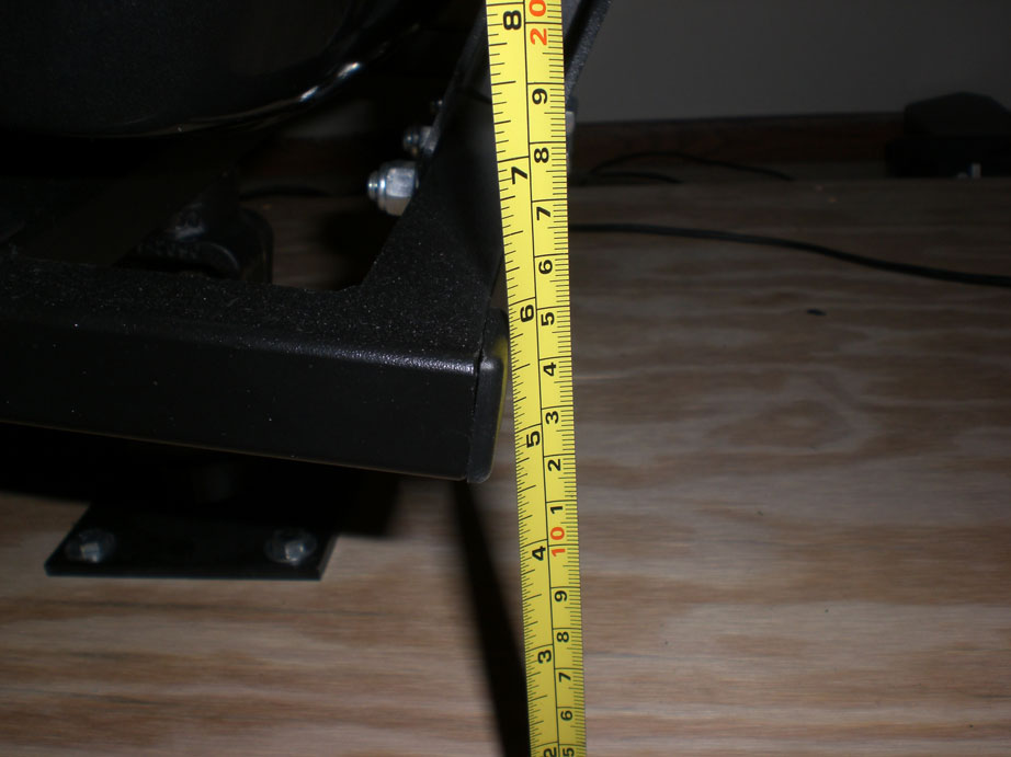

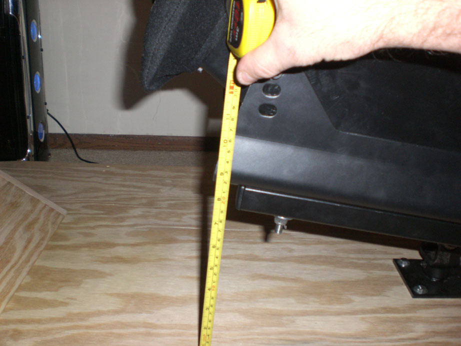

    I don't have an iPhone for comparison, but comparing seat movement can be done by fully retracting your seat and measuring the front and back of the seat to the same fixed point. This may be an easier way to make comparisons that everyone has the tools to measure.

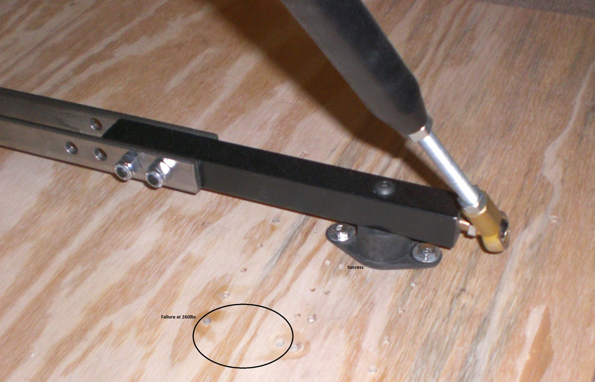

    I'm currently testing my Universal Motion Kit. Presently, it is simply attached to a piece of plywood. I fully retracted the actuators and measured the front and rear of the seat. Currently, the actuator angles are configured for a 260lb user. It is possible to achieve more movement than this for lighter weight users by changing the rear dampening bar location or width.
    Hope this helps.

    I dont have the option to click on this image and zoom. It's just an unreadable 132 pixel x 75 pixel thumbnail.

    can you make a picture 50 inch behind the sim and 10inch over the ground.
    the acculatoren one on 0mm one on 150mm
  10. bvillersjr
    bvillersjr Active Member
    Oct 11, 2008
    1,174
    Ohio, USA
    438Coins
    +23 / 1 / -0
    LOL..
    I don't get much sleep these days. Too much work to be done.
    I need to un-bolt a few things from the test sim before I can take a show this picture. I will probably have time to do this tomorrow or Monday.

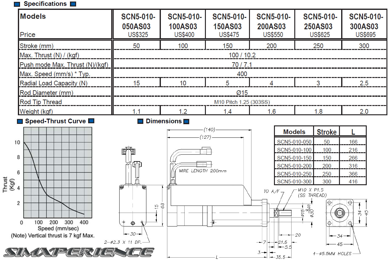

    do you have a drawing from the speed trust curve from the scn?
    aikuo60:the scn5 make many brake under weight.if use the same way,you mast carry 50% more weight.if you mast carry 1kg you have 400mm/s speed.with 5kg you only have 100mm/s.with low weight the 100mm are faster with more weight the 150mm are faster

    I know that we are out of the post, but this is the properties of the SCN6 actuators
    I think a internal software exist in order to mesure the real speed of the SCNX, it will be interresting to know this, with this we could compare the better solution for a good design without our human sensibility? What do you think about this?
