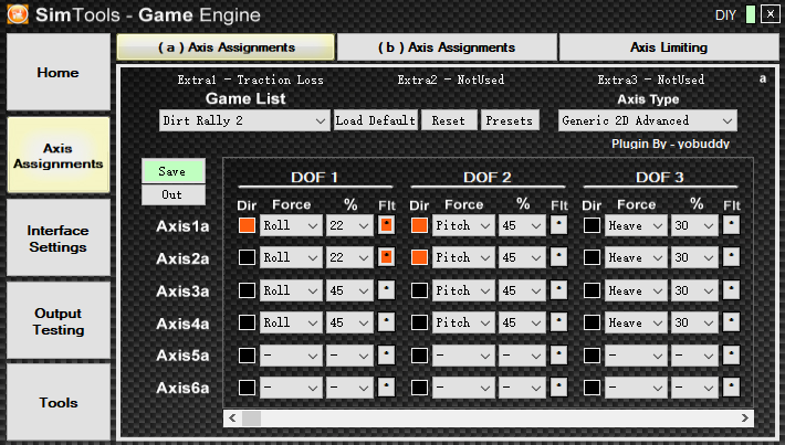

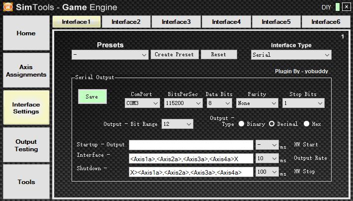

    My brother, when my simtools is connected with G force, turn on rises in a hurry. How can it rise slowly, and it also falls slowly? Brushing it is a bit scary. Thank you very much. 2.png 工作.png
    21,517
    150,722Coins
    +11,018 / 55 / -2
    Grab a copy of the SimTools manual and keep it handy for reference: https://www.xsimulator.net/community/faq/rtfm-start-with-the-official-simtools-documentation.117/
    The Axis Allocation is what % of the total axis each force has. The Tuning Center settings determines how the rig reacts with respect to that allocation.
    You should first capture the Max/Min values in the Tuning Center, the tweak from there. The larger the Tuning Center Value the smoother the responds, over a greater range, the smaller the Tuning Center value the sharper the rig responds, but over a smaller range.
    See the motion profile tuning tips here: https://www.xsimulator.net/community/faq/steps-to-create-a-motion-profile.228/
