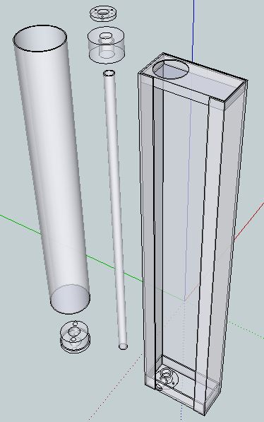

    Our community helps each other with their experience and knowledge which is great, so how about we put our heads together and come up with a design, drawings, and the eventual manufacture of the parts so that our members can source and assemble a DIY linear actuator?
    To kickstart this and get the ball rolling
    My initial specs would be
    1 a universal design to suit 2dof through to a 6dof
    2 adaptable motor mounts to suit various motors
    3 quiet operation
    I have seen a few linear actuator designs on the net, bff, Rolands, and the one that to me that has the most potential, as an easy to assemble diy project is this one.
    http://jippes.home.xs4all.nl/hi6sim/MK_IV.html
    what do you guys think?
    regards Terry

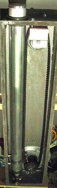

    One of the pictures on the Douwe site I linked to, is a prototype actuator from
    http://www.motion-sim.cz/index.php/en
    using a toothed belt drive, they have very good motion judging by their videos.
    also with Douwe's design the air cylinder can balance the weight which should even up the loading on the belt.
    regards Terry

    Hi Mat
    I have been following Rolands work, very clever ideas, just seems a lot of work x 6,
    I think the Douwe actuator looks a lot more diy friendly, and using adjustable air pressure to balance the weight seems an easy way to adjust for different weights of users, equipment. using the air cylinder as the ram is genius.
    I don't feel the the drive belt slack will be a problem, the image on the Douwe site is an early prototype, once tensioned. Car cam belts dont really stretch, and the design would allow easy replacement.
    I did read the history of Motion Sim cz, and the development of their belt driven actuator, using powerful ac drive motors.
    regards Terry
