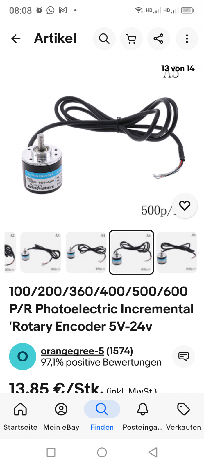

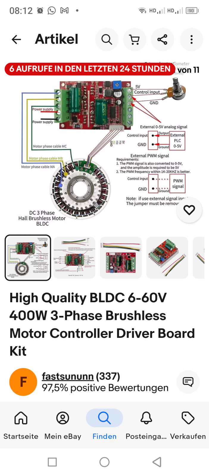

    I want to build a direct drive wheel, I have now bought a broken hoverboard for 10€ with working motors and would like to keep it as cheap as possible due to my small pension.
    Can these encoders be used and if so, at what speed?
    And is it possible to use this motor driver?
    Thanks in advance for the answers.

    You're probably not going to want to hear this but the real answer is, it depends.
    Are you looking to blaze your own trail and try something brand new that would be a start. If you want a functional DD wheel without the headache of trying to code something from scratch you'll probably want to go the ODrive and FFBeast route. That's what I did.
    I know this thread is a monster but everything you need you should find here, https://www.xsimulator.net/community/threads/dd-wheel-with-hoverboard-motor.13178/page-36.
    I recommend starting at the end and working your way backwards. The first dozen pages or so contain some false starts and avenues explored that didn't quite pan out. A couple looked really promising if you are looking for a challenge?
