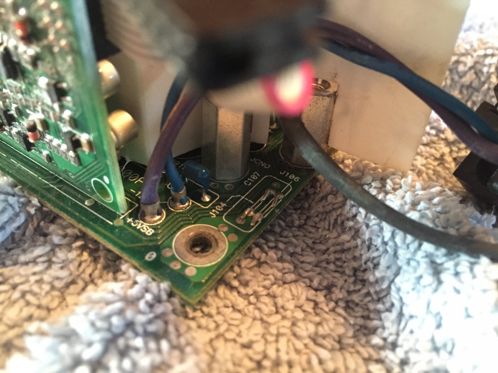

    here is how I did it.

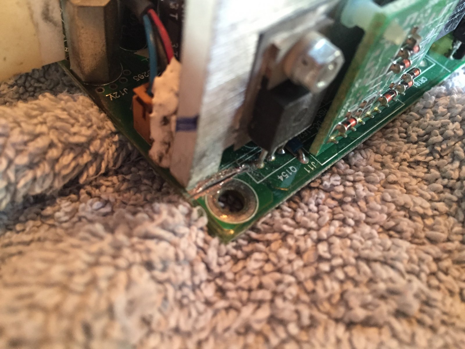

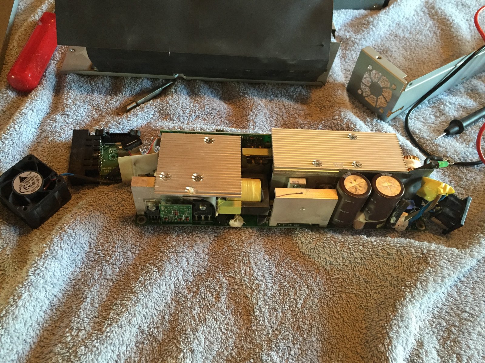

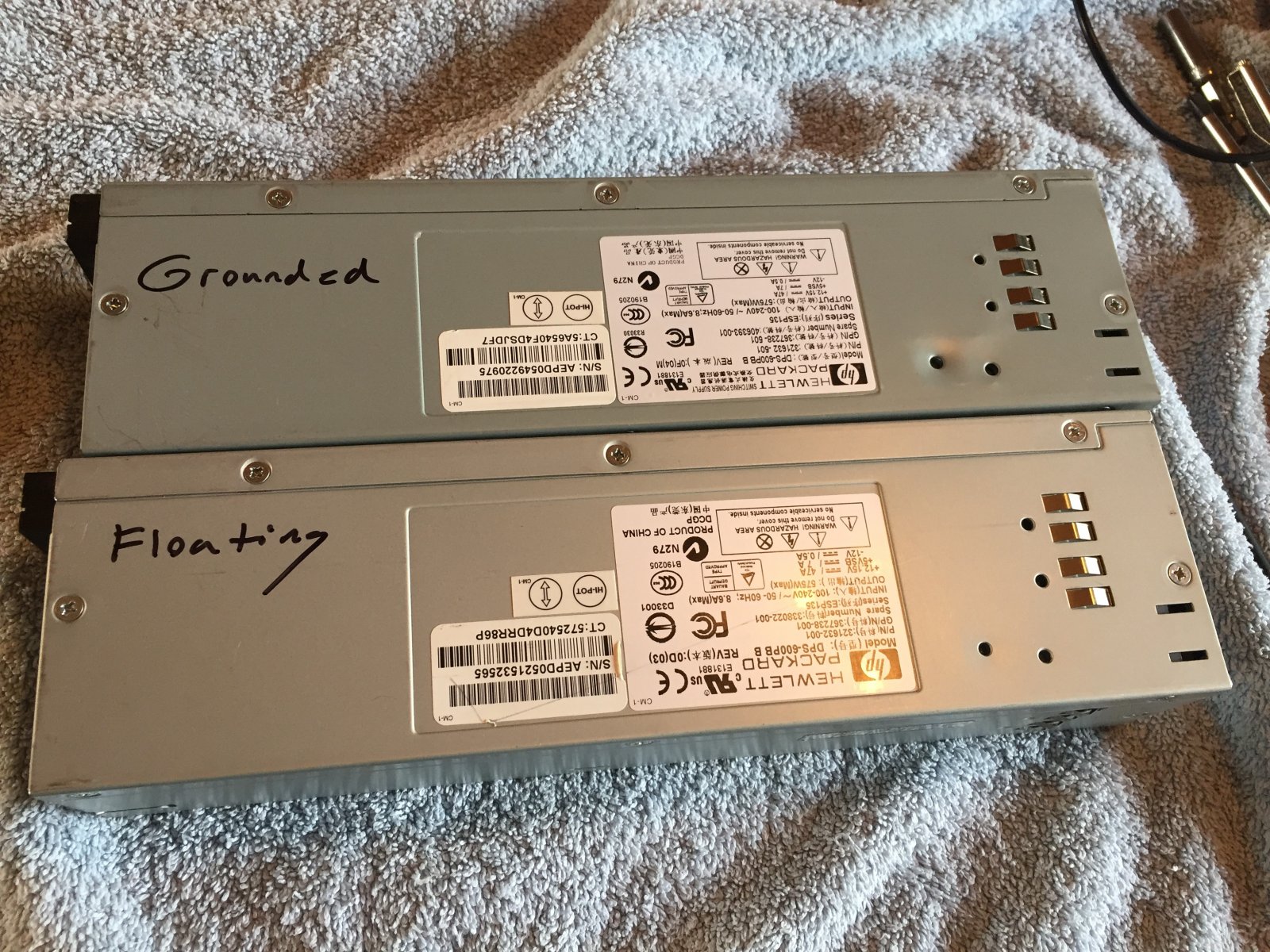

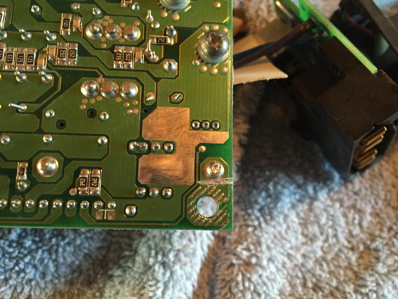

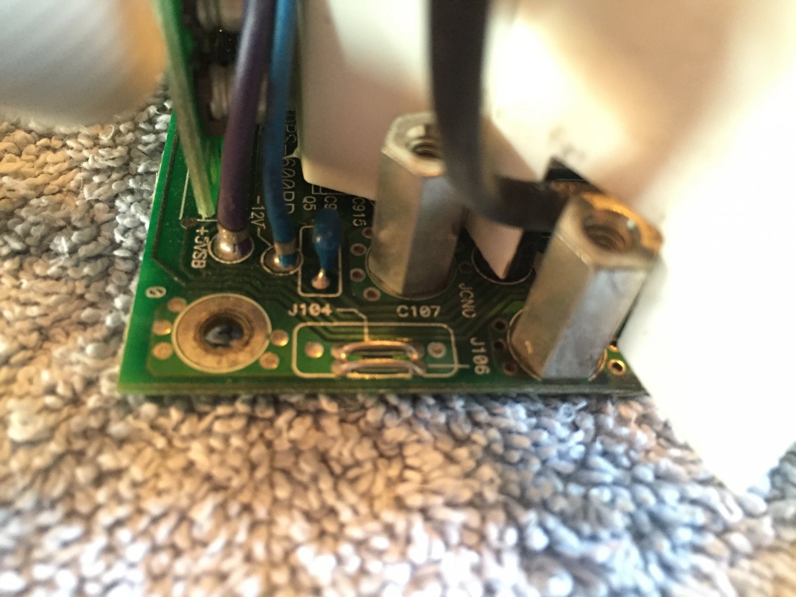

    I am using DPS-600PB power supplies, I have accumulated about 6 or 7 of these things so far. In order to use them in series without shorting them together when the cases touch one of the power supplies needs to be made to float.
    so I disassembled one of the supplies and completely removed the guts out of the case.
    Then I grabbed my multi-meter and started tracing the grounds on the mounting screw pads. The grounds need to be isolated so that the case is no longer grounded. there are lots of methods to do this, some include making spacers or washers or wrapping the entire case with an insulation like heat shrink.. I chose to physically disconnect the grounding pads by severing the traces. the first pad was easy, there are little wires that just needed to be cut.
    Then I used an exact knife to sever the traces at the mounting pads in a few more locations, each time verifying with my multi-meter that I had actually removed the connection. I was very careful to only cut the trace I needed and then went back with a little screw drive and widened the cut.
    Then I just re-assembled the entire power supply and checked for continuity between the case and ground.
    I also make a little jumper assembly with 4 servo connectors and short pins 4, 6, 8 and 10 together. that will turn the power supply on when plugged in and slow the fan down to the minimum speed.

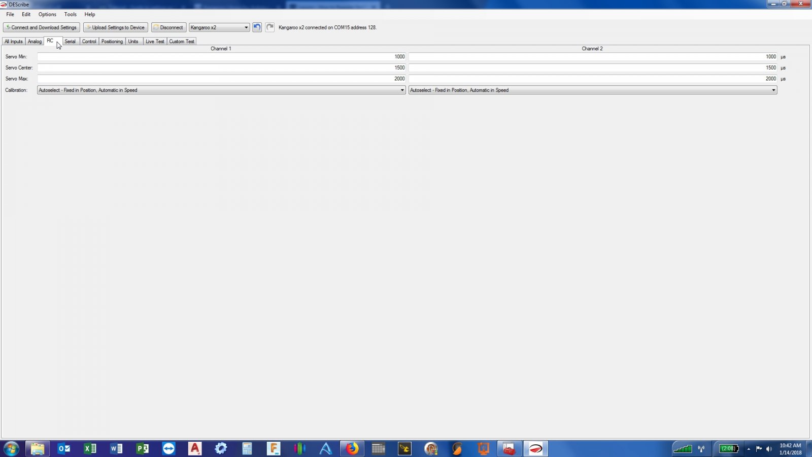

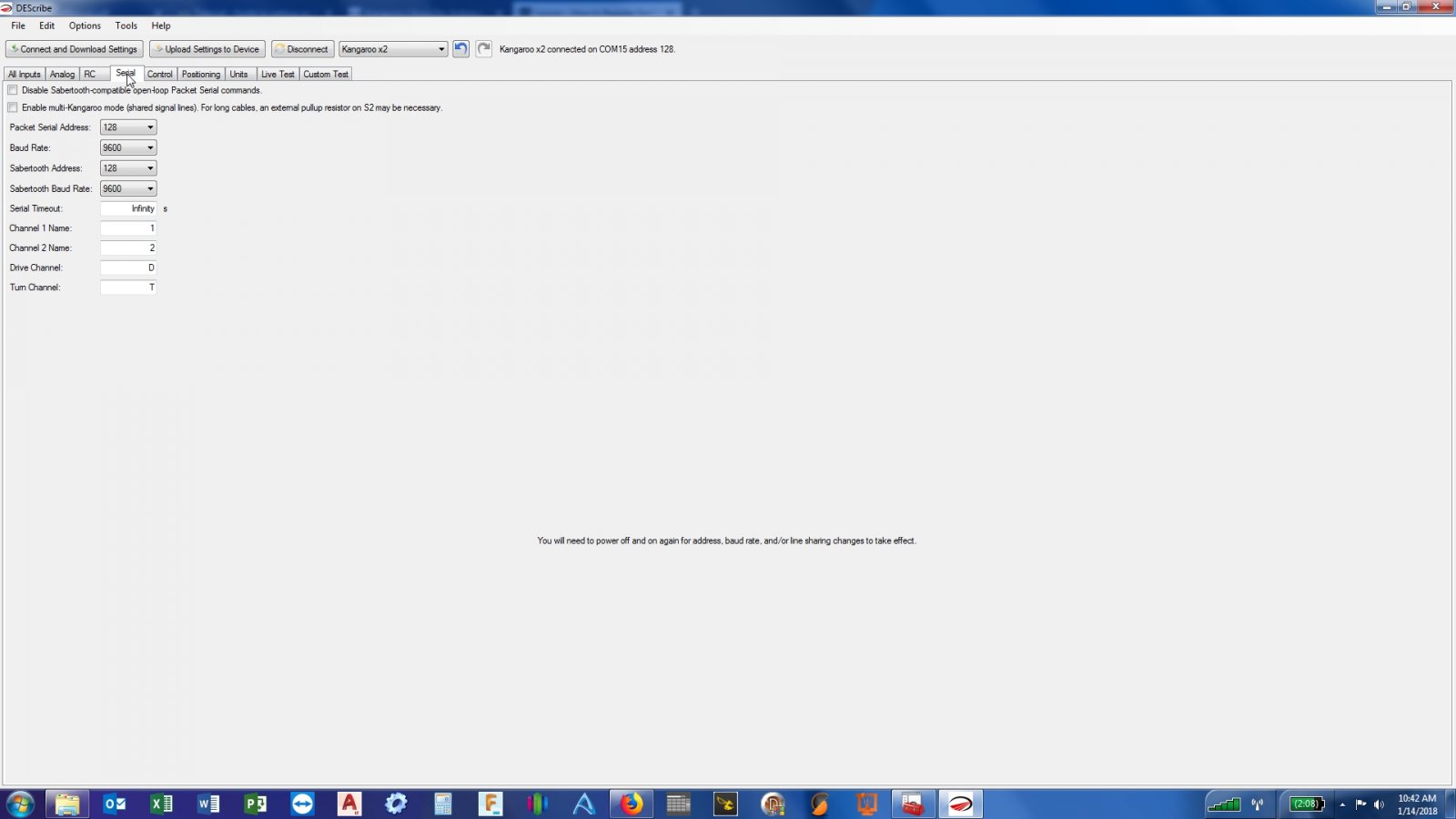

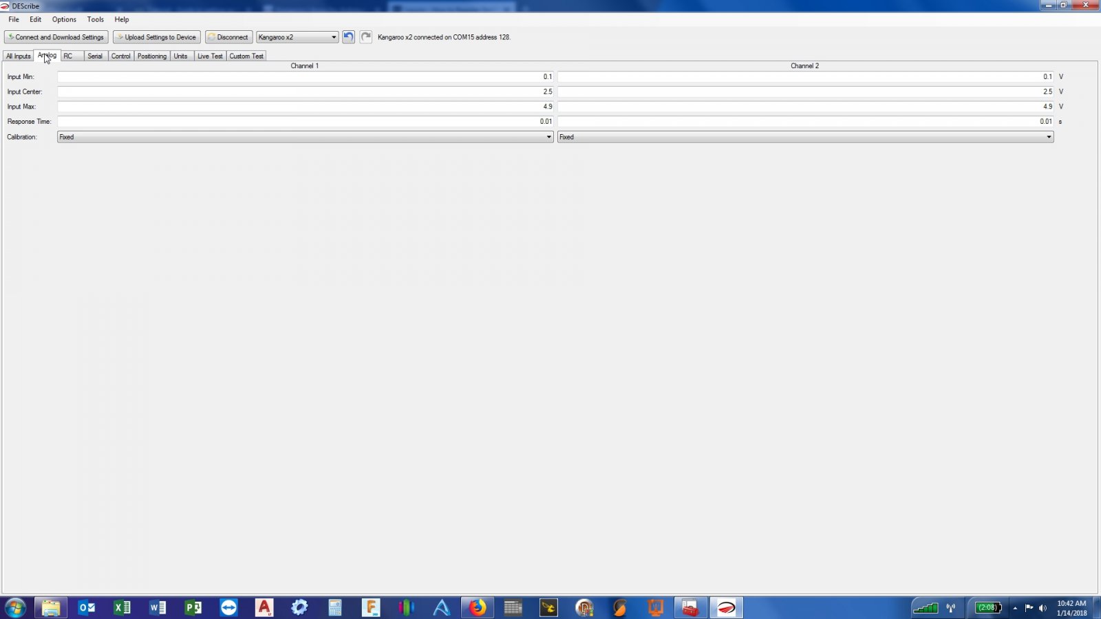

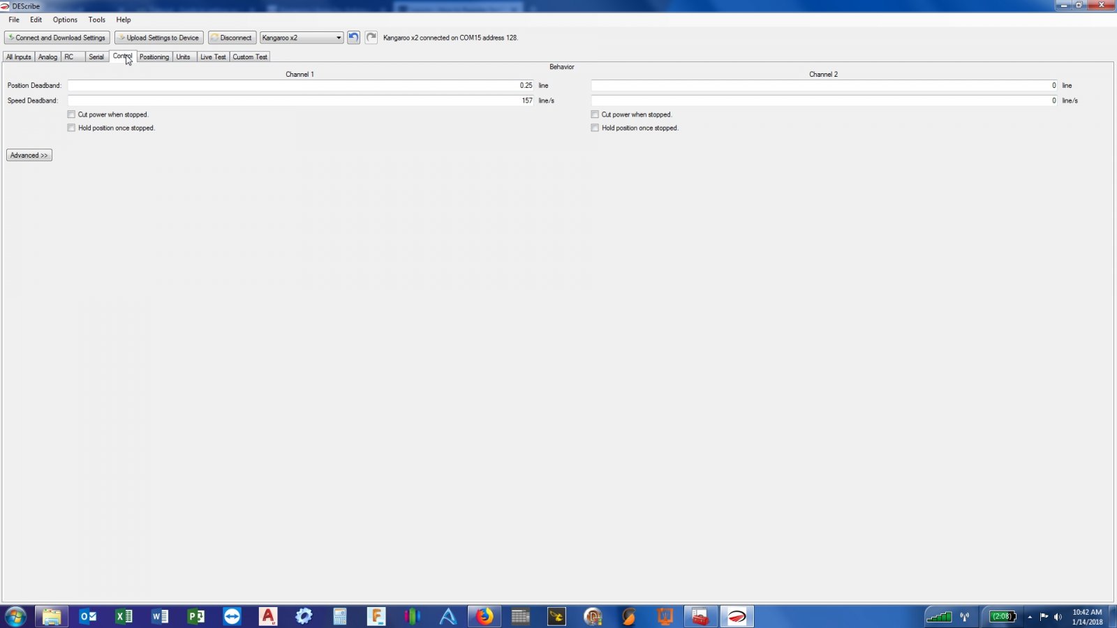

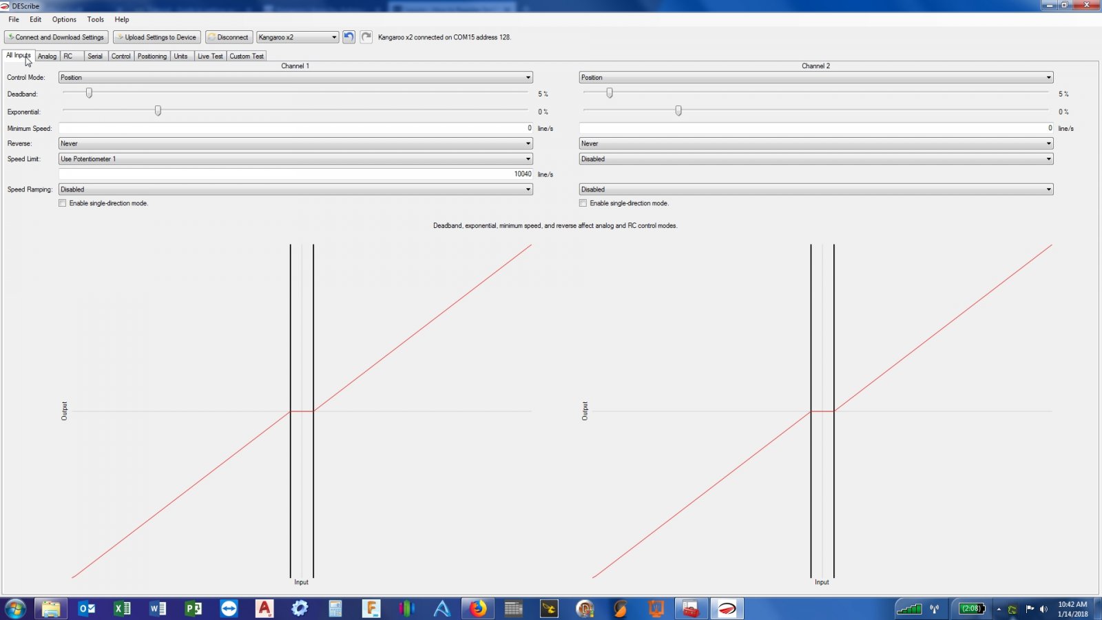

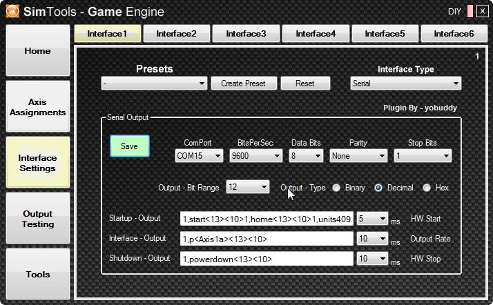

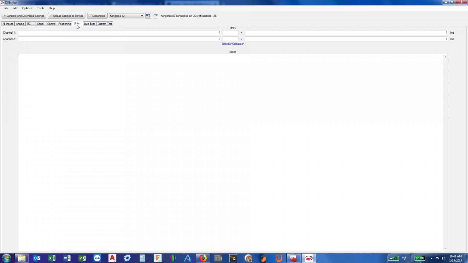

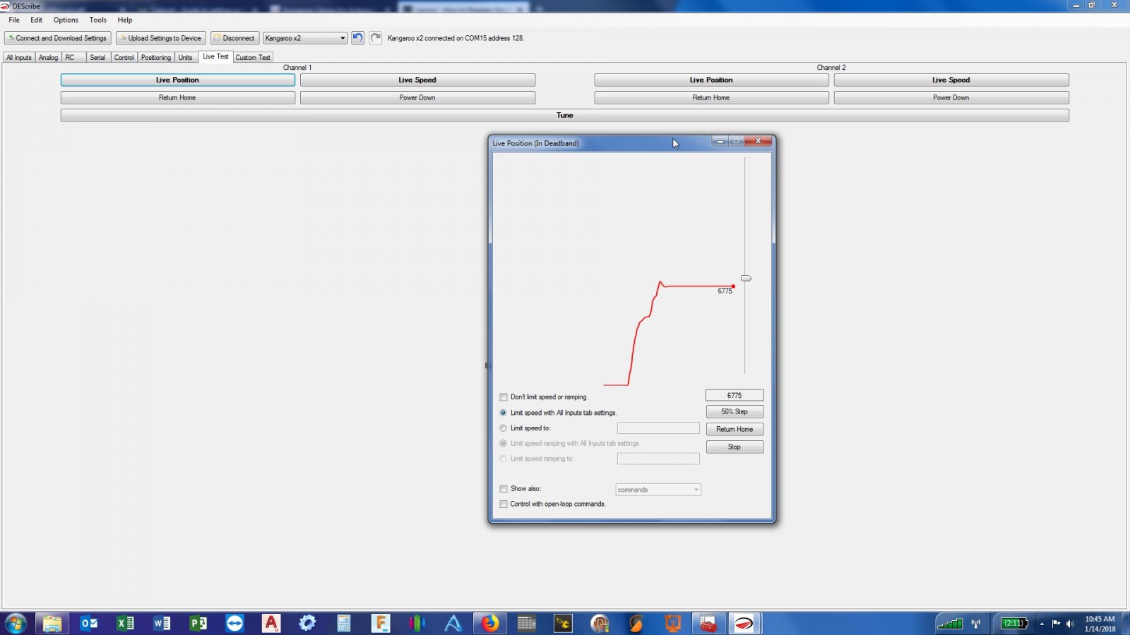

    I have pretty much put this project away for a while, but I had a help request from another forum member so I dug everything out again to finally do some testing. I was able to successfully complete a tune using the describe software and mechanical limits. I jumped over to simtools and everything worked great. Here are the settings I used in simtools keep in mind that I am using a quadrature encoder not a potentiometer for feedback.
    1,start<13><10>1,home<13><10>1,units4095=15400<13><10>
    1,p<Axis1a><13><10>
    1,powerdown<13><10>
    My travel range is 15400 encoder counts which can be found in the positioning tab of the describe software under nominal travel. I also added the home command at startup because for whatever reason when using mechanical limits the system doesn't automatically home upon power-up. also notice that in the describe software the system automatically creates hard limits and soft limits which can be adjusted manually to give more or less of a safety zone.
    The kangaroo simplified serial is pretty basic, here is a little more information about the commands the kangaroo accepts.
    https://www.dimensionengineering.com/software/KangarooArduinoLibrary/html/index.html
    and here is a video of the whole system up and running, no test stand though I needed some space in the garage.

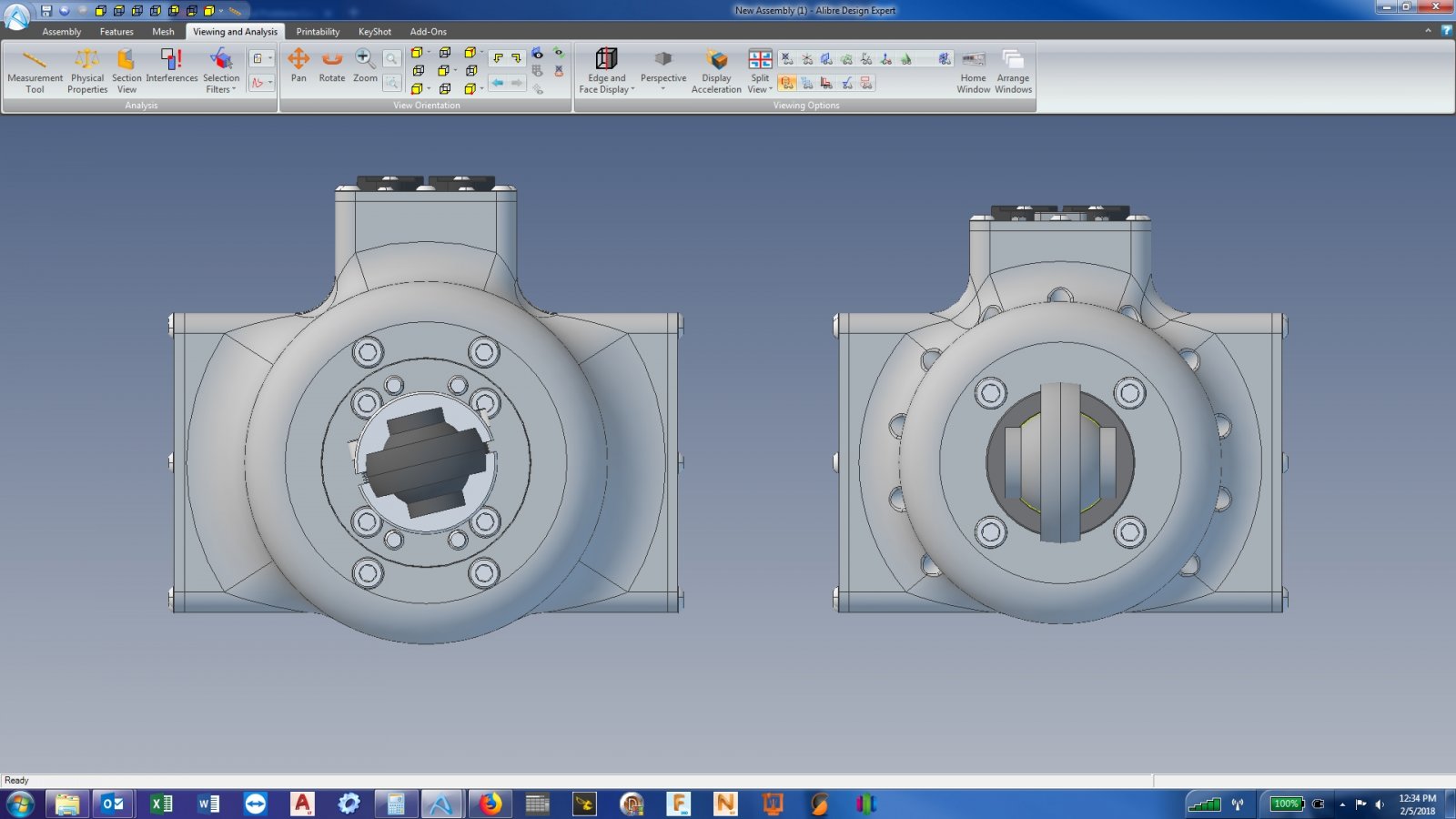

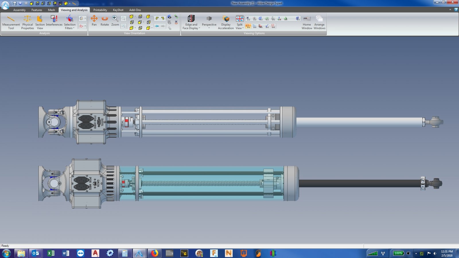

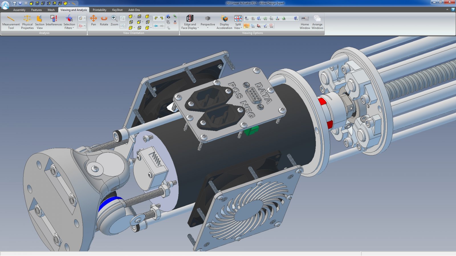

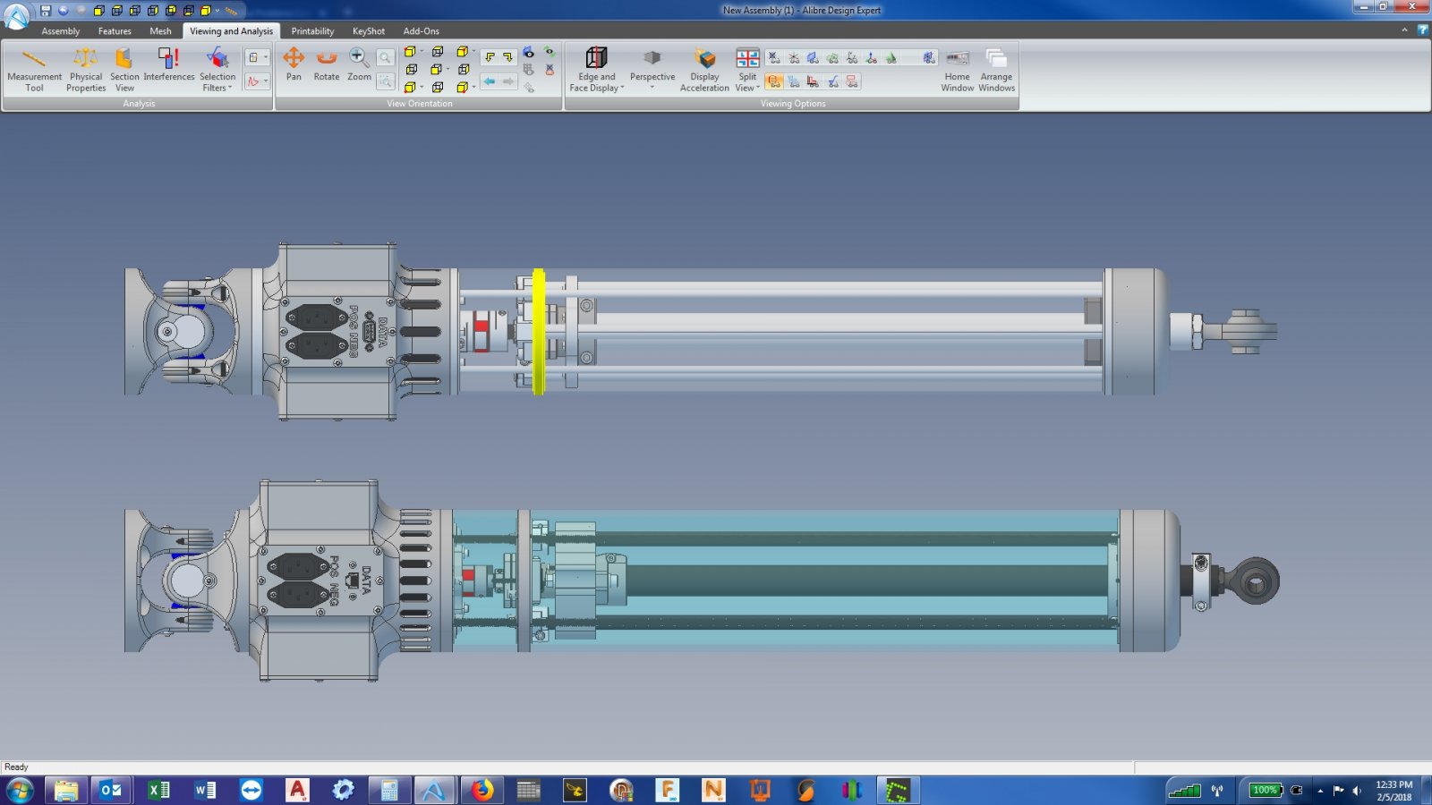

    I have put the actuator project on hold while I finish up the racing simulator, however I never really stopped thinking about it. I felt like the 3d printed design was successful enough as a prototype, but I had a few things I wanted to change. Here is V3.0 of my actuator design with some improvements.
    1. Shaft mount encoder vs gear drive
    2. More reputable 24V dc motor
    3. 30mm hollow precision linear shaft for the main shaft vs 25mm carbon fiber.
    4. qty 4 12mm steel guide shafts ( I could feel some flex from the two and the carbon fiber main shaft)
    5. Smaller 4" body diameter vs 4.5" on V2.0
    6. Aluminum plates replace 3d printed ones
    7. Aluminum tube replaces clear PVC
    8. Larger flex coupling between motor and ball screw
    9. 9 pin shielded serial connection for encoder data vs ethernet cable
    10. No more limit switches
    11. Larger swivel rod end
    I already have all of my parts sourced or prototyped and ready for assembly.
    Unfortunately I need to get the racing simulator finished up before I can tackle the next phase of this project, it should be soon though. If you want to check out the design in more detail, download a 3d pdf from here (tried to upload it here but the website kept crashing) you can move it around and hide parts to see the guts. You may need to "enable content" to get the 3d model to be interactive.
    https://www.dropbox.com/s/wxw23o8y15z13oi/DIY Linear Actuator R3.2.pdf?dl=0

    Out of curiosity, why did you decide to ditch the limit switches?
  10. llluis
    Mar 30, 2017

  12. Hoddem
    Hoddem Well-Known Member
    Sep 27, 2016

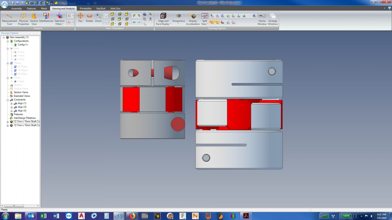

    The motor I am using is the Ampflow E30-450, When I spoke with Ampflow about my project I also asked them what encoder they recommended. Turns out that motor is designed to directly mount a US Digital E2 Encoder. While it is pricey at almost $100 ($70 for encoder, $14 for cable, $13 for shipping) it mounts directly to the motor shaft so it is a very clean and reliable solution. I haven't had any problems with my gear driven encoder, I just prefer this solution.
    Here is the encoder model I am using - E2-50-375-IE-D-G-3
    EDIT - I chose a 50CPR/200 PPR encoder based on feedback from Dimension Engineering. The kangaroo can handle 80,000 pulses per second total so 40,000 for each encoder on a two motor system. with my 5700rpm motor I will get a 19000 pulses per second per encoder (38,000 total) witch puts me at about the 50% mark for the kangaroo
    With my 10mm ball screw the resolution will be 0.05mm, with my 5mm ball screw the resolution will be 0.025mm.
    Just an off the cuff calculation if I was using a Pot I would get a resolution of about 0.1mm assuming I could use full scale over the travel of my actuator and 12 bit scaling.
    The new coupling was actually and accident, I ordered what I needed based on the size of the two shafts and the new one was quite a bit larger then the old one. I don't have enough testing to say whether the smaller coupler will fail, but I'm pretty confident the new one won't.
    Old coupler is 25mm OD x 30mm long, new coupler is 30mm OD x 42mm long
  14. Hoddem
    Sep 27, 2016
    404
    Engineer
    Minnesota, USA
    3,343Coins
    +717 / 2 / -0
    No I didn't, by calculation the old actuator is 3000rpm motor with 5mm pitch ball screw. It should be 250mm/s at 12v (the videos are all 12v) and 500mm/s at 24v. That's ideal no load speed but realistically it is probably less.
    The new actuator is using a 5700rpm motor and 10mm pitch ball screw it should be 950mm/s at 24v again that's ideal. I now have a 5mm and 10mm pitch ball screw so I will test both as I doubt that the 10mm pitch ball screw can actually lift me, but It will be fun to see how fast I can get it to move.
