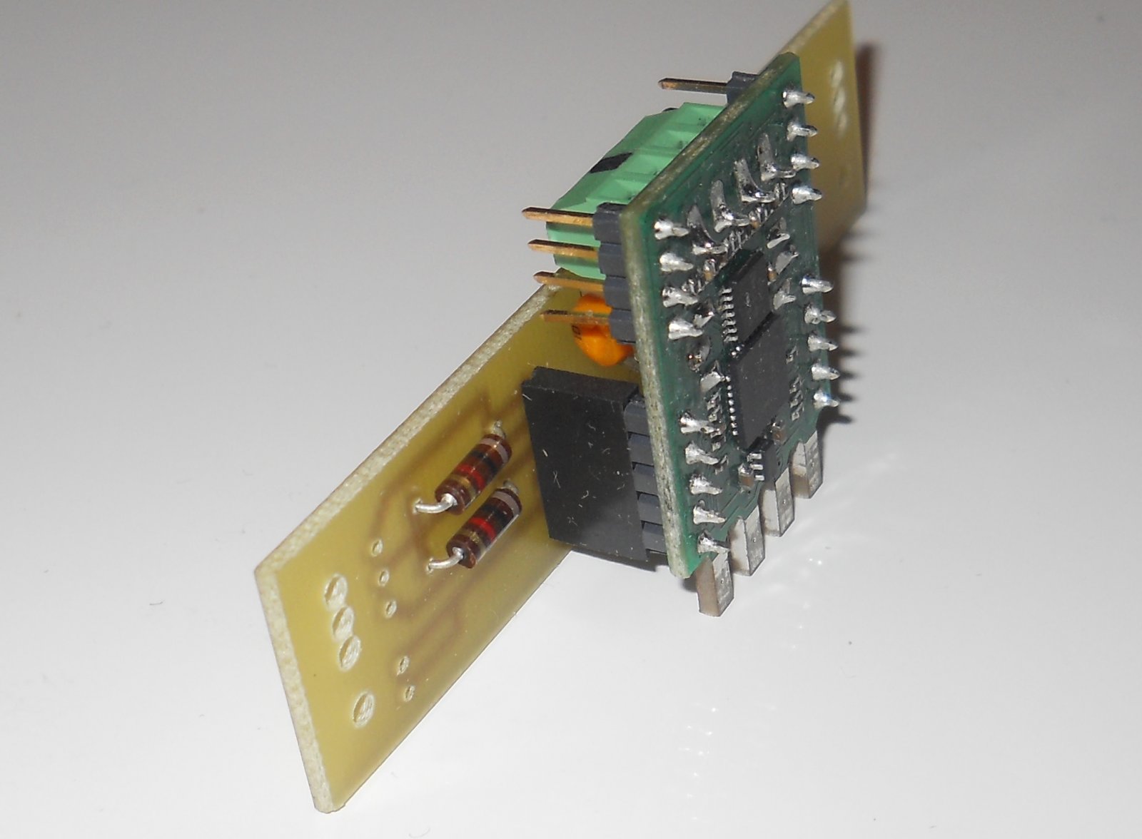

    Hiya @Hoddem just wanted to say thanks for the answers regarding the kangaroo and Optical encoders , fingers crossed you have better luck finding out the Limit switch error that seems to come up now and then with the Autotune function Teach, and I tottaly missed the 2 X 60 compatibility with the Kangaroo So never even tried it ... Hoping to have my Platform up and running again in the next week or so will post stuff in my project posting.. and the info about the dip switch setting confusion will save me some grief once im test the optical encoder / Kangeroo setup on spare actuator ..
    your quite right about lack of space for the encoder signal pull ups so I actually made a PCB with the 10K pull ups that sat ovet the kangaroo . will try to find them and post a picture .. Cheers and once again thanks for the info ref my question

    Hi @Hoddem found the PCB I made for connecting optical encoders to the Kangaroo . the idea at the time was to allow me to have the Pull up resistors mounted to the pcb and then plug the sensors into that and the whole ting connected to the kangaroo via two 4 pin headers ... the next version will be better laid out but at the time I was pulling my hair out due to the false limit switch error and I even tried the mech limits switch autotune but that played up so kinda lost heart . but the Kangeroo had / Has promise I just did not understand what I was doing wrong ... anyways wont clutter your post , just thought I'd let you see the road I travelled looking into this (bear in mind it was a long while ago but seeing your work has got me thinking again)..
    Oh Oh I just remembered , I don't know if your aware that the DE Describe software now has a facility for you to see the limit switch state and check encoder pulses in DESCRIBE .. Charlene sent my an updated version of describe way way back with this function as a pre-release copy but I never checked to see if the latest version of describe has this or if you guys were aware of this

    Nice, you must have some experience building your own circuit boards. I have done a few designs, but I always have to send them off to a board house and wait forever to get them back.

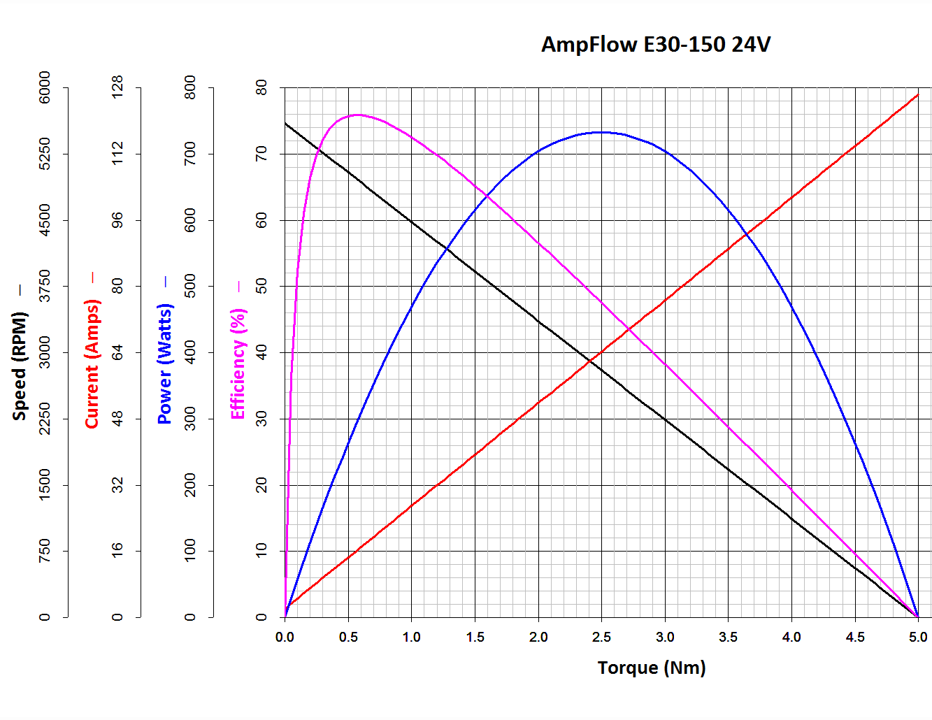

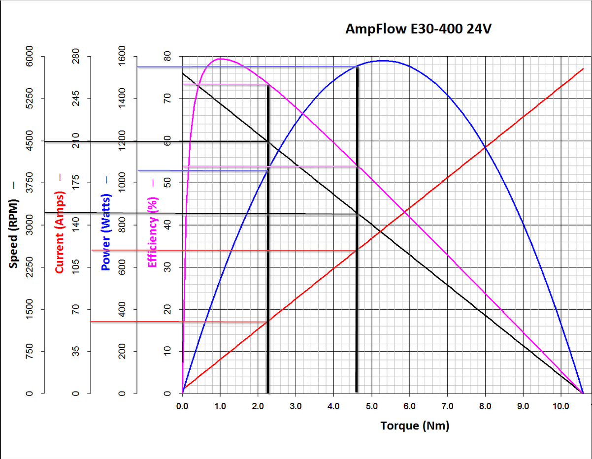

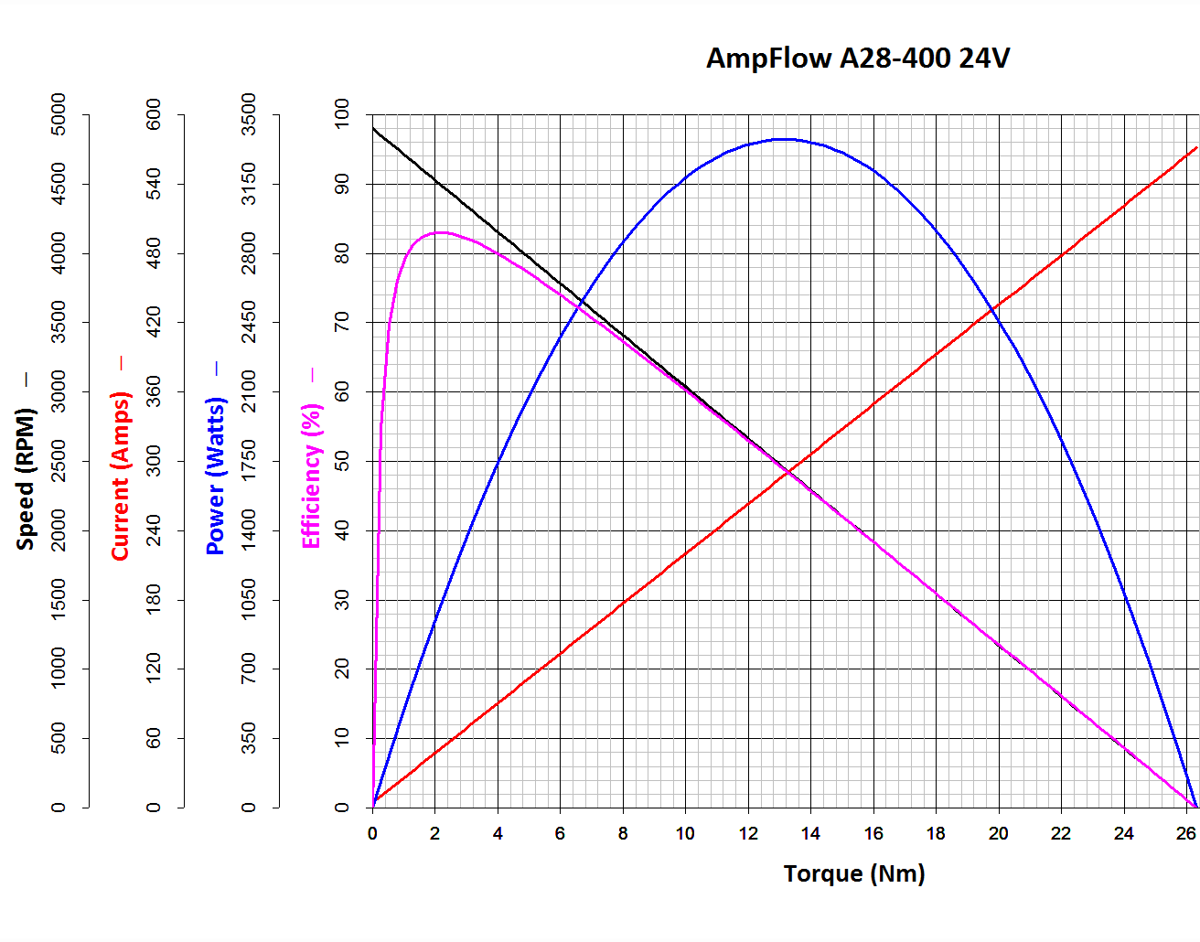

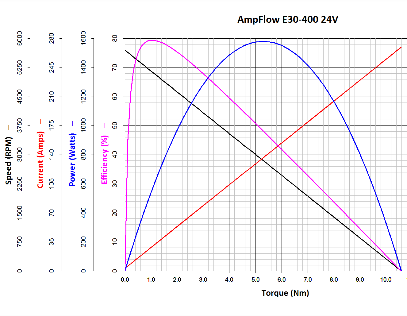

    So I have been looking at performance charts and if I am reading them correctly it looks like the E30-150, E30-400 and A28-400 all have about the same maximum torque for our use.
    Here is the torque chart for the E30-400 which is the motor I have had my eye on based on performance and cost. I added the lines in to show the corresponding speed, power, efficiency and torque at 60 and 120A (the peak continuous and peak momentary current of the sabertooth 2x60.

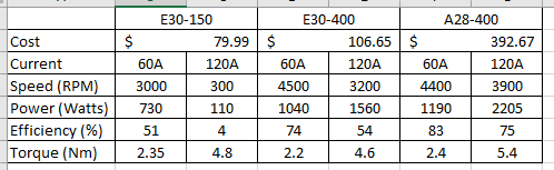

    I ran the numbers on these three motors and this is what I came up with.
    Somebody take a look at this and let me know if I on the right track here. I gave AMPFLOW a call but they didn't answer, I will try again later to get their recommendations.

    I just got off the phone with a gentleman from ampflow and based on my requirements he recommended the E30-400 for testing purposes. He was a little concerned when I told him 60A and 120A current loads, he was recommending about 30A continuous current. He did confirm the more expensive motors do not result in greater torque at the same current, but will have a higher RPM.
    I think that was about all the push I needed to get one and try it out, I will wait until after I figure out my limit switch issues though.

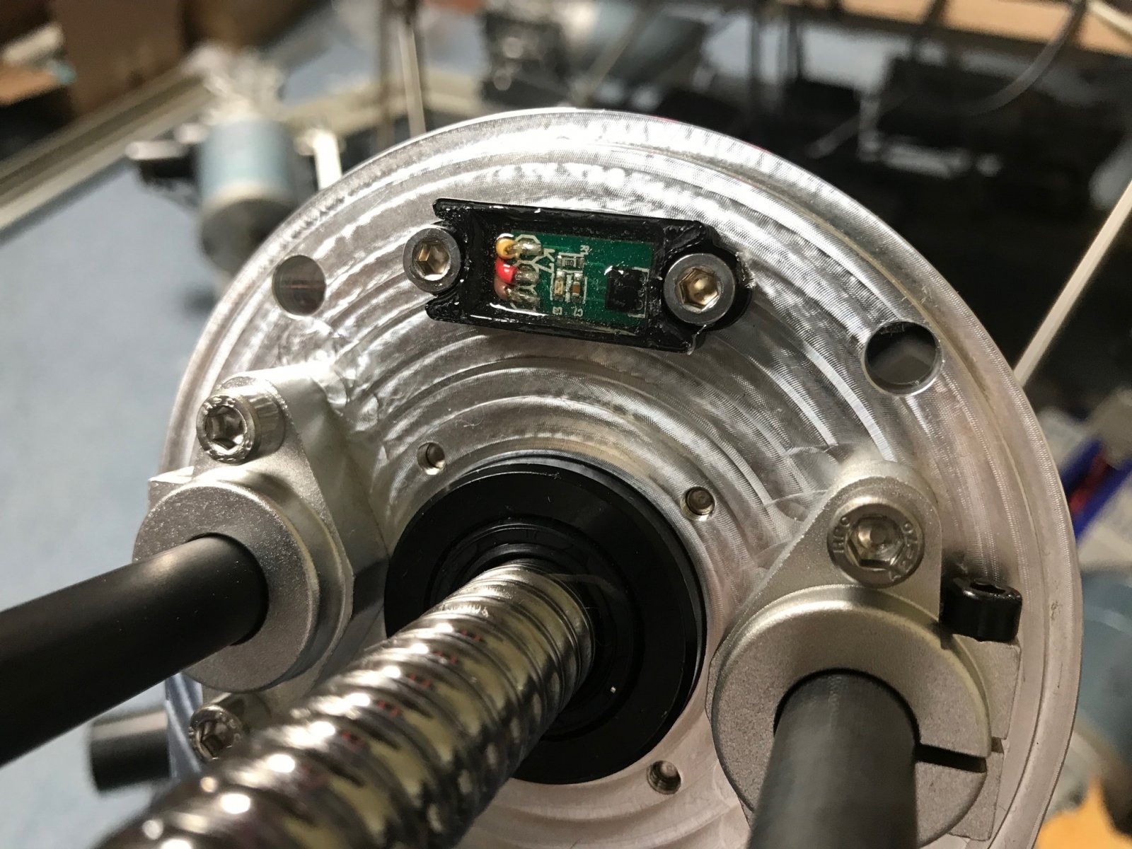

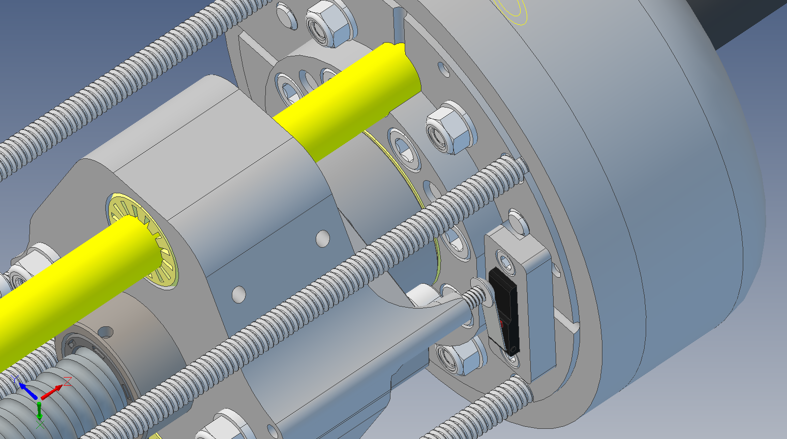

    here an alternative to the end stop switches.
    I'm using "HALL-Sensor-Switches" for my actouator design.

    Have you done any testing with the sabertooth and kangaroo. I would think the same problem would exist regardless of what type of switch is being used. Note its not a failure of the switch, its an issue with how sensitive the the circuit is to interference. I still haven't had time to test shielded cabling, but the more I think about the problem I keep wanting to just eliminate the limit switches and go with the mechanical stop tuning mode.
    also, I figured out why my 25mm linear bearing was pushing out. the 25mm shaft clamp will actually fit inside the 3d printed housing. So when the system crashes it is actually crashing into the 25mm bearing. I'm not sure why I didn't notice that before. I will probably add a feature to create a hard stop so the problem goes away.

    Hi @Hoddem Love the idea of the no contact hall sensor for limit switch ( as used in many 3D printers ) , did you not have a problem with the actuator damaging these once the switch was tripped but the inertia overrun would cause hard contact with switch ain the position they are currently mounted ? maybe a spring loaded-4-5 mm diameter pushrod could be fitted to allow switch to be triggered but would allow the rod move against the spring during any gravity /inertia over-run and so as not damage the sensor or end up with mechanical crash which would put unnecessary load on the Leadscrew Nut mount when switch contact was made . not re-read the last few posts so maybe this is no longer an issue in you revised design .. again guys I mention these things not as criticisms but just observation learnt form past experience :) Damm Fine Work so Keep it up . as yet another great DIY Linear actuator takes the stage ..

    In my design I use the HALL Sensorsinstead of switches. The detection (switching) is about 10mm before the real physical contact will happen. I hope the 10mm is more then the overrun could be.
