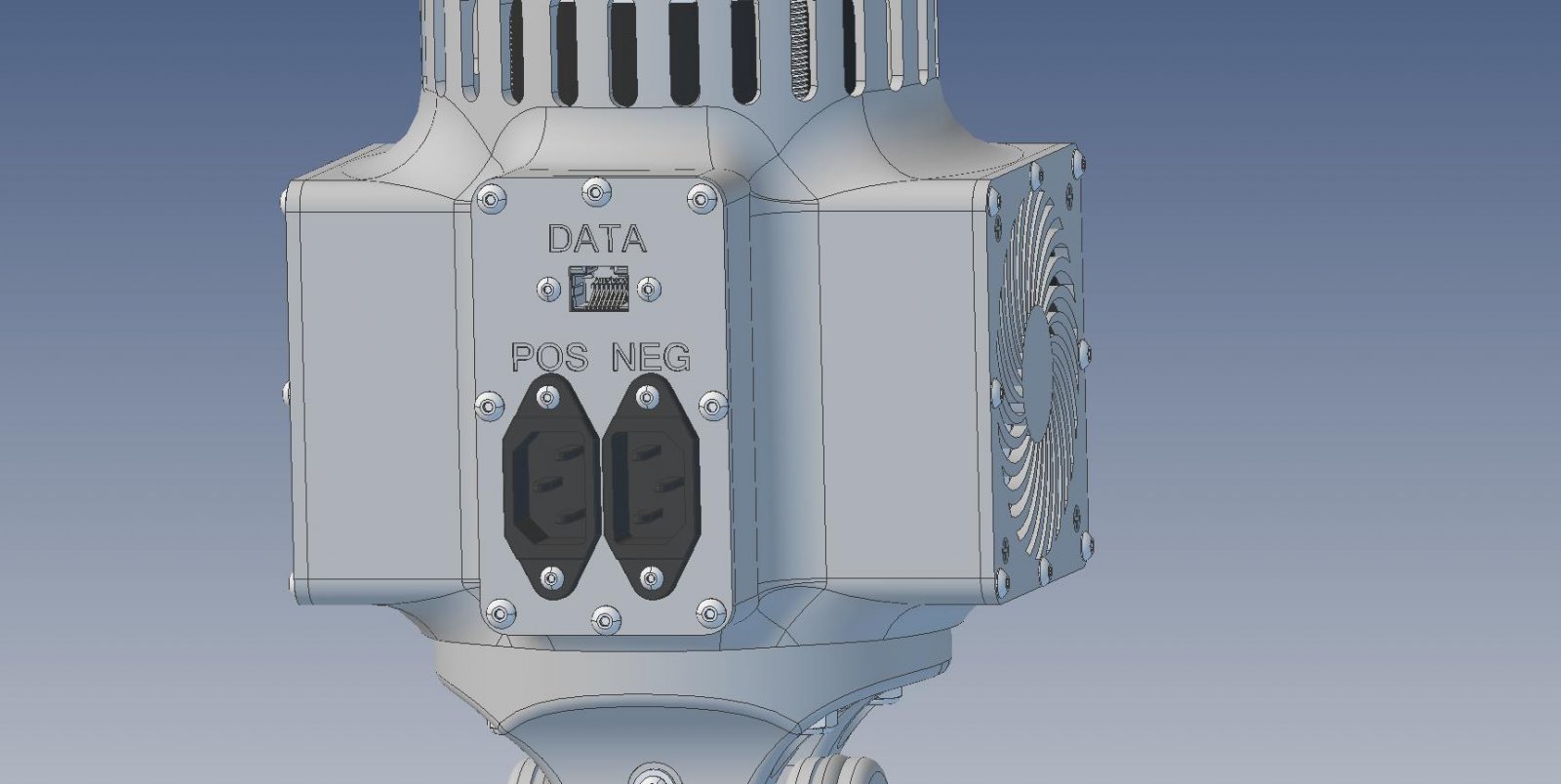

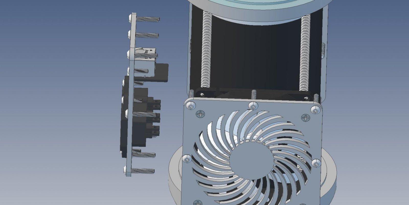

    I updated the design to include the new connections. The power inputs are standard IEC320 receptacles and the Data port is a 8P8C breakout board that I will add terminal blocks to.
    amazon.com/uxcell-Panel-Adapter-Connector-Socket/dp/B01ISO2T1C
    amazon.com/Connector-Breakout-Ethernet-DMX-512-Unassambled/dp/B0120Q1WSU

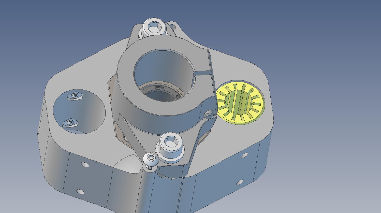

    I also updated some of the parts to capture the bearings rather then rely on the press fit to hold them. I noticed in my limited amount of testing that the 25mm main bearing was starting to slowly work itself out.

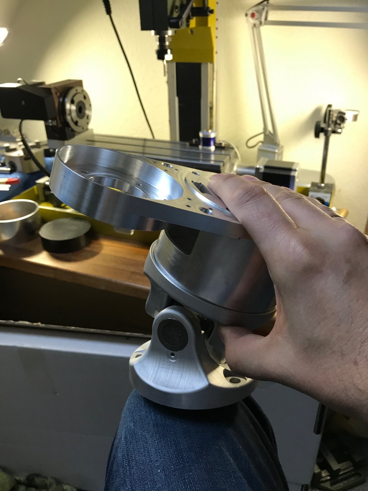

    First Material arrived, everything till now is made with 7075 aluminum. Seems to be fit together :grin
    Still waiting for the motors,
    @Hoddem , the aluminum parts for the joint have to be modify for proper Assembly.
    -kermit

    Wow, Looks really good.
    Are you saying that you can't assemble the u-joint in the current configuration? it looks like you built them as a solid piece, when I 3d printed mine like that I couldn't assemble them because there was not enough space to fit the actual u-joint in. The design now has caps with u-bolt for retainers to make assembly possible.

    Also, Are you machining those in house on your home built multi-axis mill? If so you really need to do a time lapse video of it running because that is a very complex part for a home shop to make.

    Yes right I made solid pieces. I modified the 3D's to make it possible to assemble the u-joint

    I didn't make this complex piece on my home machine, a company made this for me. But some other parts are homemade.

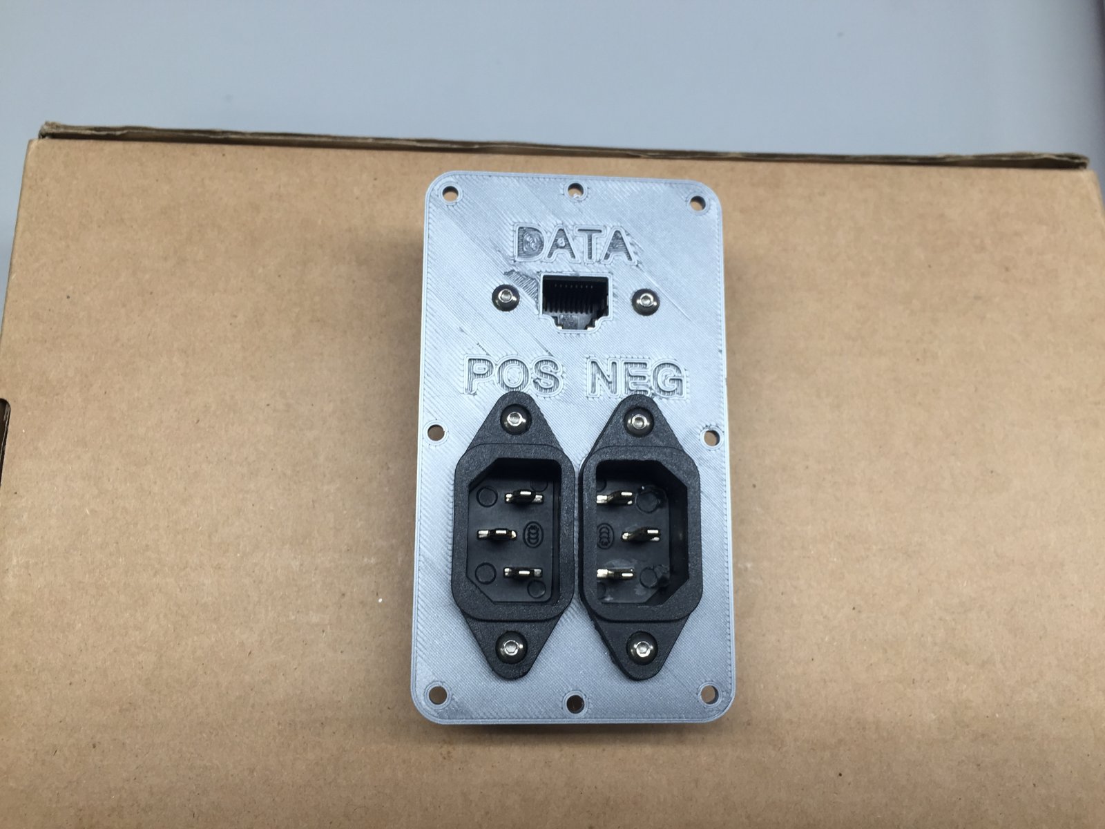

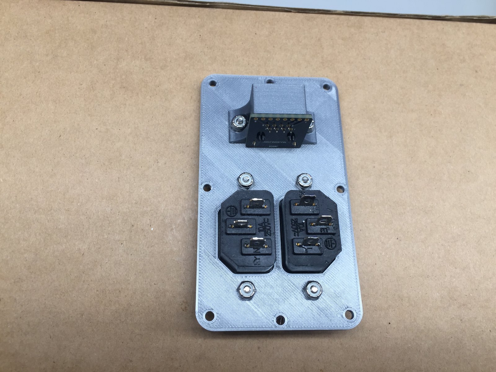

    Here is the new connector plate with the 2 iec320 receptacles and the data port. Not my best print, but it will work for testing just fine.
    I am planning on adding screw terminals to the Ethernet breakout pcb. I would like to go with 5mm terminals because I need to share the ground on 4 wires, That will require an adapter board though.

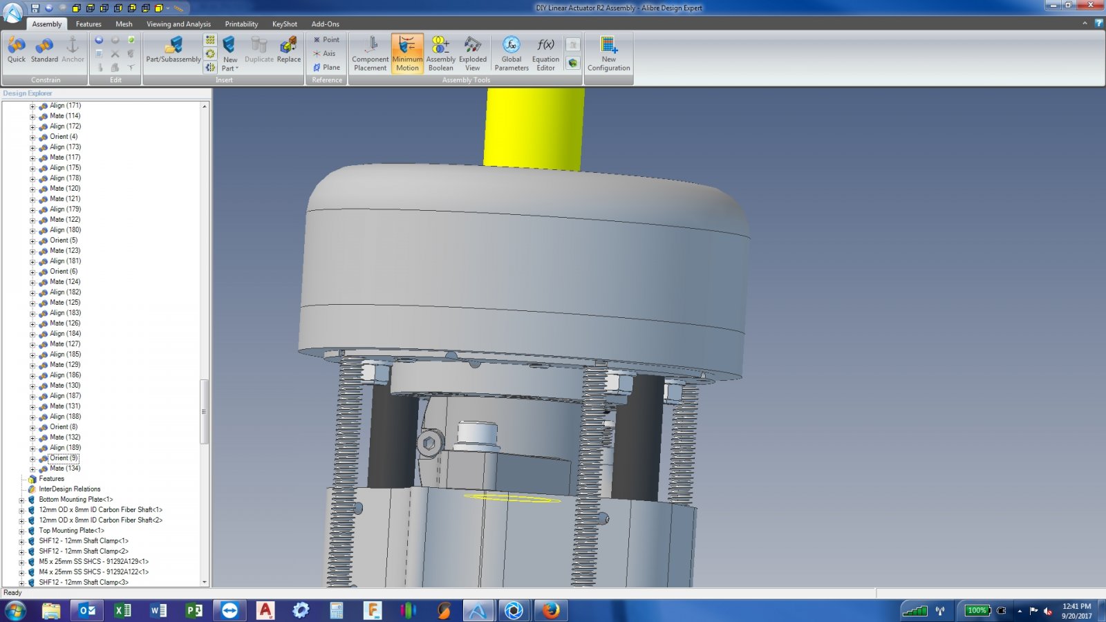

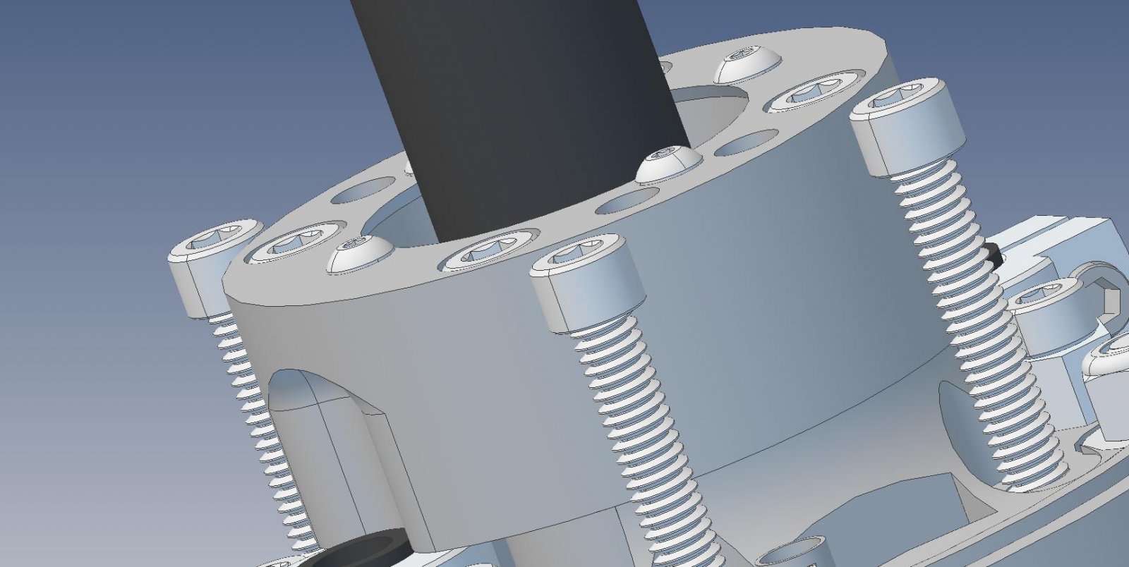

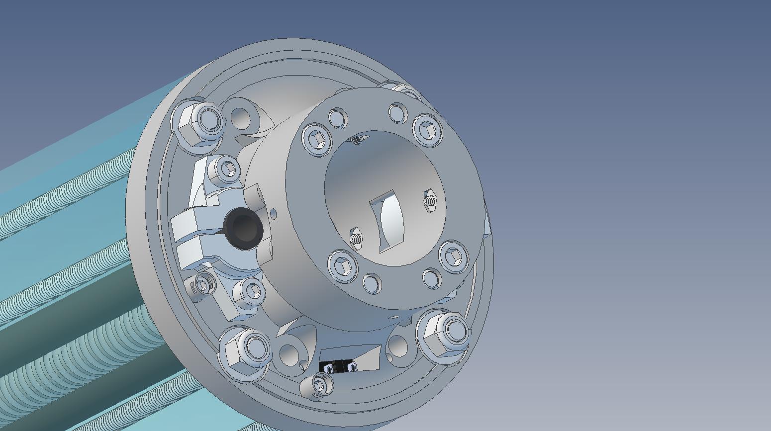

    Well, I printed out some parts with the new capture design and I really wasn't very happy with the results. I decided to go another route and added set screws to the design. The set screws will hit in the groove on the linear bearing and should be plenty to prevent the bearing from working its way out.
    I will have an printed parts with the new design soon

    What's about your first idea to have two screw from the top to fix the bearing ?
    This didn't work ?
    -kermit

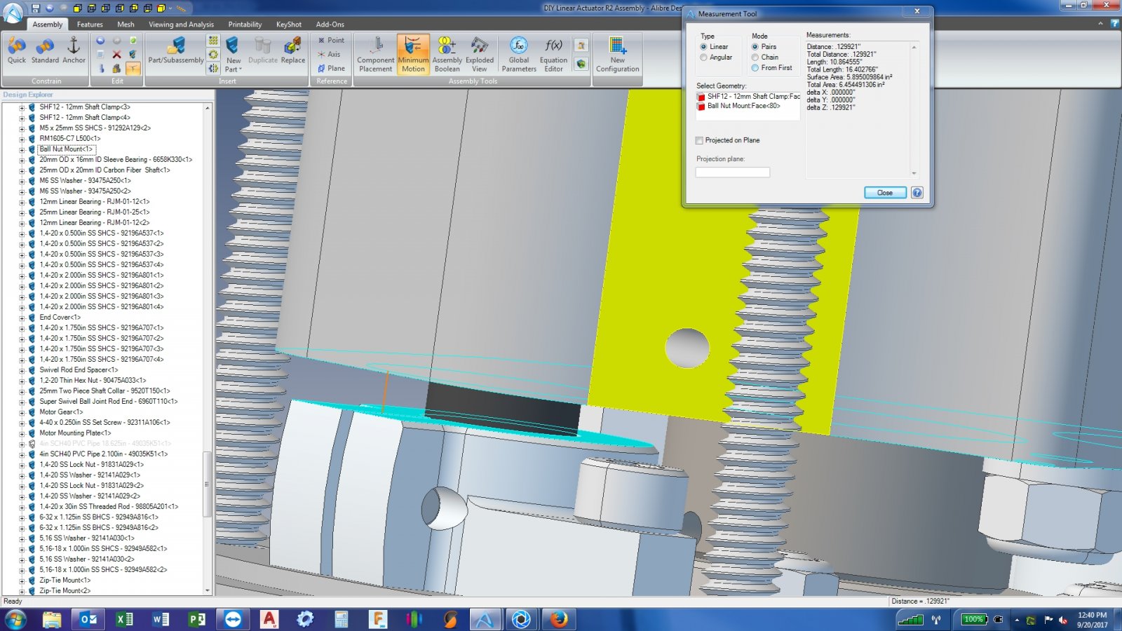

  18. Hoddem
    Hoddem Well-Known Member
    Sep 27, 2016
    404
    Engineer
    Minnesota, USA
    3,343Coins
    +717 / 2 / -0
    No it didn't work, I suppose its a limitation with 3d printing and would work just fine on machined parts or with modification to the design. On the 3d printed parts the screws were too close to the bearings and ended up compressing the entire bearing into an oval shape. I could have moved screws further away from the bearings and added washer, but I am running out of space and that design would restrict the movement slightly.
    I have 1/8" of space on the bottom of the ball nut mount, its a tight fit to get the retaining screw and washer into that space.
    on the large bearing any retaining screws on the bottom side will shorten the stroke by the height of the washer and screw head.
    in the end I decided to go with the set screw method, it should work and will be a little cleaner.

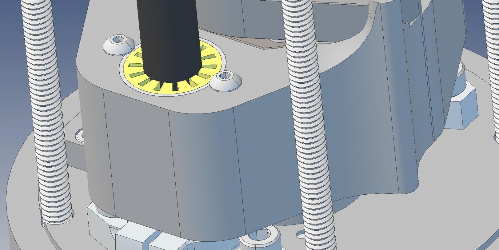

    I didn't see this, are you asking about the encoder or the limit switched?
    The encoder is from sparkfun COM-10932
    www.sparkfun.com/products/10932
    the limit switches are from Amazon
    www.amazon.com/PODOY-Micro-Limit-Switch-Hinge/dp/B0171G7HCY/ref=sr_1_1_sspa?ie=UTF8&qid=1505931496&sr=8-1-spons&keywords=KW4-3Z-3&psc=1
    I chose an encoder over a potentiometer because I will be using a kangaroo driver and I have read on the forums that the kangaroo just works better with an encoder (also encoders have unlimited rotation). However, that being said I may end up going with a kangaroo on my racing rig which has potentiometers so hopefully that's not entirely true.
