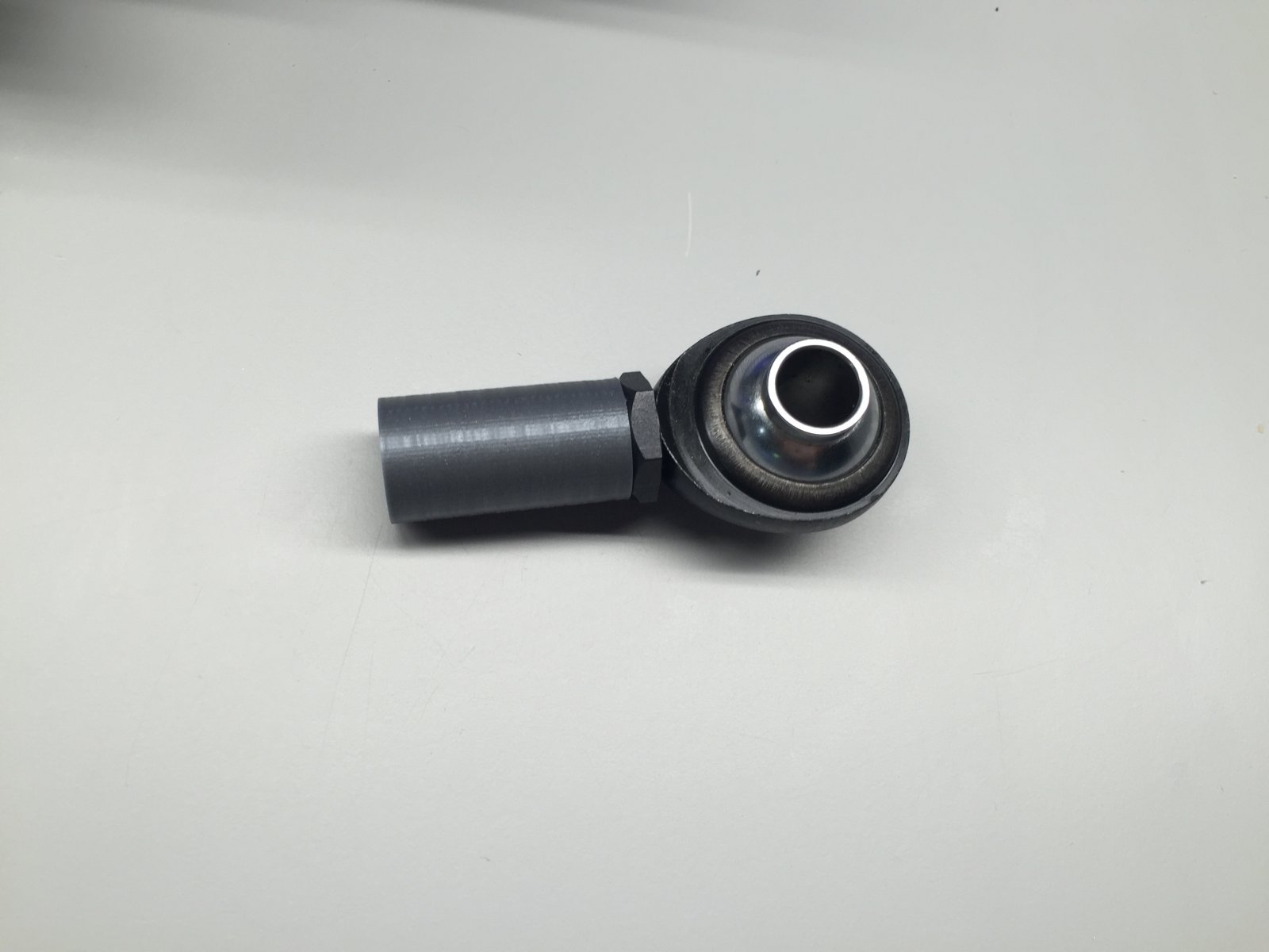

    I printed off the adapter for the swivel to mount in the end of my carbon tube. I added a nut at the top to stop the swivel from migrating into the carbon tube, I may add a washer to give a little more surface area. I'm making the assumption that the actuator doesn't need a lot of pull force, but I will test it to see what its capable of.
    I'm not sure how much help the shaft clamp is providing being that the carbon tube is so strong. The adapter is a snug fit so I would think a little epoxy may be all that is needed or I might cut a slot in the carbon tube to allow the clamp to provide some squeeze on the adapter.

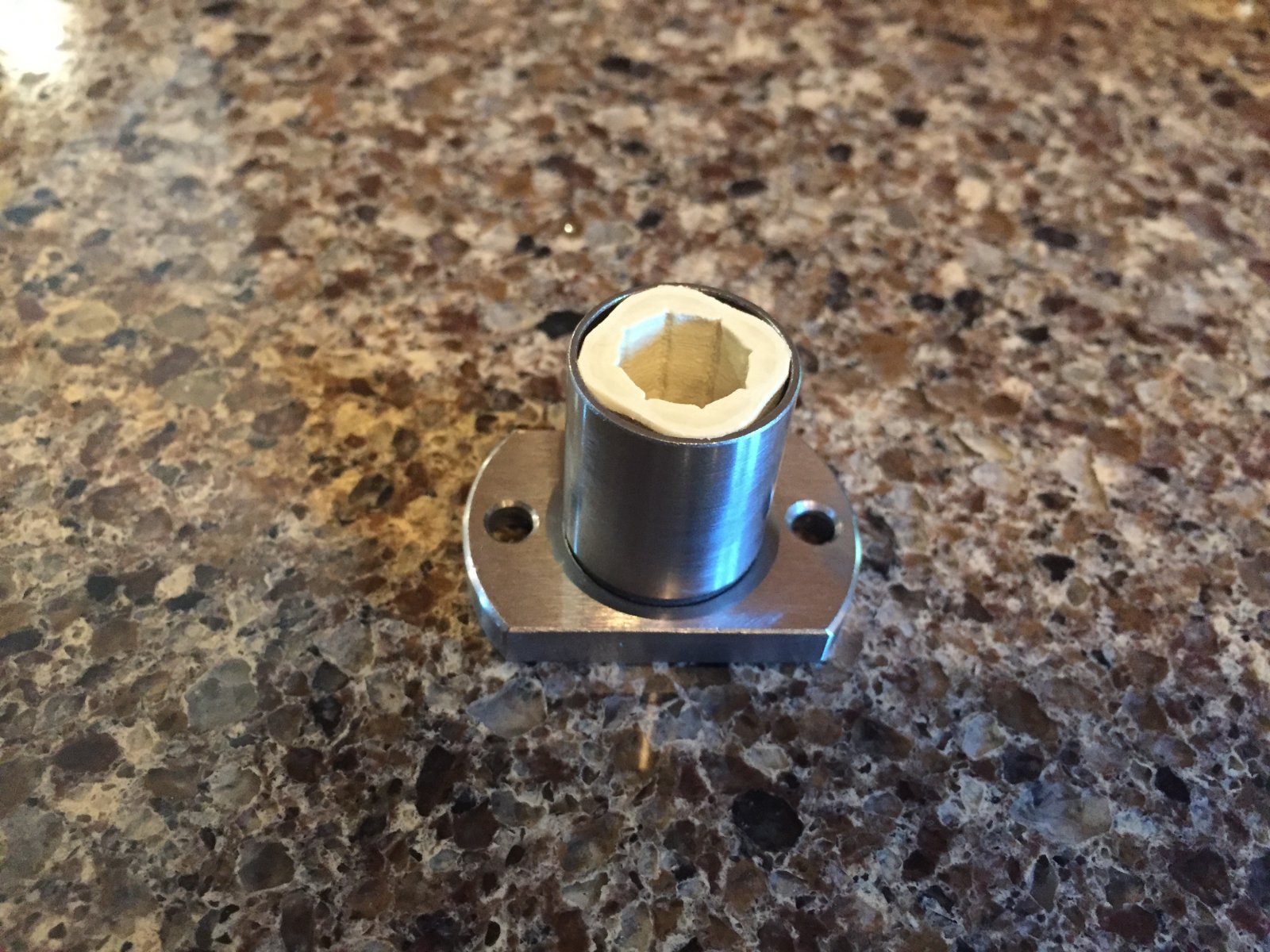

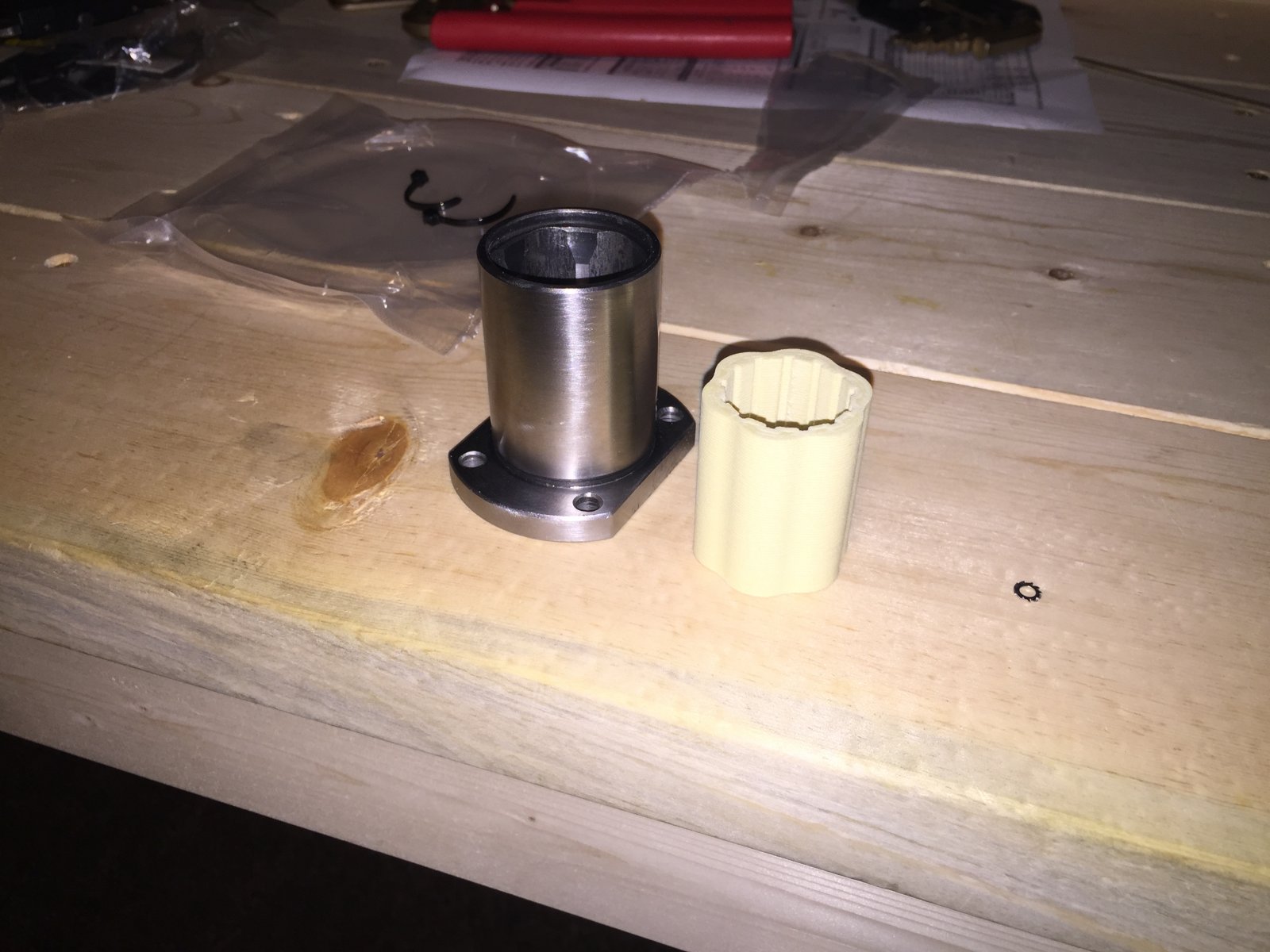

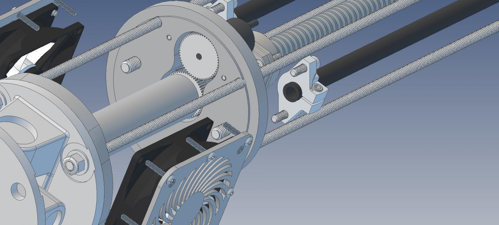

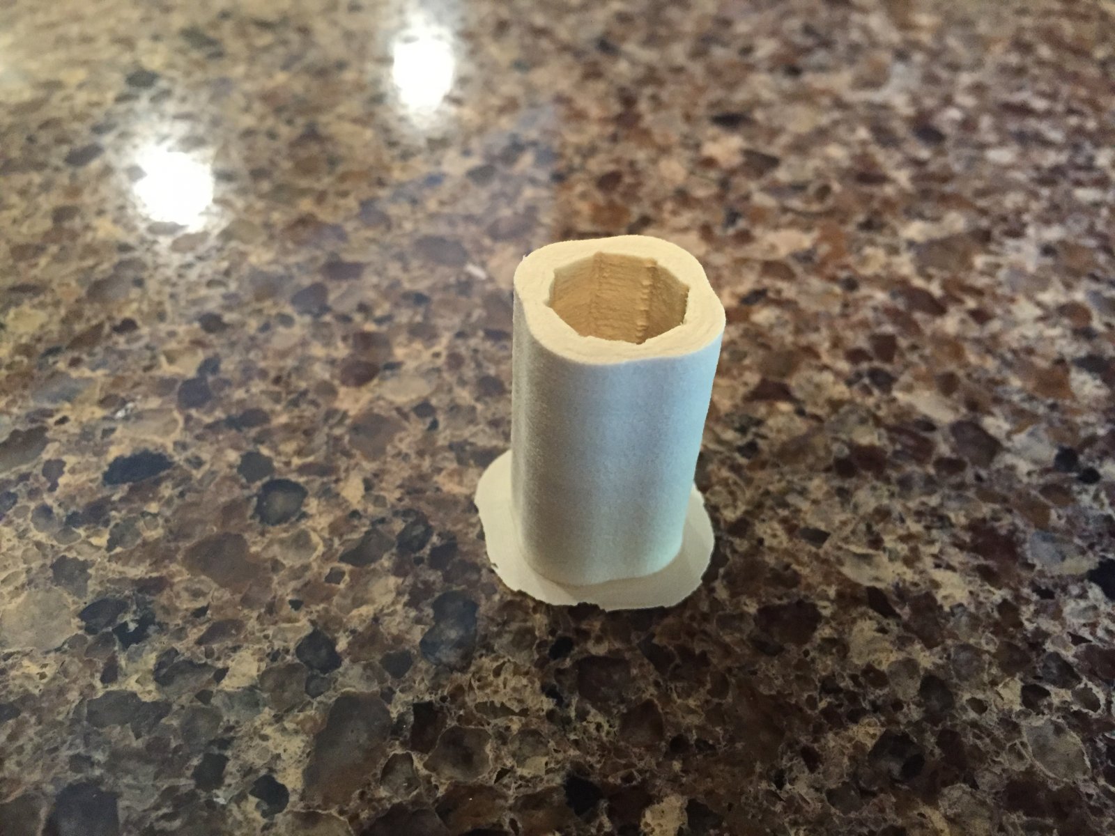

    I had a little time over the 4th of july week to keep playing with my actuator design. Most importantyl I had some time to work on the 3d printed bearings and learned a lot of hard lessons. I started off trying to print the J260 material (which IGUS lists as the most dificult to process) on my monoprice maker ultimate, absolutely no go. I couldnt get the material to flow very well and it wouldnt stick no matter what I tried for a build surface (build Tak, blue Tape, Glass etc.). I switched over to my prusa MK2S and struggled until I pushed the temperatures to the absolute maximum of the prusa (295 Extruder and 115 Bed) then things started working a little better. I was able to print all three bearings, two 12mm and one 25mm using the three sample packs of material IGUS provided.
    The parts came out pretty rough and required a ton of clean up, also I had to print a lot of them to get the fit just right in the bearing holder and on the carbon fiber shafts. Also I would print two identical parts off the same print file and the fit would be completely different between the two. the parts just dont seem to hold the same precision as the pla parts I have made in the past. All in all I think I will give up on the idea of 3d printed bearings, because most printers cant handle the temperatures required to print this stuff and that defeats the purpose of the project for me.
    The parts that I did make will work and look pretty good in the end, but I wouldnt want to got hrought this process six times over for a whole rig build.
    To get the 25mm bearing printed I actually had to print it in two sections becasue without an enclosed printer the part would cool down and eventualy seperate from the build surface.
    So I spoke with IGUS and disclosed my frustration with the material and of course they recomended using their flange bearings (the same ones most guys are getting free samples of) but I want to keep the project cost down and also not have to rely on free samples. If someone wants to repeat my buid and can't get free samples that would be several hundred dollars extra. In the end IGUS is sending me standard poly bearings in 12mm (RJM-01-12) and 25mm (RJM-01-25) to test out. I will be redesigning my system to eliminate the chinese flange bearings completely and print my parts to house the IGUS poly parts directly.
    This is a bit of a setback as I had all of my parts for that secion of the actuator completed and ready for assembly.

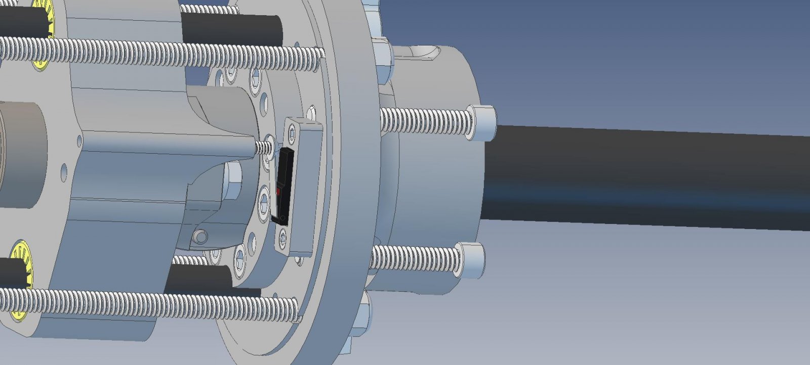

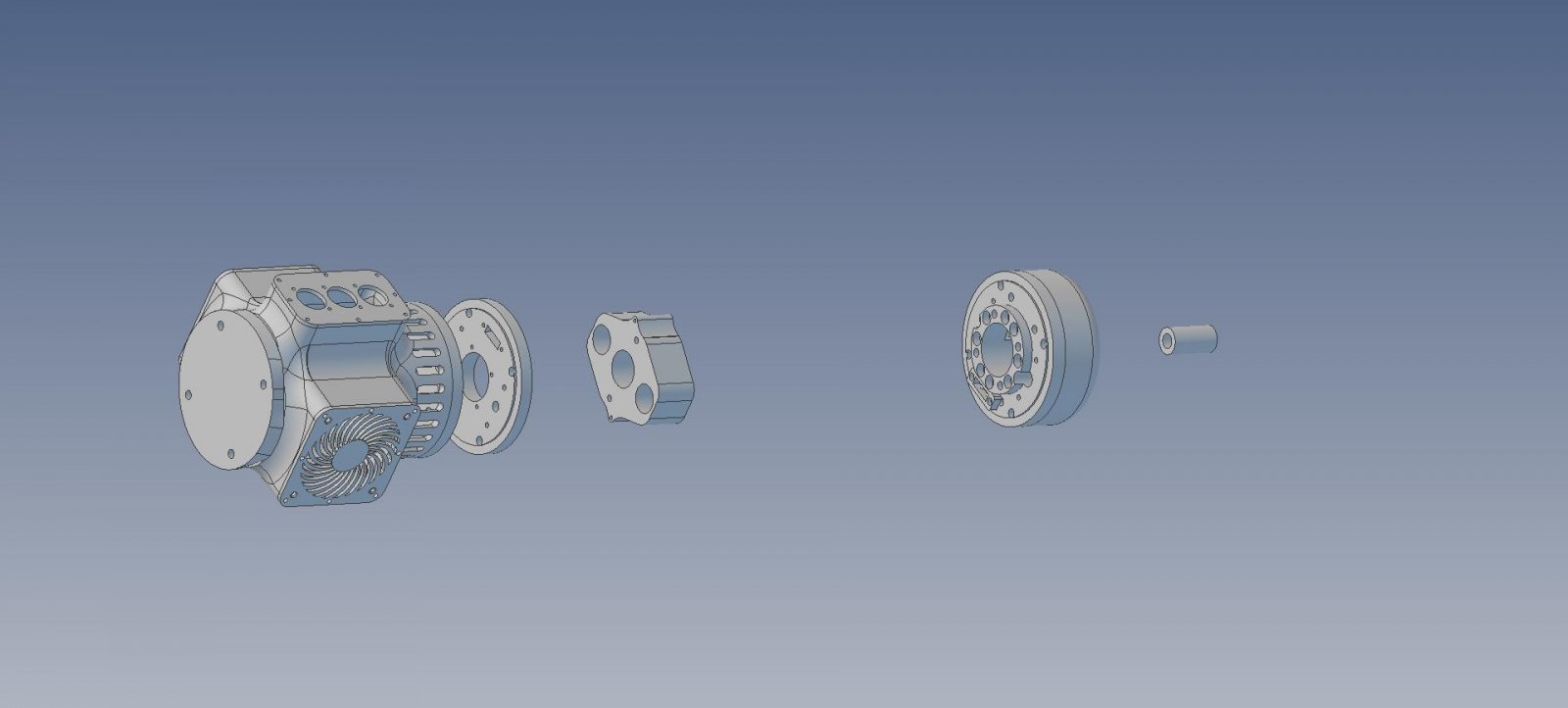

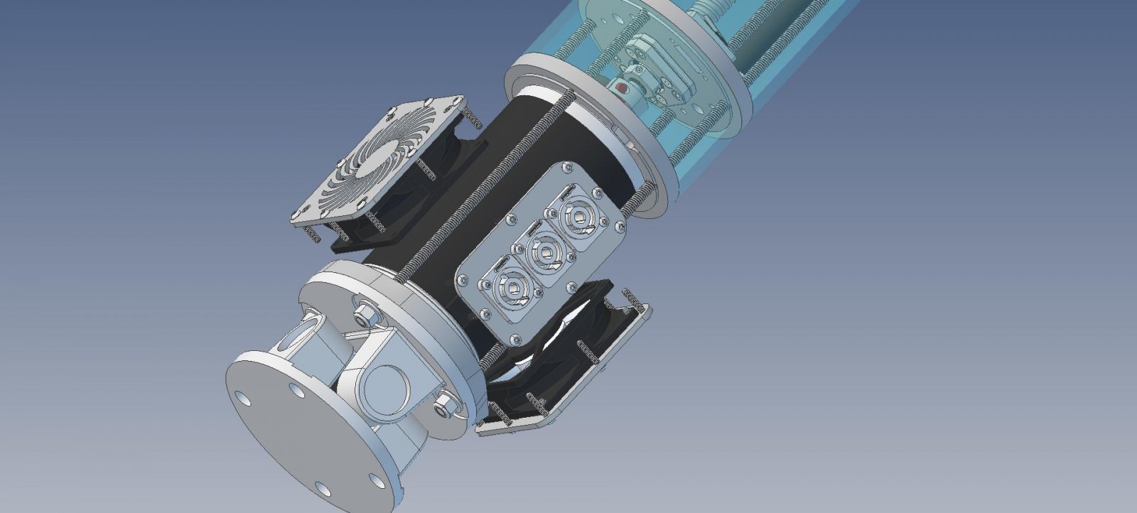

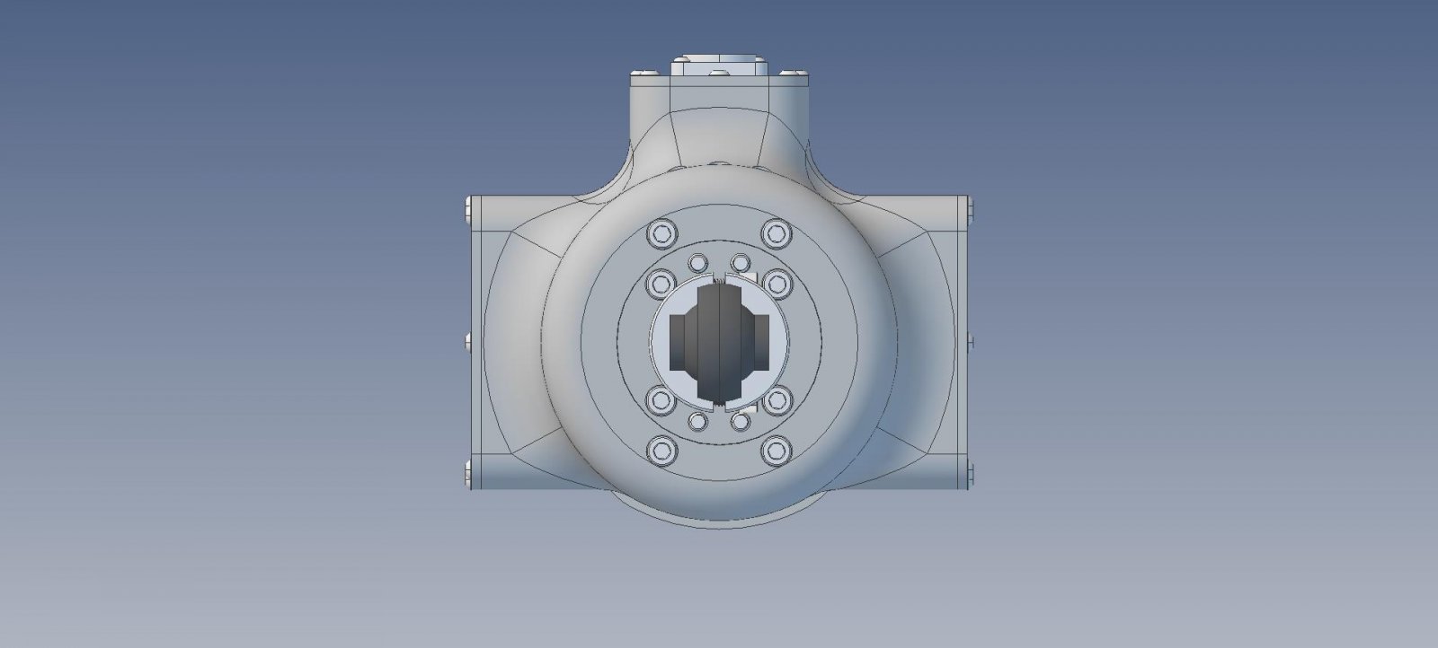

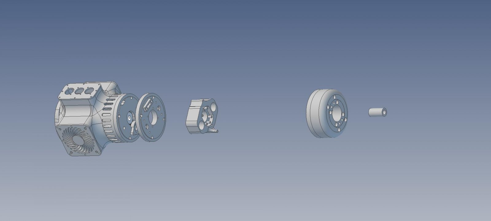

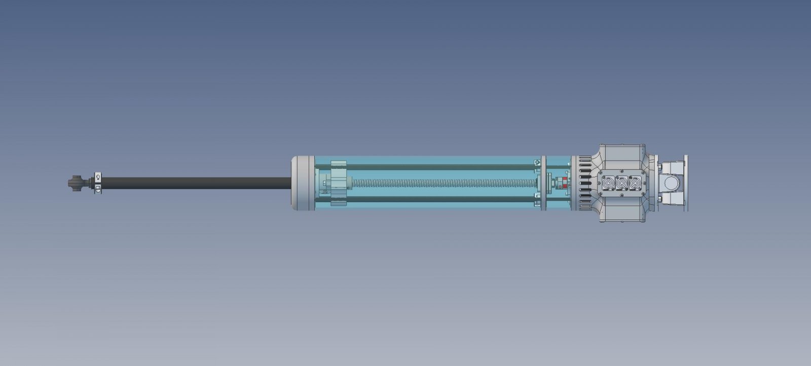

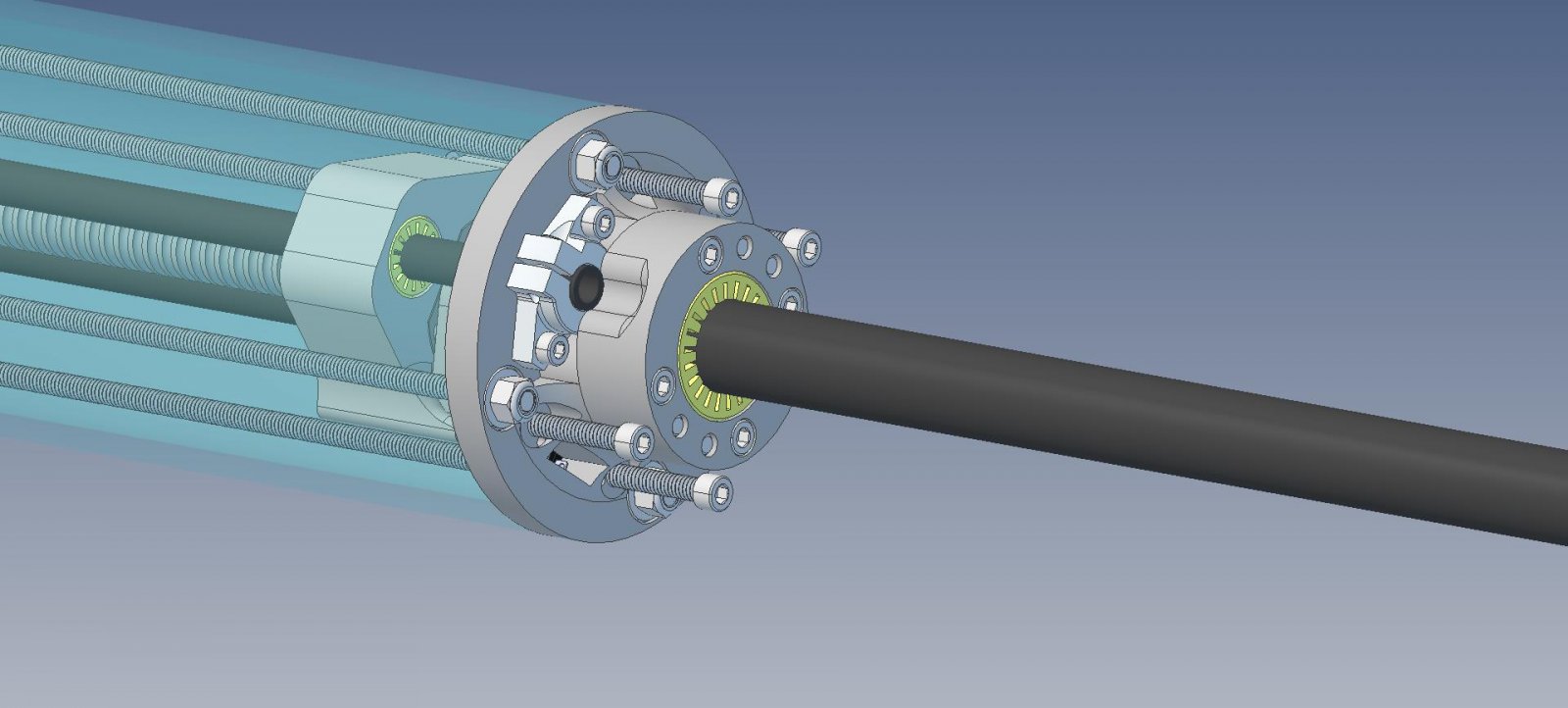

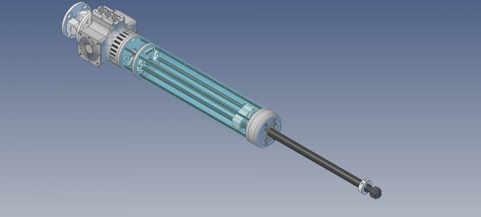

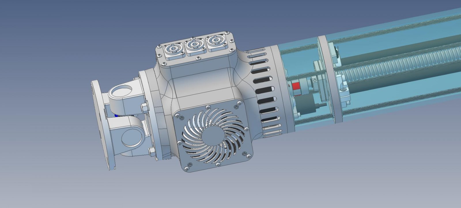

    I finished my 3d model utilizing the IGUS polymer bushings instead of the 3d printed ones. I will start printing everything today, but it will probably take a week to get all the parts made.
    Here is the link to the 3d model on GRABCAD
    https://grabcad.com/library/hoddems-diy-linear-actuator-r2-1
    here are a couple of shots of the new design.
    DIY Linear Actuator R2 Assembly 7-14-2017-2.jpg DIY Linear Actuator R2 Assembly 7-14-2017-5.jpg DIY Linear Actuator R2 Assembly 7-14-2017-4.jpg DIY Linear Actuator R2 Assembly 7-14-2017-6.jpg DIY Linear Actuator R2 Assembly 7-14-2017-7.jpg DIY Linear Actuator R2 Assembly 7-14-2017-8.jpg

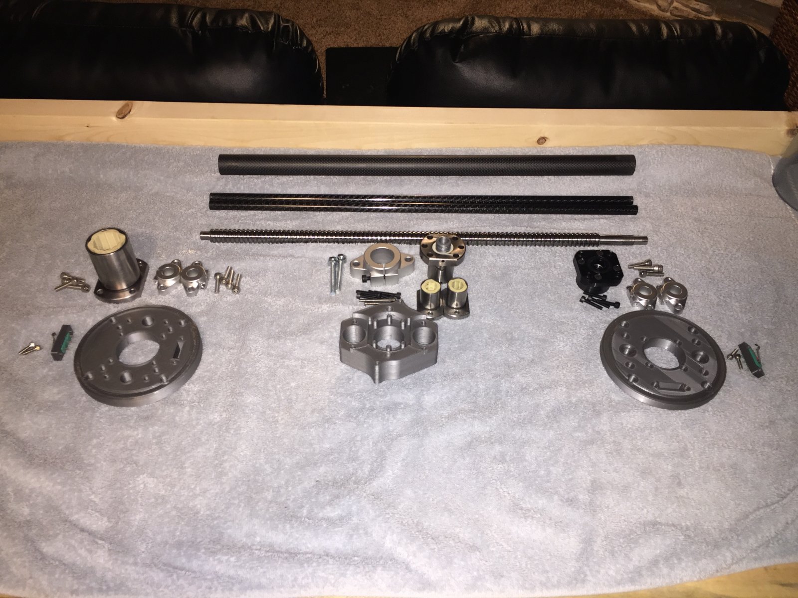

    A couple of pictures of only the 3d printed components.

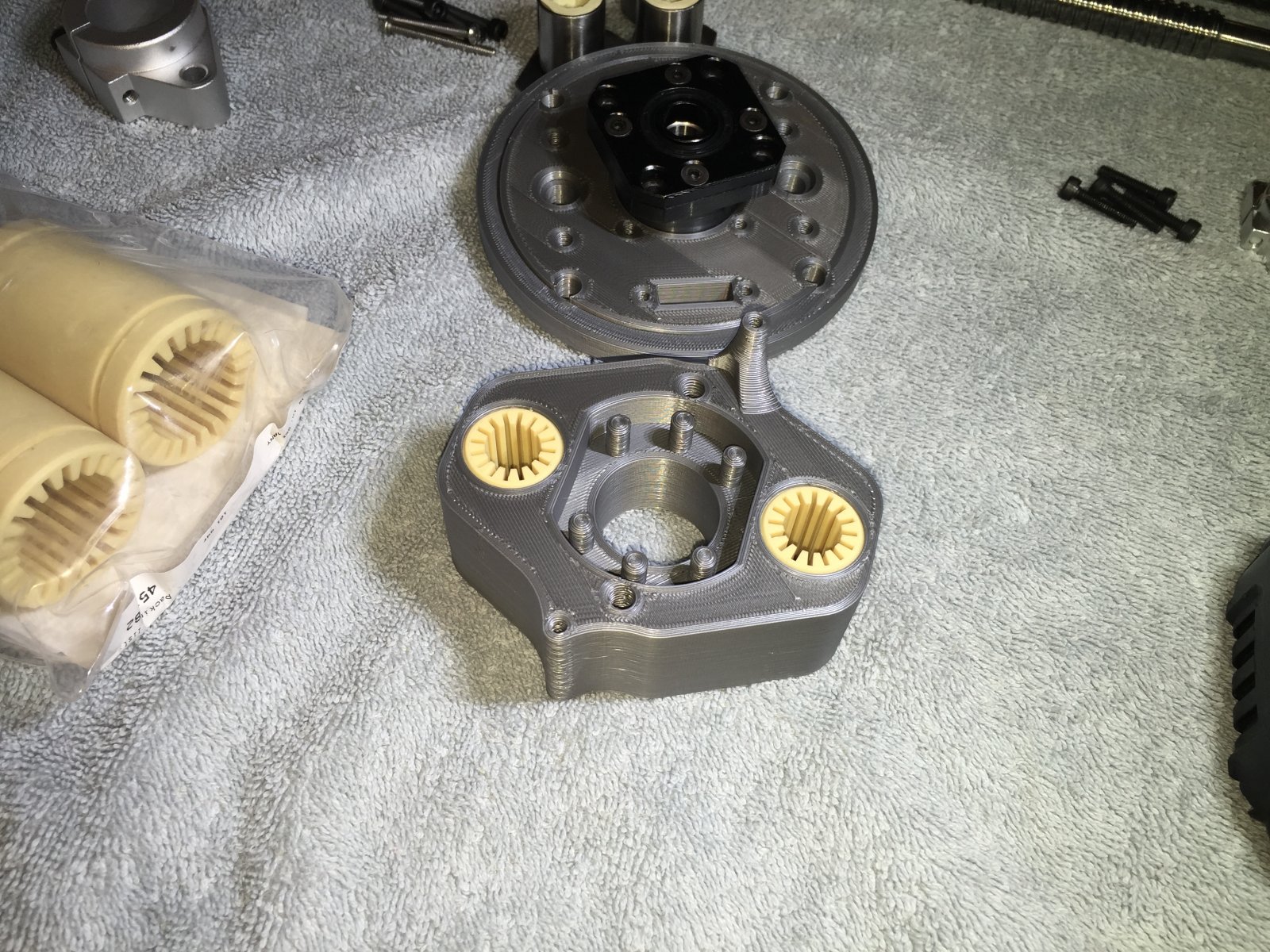

    First part off the printer (since the design change).
    The bearings are designed to be pressed in and are pretty loose fitting until they are pressed into the correct housing size. I was a little worried that the 3d printed part would give and the bearing wouldn't be pre-loaded correctly, to my surprise the fit on the 12mm shaft was about perfect. I just used my bench vice to press these into place and they went in pretty easy.
    I'm printing the housing for the 25mm linear bearing now, if it works out this is a much easier method and cost will be about the same because I don't need to buy the Chinese bearings or the 3d print filament.
    These bearings are only about $6-7 each.
