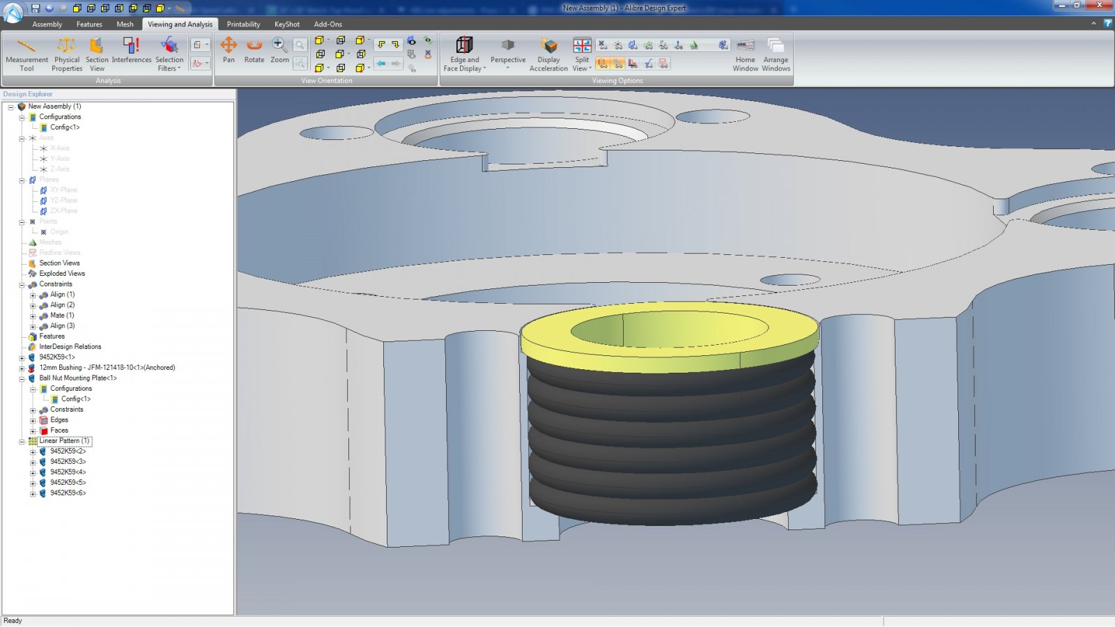

    I think I came up with a solution to the squeaky bearings. The way my actuator is assembled it might work with precision parts assembly jigs etc, but with 3d printing and hand cut parts I will never get the alignment of the whole system perfect. Usually in a system with multiple bearings some of them are fixed and others are floating to compensate for misalignment. Its going to be tough to float a bushing, but I think I can add some o-rings around the bushing to give it some float without losing too much of the intended function. I can run between 2 to 6 o-rings and try different durometers to tweak the performance. The design isn't finalized yet, but this is the general idea. I'm not sure how many I would need to float, at least 2 but probably all 4.
    The other problem is that my tube has some amount of out of square at the ends which will pull the actuator out of square when I tighten down the tension rods. I'm still trying to figure out a way to square the tubes up with my home equipment, but I may admit defeat and pass them off to a friend who has a lathe capable of such work. Another option would be to 3d print a jig, though I'm not sure exactly what that would look like yet.
    Right now the 3d printed parts are all at 20% fill, I am going to start re-printing the load bearing parts with a higher fill percentage (50% or more) so that I can do some load testing this weekend. I'm starting to think that for simplicity I might stay with 3d printed parts rather then aluminum.

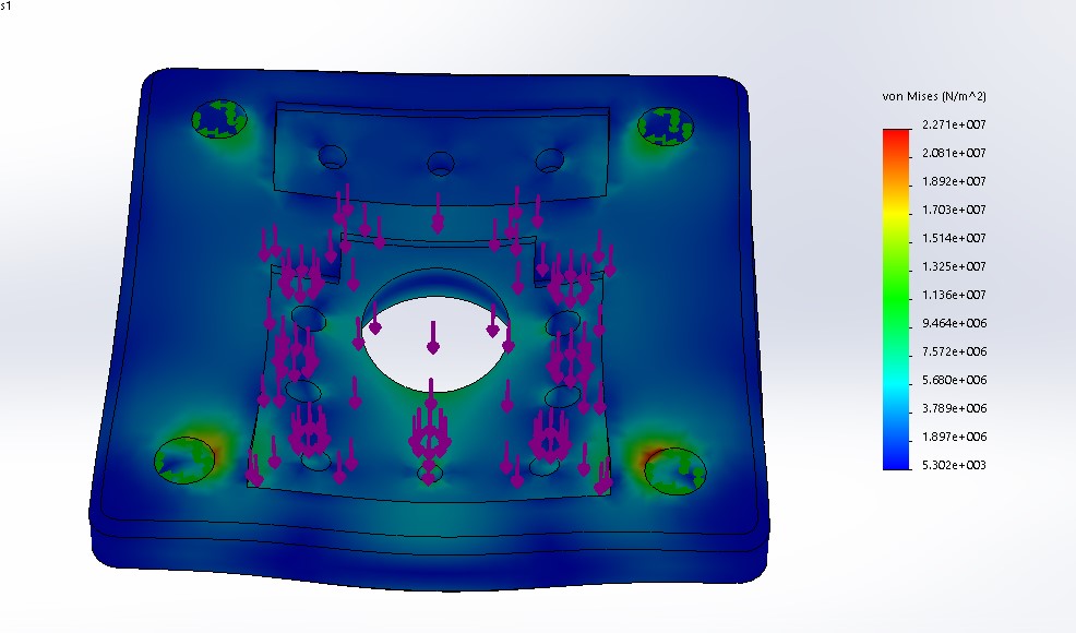

    check out petg 10 times the strength of pla. it is similar to abs, just not quite as strong but it wont warp on a heated bed easily.
    I put 1500 newtons x 9 on my centerplate in a simuation yesterday it bent but didnt break. im sure the part was ruined. i am going to run some more simulations for the assembly but so far in theory (simulated) the printed parts are very strong.

    If it’s 10 times stronger then I would bet it will stand up to just about anything. I have been trying to figure out a good way to strength test parts. I think I’m going to take on a little project to turn a small bottle jack press into a compression tester. Well see though, so many projects so little time. I’m just really curious how strong my 4” disc is and I would also like to test the pull out strength of printed threads.
    Pretty neat simulation, if I get my jack setup I will have to have you run a simulation of the same part I test to see how accurate the model is.

    I printed up my new floating bearing plate and mounted it up. I ended up finding some square o-rings and everything fit pretty well. After assembly I could already feel the actuator running much smoother when I forced it in and out. The squeak is gone, but I can hear the ball screw whipping inside the linear shaft, I plan on putting a 3D printer bushing on the end of the ballscrew, I just haven’t gotten to it yet.
