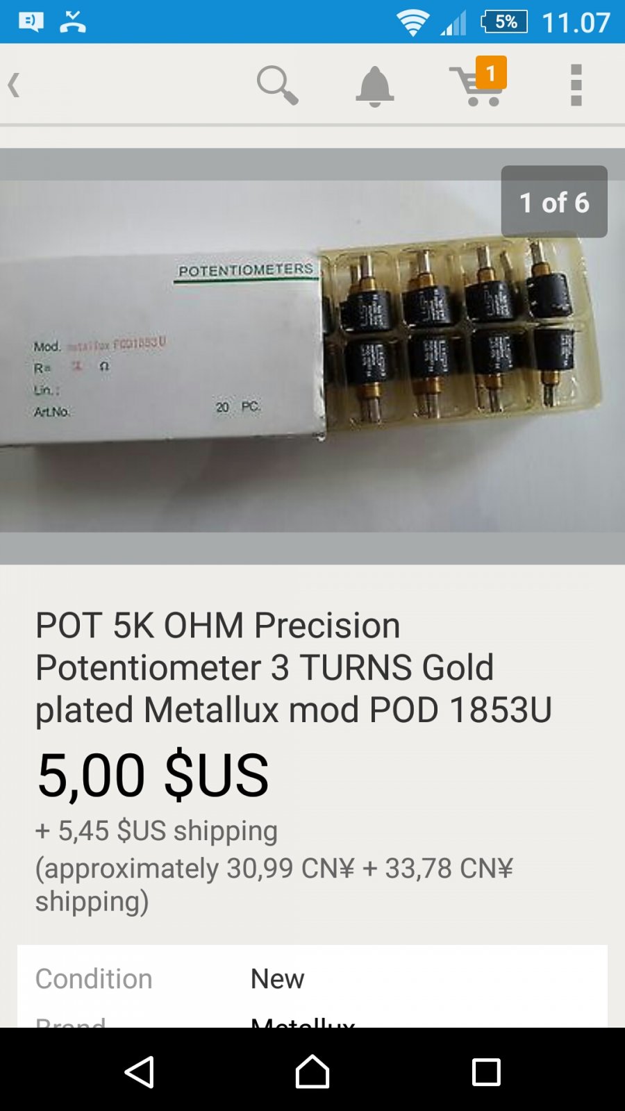

    I have ordered these pots for my rig,any objections? Will it do with the proper gearing?

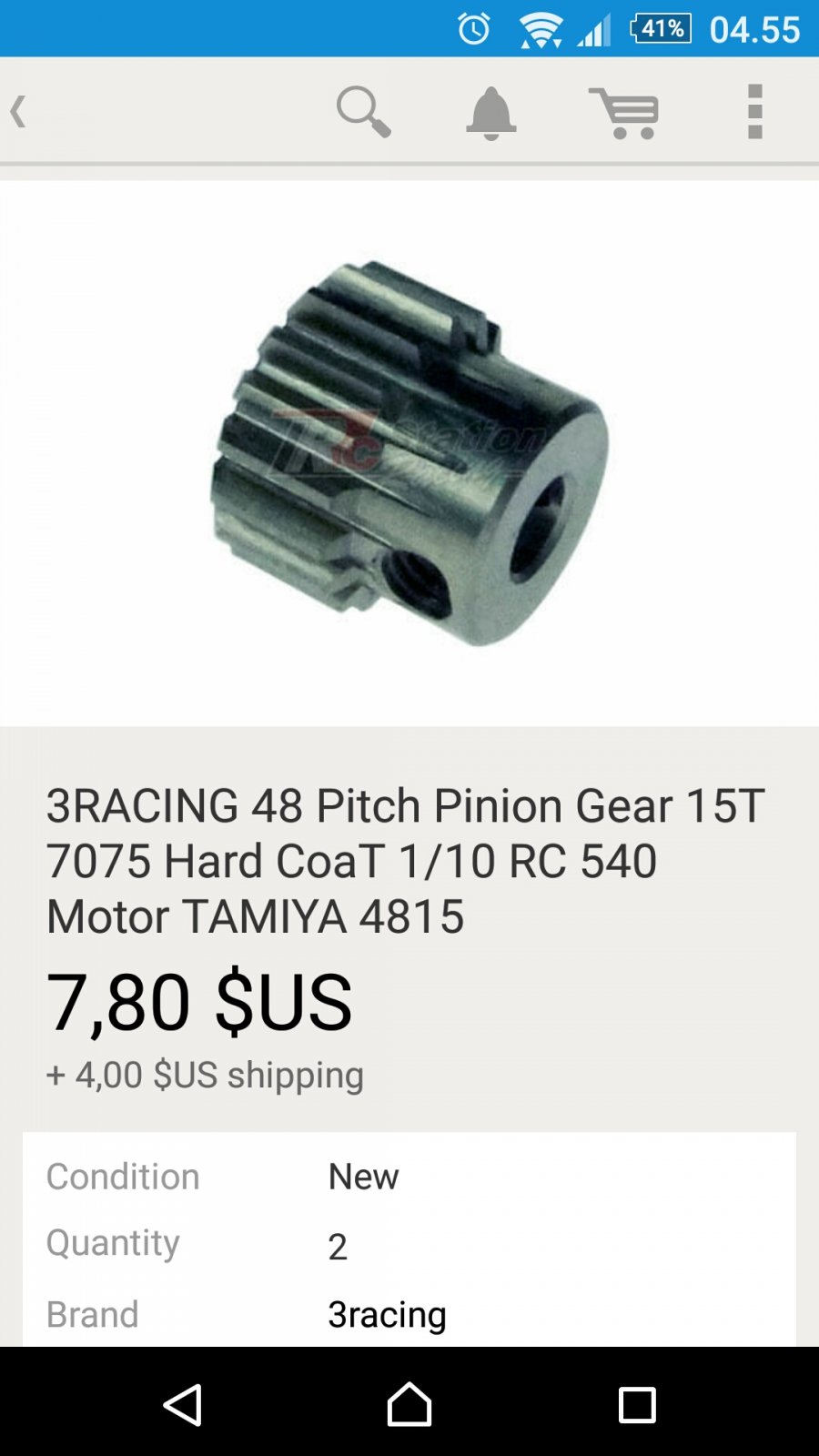

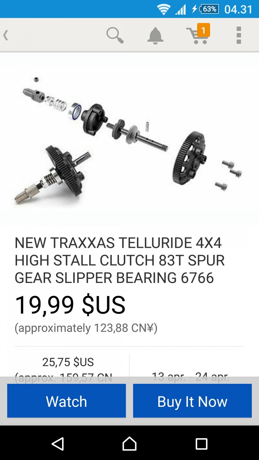

    I've found these gears on EBay, as you can see it's 15t and 83t,shouldn't that be perfect for a 3 turn potentiometer?There's also some slipper clutch I thought I could use to protect the pot's from over turn?

  7. bsft
    continuous single turn pot 360 deg, never breaks from overshoot.
    I used to use the gear method myself with 3 turn pots, until I moved to 360 deg pots.
    No need to use gears, connect the pot on the back of the motor shaft.

    But did you feel a difference, when you changed?
  9. bsft
    I could not notice a difference even in fine motion.
    Reason I changed is that it costs me $26 for 360 deg pot as opposed to $8 for gears and $35 for 3 turn pot, which could still break if it overshoots far enough.360 deg pot made sense for cost. Performance, negligible.

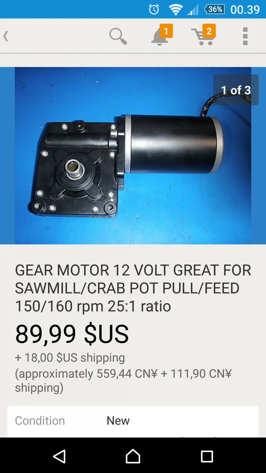

    Hi again, can someone show me a rig using the crap pot motors from EBay with the 25:1 gears?Please? Anyone? I would like to see what to expect, as I am waiting for mine!

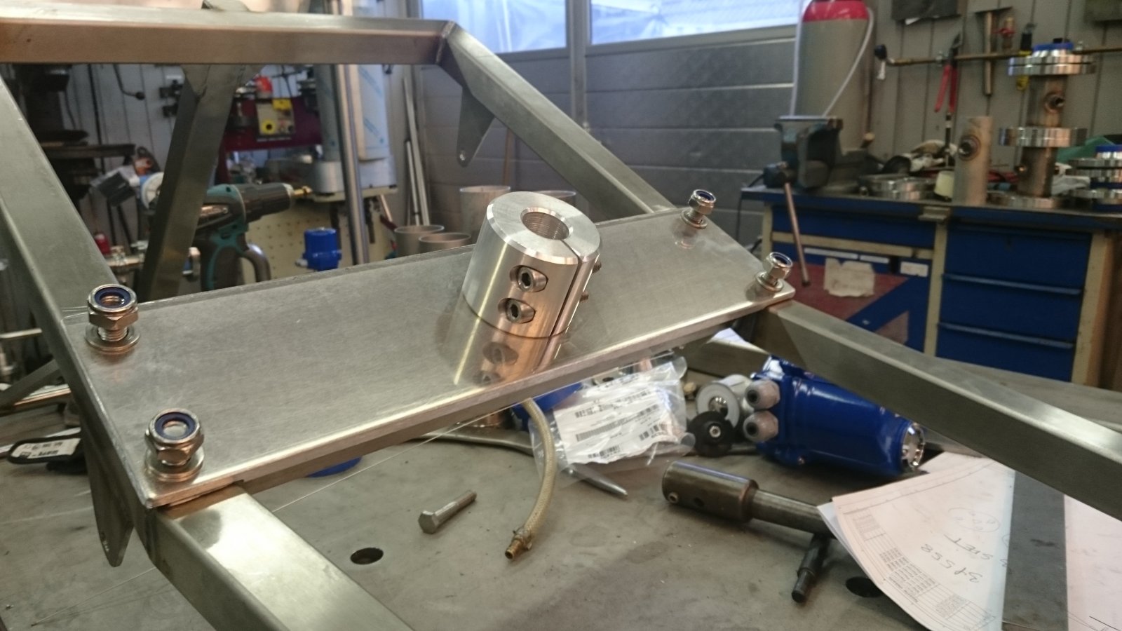

    DSC_0030.JPG Hi again,haven't been in here for a while, went down with the flu! Here's how I connected the mowing chair part to the base,all in alu to keep the weight down.

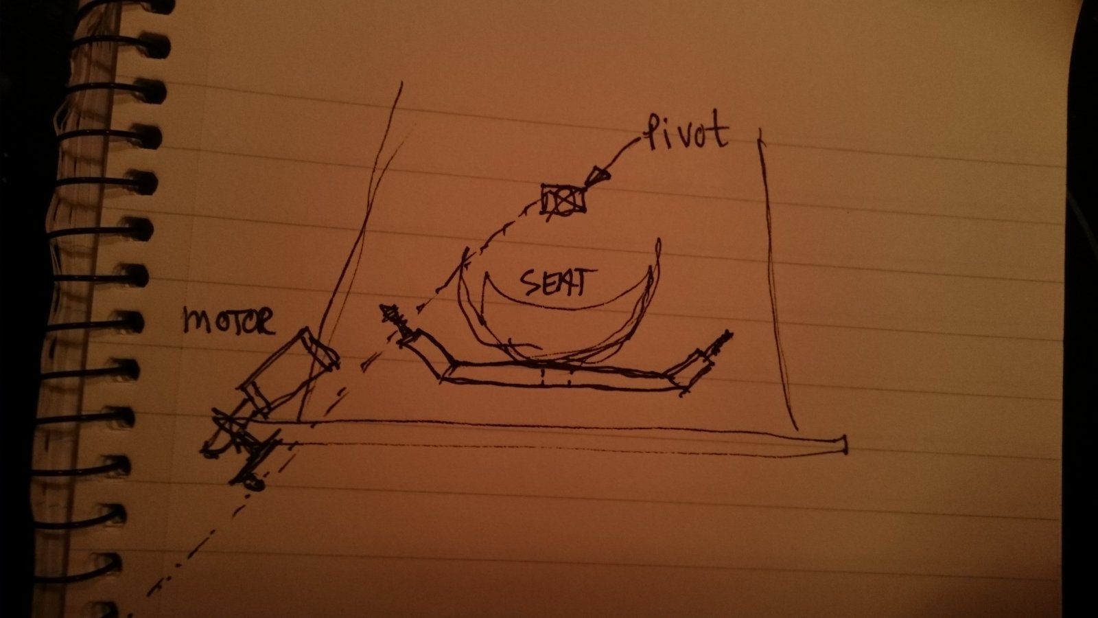

    Now,is there a best angel on push/pull rods?I'm mounting the motor brackets!

    2DOF, DC motor, JRK, Motion platform
    I was thinking,wouldn't it be the best to put motor and seatbracket mounting point in line with pivot,look at drawing! DSC_0032.JPG
