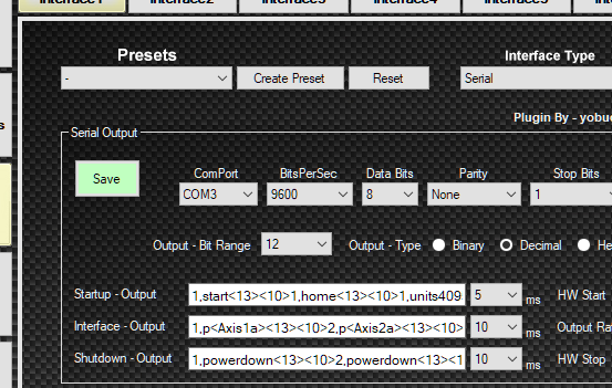

    Hi: Thinking about redoing my rig for the 4th time : ) using 3 axis now, but would like to go to 6 axis.
    what I would like to know is if I can set simtools to shutdown and lower my seat to near the limit switches, now the chair will stop where it is. If I can do this my rig would start near the ground and it would be like getting into a rig at ground level. Then when the Sim starts, it would find the 6 limit switches center normally. Then when I finish racing (shutdown), the seat will go back near the floor so I can step out instead of jumping down. : )
    These are my working settings for: 3axis, sabertooth, kangaroo2x and encoders,
    Startup and Interface are probably Ok, I just don't know how modify the Shutdown settings.
    INT 1 Com 3 ch 1 ch 2
    STARTUP: 1,start<13><10>1,home<13><10>1,units4095=5206<13><10>2,start<13><10>2,home<13><10>2,units4095=5383<13><10>
    INTERFACE: 1,p<Axis1a><13><10>2,p<Axis2a><13><10>
    SHUTDOWN: 1,powerdown<13><10>2,powerdown<13><10>
    INT 2 Com 5 ch 3
    STARTUP: 2,start<13><10>2,home<13><10>2,units4095=3815<13><10>
    INTERFACE: 2,p<Axis3a><13><10>
    SHUTDOWN: 2,powerdown<13><10>
    1 more thing. I can't find anything about these programming codes. nube. Is there a a manual ?

    I think it's like this,
    Startup:
    1,start: Starts the motor
    1,home: Finds 1 of the limit switches
    1,units4095=5206: Tells the motor to go to 50% after it finds the limit switches.
    interface:
    is the feed from the game
    shutdown:
    just powers down the motors where ever they are when you exit the game.
    Not 100% sure about all of this but it has always worked for me.
    I'd like to add the 1,units4095=5206 code so the rig puts me back at 50%. Just haven't tested it yet.
    I also need to know what I would change to get it back to sat 80 or 90% at shutdown.
    And yes, that is all the code I use to run the game.
    Hope this helps Pb

    Are you tuning with DEScribe?
    This is my setup

    Thank you for the photo. At home I will adjust some things, hopefully it will work then.
    Last time I tuned with DEScribe, Why?
