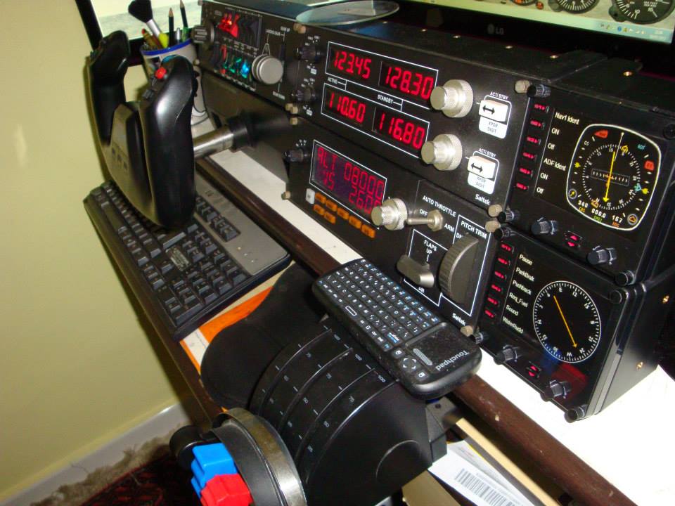

  6. silmar
    silmar New Member
    Sep 2, 2014
    25
    - 78Coins
    +9 / 1 / -0
    this is my simulator
    • Dislike Dislike x 1
