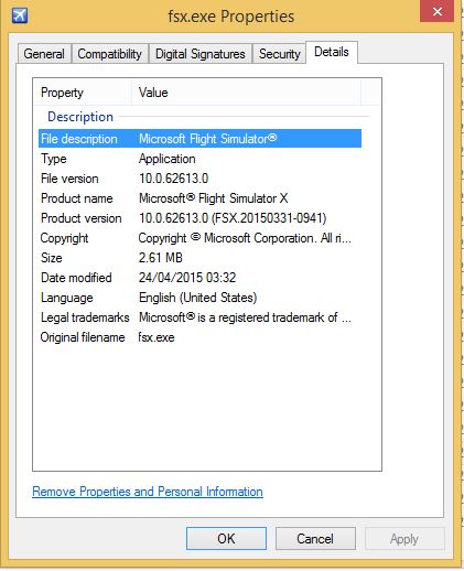

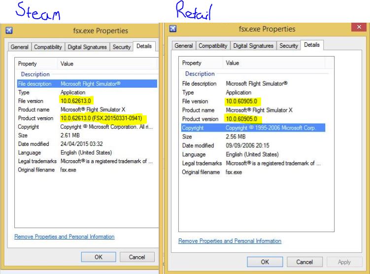

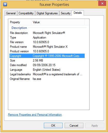

    Ok @value1 and @noorbeast.. I installed the Gold Boxed version on my C: drive (Steam is on my G: drive) and the Retail Version works as expected.
    No issues, I can see values in the Tuning Centre.
    The FSX.EXE for the retail is: 2,629KB
    The FSX.EXE for Steam is: 2,681KB
    They are different versions as well. Steam being the newer of the two.
    FSX - STEAM Properties (thumb)
    FSX - Retail Properties. (thumb)
    Seems a new Plugin is needed for the Steam version :(

    Side by side:
    21,597
    151,245Coins
    Thanks for that @Archie...pity they messed with it and broke motion support :(
