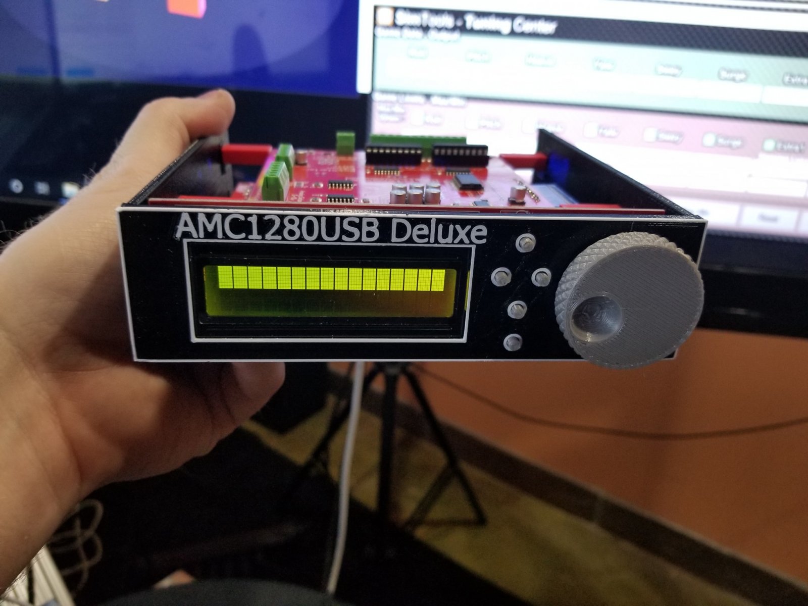

    Hi everyone,
    I've been lurking quite a while, but finally have been getting everything together to build a 6dof setup. I've been 3d printing a prototype, got my Simtools license, heXpod key and unpacked my AMC1280USB that I purchased back in 2017
    I plugged in the AMC to my computer's USB port and am only getting blank squares on the display. I was wondering if @Thanos or anyone might have a suggestion on what to try or did I just get a bad board? Being that this is a first hookup, I don't really have much to go on other than it doesn't seem like any of the various videos I've watched are showing the same display startup.
    Thanks for any help anyone can provide!
    Best regards,
    Dan

    Hi @Nisch funy you should post this , as I have just had the same Problem , My Fault and @Thanos has basically said the AMC is fine Just need to Reload the Firmware ... Its late now But I can Post the Email Instruction he sent me and it cured my Problem , Much to my relief
    Hi Calvin,
    The procedure is as this:
    1. Remove the jumper and press the reset button.
    2. Press the download button in the universal bootloader utility to start downloading the fimware.
    3. As soon the downloading starts, place the jumper back to B0 position.
    4. as soon the firmware is done downloading you are done.
    Just remember to unplug any devices from the AMC1280USB board (6DOF ext board included)
    Cheers Will post video links tommorrow

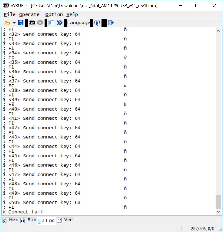

    Ok, so I downloaded the latest firmware per the link,
    Opened AVRUBD
    Loaded the enc_6dof_AMC1280USB_v3.5_rev1b.hex file

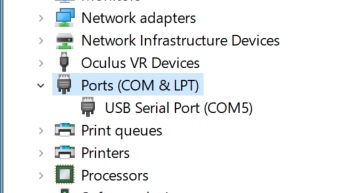

    Changed it to Com Port 5 (screenshots included)
    Removed the jumper
    Pressed Reset
    Started Download from AVRUBD
    From there, it ends up with a "x Connect fail" message after repeated "Send Connect Key" messages.
    Looking at the Atmega board, the LED's are flashing with every attempt.
    As per the other videos, I tried several times.
    Any suggestions? Obviously it's trying to connect.

    Disregard, I just got it to connect on my laptop. It's downloading as we speak.
    Fingers crossed!

    It worked! Thank you @wannabeaflyer2 and @Thanos
    You guys rock!
    That's a complete relief. Now I can get all of this connected.
    Thank you again,
    Dan

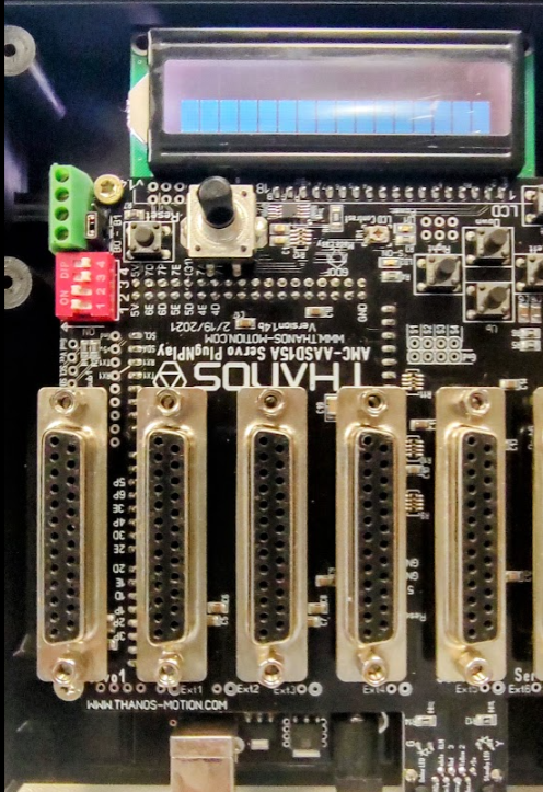

    I got the same issue as Nisch when I tried to update the firmware on my Thanos amc-aasd15a.
    Tried several times, but no success. I keep getting "connect fail".
    Any suggestions to get it working again would be greatly appreciated

    I assume you have in the background the motion software running... close it as it scans and takes over the COM ports from the firmware update utility..
    Also see latest firmware and instructions here.

    Problem solved.
    It seems the USB connector didn't seat properly.
    Enough to provide power, but not enough to transfer data.
    As I held the USB cable in place with my hand, the update ran without a hitch.
    Thanks @Thanos for your quick reply!
