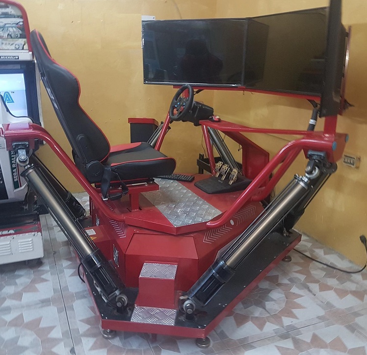

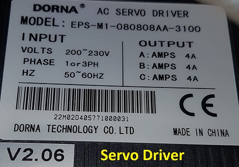

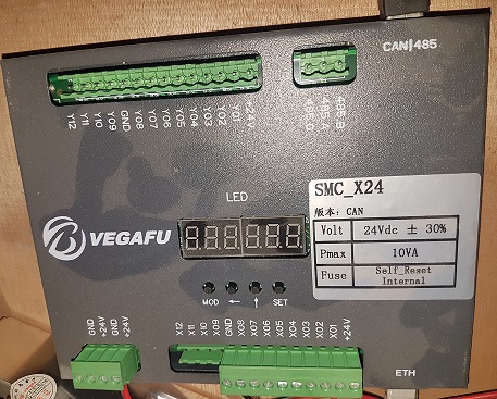

    hello good day I'm new to the topic I hope you can help me. A few months ago I bought a motion platform of 6 DOF in China but I really have no idea how to link it with FSX or Prepar3D, the only thing that is that if it includes the actuators, the drives, and the control board, I know that we have to Link to the PC through a network cable. which I already did but obviously I lack some onterface software and how it would add the values. I would be grateful if you could help me. I attached some photos of the platform and its components. by the way the drives are Dorna brand and the control board is VEGAFU attached the link

    control board VEGAFU SMC-X24

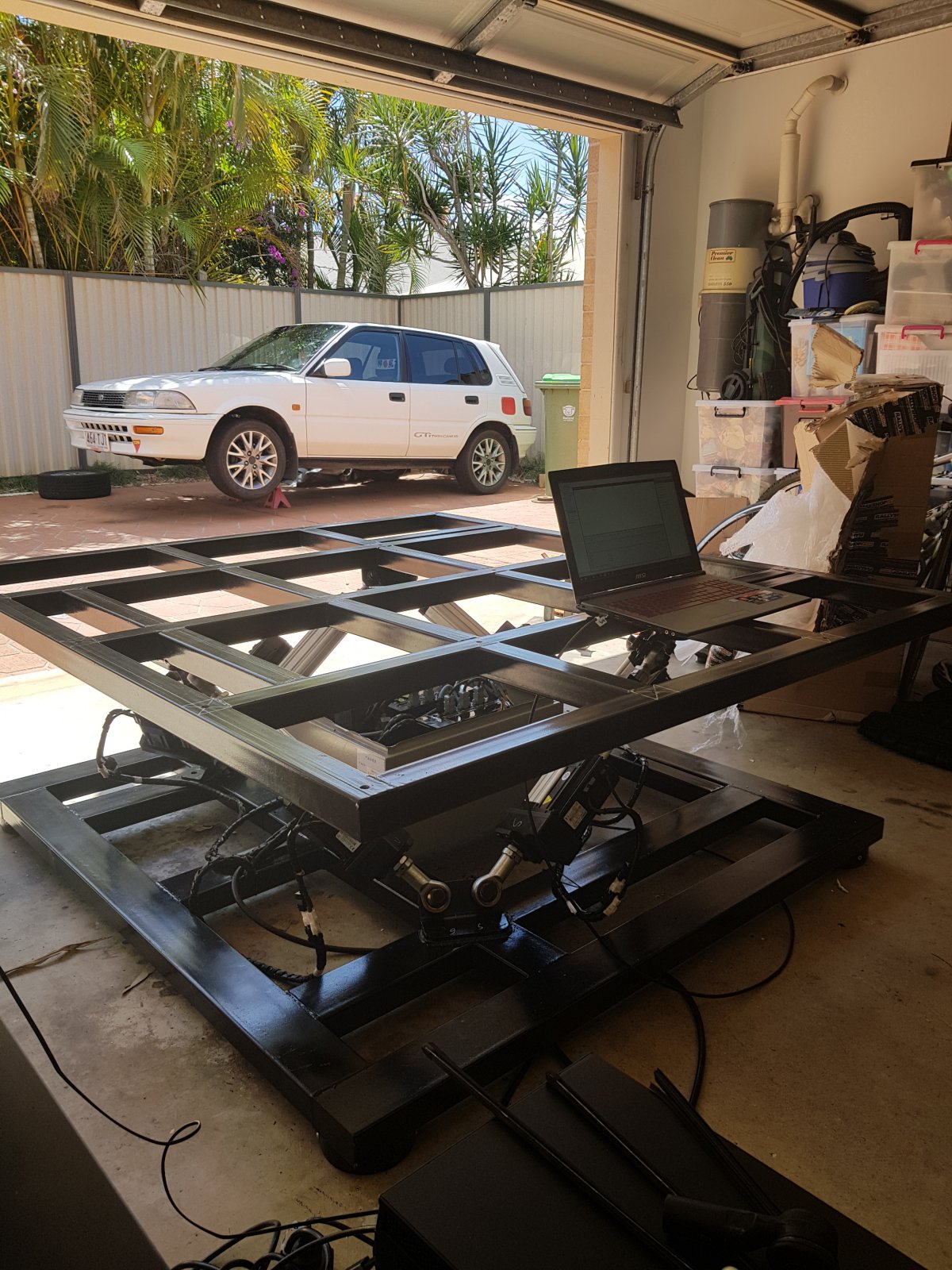

    The Vegafu controllers are not exactly universal unless you have documentation and are capable of creating your own interface and software. As it is it is only compatible with Pcars driving simulation as the Chinese software is locked to only that. If you have the Doma M1 servo motors on your platform, they can be controlled via their 44 pin cable with analog signals instead of over Ethernet with the Vegafu controller. This can be done to make it compatible with Simtools but you will just throw the vegafu controller away as it’s useless for anything else other than Pcars as a demo. Let me know if you have the Doma M1 actuators.

    Sadly not an option for me to toss the Vegafu. :( It looks like an older version of one of these VR pods. I'm friends with the owner of an arcade that has one and I don't think he'd want to break existing games to add support for flight sim.
    However, it has a bunch of VR "games" and movies that it works with out of the box, but no pCars. From the last time I poked around on it, some of the movies are just MP4 files (in a 360 wide format) so I wonder if they have a premade "script" the motion controller follows for these? (It has almost 100 experiences, so I assume that data has to be stored on the PC itself somewhere.) If that's the case, it might give us a way to hook into the vegafu controller code. I'll see tonight if I can get the info on the actuators.

    Do you have any working software currently? And if so what connection type does it use? The one I'm hacking away on uses ethernet port.
    A few things I've managed to suss out:
    -The SMC has a static IP (not sure if this is set or not?)
    -Commands are sent from the PC to the SMC every 50ms. (Even if there is no data change)
    -It sends three values: x, y, and z. Each are a single byte wide. (Therefore, in the range of 0-255)

    I'm sorry that i have to tell you this but the protocol on the PDF file you shared is not for the vegafu... it looks like its for some 3 axis interface xyz axis...
