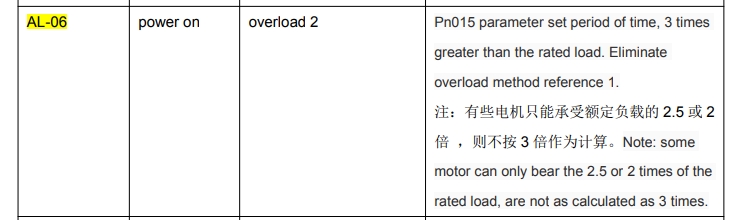

    Today, I tried to launch it again and the rig acted a bit strange and raised very high up and then all the server controllers threw the error AL-06 whenever I tried to move it with the SRS software (using Thanos4U controller).

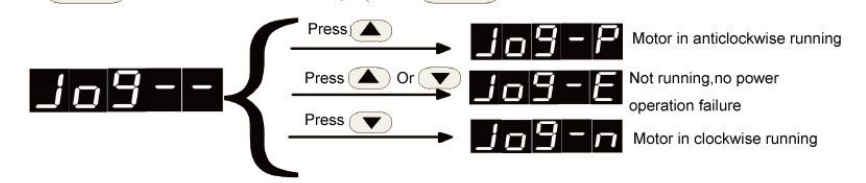

    I checked all the wiring and settings and then I realized that I can lower them all with the server controller's Fn002 Jo9- job function.
    I lowered 3 of the motors back to the ground. The last motor will not move and displays the error message on the servo controller: Jo9-E (e meaning error I believe).
    I took apart the actuator and tried just moving the motor and it throws the same error.

    The Thanos4U would no longer control the motors after they went into that very high position - it was very strange and when I tried they would make a small vibration and then all AASDs showed the AL-06 error.

    Something is wrong with your power, or you are loading too much your rig, or maybe the actuator mechanics are not well lubricated and create resistance on the slider inside?
    The AL-06 is overload message, that means the motor reached above 300% of its torque levels, for several seconds before it failed with that alarm code.
    As for the JOG-E it means the jog function could not run as the power was not present on the IGBT circuit or the Servo Enable signal was not active
    Maybe check the motor power cable wiring to see if anything is loose or the aviation plugs are not tight enough...

    Thank you so much - I will review all the electrical wiring and the cable connections to the motor.
    Since the motor is still not moving with the actuator disconnected and still throwing the Jo9-E error I'm assuming it is the power (per your suggestion).

    Well - problem not solved but the cause has been isolated.
    The cable running to the motor from the AASD is faulty - must have got damaged somehow. I was able to switch the cabling and the motor works perfectly fine.
    Much appreciated - I have reached out to the supplier to provide a replacement cable and I'm going to be ordering longer cables soon anyway.
