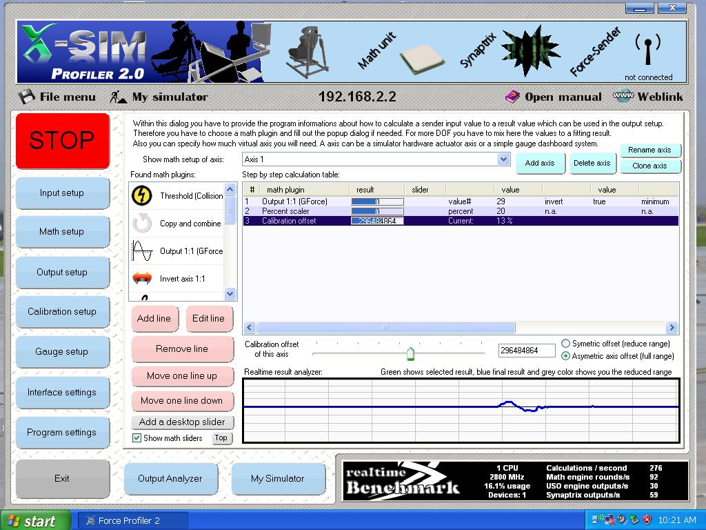

    I've been building a JOYRIDER type of simultator with two wheelchair motors for propulsion, and a AVR 1.5 and 2 Pololu high-power motor drivers 24V20 to power them. Also I've been using Flight Simulator 2004 to get started. Right now, I've been working on the X axis. The problem is, that when I do a two minute turn, lets say to the left, half way through the turn the simulator changes 180 degrees and does a flip flop to the right, the same thing occurs to the right hand turn. I've done a number of things to try to remedy the situation...to no avail. What do you suggest? Any help is appreciated.

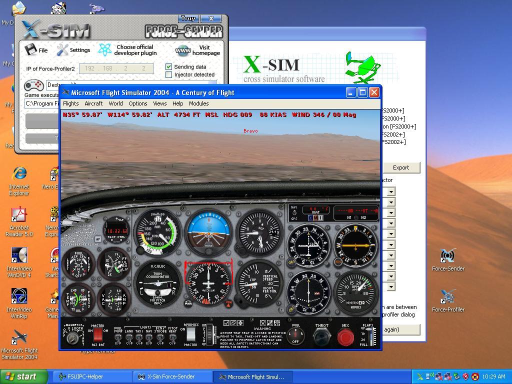

    I loaded up X-SIM3, just as you (Tronic) suggested. And I've got the same problem previously described. In addition I just lost communication between my computers (2) and the sever and the game suddenly ended. It took my hours to resolve. Is there no way to get this played offline?

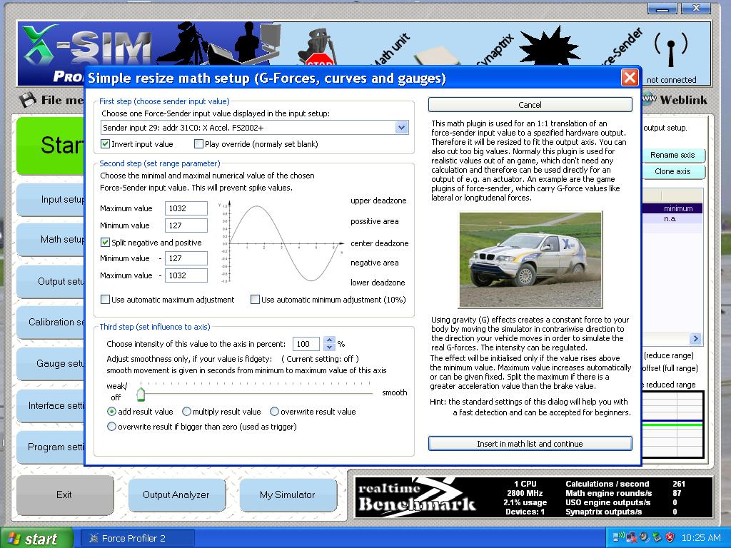

    Do you have a x acculation effect .have the Play Not a x Position effect?i mean it is better but iam Not a flight man.

    I'll look to see..., X Acceleration is what is listed. Effect #29 addr 31C0 X (lateral)Acceleration [FS2002+] is what I have been work with. I've been told it is better to work with Effect, one at a time.
    I think I have resolved the situation (thanks to Nima). I scanned the table of all exportable elements and found an obscure input called 057C /Bank /var.Type S32 it seems to do the trick. I wonder why that was not listed on the EFFECTS page on the Pete Dawson's FS Modules page, that would be the first one I would place on the page followed by pitch. But who am I, to question such things. Once again thank you NIMA!!!! :cheers:
