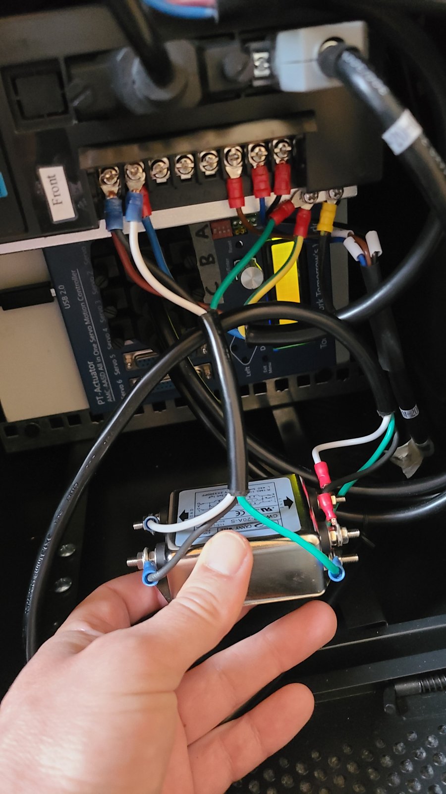

    On in this case you need to add a line filter on the power lines that end up on the AASD-15A servos, to block EMI noise go back through the lines and reach your other equipment:

    I had a chance to to watch this and do some testing. I was able to at least make sure the ground loop was not the issue (thank you, I looked it up). After watching the video on this inline filters I think I am going to order them. Look easy to install and designed to solve the exact issue. As always you all rock!

    Going to try to install this tomorrow. I will let everyone know the results.

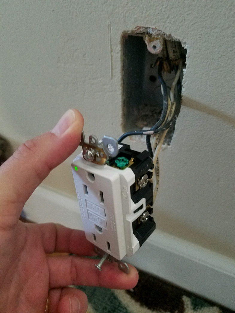

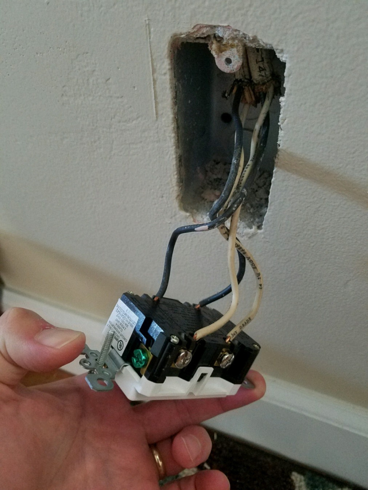

    No go, when ever I add the ground it blows the gfci on the wall. With or without the EMI box. When I received this I did not have a ground to the wall. I watched the video and matched the wiring. No luck. Any thoughts? I still get the emi "whine" and the ground is causing an issue. I must be missing something.

    I don't think its good idea plugging device with load like the servo drive on GFCI wall outlet. They are particularly picky when it comes to power they deliver and sometimes may hide nasty surprises like my old house that had no ground wire at all and they installed GFCI to get around it regarding regulations...
    Can you open the wall outlet and check if there is ground wire installed indeed?

    Yeah, the wall outlet is actually less than a year old and I know it is grounded. Plus, it blows 3 different GFCI's (tested 20 AMP's with extension cord to the bathroom etc.) I can toss into a standard grounded plug and see if throws the main breaker for the room. Sucks, I have watched Berry's wiring video showing the ground being used and another video which I thought was from PT showing no ground from the wall. Certainly grateful for your help! I inspected for crossed wires but no luck..
