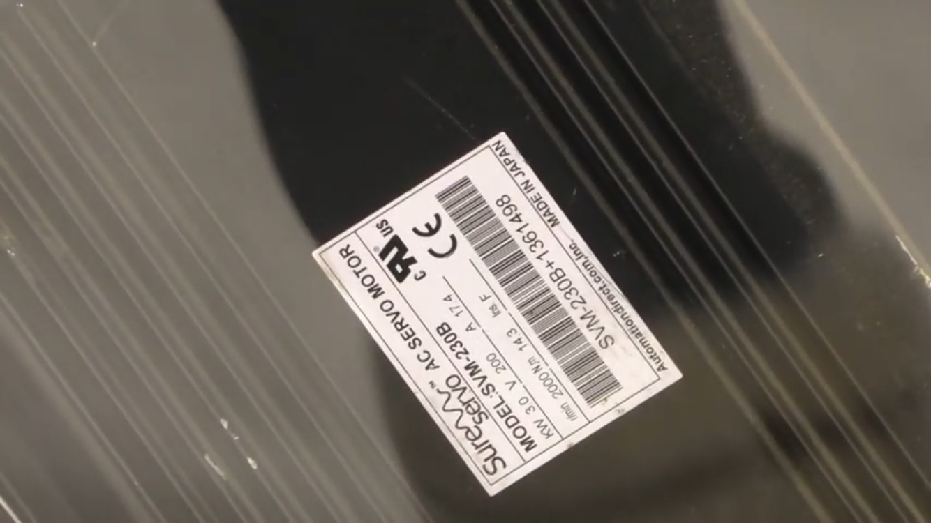

  13. joe extraknow
    joe extraknow Member Gold Contributor
    Jan 4, 2017
    111
    United States
    1,550Coins
    +40 / 2 / -0
    I was there and saw the motors:
