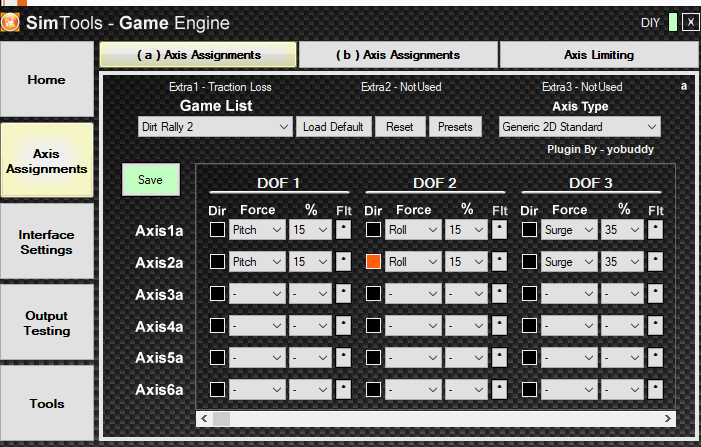

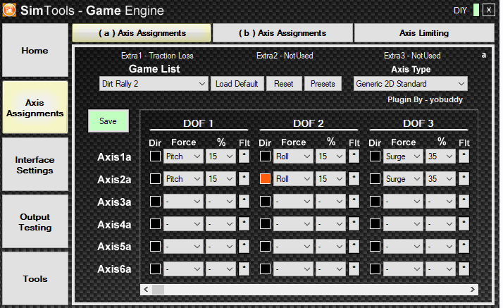

    Here i made 2 video showing my set up.
    Basicly when i start the game nothing happens if some1 can help i will be very happy
    Picture of my setting
    88904 88905 88906

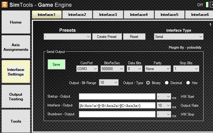

    upload_2022-1-10_21-50-10.png upload_2022-1-10_21-50-18.png upload_2022-1-10_21-49-55.png
    Idk if the pictures worked so i resend

    From the disco inspired video it seems that Output Testing works.
    If so the hardware is working and it is a game configuration issue.
    What Windows system do you have and is the game patched the the correct path: https://www.xsimulator.net/communit...-32-bit-install-path-for-motion-patching.260/
    If the game is correctly patched have you captured the Max/Min values in the Tuning Center, see the motion profile tips in the FAQs: https://www.xsimulator.net/community/faq/steps-to-create-a-motion-profile.228/

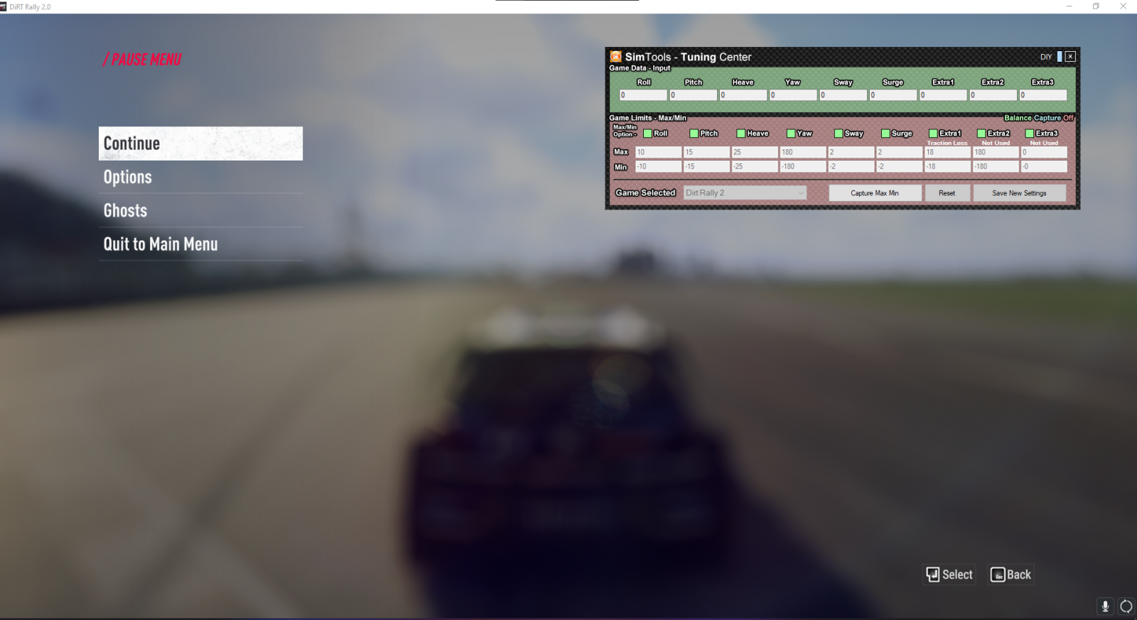

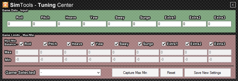

    No don't bother, as long as Output Testing results in rig movement it indicates the issue is really about game configuration or what could interfere with plugin communication, like anti-virus or firewall, photos are a better option than video.
    Can you please post a picture of the Tuning Center while DR2 is running in a race, that will indicate if the game is sending data or not.

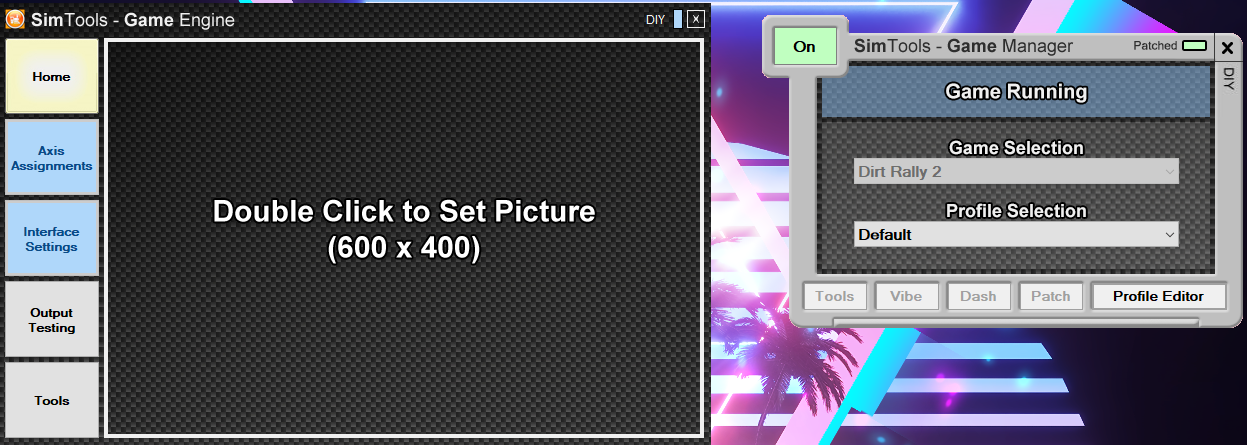

    this is what the sim tools show me. also is there a chacne we can talk in discord i would share screen and u coukl help me mayby?

    ok basicly me and @Daguru tried almost everythig we uninstaled sim tools, got all the settings where they shood be. i cant get consistand movement its just going left and to the middle. If any one can help me pleaseeee

    also output testing not working (it moves ones for a second and broke again) it works in game a bit but still no and in autput testing no. very wierd

    Hi @noorbeast he said theres no disconnects, the hardware is an arduino and an MM but no idea whats installed on there (i got him to download and install smc3 but it failed to connect after entering the correct com port so maybe someone elses code)
    simtools seems to be sending data as we had numbers in tuning center etc
    but no output testing :(

    The code on the hardware side needs to be known and working as expected.
    With MM they should be tested before use: https://www.xsimulator.net/community/faq/monster-moto-testing-before-use.158/

    @noorbeast This was all working before reinstalling window's
  20. noorbeast
    21,907
    153,053Coins
    +11,117 / 56 / -2
    If there has been a reinstall there may also be a driver issue to consider as part of the mix. But basically it comes down to checking each aspect sequentially, to ensure everything does in fact work as expected, rather than assume it does.
