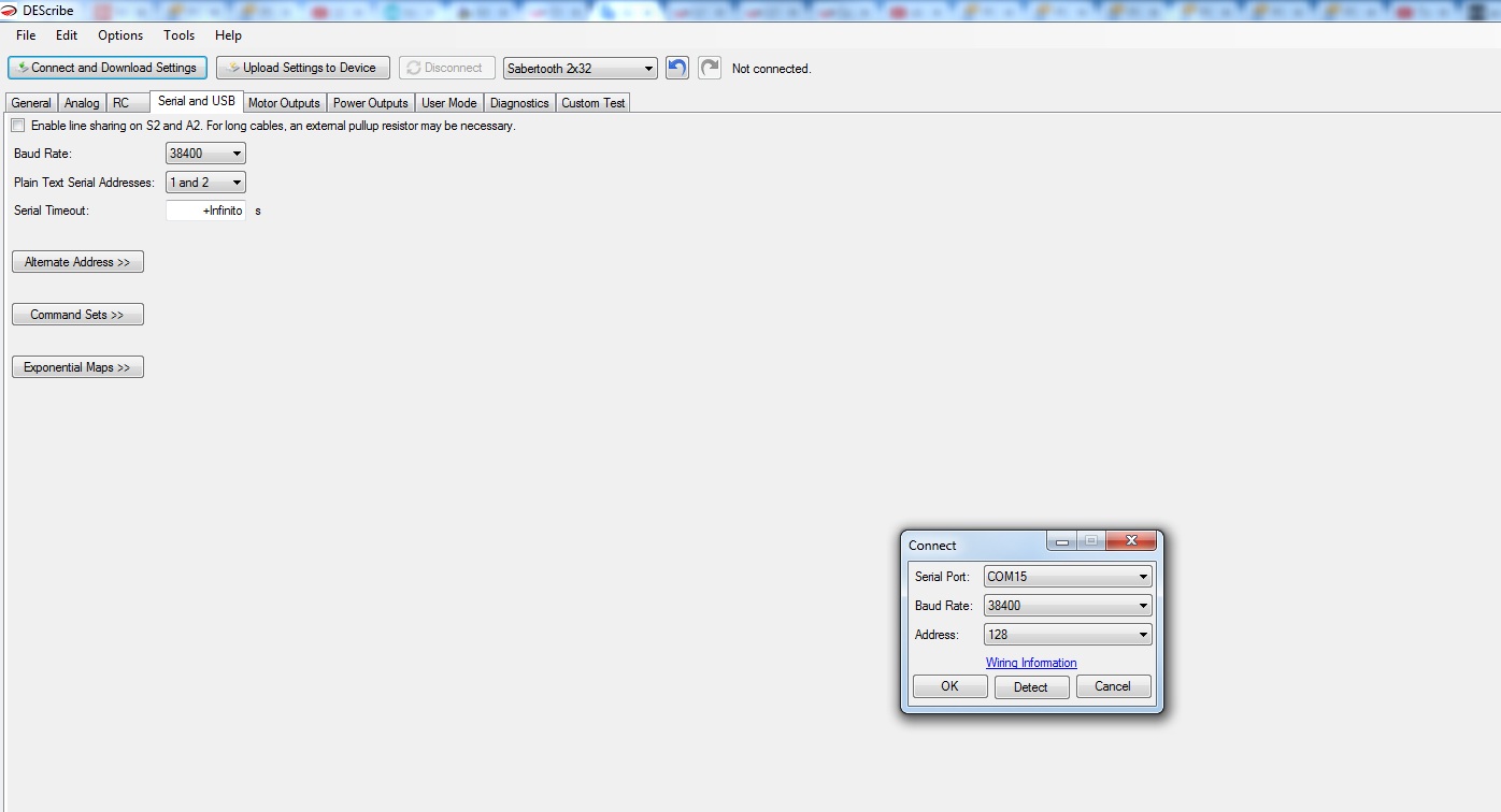

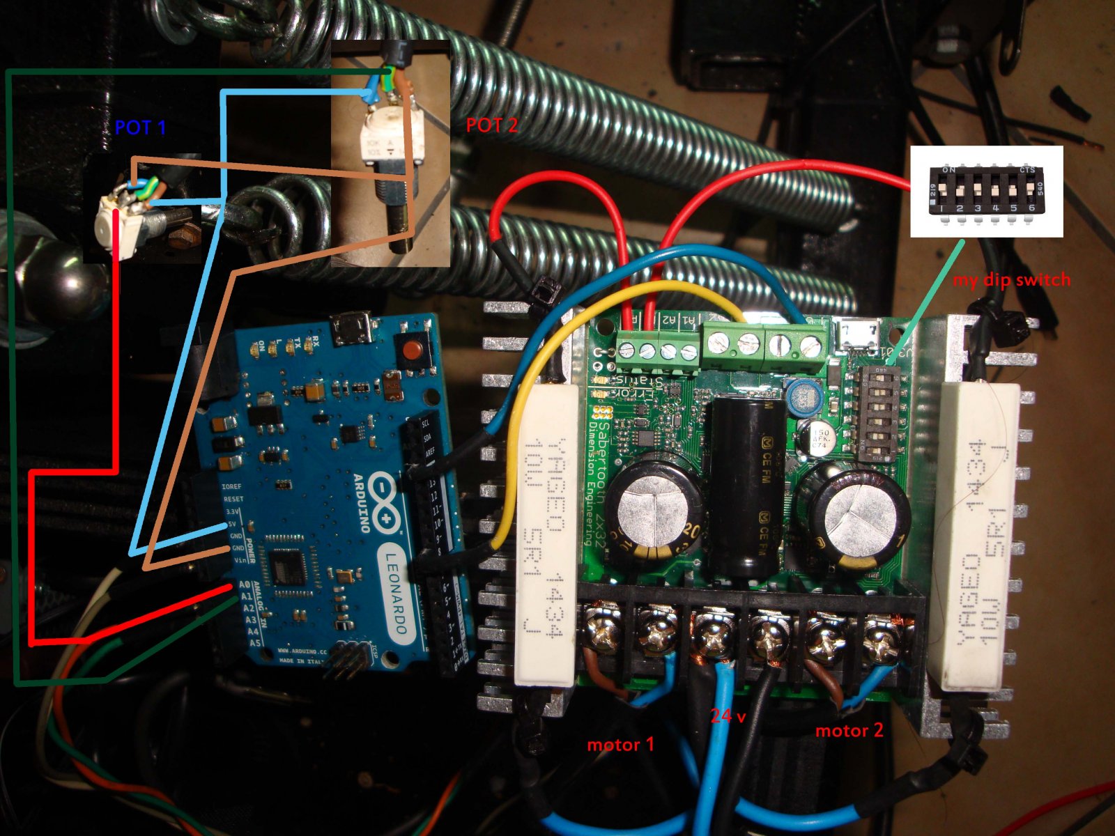

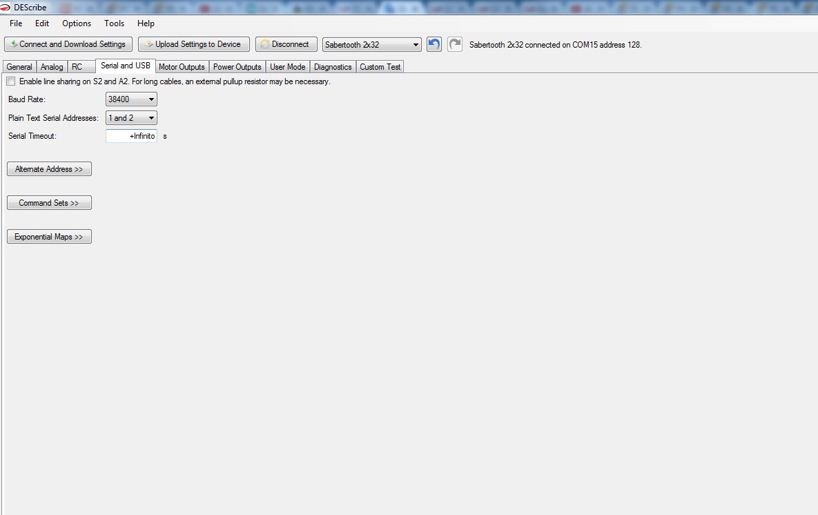

    DSCsetup.jpg I am here again, I ask you humbly apologize but unfortunately I can not get any results, I ask you to follow step by step, I mean from start to finish all the steps from the installation of the driver configuration Arduino Leonardo and sabertooth 2x32, place the photos I made connections thanks again for your trouble

    With the 2x32 you need to set 1,2 and 4 OFF if you use my original sketch (1 and 2 OFF if you use the sketch given by zigzag49) . But before you need to set the speed at 38400 with describe (115200 with the sketch sent by zigzag49).

    You need dip switches 1 and 2 off and 4, 5, and 6 on to run the sketch from zigzag49 (leave switch 3 on with a psu). After looking at his sketch it has an auto baud feature so your 2x32 should set its baud rate automatically when you run the sketch.
    If you still don't get anywhere after trying that I strongly suggest you familiarize yourself with Describe software and use the "live test" feature to see if you can get your motors to move that way. Then you will at least know whether your issue lies there or elsewhere.

    After more research I found the 2x32 won't auto baud so you will have to use Describe like Wanegain stated.
