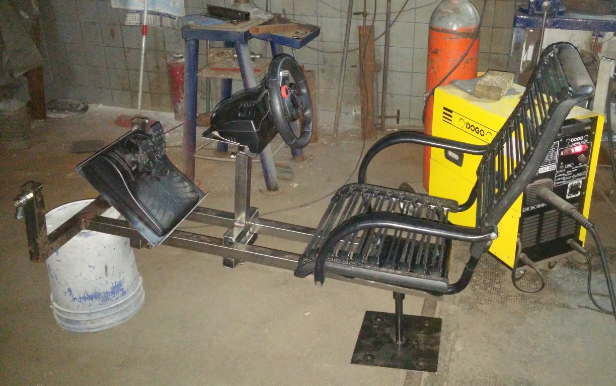

    Final Sim design, based on @Archie 's foot mount :cheers
    Pedals and wheel can be moved to different configurations, all made in 45x45 steel.

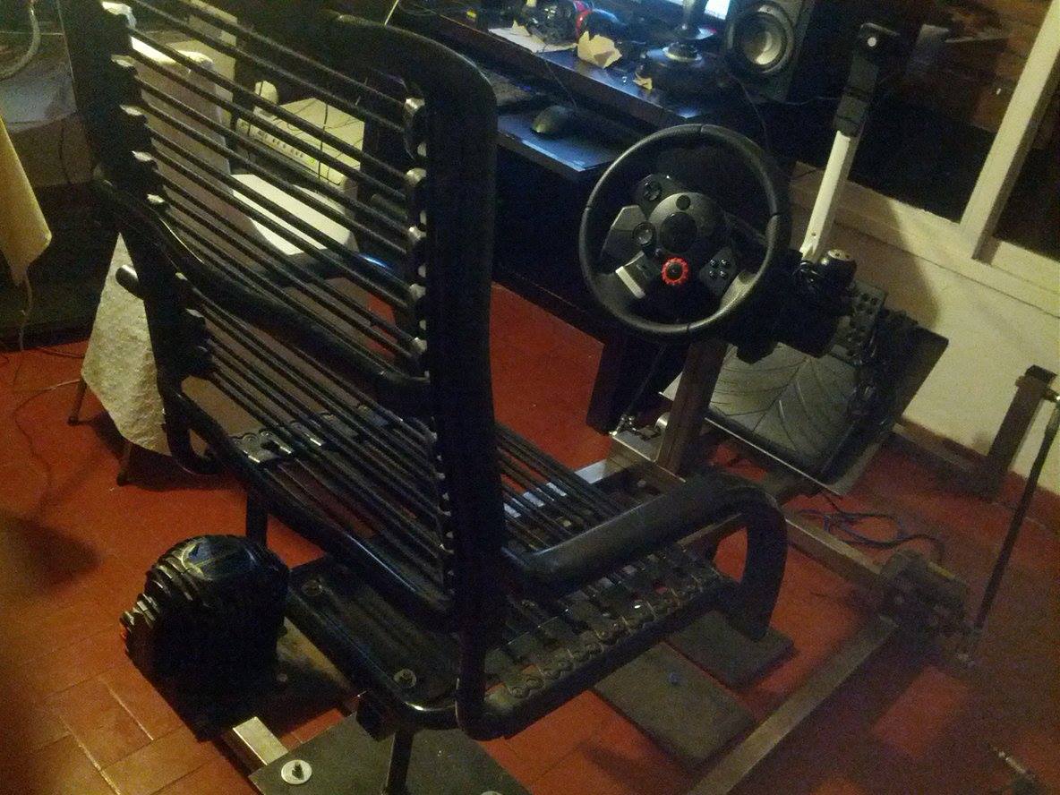

    I hope it will be ready in a week, I will test test it a pair of weeks and then send it to powder paint for a good and lasting finish.
    Still thinking about changing the seat...

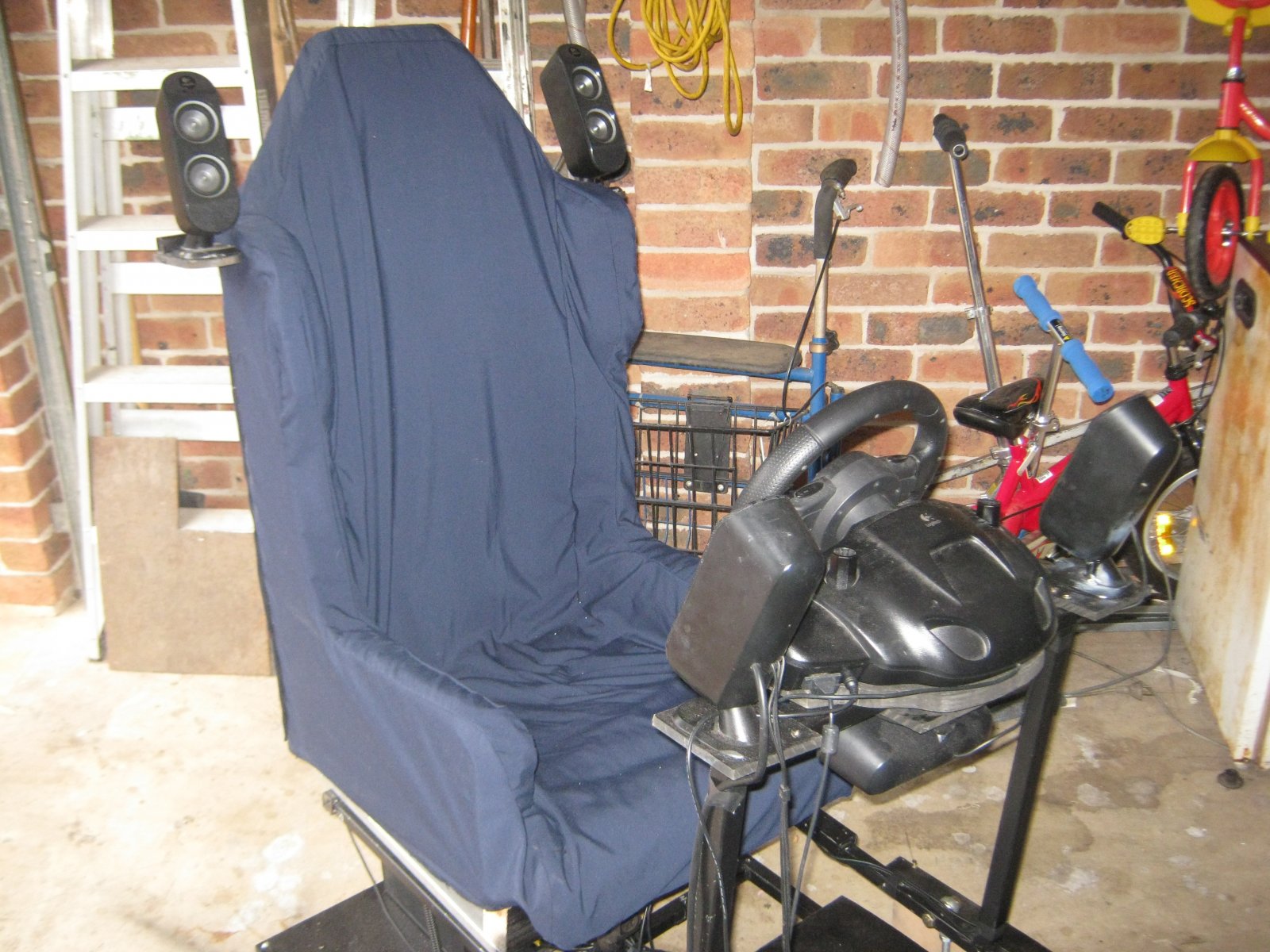

    Congrats @mariano68 - If you get thrown around in your sim as much as I do I would recommend getting a chair with fabric and/or padding.
    You will slide around in that strap chair which will take away from your experience and likely get annoying very quickly.
    Even a cheap car seat or something like that.
    Looking good though, can't wait to see it moving. :thumbs

    I will be using 60mm ctc levers, because the foot mount is about 1mt away and about 30cm higher from the COG, so easier to move, but also I think it will cut some moving.

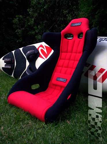

    What do you think guys:
    1-This sport car seat
    2-Or a fixed sport car seat
    butacas-de-competicion-y-deportivas-pana-o-cuerina-mc--9523-MLA20018354778_122013-O.jpg
    21,560
    150,980Coins
    +11,025 / 56 / -2

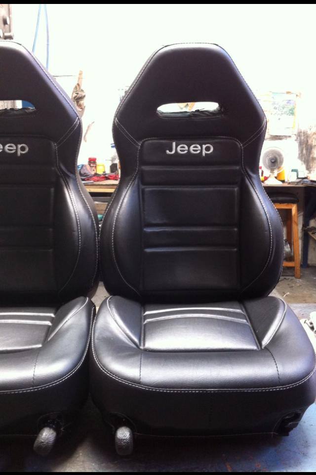

    The fixed car seat will be lighter and likely will not cushion finer vibrations. But choosing the seat that you are going to be most comfortable in should be a main criteria, as you will be having so much fun you will be spending hours on end in it on a regular basis ;)

    My butt will not fit in that space lol!
    Anyway, I think i'm going with the second choice with seat belts! would be more comfortable

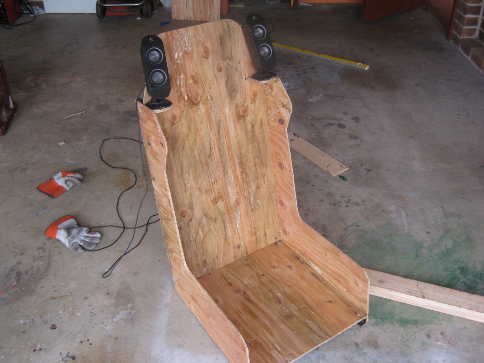

    with that seat, you could get some plywood and build a bit of a frame to go into it, them pad it and toss a seat cover . Piece of cake
    maybe build something like this inside the existing seat frame.

    That Sparco looks super comfortably, but one like that here, costs more than all I'd spent on the sim, and the cheap ones aren't that comfortable, I'm still deciding...

    Good idea, but the costs of the ones I pointed are fine, so I preffer to buy it ready to use this time.

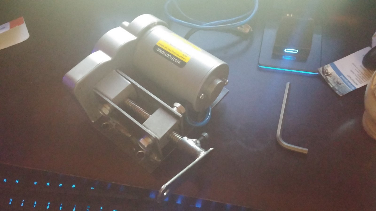

    I'm using 150watts 2Ton modded electric jacks, they use 50:1 gear and arduino+MM

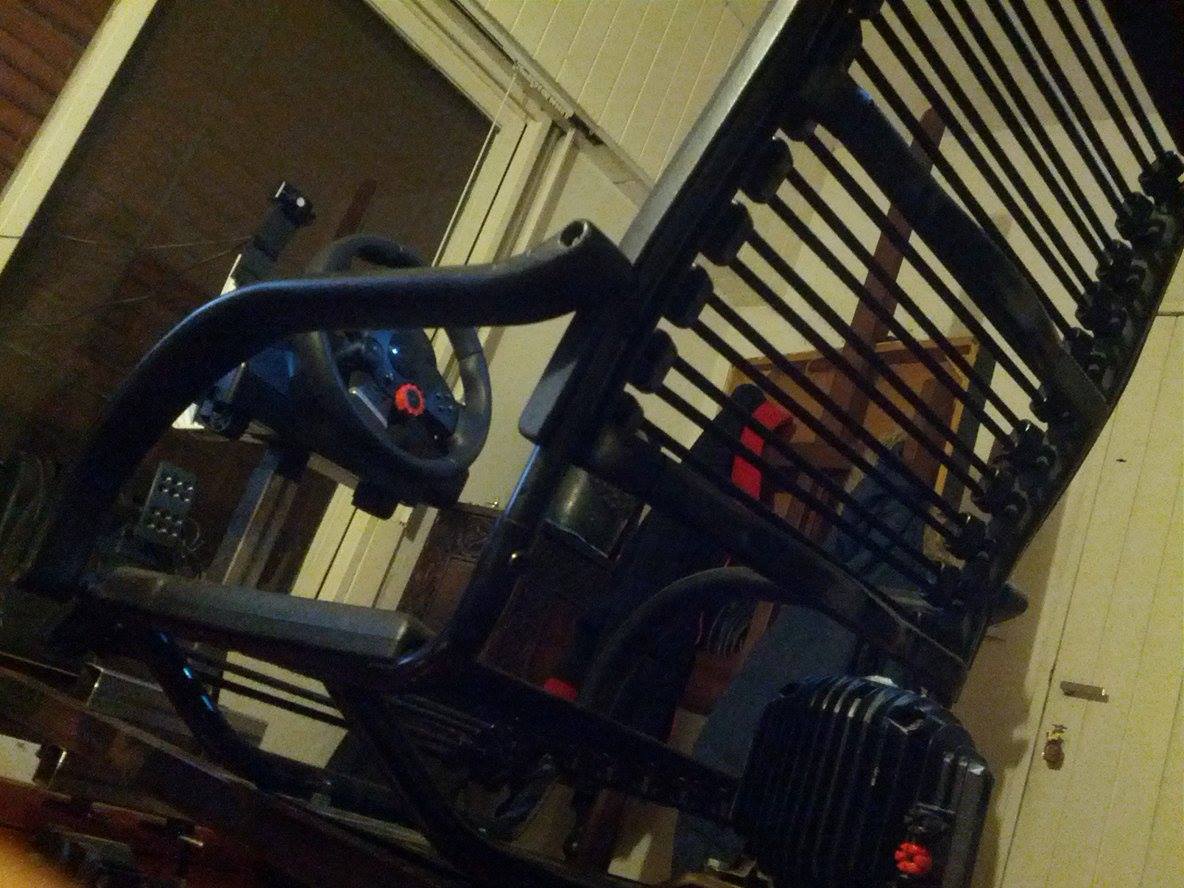

    I made a new metal base for the sim in 40mm x 1,6mm thick square steel tube, as the MDF was bending a lot, so now feels strong and looks a million times better.
    Downside is that I was almost finishing getting all together, and inverted 12v power... Arduino UNO is dead, also one usb 3.0 dead and the onboard sound also killed :mad:. Don't know if the motomonster is also dead...
    Now I'm waiting delivery of a new Arduino and also another motomonster, as even if it is not dead, I want to use one for each motor with his own 32amp psu.

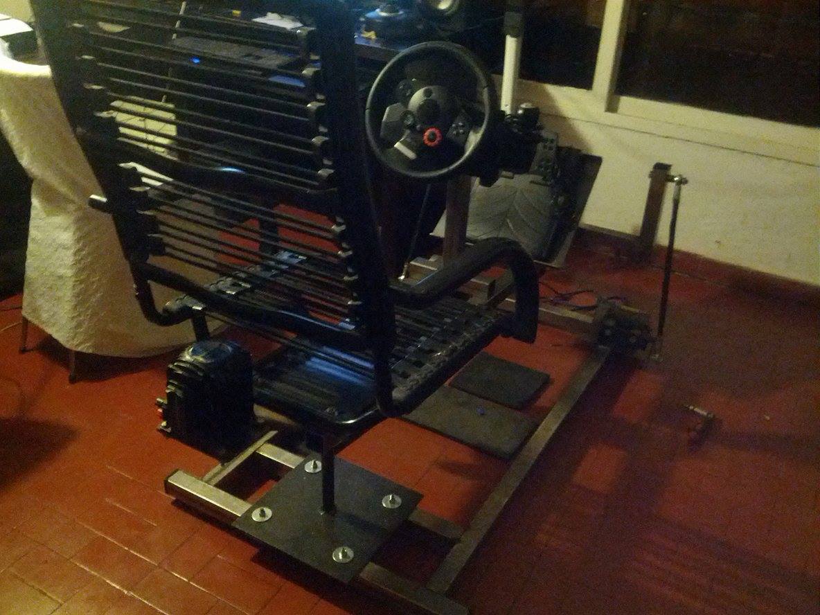

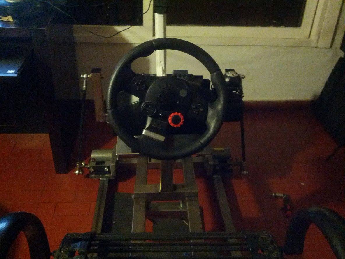

    Ok, tested the Ard+motomonster with smc3 util and tester, looks like the motomonster is fine, now it's time to put all together...
    Some pics

    Finished connecting for the first time...IT WORKS!!! :cheers:cheers:cheers
    Just got a ride in No limits 2, works fine at only 60% of the axis, motors at 200 and with only one motomonster for both, feels powerful and silent enough.
    The levers are 45mm CTC, tomorrow I will try more power and more % axis, it's 12 am and my wife and kids are sleeping... so no more testing for today.
    The electric jacks are a cheap and better alternative than the wipers, I will take better and detailed pics of them.

    Ok, first run in Assetto Corsa with the rift and the sim... unbelievable!!! Really worth the effort it took! Will be awesome once I tune it correctly and add heave, as only tried surge and sway.
    Again, the Electric jacks did a great job, at 170 pwmmax and just 32amps for both. Just because I have another psu and MM, I will add them to use one for each jack.
    Tomorrow I will take pictures of the jacks etc and make a new thread, they are a great and cheap alternative for people that doesn't have access to good and powerful motors.
