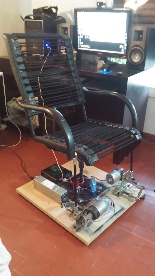

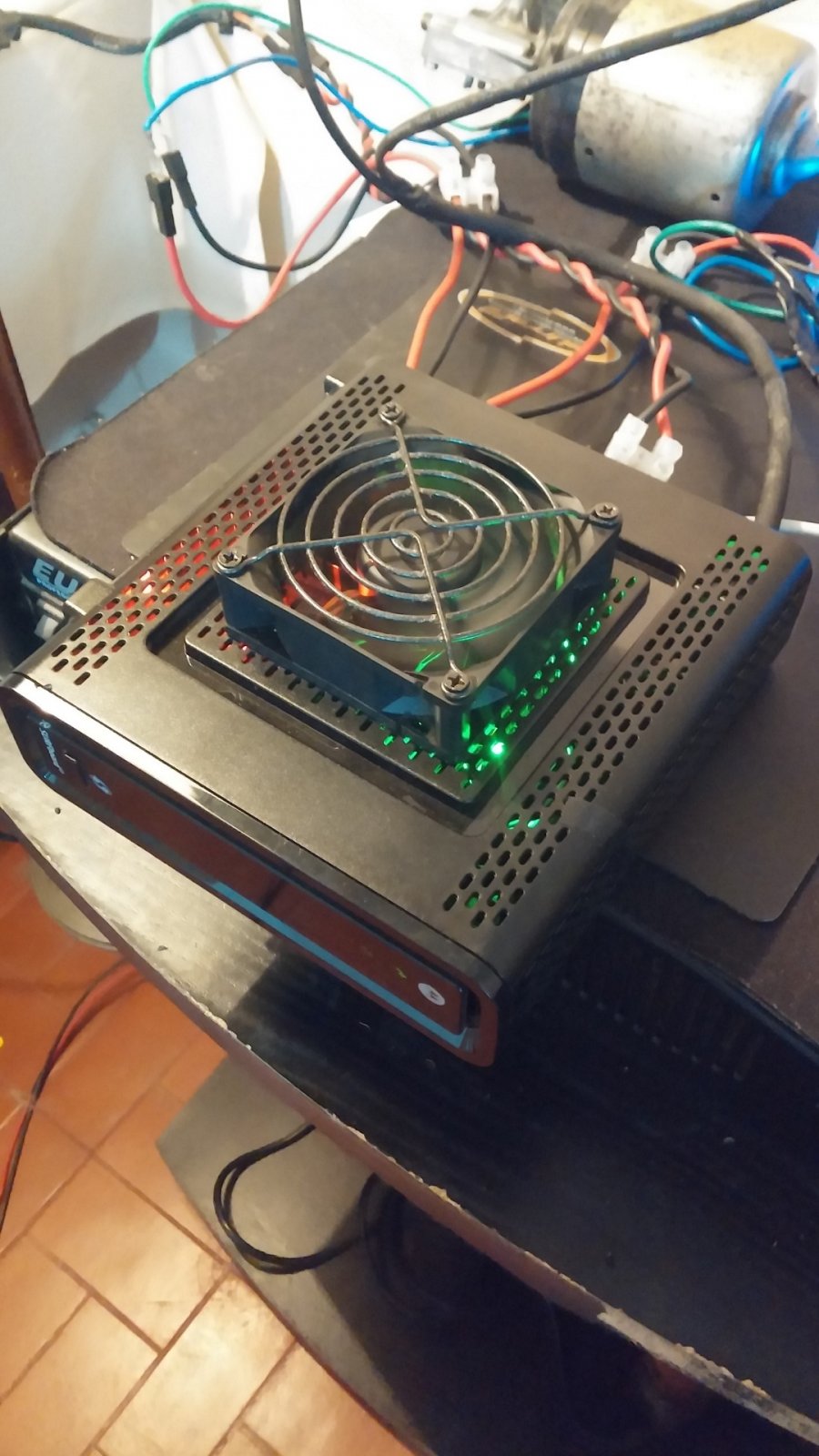

    Electrical part and electronics done:
    A Cablemodem box recicled :) for the Arduino+motomonster
    Also made a new shielded cable for the POTs out of an old VGA cable.

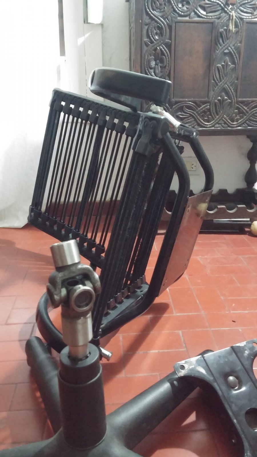

    Trying to make the sim as compact and light as possible, got the idea:

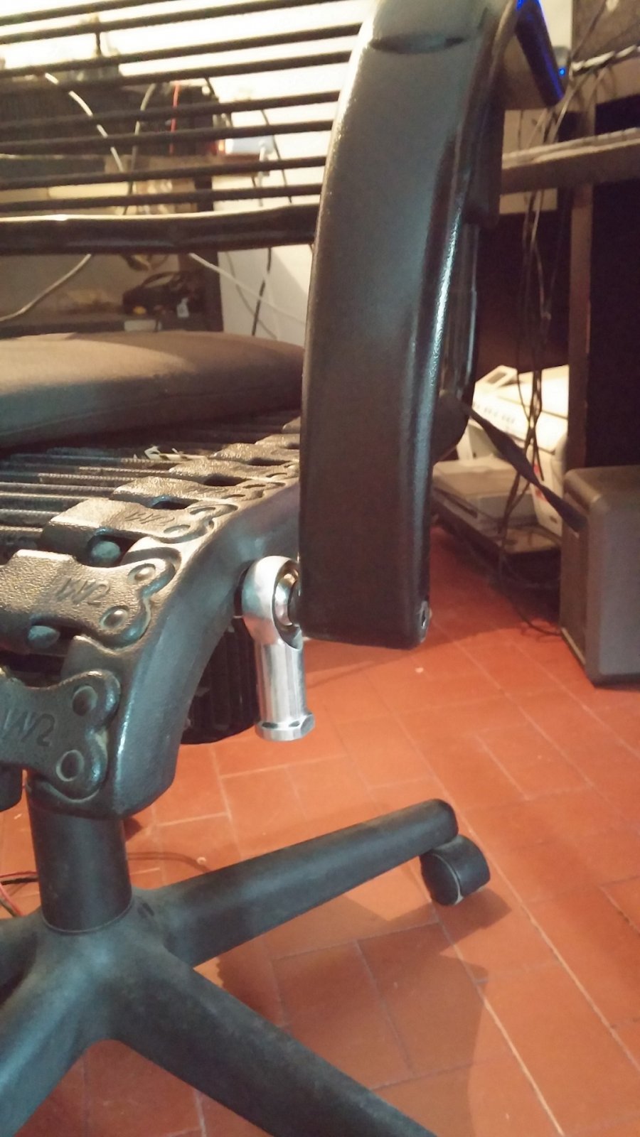

    I bought longer screws so I can fit the ball-joints, as I will start with 25mm levers, I think torque will be fine, the COG is about 200mm lower than the ball-joint, we will see...
    21,676
    151,700Coins
    +11,045 / 56 / -2
    What are the torque/speed specs of the truck wiper motors you plan on using?
    You can get a bit of an idea of how design may effect available torque: http://www.xsimulator.net/community/faq/calculating-basic-linear-speed-and-forces.89/

    Based on what I searched, this wipers are in the 20NM range, and tuned to about 90RPM no load.
    Thanks for the link! It is on my favorites already but as the specs of this wipers aren't sure, I will start with a short lever (25mm ctc) and then tune it to my pleasure:)
    21,676
    151,700Coins
    +11,045 / 56 / -2
    For practical purposes 25mm CTC is about the shortest you can go and I think you may need it.
    I use 40mm CTC with 36nm torque and 54 rpm at the gearbox but I am guessing I have a longer and definitely higher connecting point, so also use much more leverage than you plan on using. In fact I have moved my connection point 30mm further forward during my current round of upgrades, to increase the leverage even further.

    Yes, I know it is the shortest, and coincidentally it is the size of the lever that came with the motor pantograph :grin, but as you said, my connection points are really narrow (I think I saw some narrower).
    Anyway, I think this initial setup will be just that, "initial". I want to feel and play with a moving sim, once tried I'm sure I will know a lot better what I really want and expect from it.
    What I think it will help it's that the center of gravity is about 15-20cm lower than the upper ball-joint.
    BTW, I'm using a server psu, 12v 32amp. that has a really noisy fan, when I tried to change that fan for another quieter/slower, the PSU didn't turn on, so it looks like it has a current sensor as the original fan is 12v 0.65amp and the replacement is 12v 0.15amp. As I will use 2 fans for cooling the wipers, I connected them together with the inner fan of the PSU and Voila! PSU working fine again and I have power for my fans ;)

    Playing with the parts...
    Fits perfectly, no need to solder anything an easy to add YAW movement in the future...:)

    Thank you guys!
    Well, it is rough, it will be nicer...
    It's called "The Chair" :confused:
    Before I try anything, I have to install the pots better...
