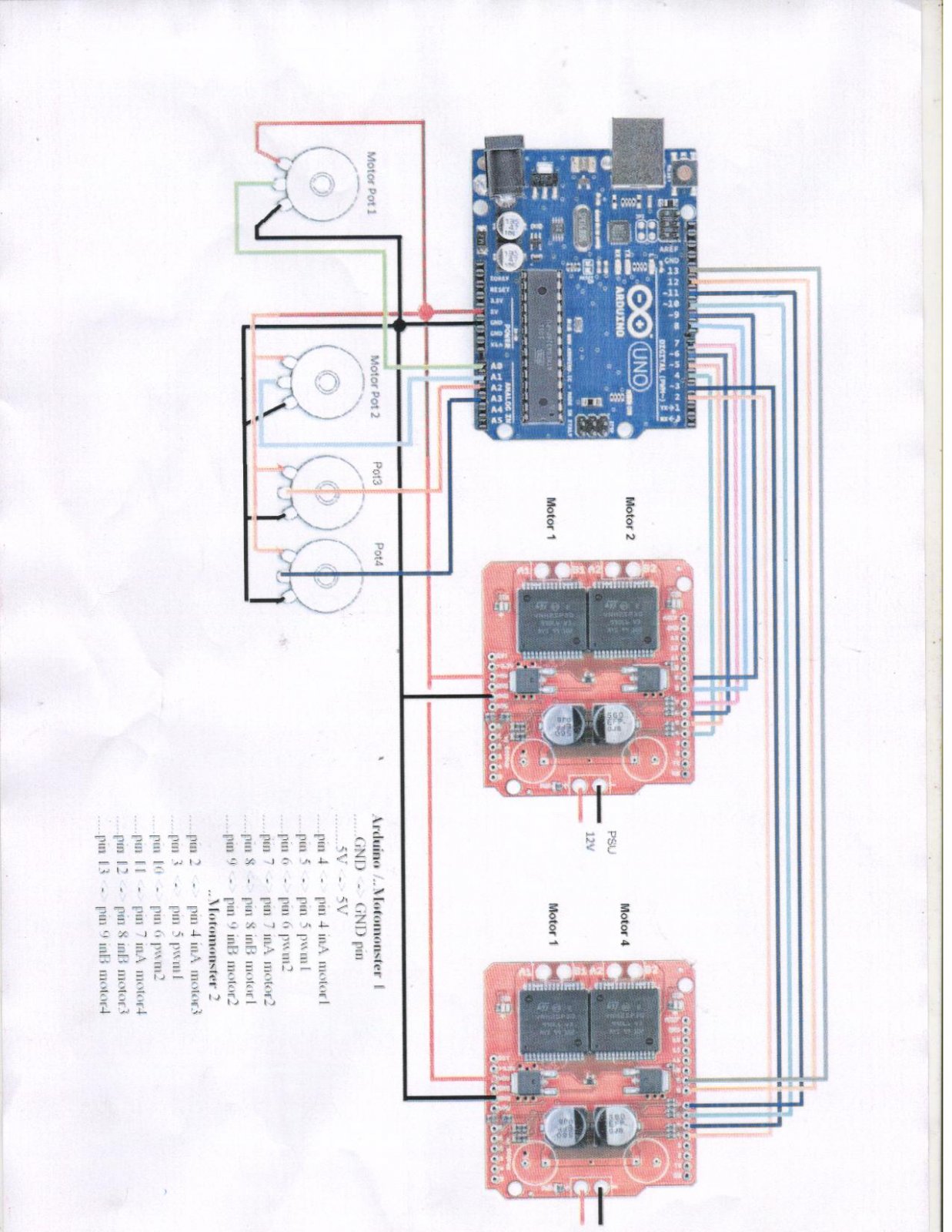

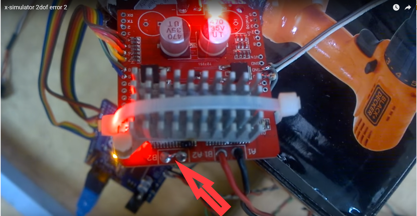

    Pesquisando no youtube, verifiquei que p Jurbuli, (@Jymä aqui no fórum, usou dois MM, um para cada motor. Fiz o processo pelo seu post... Ele pegou o esquema do @Pit, e o código do @RacingMat. Fiz o mesmo processo. Upei o código no arduino, fiz as ligações igual o proposto (vou colocar a foto) mas o simulador parou de dar sinal, e para minha infelicidade outro motomonster queimou... (são dois motomonster queimado mais 2 arduino, lembrando que o Real vale 1/4 do Dólar, :mad::mad::mad:) Estou mandando dois vídeo para o pessoal puder visualizar e mandar alguma ajuda se possível, porque está foda... Abraços.
    Guys, good afternoon, I'm almost giving up because you're f *** .... I am building a 2dof sim since March / 2016 and so far nothing. Next, I did a test simulator and it worked and, parts ... only one engine was working and the other was giving up because it was used. I bought two more remanufactured Wapsa from the Kombi / VWm and it worked, again in parts ... One of the motors always hung in the middle of the turn. When I bought another better source (I was using ATX), it started shutting down as soon as I started the track. (Desperation hit!: Mad :). Again I came to search the forum and bought the server source that everyone is using and ... it would shut down when it would start the track !!! PQP !!! F *****, $ #% @ # ...
    Searching on youtube, I checked that p Jurbuli, (@ Jymä here in the forum, used two MM, one for each engine.) I did the process for your post ... It took the @Pit schema, and the @RacingMat code. (I put the photo) but the simulator stopped giving a signal, and to my unhappiness another motomonster burned ... (they are two motomonster burned plus 2 arduino, remembering That Real is worth 1/4 of the Dollar,: mad :: mad :: mad :) I'm sending two video so the staff can view and send some help if possible, because it's love ... Hugs.

    the wiring in the top video is suspect. the moto is burnt where no wires are coming off, looks like terminal A2. also the heatsinks are too small, no fan and are not attached properly.https://www.xsimulator.net/community/faq/xilence-cooler-for-moto-monster-sparkfun.211/
    just search for north bridge heatsink on ebay
    motos could be bad also but they need to be tested upon arrival from your vendor due to quality control issues. the motos do not stand a ton of abuse, yes they are tuff but a little too much heat/power and poof. Also did you prep the psu as suggested. I can't find the link but maybe @noorbeast has it handy.

    Sim, na verdade ele queimou e depois eu fiz o vídeo, mas apenas para demonstrar a NÃO ação dos motores. quanto ao dissipador, vou adquiri-lo em seguida, agradeço a dica. Mas ainda tenho o problema de não enviaram comando do arduino ao motomonster. As luzes das direções dos motores não acendiam e após desconectar os potênciometros, as luzes de direção voltaram a acender. Outro detalhe que não citei, era o segundo motomonster, ele ficou estático, como se não estivesse conectado. A ligação está incorreta? Poque fiz do modelo que está desenhado acima.
    Yes, actually it burned and then I made the video but only to demonstrate the NO action of the engines. As for the sink, I'll get it then, thank you for the tip. But I still have the problem of not sending arduino command to the motomonster. The engine direction lights did not light up and after switching off the potentiometers, the direction lights came back on. Another detail that I did not mention, was the second motomonster, it became static, as if it were not connected. Is the connection incorrect? Because I made the model that is drawn above.
