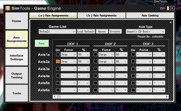

    Hi all!
    I'm so excited to got a 2dof seat today. before that i already got the simtools 2.4 and linking together.
    I can see the output value in turing center.
    Also when i plug my 2dof seat to the laptop, i can hear the special sound in windows
    also i can feel the seat is reset one time. but it's still not working in output testing.
    here is some of my option, maybe it's some wrong there
    I'm a brand new user, maybe there is some mistake in my option...
    hope to get some suggestion!
    great thanks..

    When you say you "got a 2dof seat today" what is the rig and what is SimTools communicating with in terms of hardware?

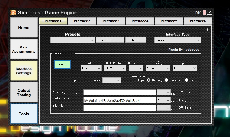

    Now is working in old version simtools! finally it start to moving with output testing. but in new version it still don't move. i already change the option in the interface from <Axis1> to <Axis1a> but still not working.
    which step i lost?
    21,560
    150,980Coins
    +11,025 / 56 / -2
    In that case in Interface Settings the Interface Type should be SCN and the settings configured accordingly.

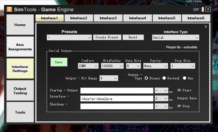

    finally i check all the things again, in the old version simtools it working with serial type. sorry for the mistake. but all same option (already change the <Axis1a>)in simtools 2.4, it's not working. interface new.jpg

    You should upload a photo of the seat to help you confirm if it is SCN5.
    If it is SCN5, the interface settings are not like this.
