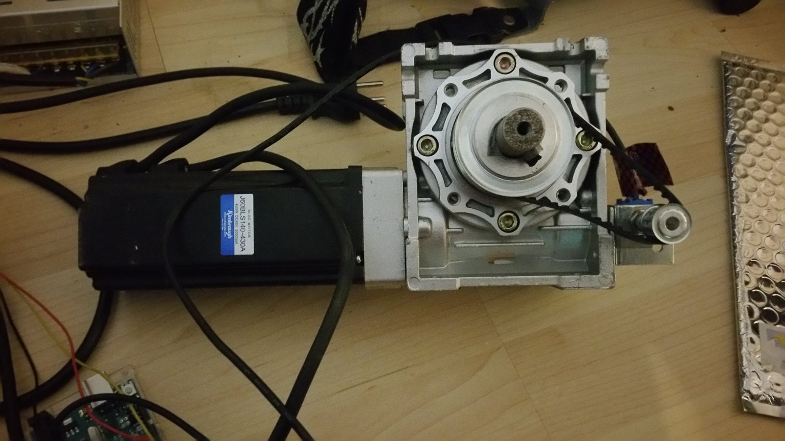

    the motors are bldc : brushless dc, 48V, 400W, 3000 rpm, 1.25N.m.
    ref is: J60BLS140-430A
    price: €50 + €40 shipping. if you order 3, shipping are €75 (for europe)
    the size of motor is the same of Nema 24: it's frame 60, the axis is 14mm keyed
    i put it on NMRV040, for nema 24, with 50:1: input 10mm keyed, and perfect fit for fix it.
    ouput are 18mm keyed, single axis. i changed the single axis by double axis.
    price: €35 + €39 shipping ( or €106 shipping for 3 units)

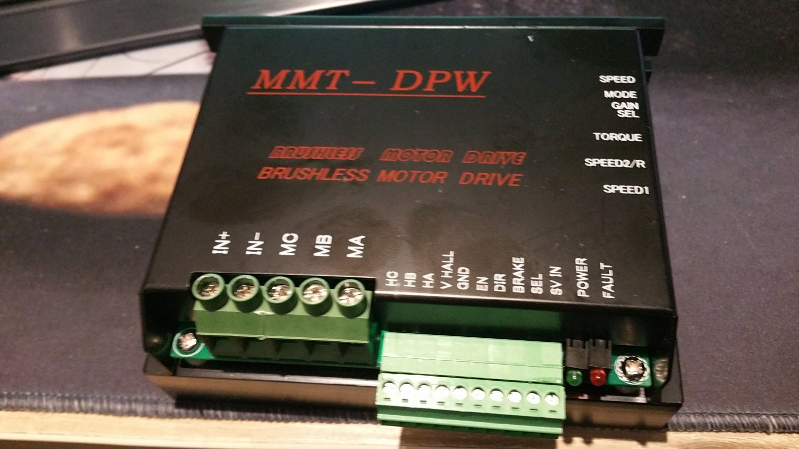

    controller is DC10/50DPW30BL: it's a 600w , 48V capable controller. i use it in pwm /5v mode and 1 wire for dir.
    price: €66 + 8€shipping (€44 for 3.... i ordered one by one ! )

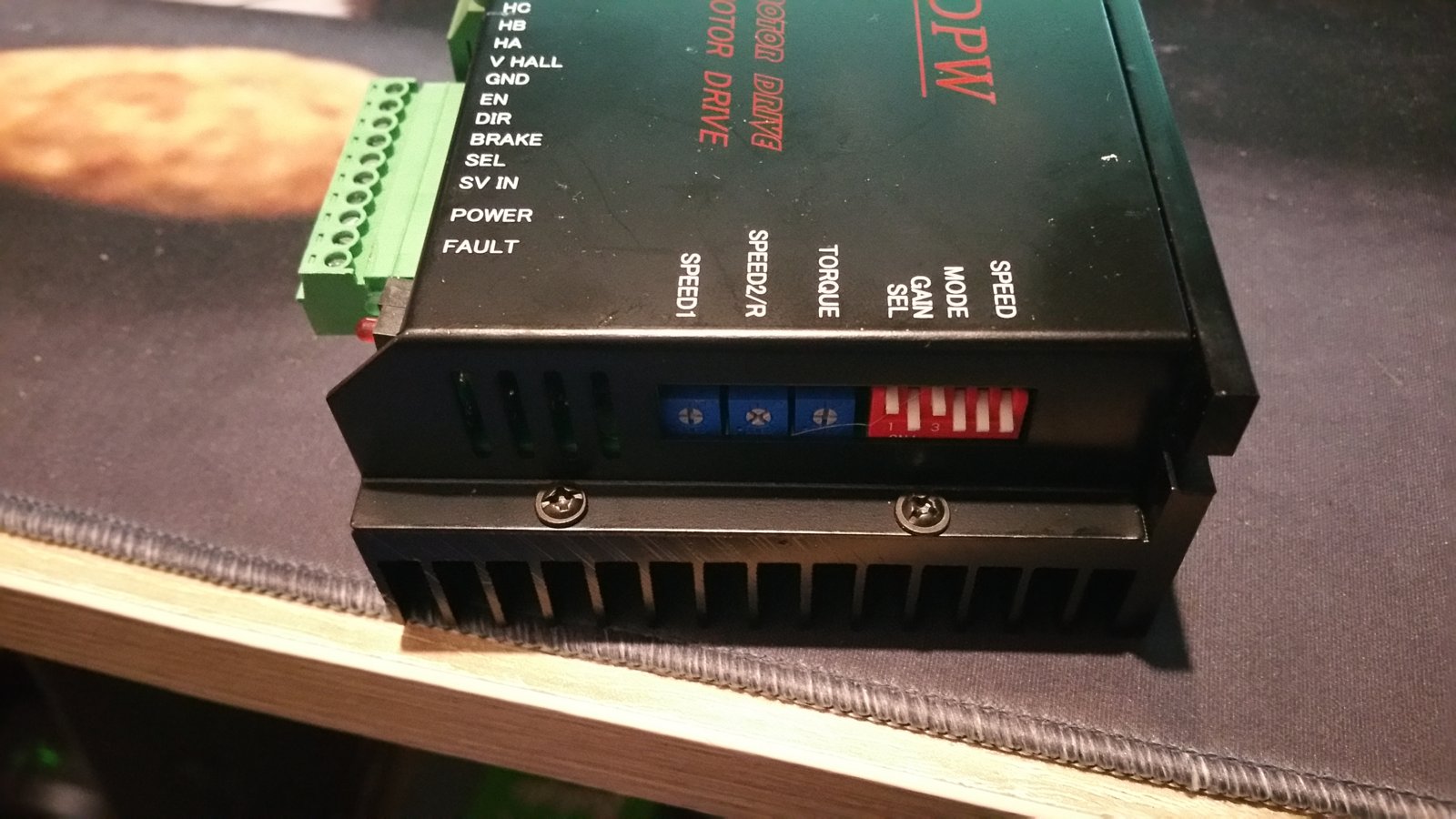

    for control, on the controller there are several settings. at the speed level, I put the max, I removed the startup delay, so in fact it is managed by the current.
    I get a result that seems to match the game: slow movements or fast, everything looks perfect. remains to see once on the chassis

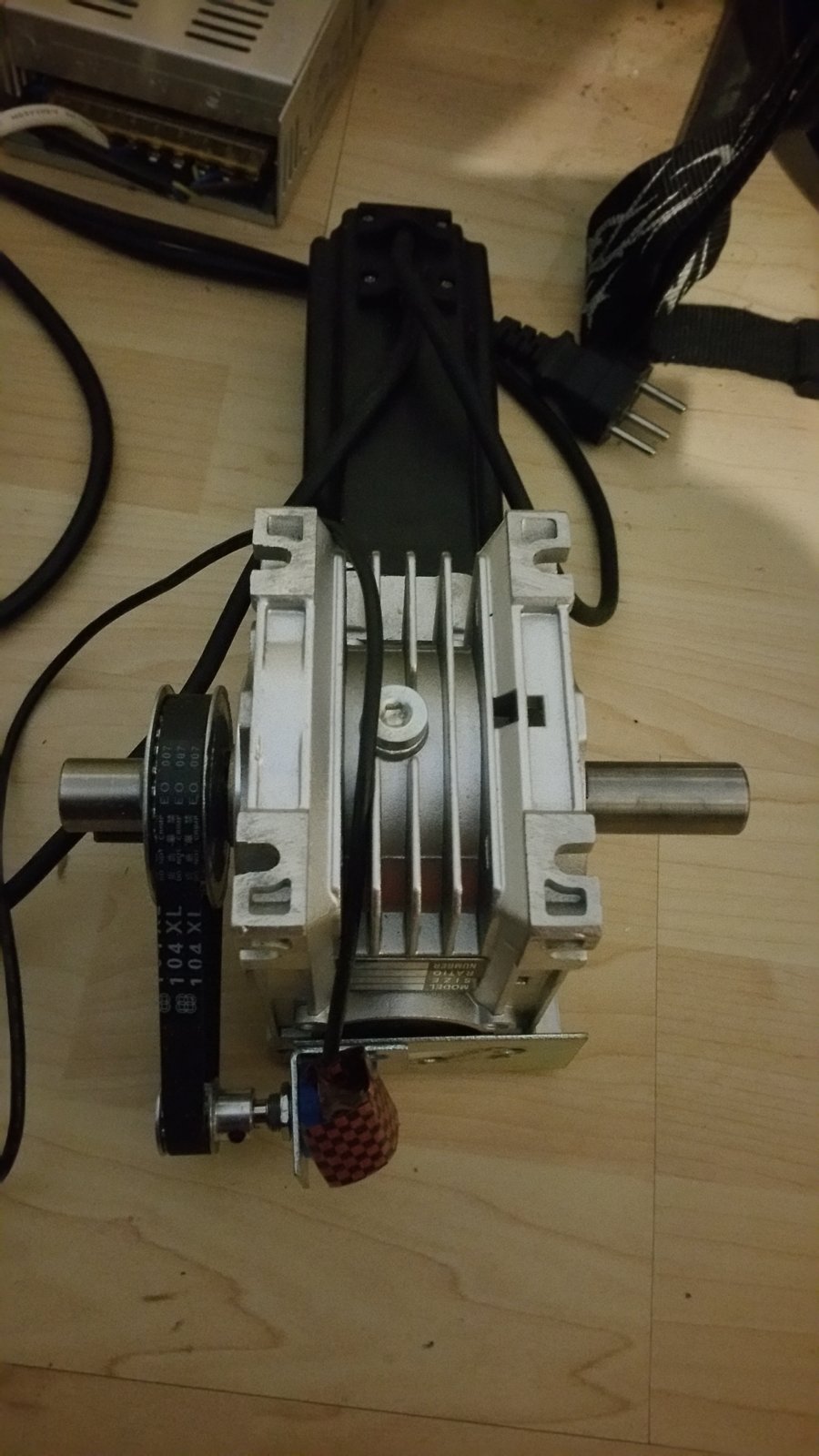

    for the feedback, I use a linear potentiometer of 100k / 10 turns. I fixed a 10 tooth gear on the potentiometer, because I managed to find potentiometers and gears (always on aliexpress), with the same diameters of axis.
    On the output shaft of the reducer, I fixed a toothed gear 30 teeth that I modified: I found wheels with a 19mm axis, I removed the fixation by original screw, and i dug a key. everything is connected by a belt.
    so for 120 degrees on the motor, I have 360 degrees on the potentiometer.
    it is therefore a feedback by angle. the potentiometer is connected directly to the arduino. I saw that it was better to have a shielded cable, with the shield connected to the mass of the arduino.
    I take the 5v for the potentiometer on the arduino.
    the arduino therefore receives a voltage (the potentiometer acts as a divider bridge): at 2.5v, it is in the basic position.
    for the original setting, just put the potentiometer in the middle and reducer in the starting position, then install the belt.
    the maximum position and the minimum position are then set in the software.
    I still have to test with other gears to see if the accuracy is better, but I have not yet received the gears and belts I ordered.
    I used this feedback system because it is simple, and the engines I use do not have built-in feedback.
    there are 3 wires to turn, and 5 wires for hall sensors, which allow the controller to check the speed and direction of rotation. I do not know if we can use this for feedback, but it seems complicated, while the system by potetiometer is very simple.

    here is some pictures:
    20190203_003323.jpg 20190203_003314.jpg 20190203_003251.jpg 20190203_003234.jpg

    I have a question for you : Do you think you can use this reductor in all position ?
    Some manufacturer said that there gear worms reducteur must be used preferably at the horizontal (for best life with lubrification)... Do you have more detail about that ?
    Does the lubrication is supply with reductor ?
  11. Ranch
    Ranch New Member Gold Contributor
    Jan 28, 2019
    8
    41Coins
    there is no indication of the position.
    the gearbox is delivered empty: it must be put gearbox oil, which is easily found in auto parts stores
