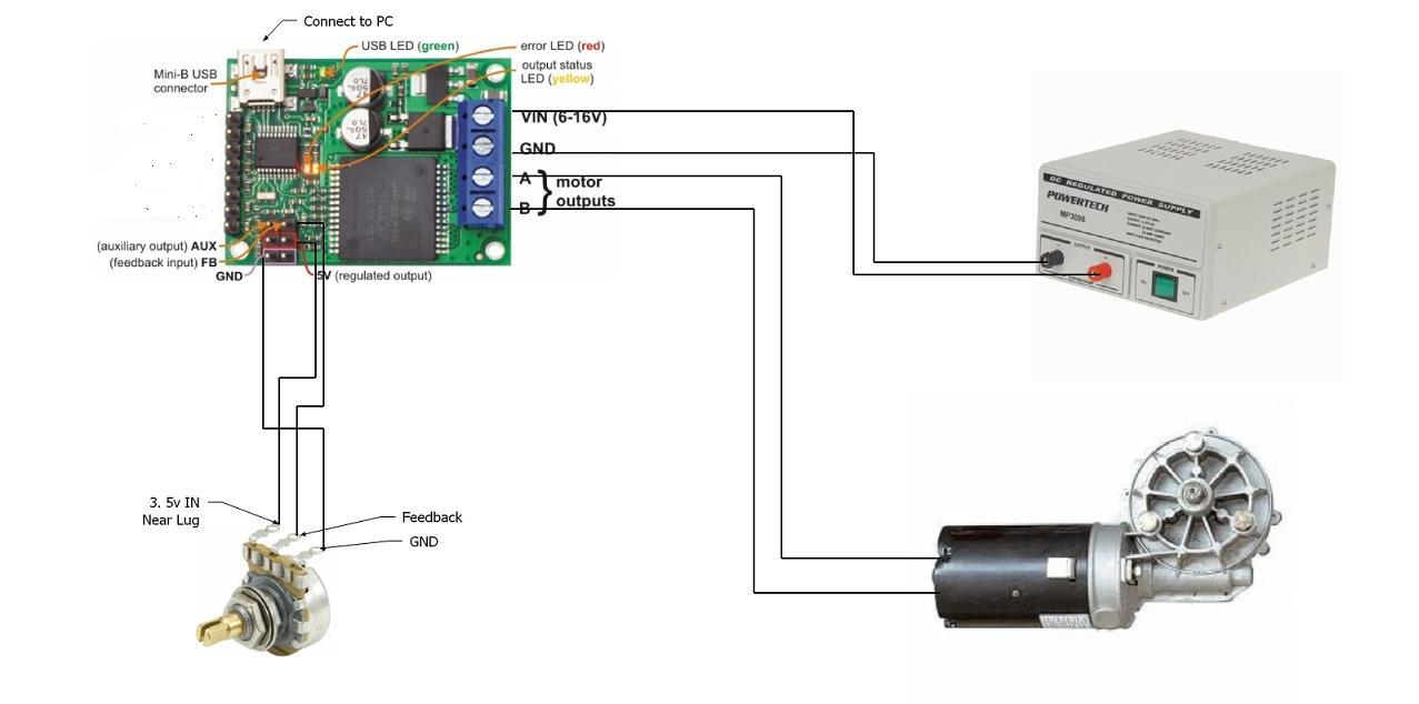

  20. bsft
    wiring the JRK

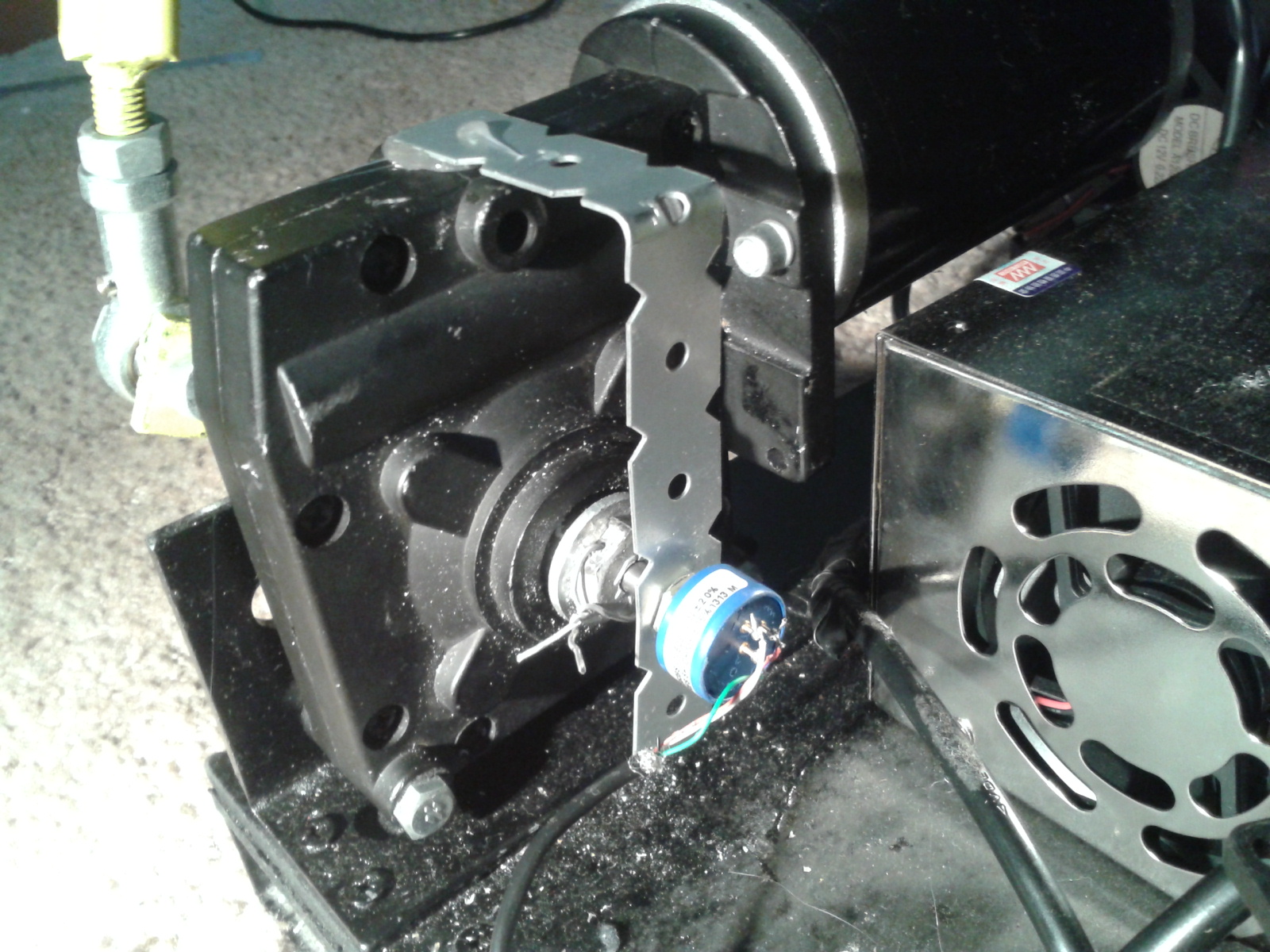

    suggested connecting the pot to the back of the motor shaft, and @Nick Moxley , can you please add a pic of your pot setup
