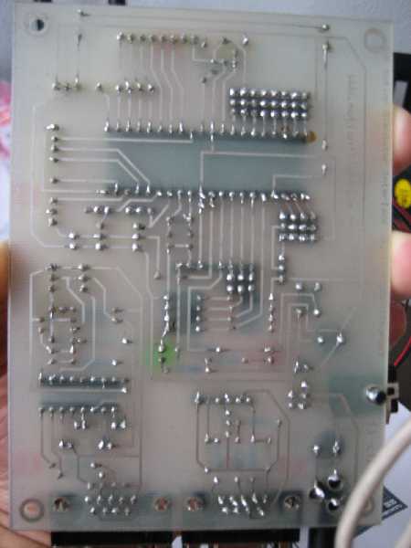

    Hey and hello, im robert from germany and have problems to connect to xsim,
    no avr in the interface window, no working output numbers, how can i test whats wrong with my board or cable?
    which serial cable i need, i have a normal 1 to 1 cable, is that right?
    no work with all comports 1 to 4 ,are some settings wrong about the usb to serial adapter?
    have vista and xp testet, please help me, wanna have fun in future with a great xsim motion simulator.
    here are some pictures from my board.
    hope i have a simple failure or mistake.
    :sos: :sos: :sos:

  4. tronicgr
    tronicgr
    I see you have used 24Mhz firmware... Is your crystal 24Mhz??
    Some ATMega8535 chips cannot handle well that high overclocking, you might have to use lower crystal speed and appropriate firmware (22.xxxMhz or 18.xxxMhz).
    Also check to see if you have set correctly the settings for the USB2serial connector (FTDI chips need to have enabled the serial printer option)
    Thanos
  5. Robbi81
    Robbi81 Member
    May 28, 2010
    33
    0Coins
    hey thanos, thank you for your post,
    i have now 18 mhz crystal and firmware, it works with xsim yesterday i had tested short.
    but i have one more question to you, in the interface window of xsim 2 is no avr or amc to see.
    is that right, i thought i have to see in and outputs fram your amc 1.5 in the interface window of xsim 2.
    how can i configure that.
    thank you

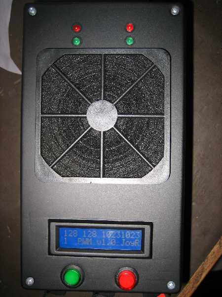

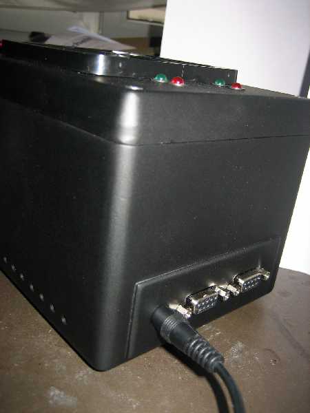

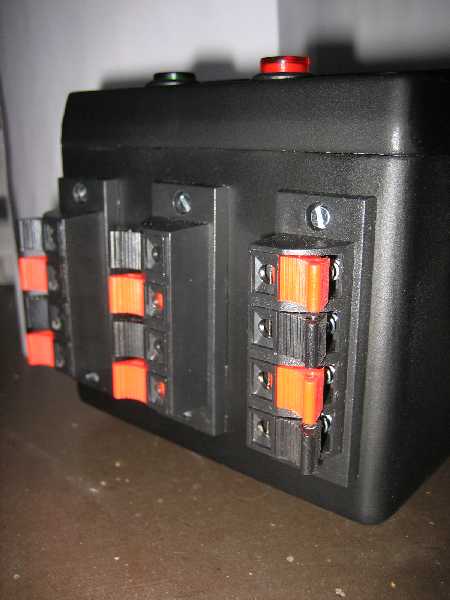

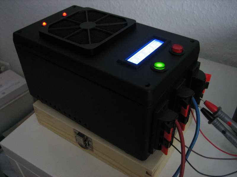

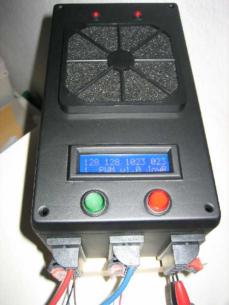

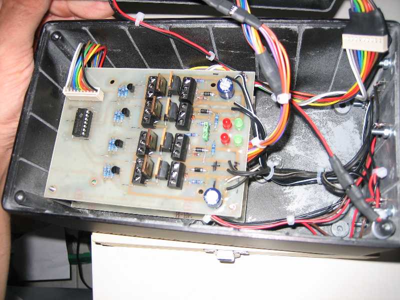

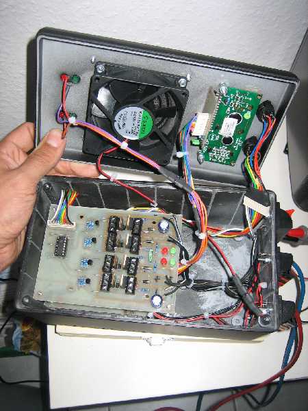

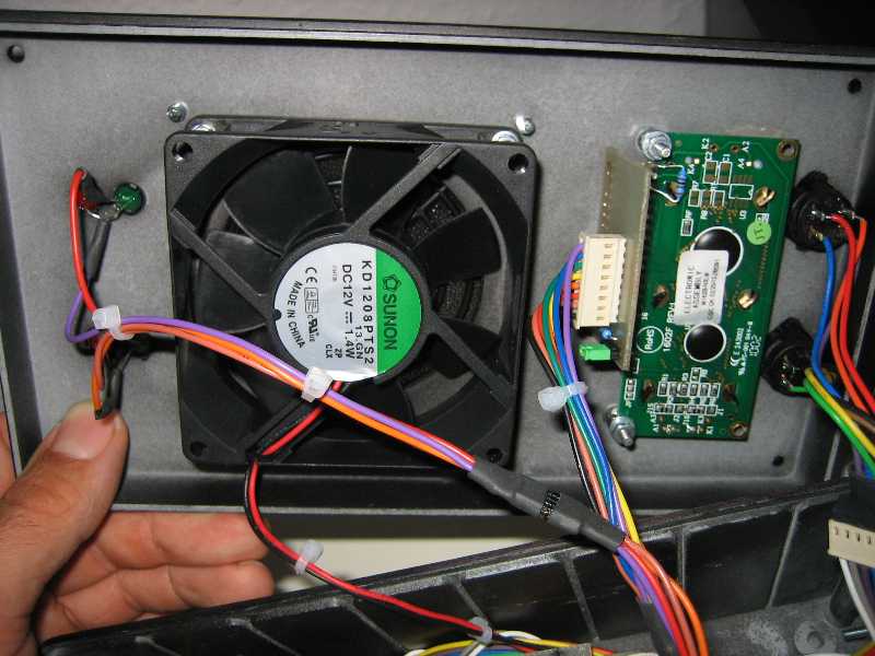

  7. Robbi81
    Robbi81 Member
    May 28, 2010
    33
    0Coins
    Hi guys, i spend a lot of time in my avr and h-bridge box, and now i have finished my black box,
    i will show you:
