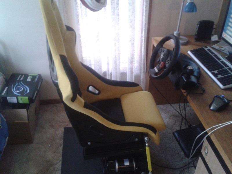

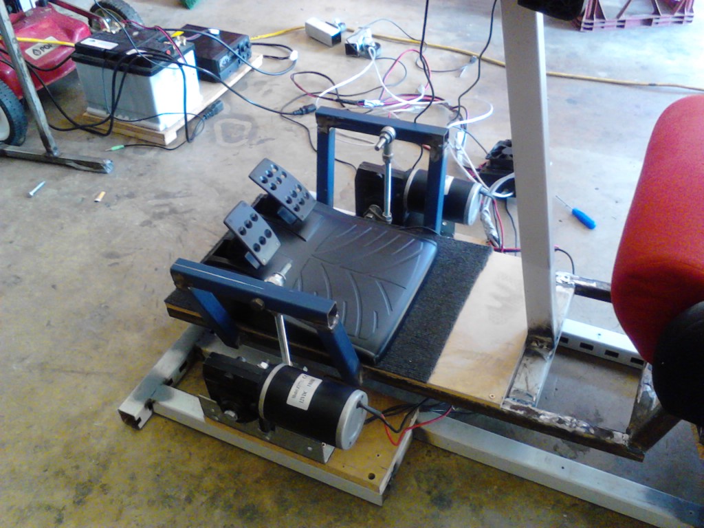

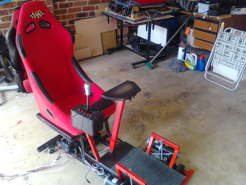

    As for Robs point on real life videos, heres a good one, watch the driver in the corner of the video get tossed around
    Although only from my perspective, the foot motor sim I built was really good even though it was a full frame. The long distance from the pivot , 700mm , gave me short sharp jolts motion and sufficiently gave good pitch feeling on a short throw on the motors. As said, the frame had big roll, but a profile sort fixed that no problem.
