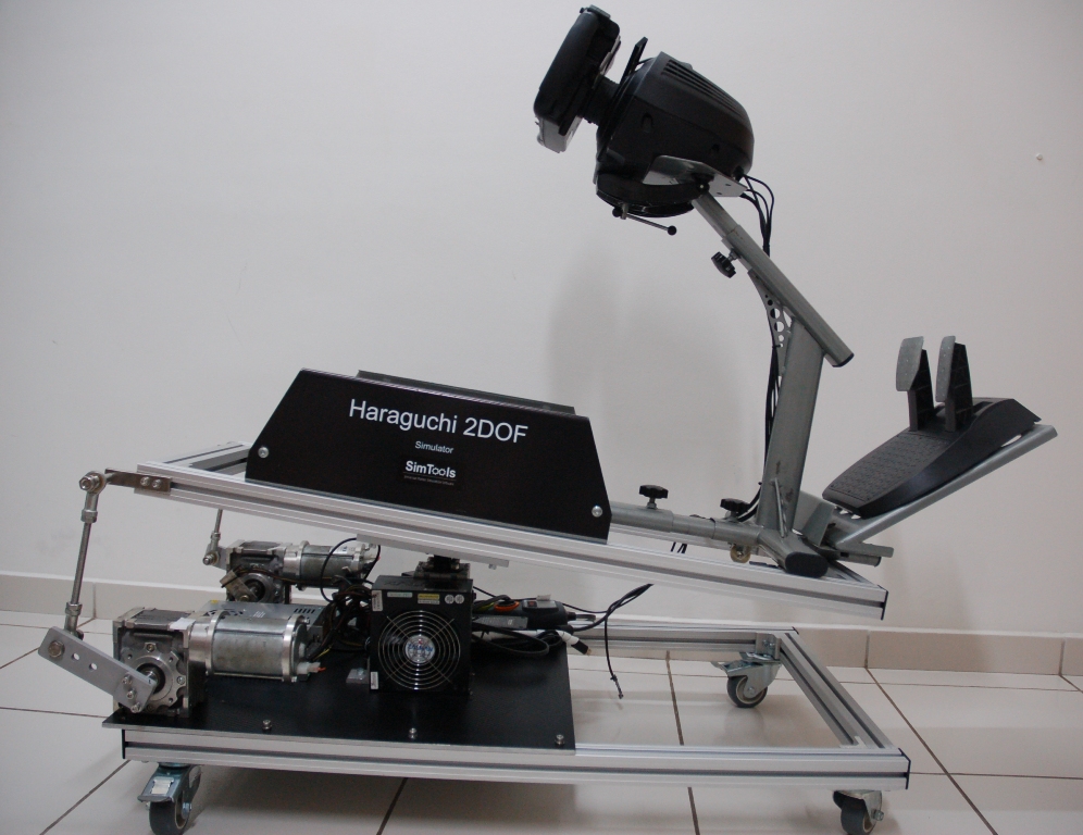

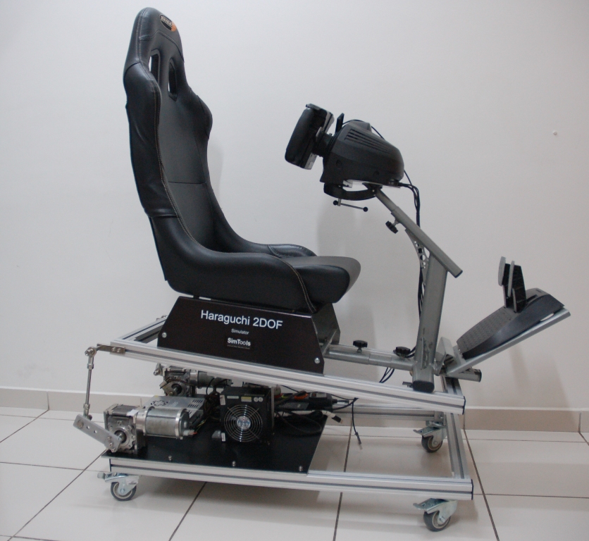

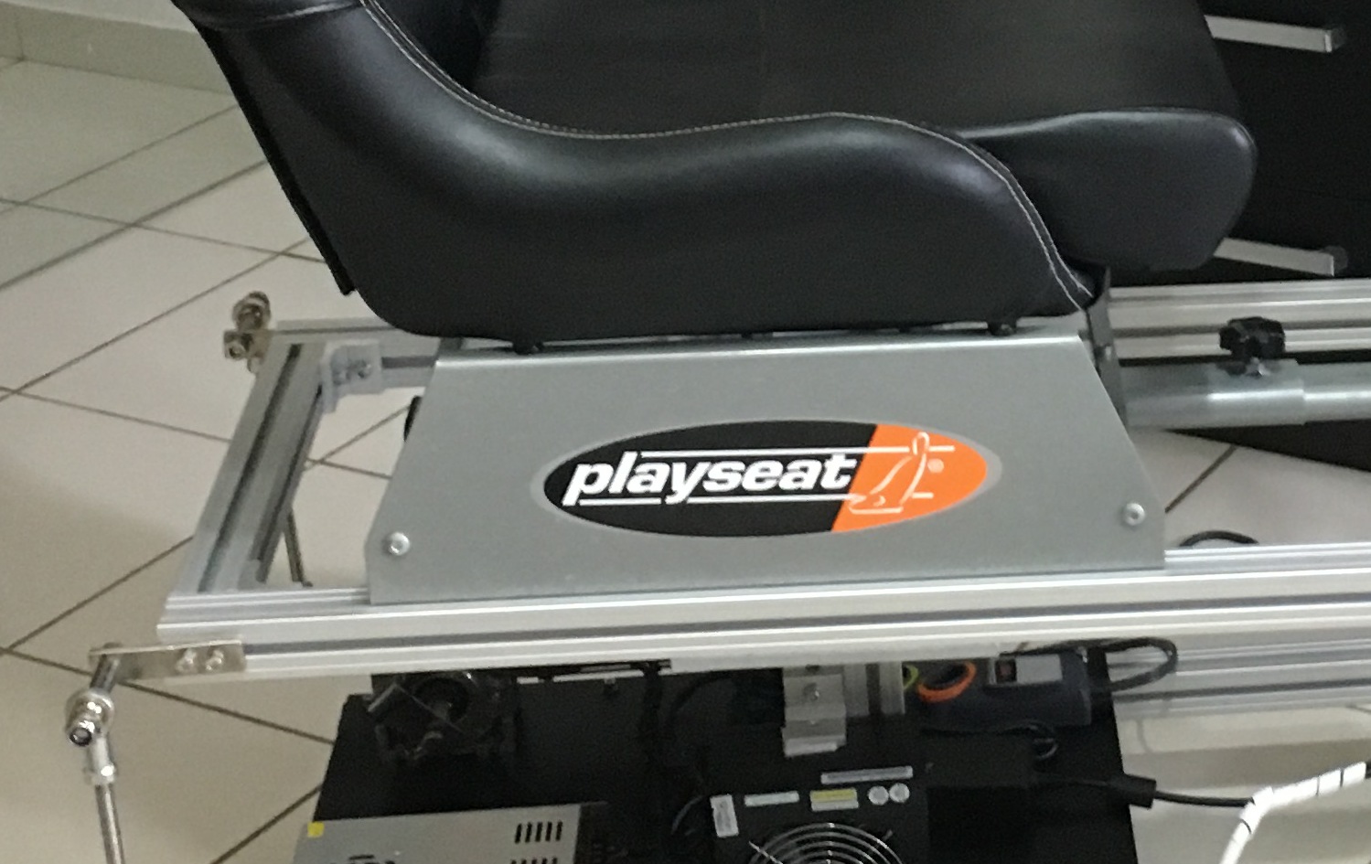

    I'm going to remove the side sticker from Playseat:
    And maked an art.
    I'll print on vinyl and put it in place:
    Tomorrow as soon as I get ready the sticker I 'l mount the simulator and put new photos!

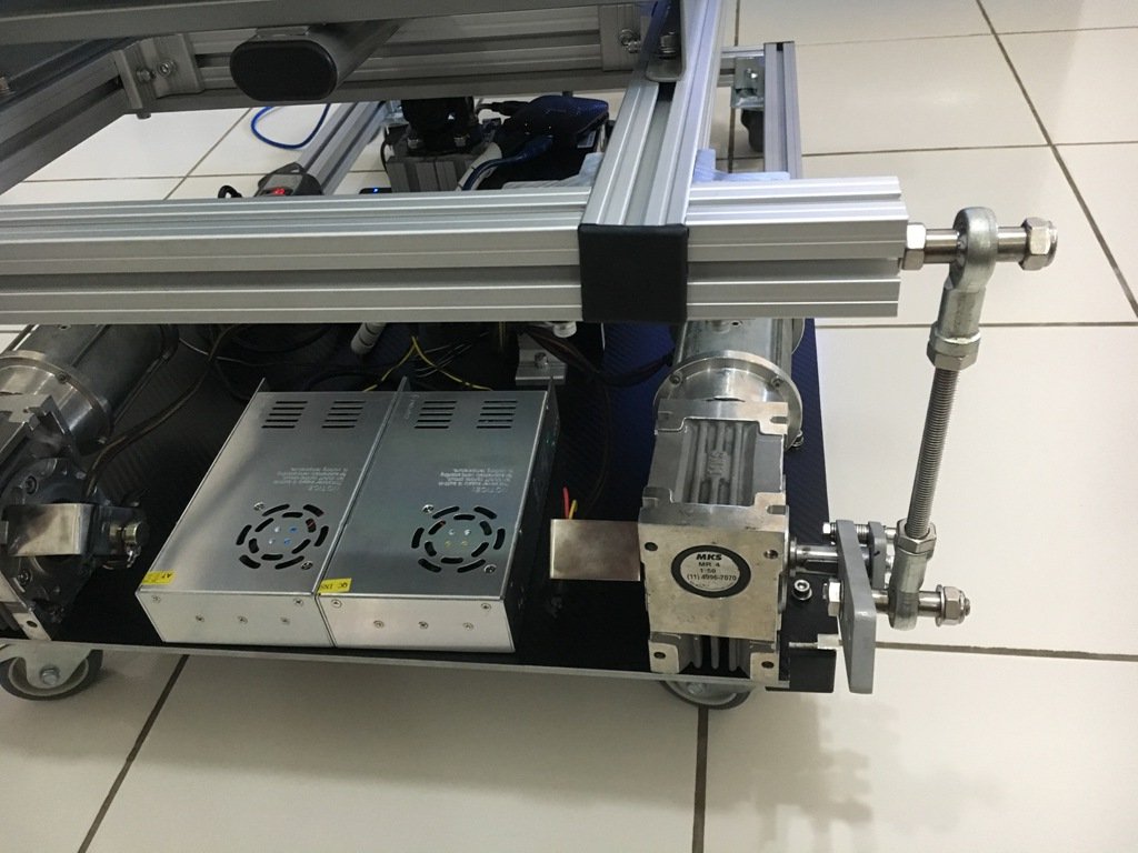

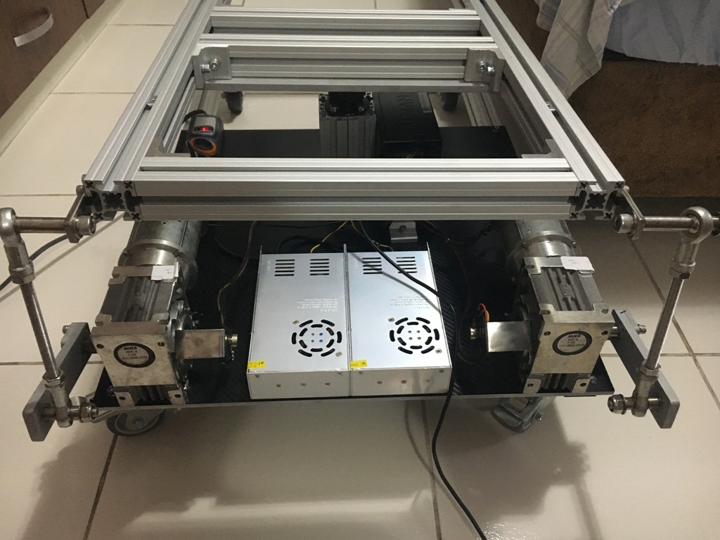

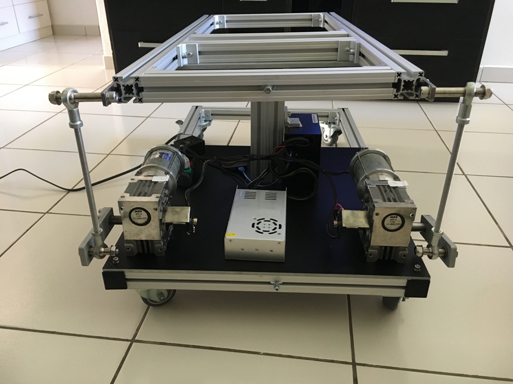

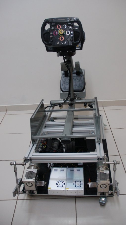

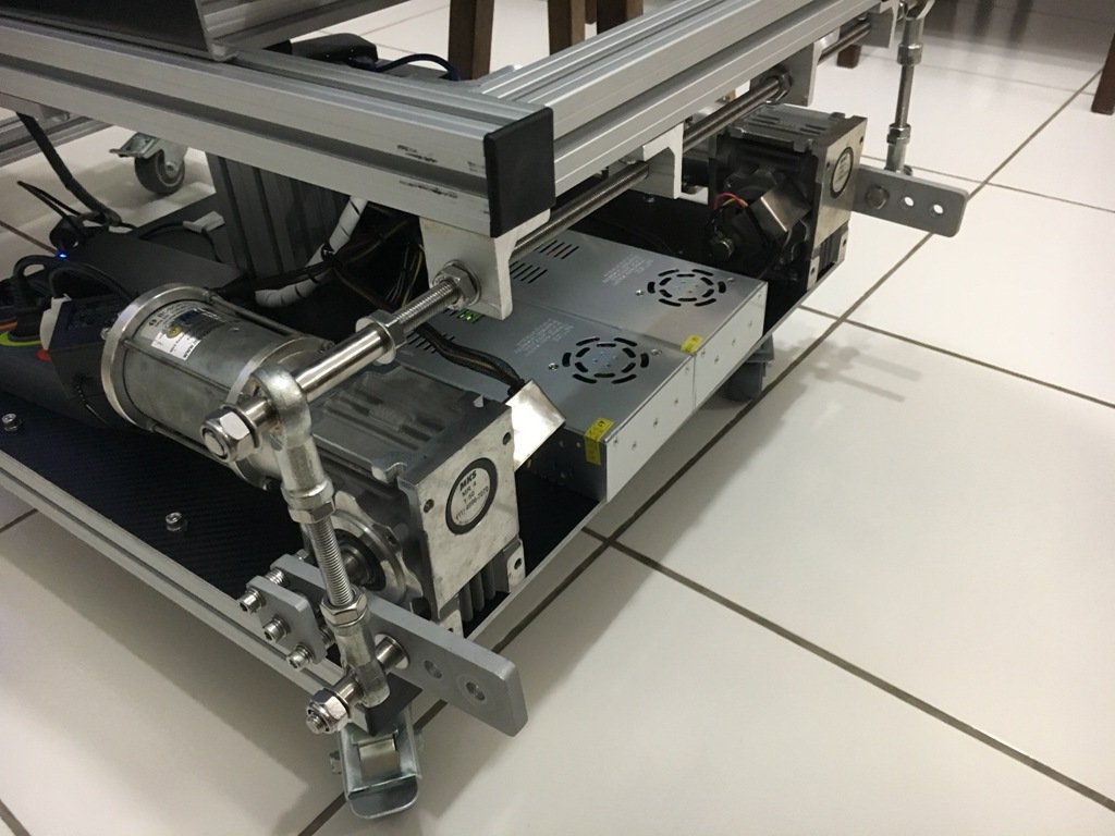

    Today came the 2nd source (PSU)
    Now each engine has its independent source PSU)
    Before:
    After:

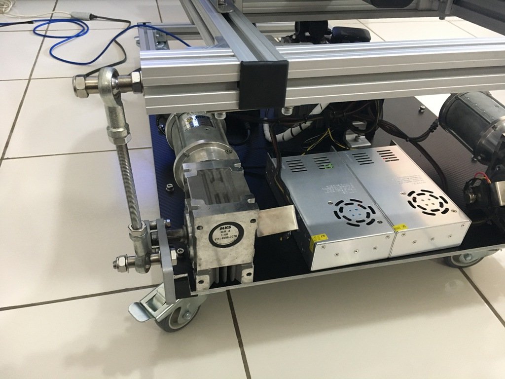

    News !
    I put the sticker on, put it all together, now 99% done!
    I have a problem, I think with the engines, because after some time they lose communication ...
    With my daughter (it's about 32 kg) the simulator operates normally. when it is my turn (72Kg) the engines stops a short time ago ...
    I'll search more to see what the problem might be.
    Probably overload on the engines as they are only 100W.
    Novidades !
    Coloquei o adesivo, montei tudo, agora 99% concluído !
    Estou com um problema, acho que com os motores, pois após algum tempo ele perdem a comunicação...
    Com minha filha (tem uns 32Kg) o simulador opera normalmente. Quando é minha vez (72Kg) os motores param apos um curto período de tempo...
    Vou pesquisar mais para ver o que pode ser o problema. Provavelmente sobrecarga nos motores, pois eles são de apenas 100W.
    Photos:
    21,580
    151,094Coins
    +11,028 / 56 / -2

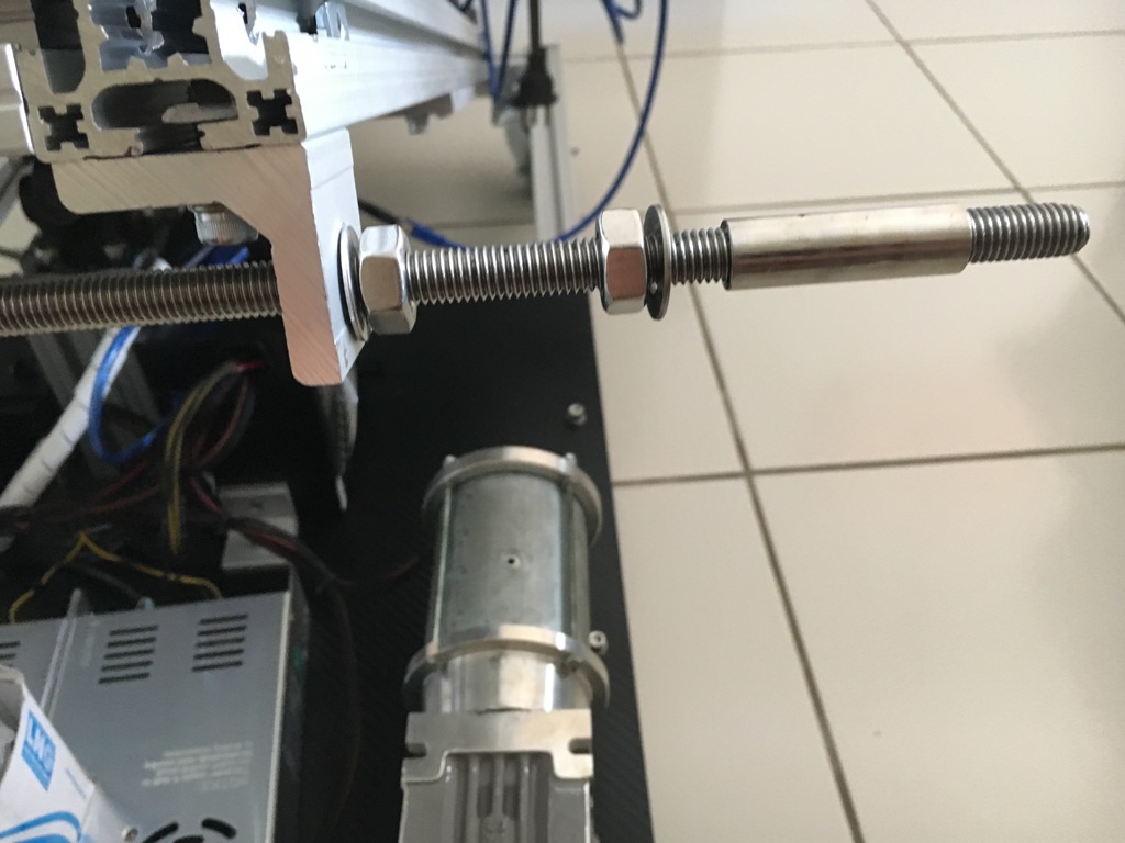

    Have you tried a shorter CTC hole on the levers?
    And did you balance the rig with yourself siting on it, along with all peripherals?

    Yes, I think I did it right.
    Would you have some place in the simtools to configure the power of the motors? Something like "full power"?

    No, SimTools does not do that, rather it is handled on the motor driver side.

    Tomorrow I'll try to do what you suggested, I'll start for a shorter CTC hole.

    News!
    I installed it on the CTC as close as possible to the motor shaft.
    Now it's all right !!
    I made some changes to improve the reliability because I noticed that the CTC already showed some signs of wear.
    ow it's closer to the middle of the shaft.
    Novidades!
    Instalei no CTC o mais próximo possível do eixo do motor.
    Agora sim, está tudo certo !!
    Fiz umas mudanças para melhorar a confiabilidade pois notei que o CTC já apresentou alguns sinais de desgaste. Agora ele está mais próximo do meio do eixo.

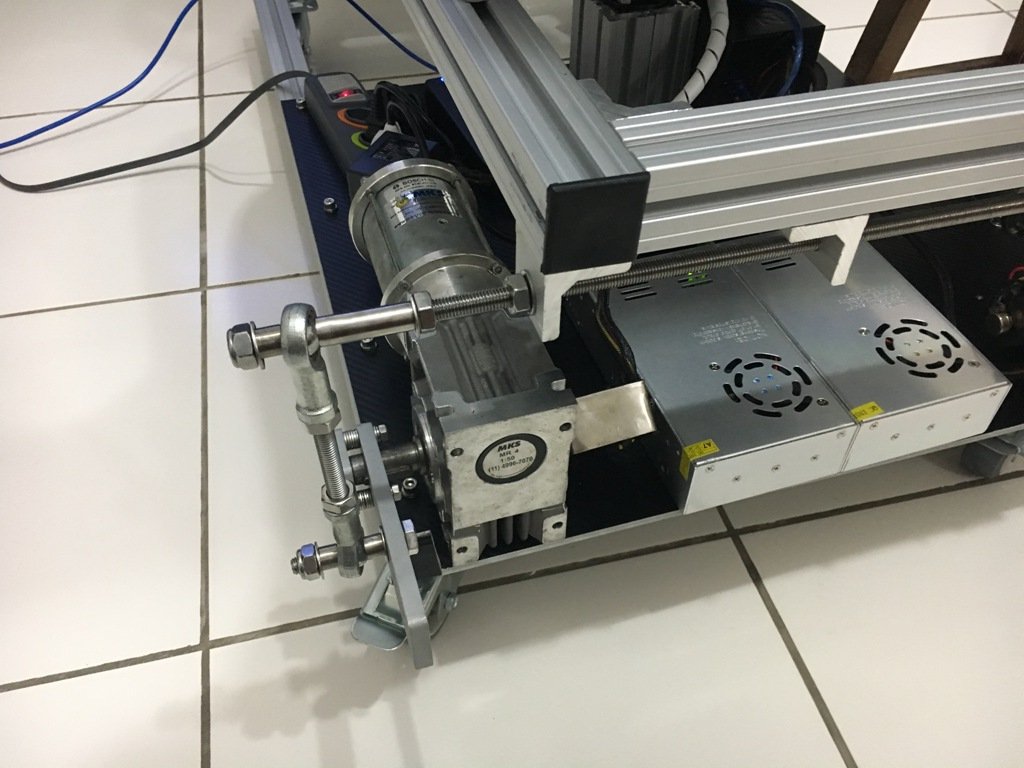

    Before: Note the simple actuators installed (left and right):
    After: (I modified to improve the actuators)

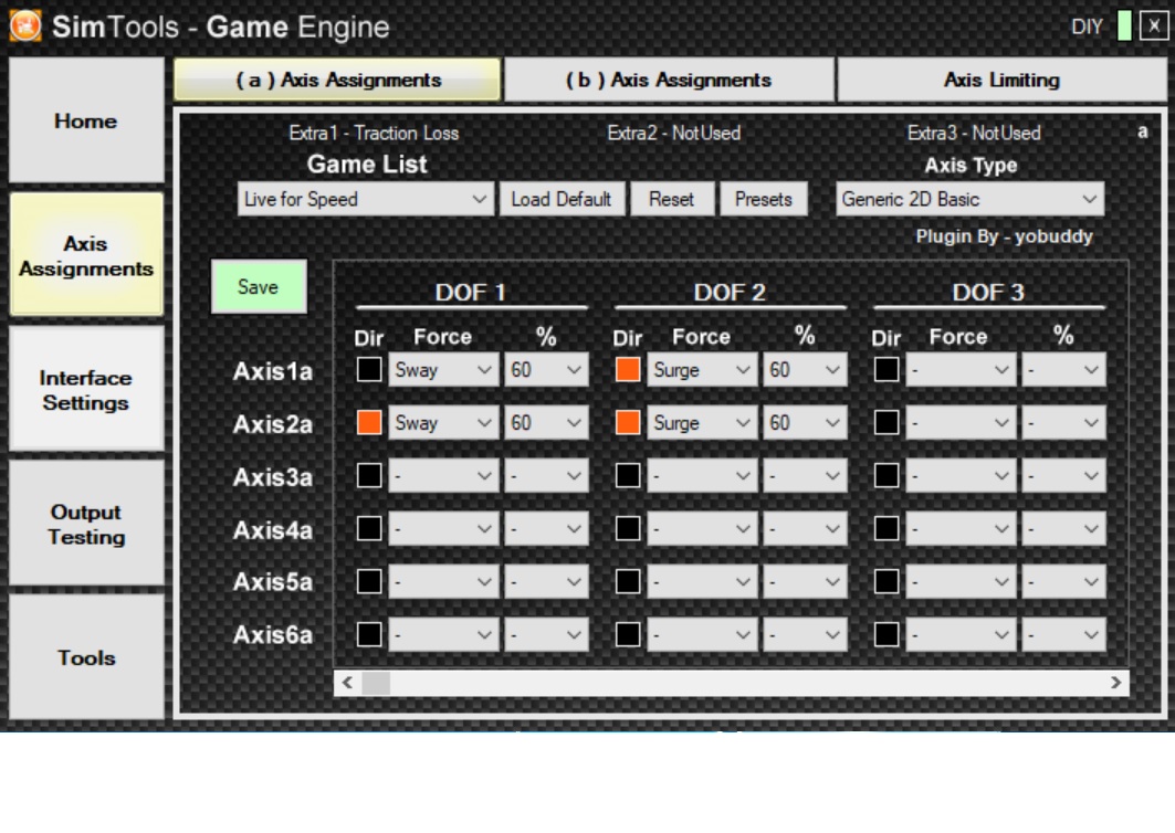

    Before today's modifications I had made a video with my daughter driving the LFS:
    I saw that the axles were inverted, that is when the rear brake was lowered, where the right thing was to get up.
    Today has already been corrected, it is still missing the video.
    Antes das modificações de hoje havia feito um video com minha filha dirigindo o LFS.
    Vi que os eixos estavam invertidos, ou seja quando freiava a traseira abaixava, onde o certo era levantar.
    Hoje já foi corrigido, falta fazer o video.
  11. stevemontuno
    stevemontuno Active Member
    Apr 24, 2015
    316
    UK
    1,461Coins
    +335 / 0 / -0
    Yes you need to invert your surge in simtools ,,,, Rig looks cool ,,,nice job :thumbs

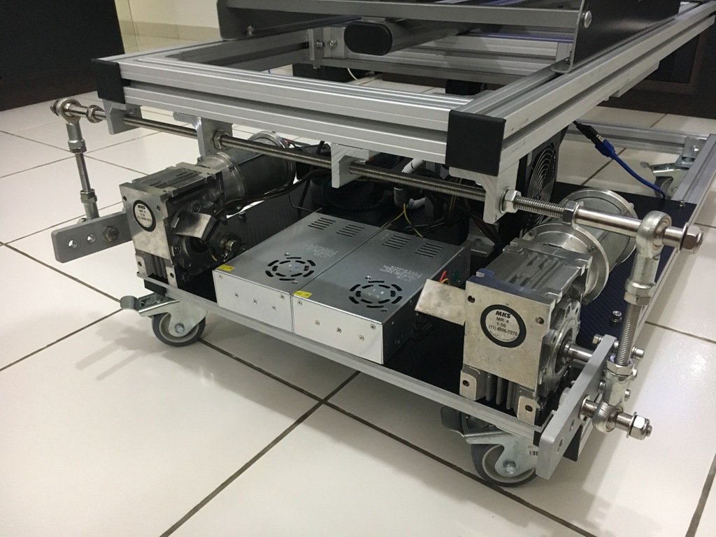

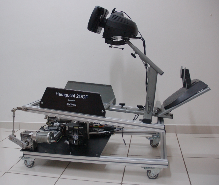

    Today I made (more) some modifications because the trigger was very long and was getting warped.
    Instead of passing under the cockpit frame I punched a hole through the profile and passed the trigger there.
    Let's see if with this modification the simulator is good.
    Hoje fiz (mais) lgumas modificações pois o acionador estava muito longo e estava ficando empenado.
    Ao invés de passar por baixo do quadro do cockpit fiz um furo por dentro do perfil e passei o acionador por lá.
    Vamos ver se com esta modificação o simulador fique bom.
    Before:
    After:

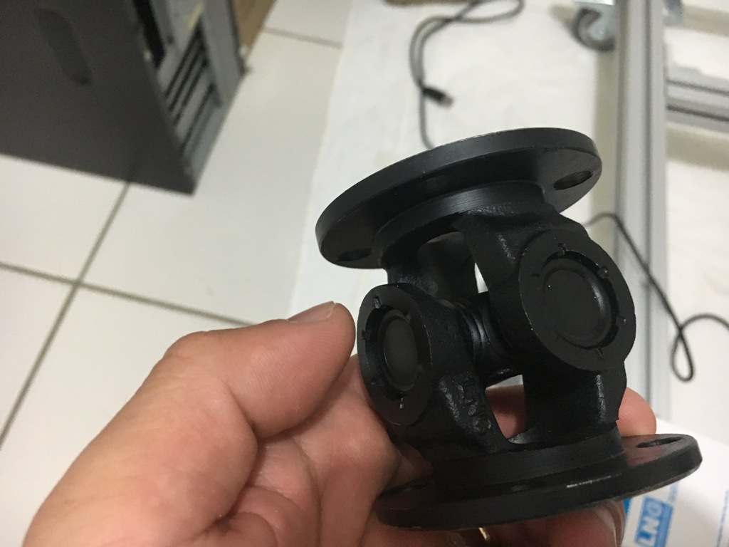

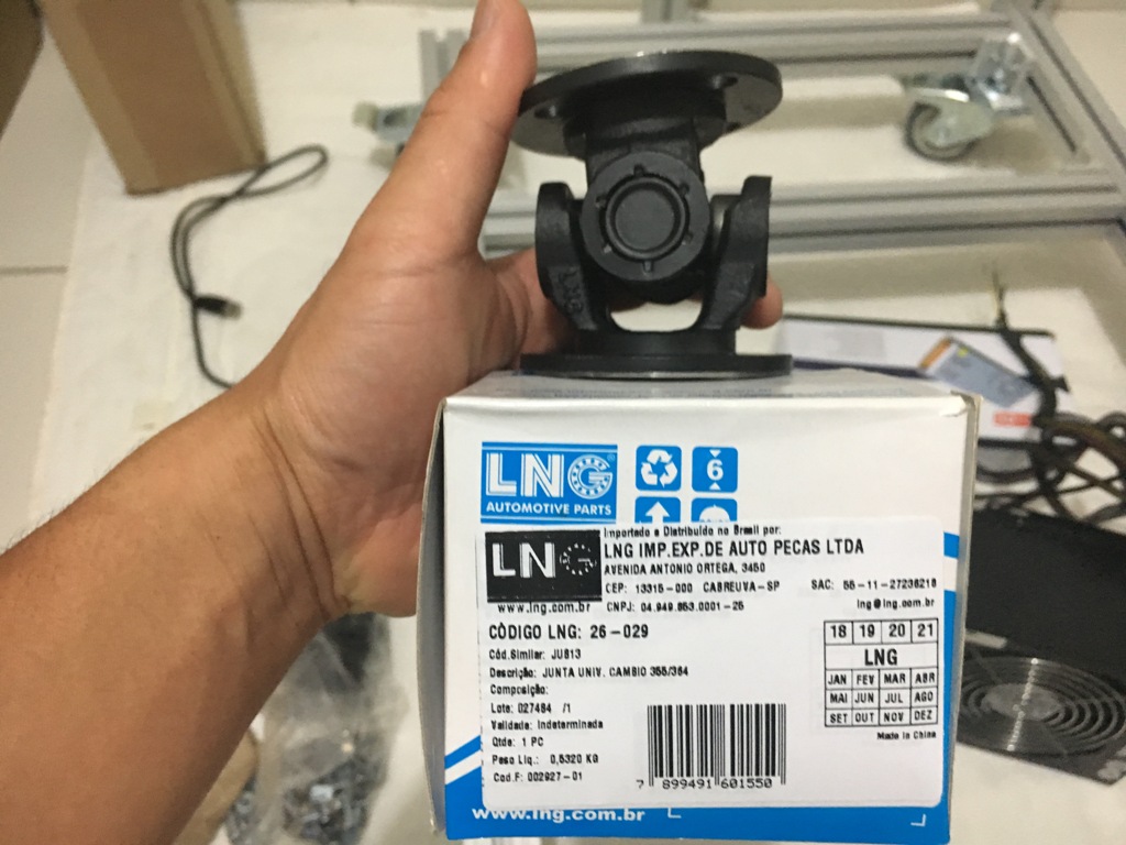

    Bonjour
    je suis très intéresse par l'arbre et se système de montage
    ou avez vous l'arbre et un prix Commandez quel

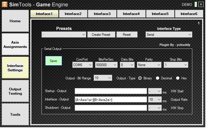

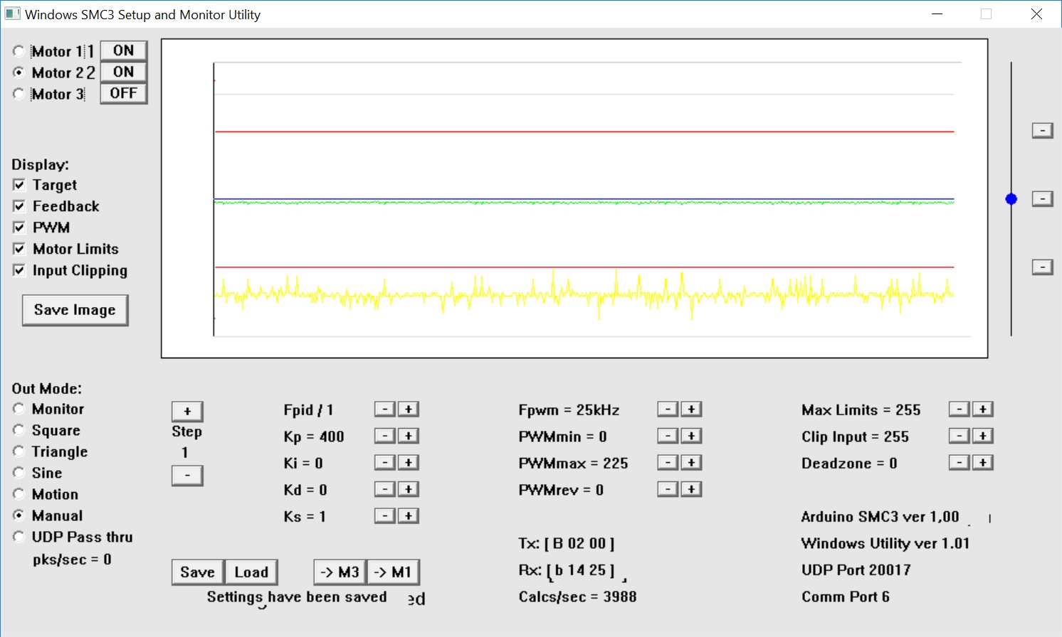

    Você poderia postar fotos da configuração do teu SMC3Utils e do SimToolsGameEngine ?
    Could you post photos of the configuration of your SMC3Utils and SimToolsGameEngine?

    Opa tudo bem ?
    Sim segue a tela dos eixos e a da interface: O simulador não está conectado ao PC, assim que eu conectar posto aqui ok.
    HI, how are you?
    It follows the screen of the axes and the interface: The simulator is not connected to the PC, so I connect post here ok.

    Bonjour Haraguchi
    merci beaucoup pour le lien de l'axe
    est que vous savez si il envoi dans le monde entier et plus particulièrement pour la France
    merci beaucoup

    Ok, the smc3 print:
