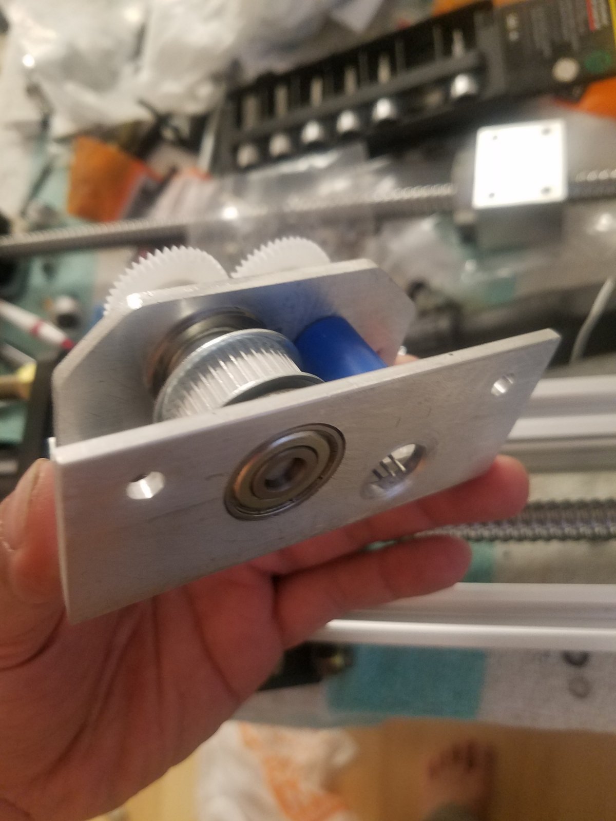

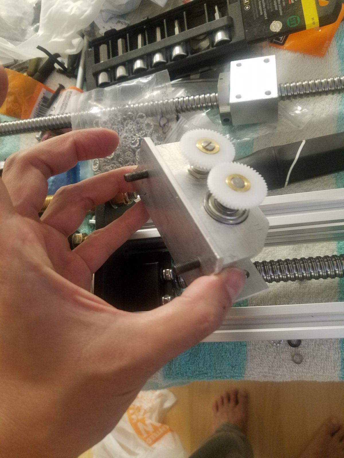

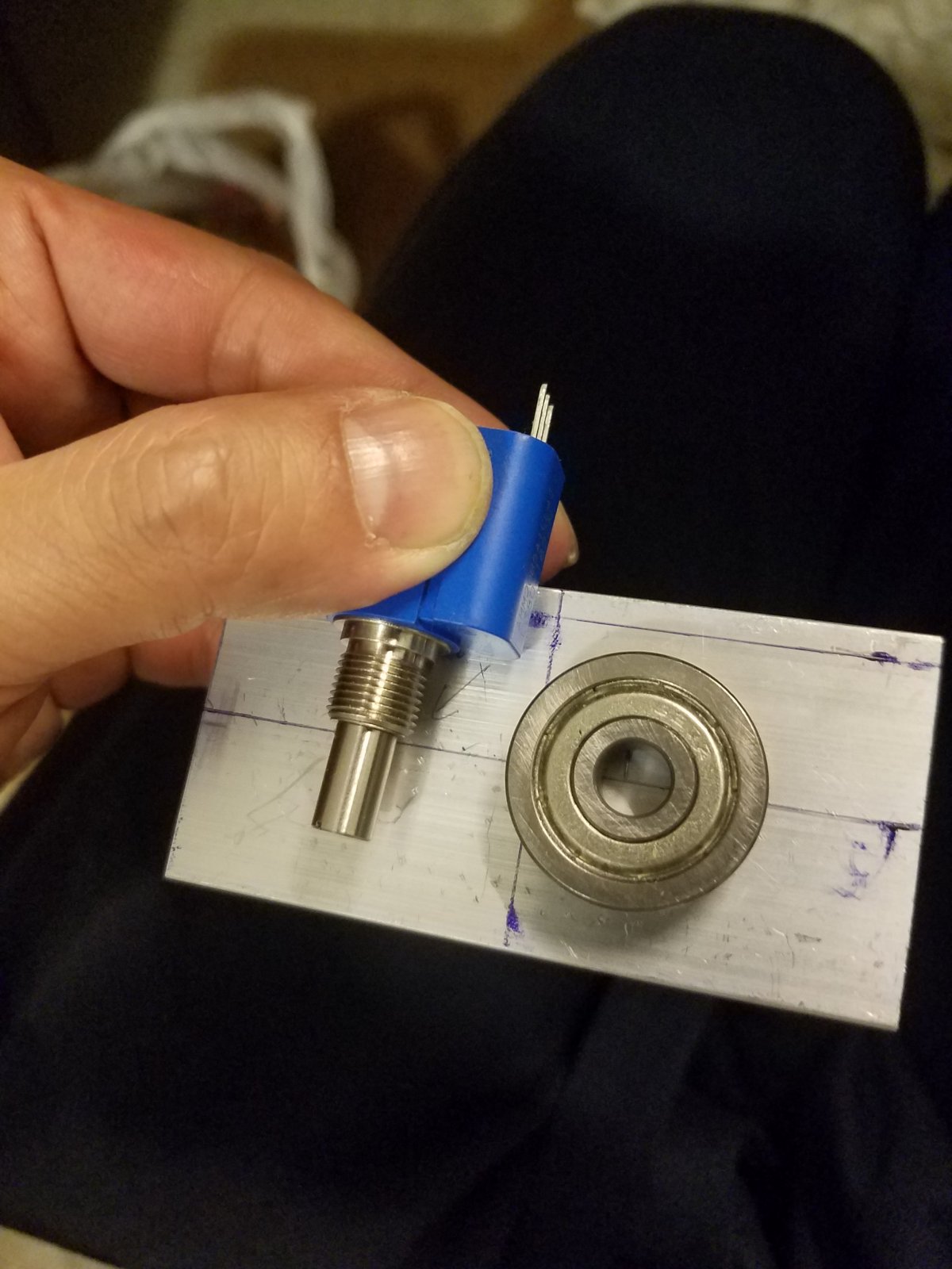

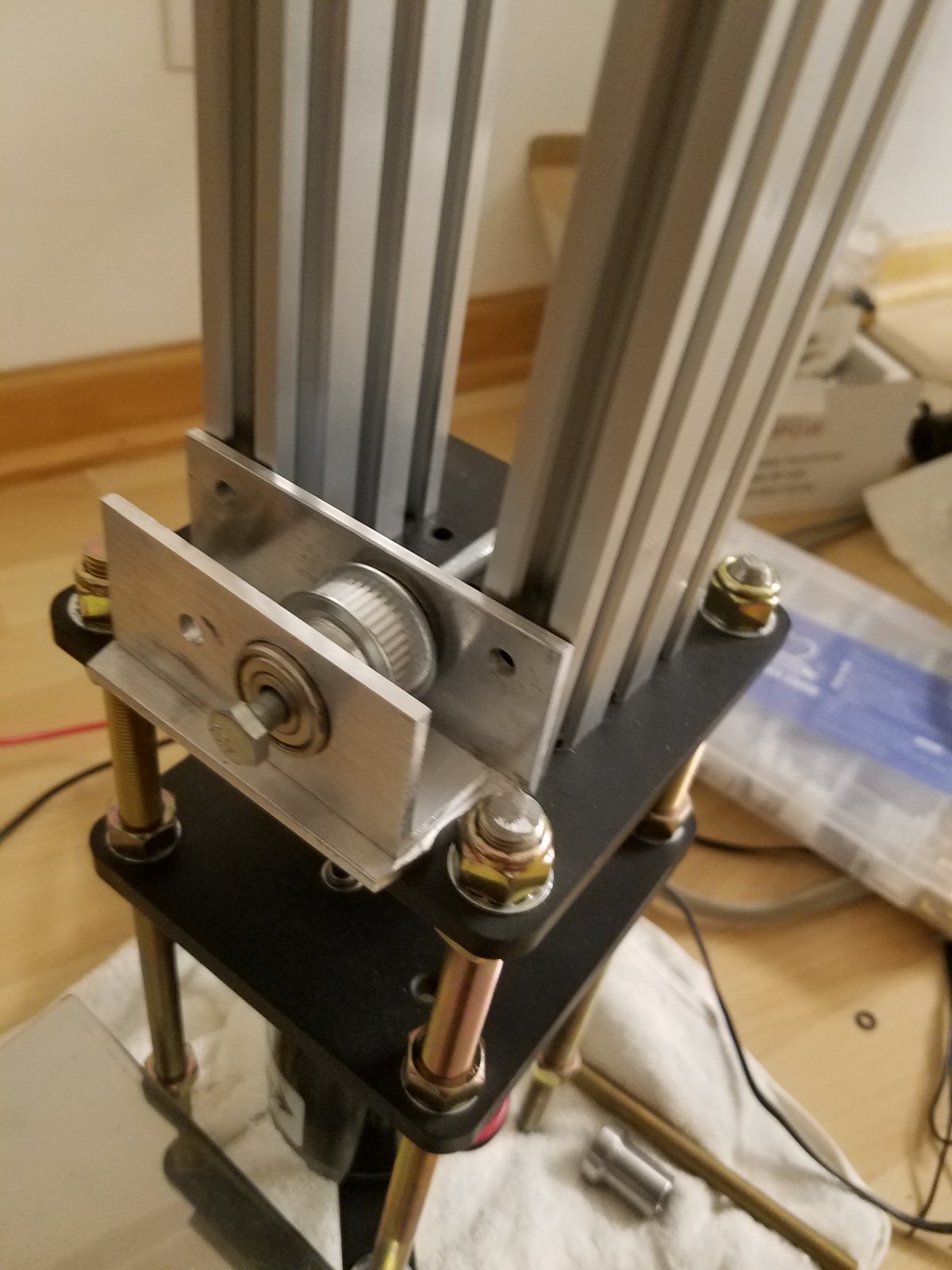

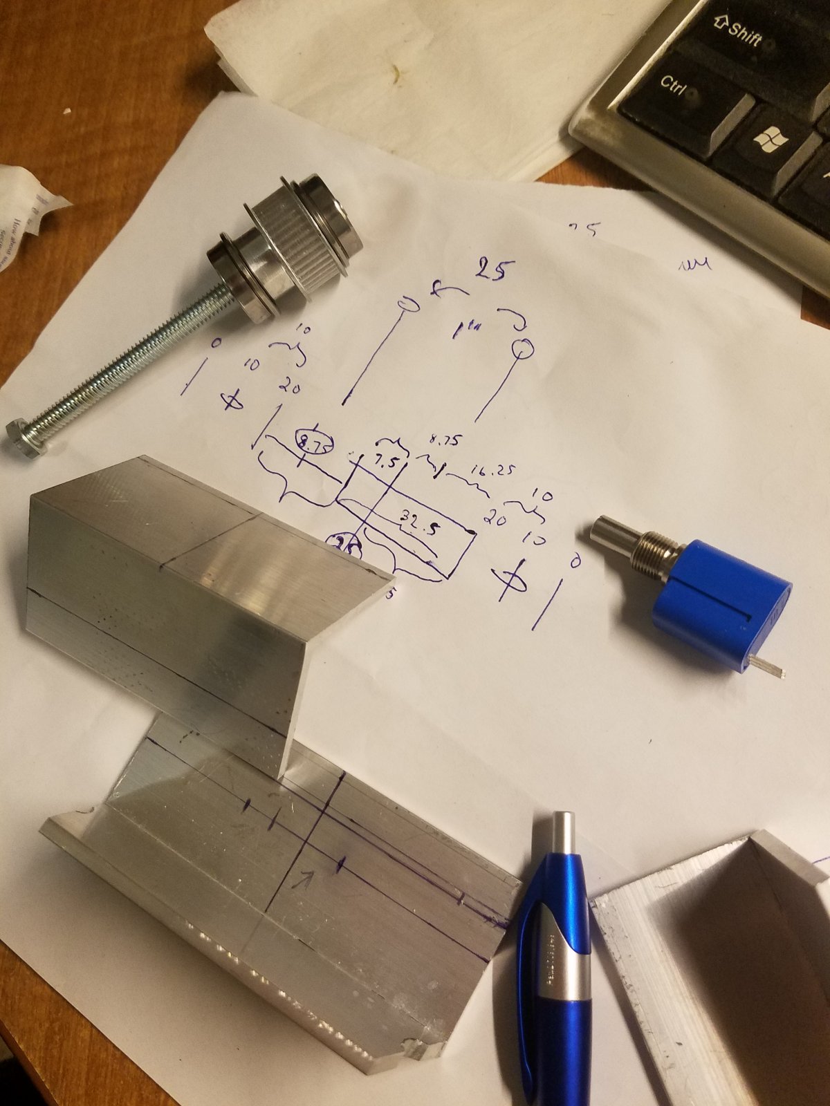

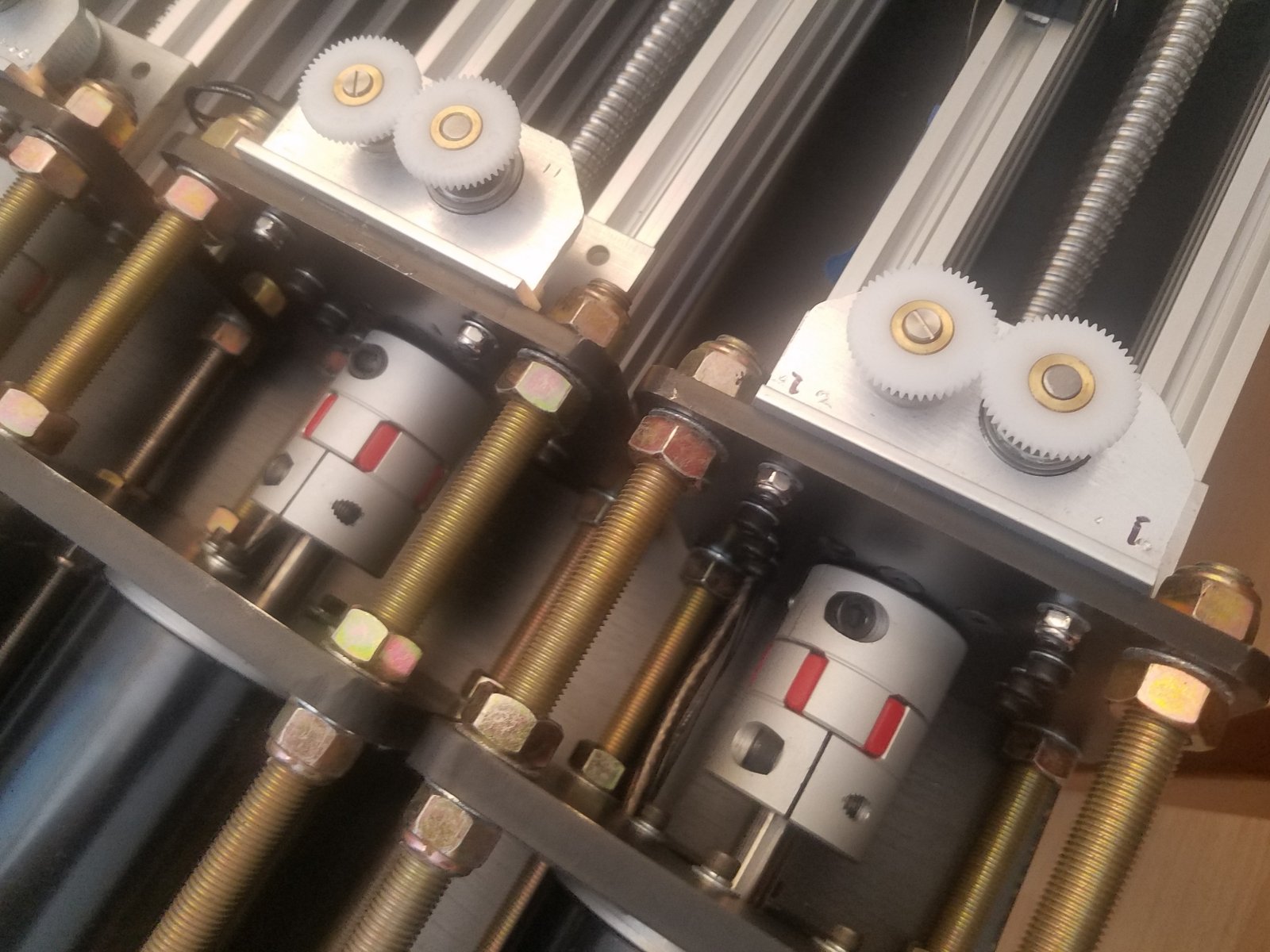

    Working on my pot pulley assy.. i try not to 3d print.. i dont trust my 3d print ability

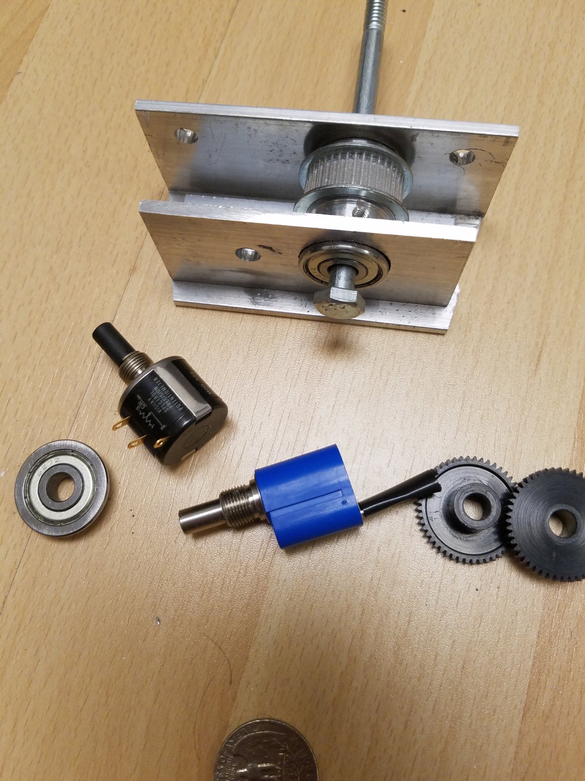

    @SilentChill I dont know how old u are sir. Young maybe.. energetic.. to plan for a new build! i think i would not have made it if i started with motors for 6dof.. (i am getting old) but im sure u learned alot in process .. but i understand your joy of the build.. its like sudoku..
    In mean time my pot pulley assy looking like something

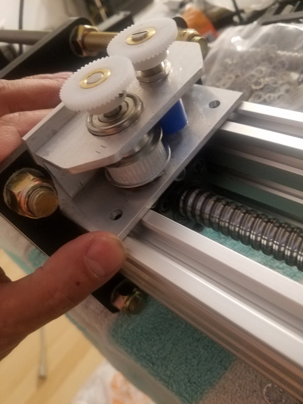

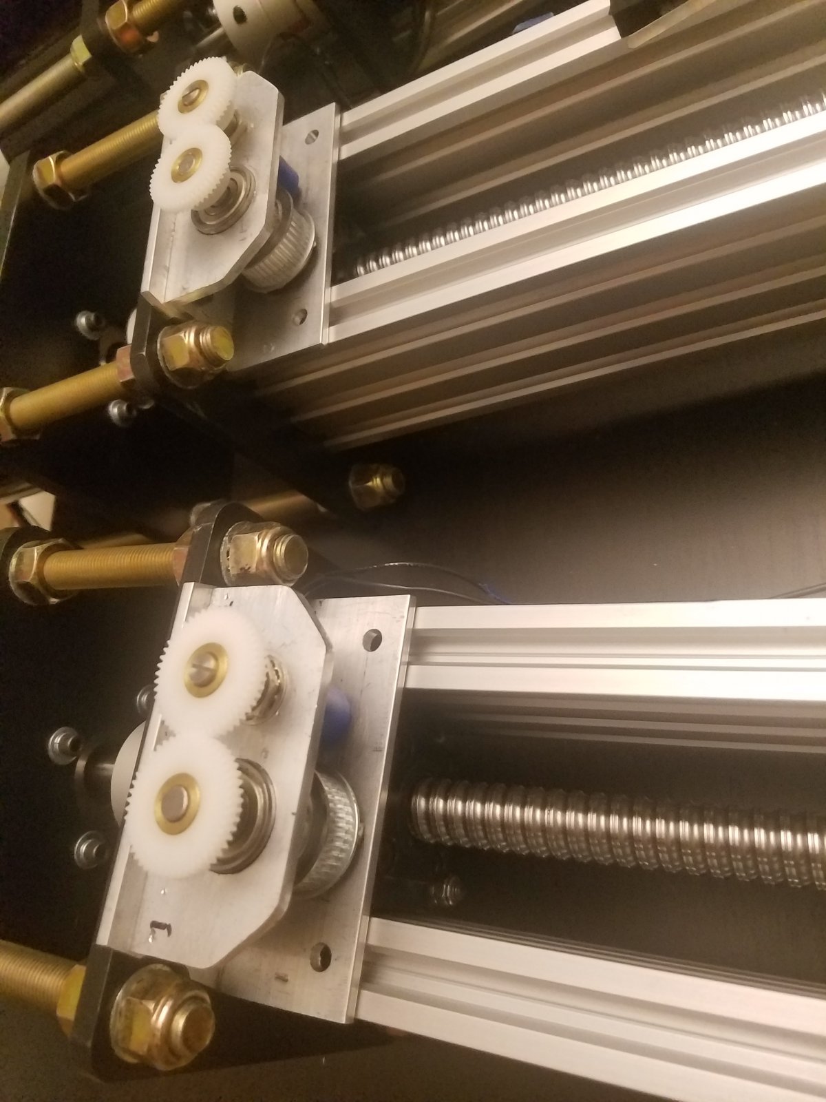

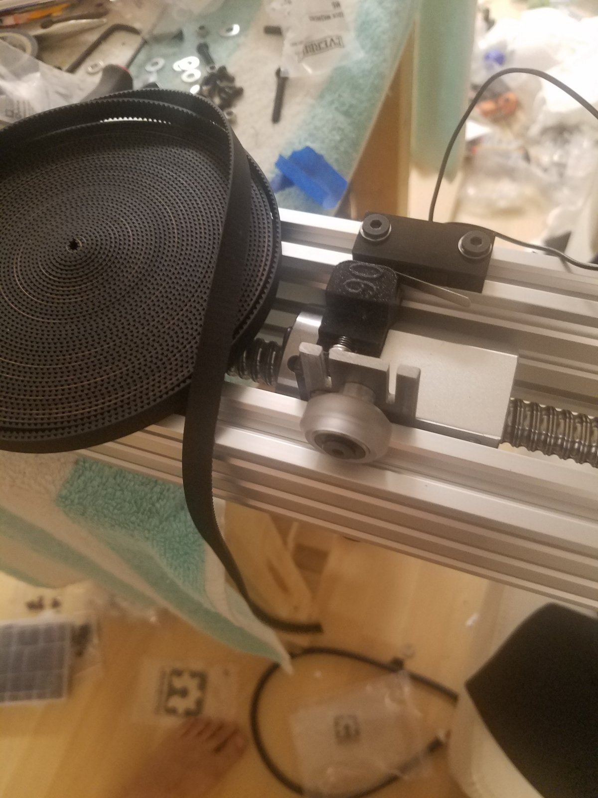

    Looking sexy.. but half way finished with 1... 5 more to go

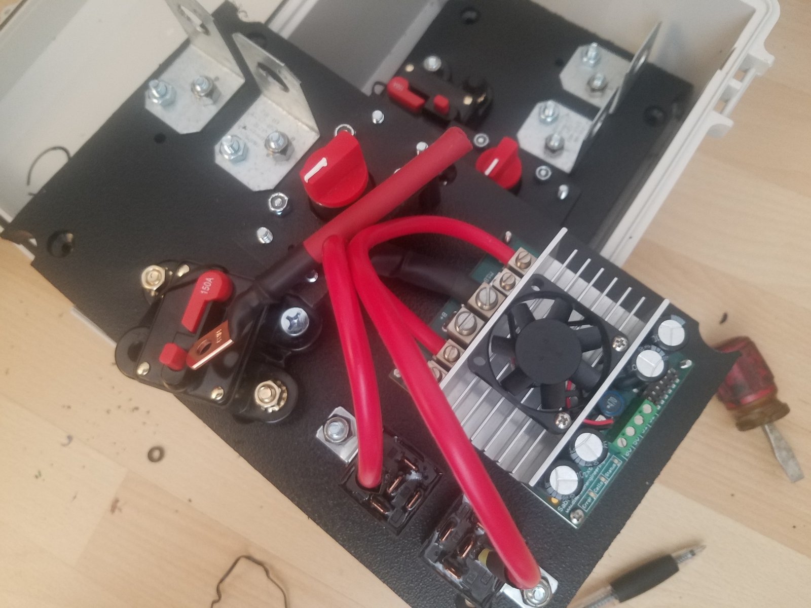

    Started to put one power section together

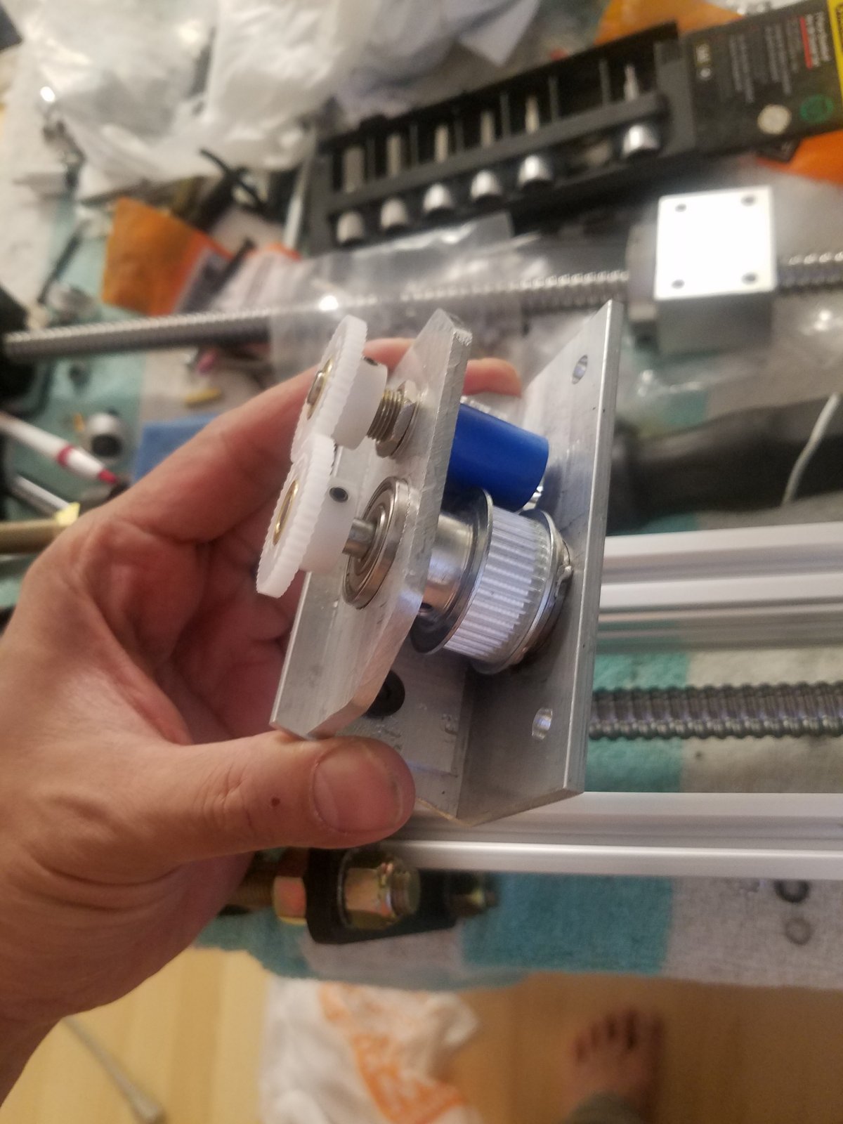

    Fabrication of my pot pulley assemblies

    1 fully finished pot pulley assembly.. 5 to go..

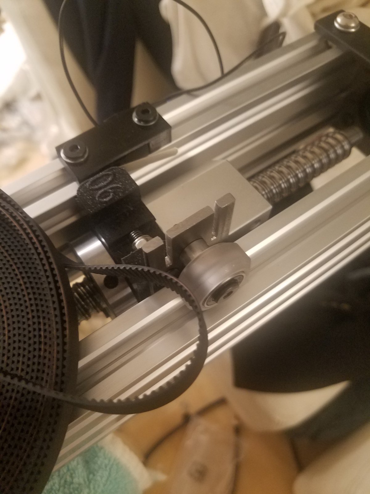

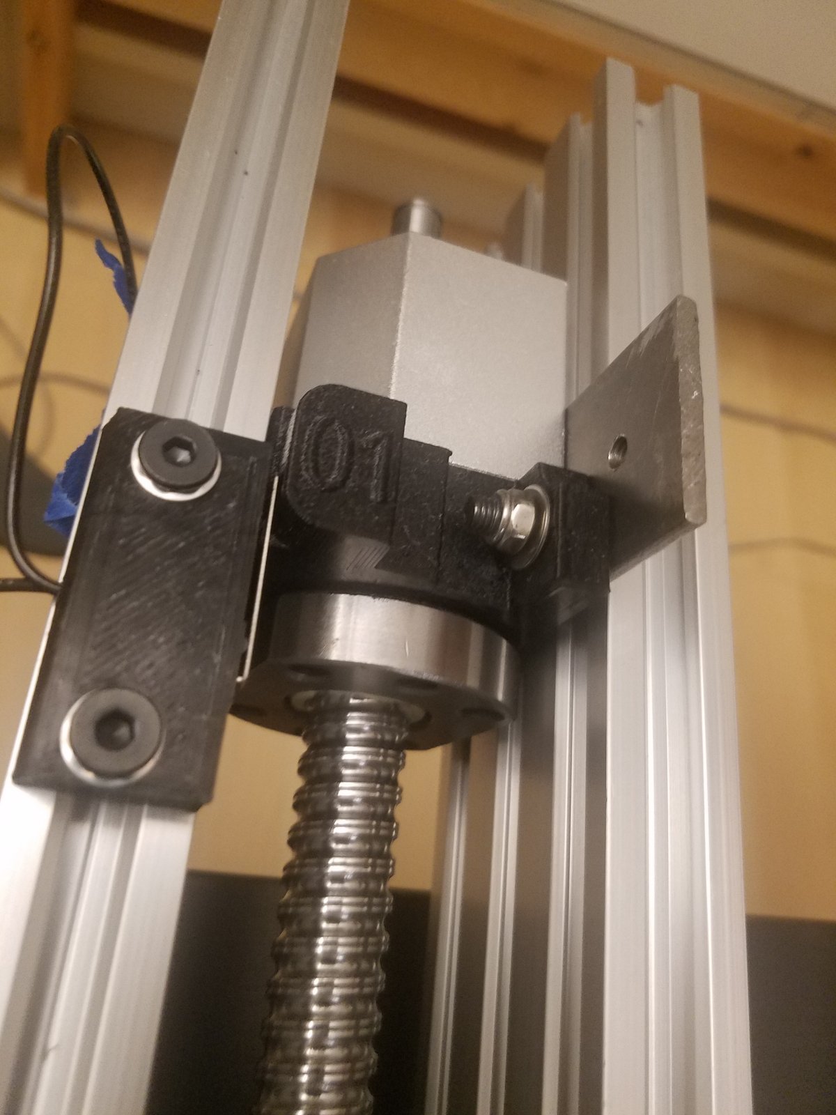

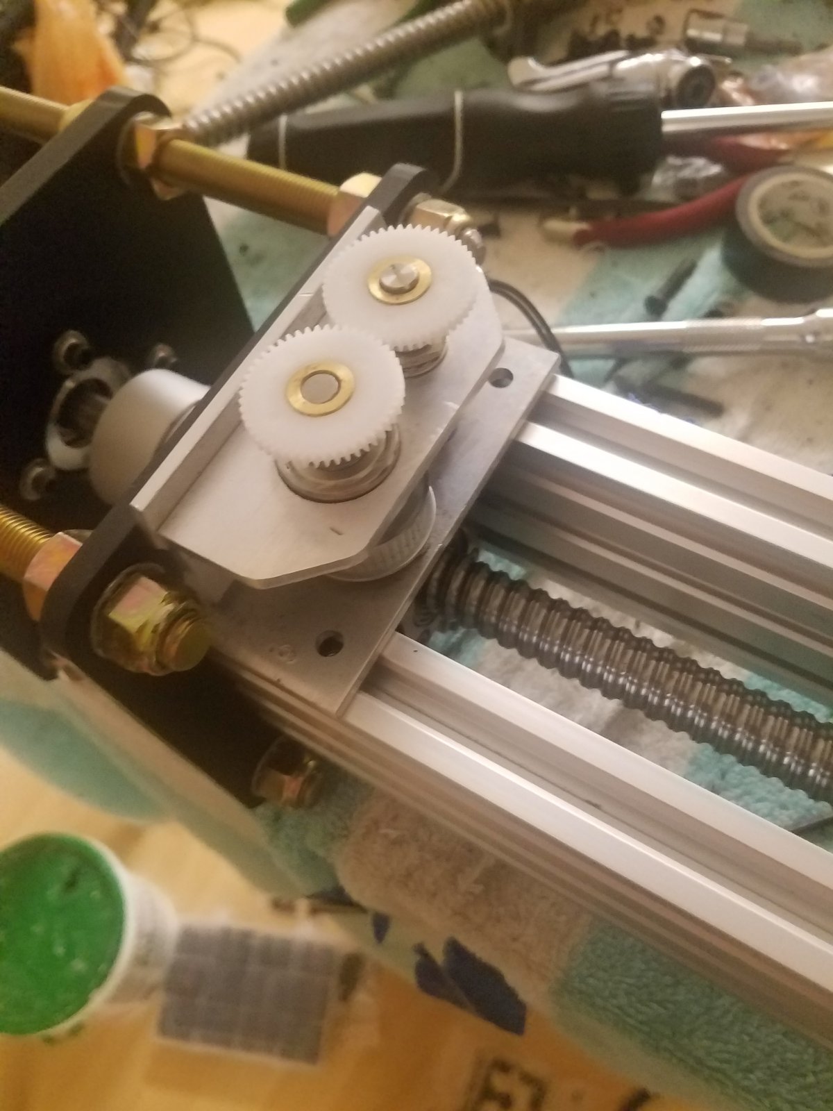

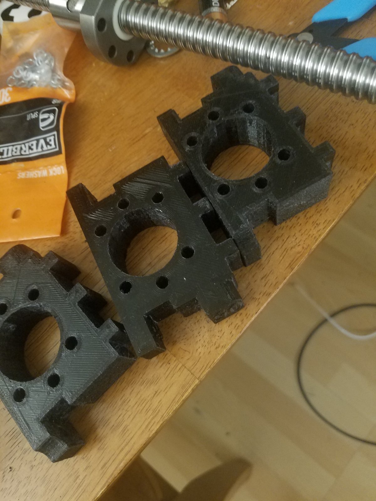

    Just some progress. Finalized my version of the anti rotation device.
    used the nut housing which i plan to epoxy the carbon tube with, but increased the surface area by adding a PETG 3d printed 20mm ball screw spacer..

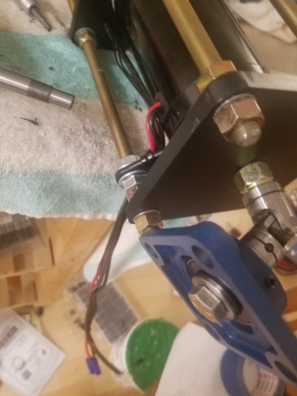

    One actuator ready for power.. only after i manage to finish the power section..

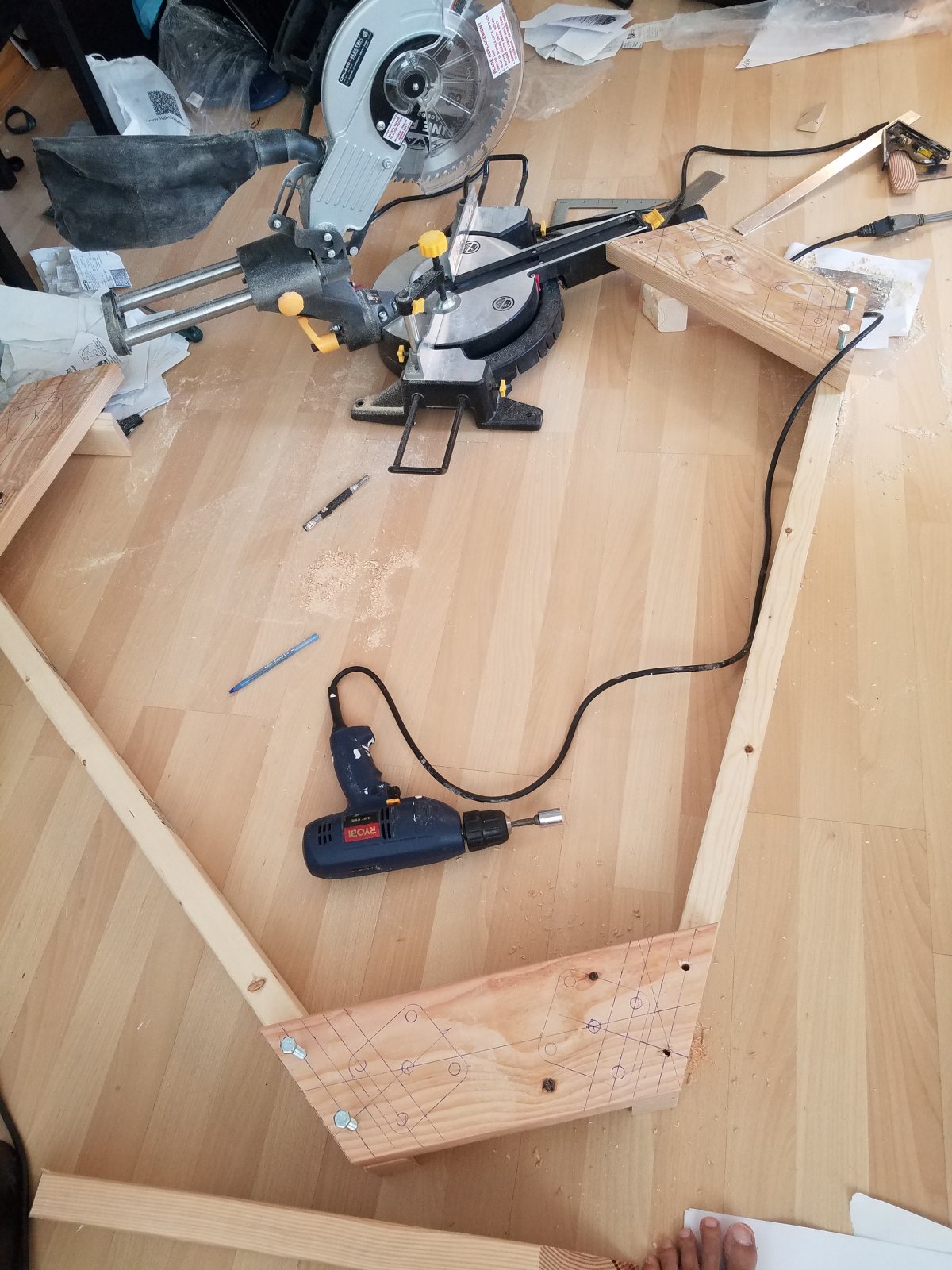

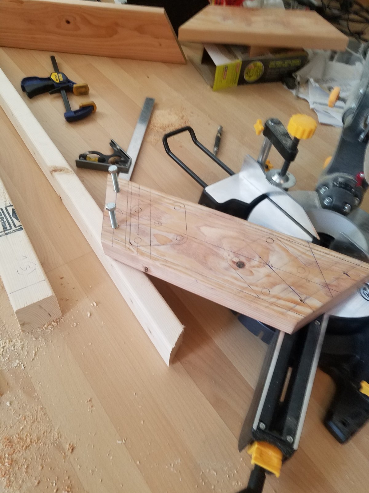

    Building again..

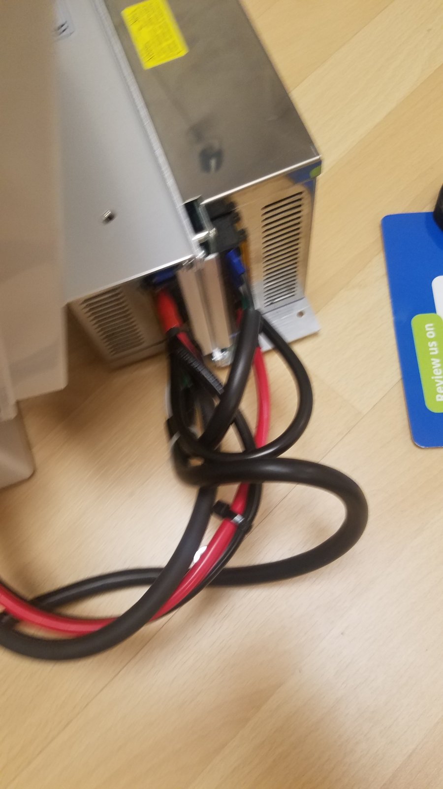

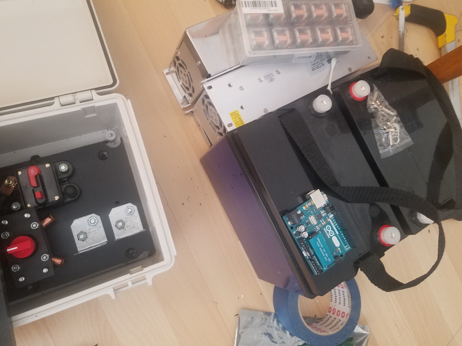

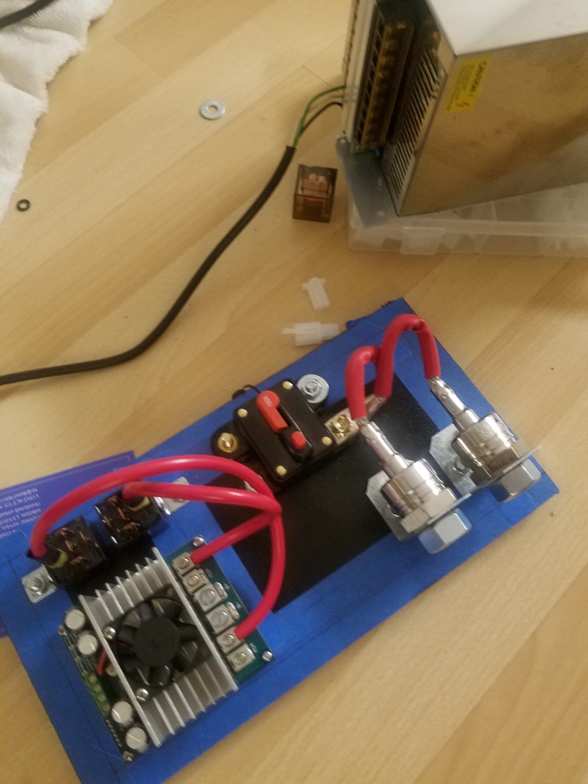

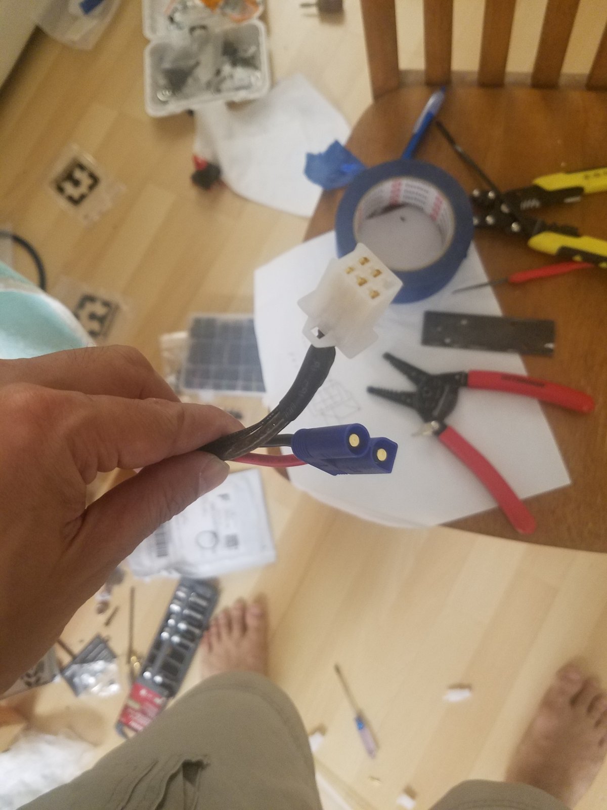

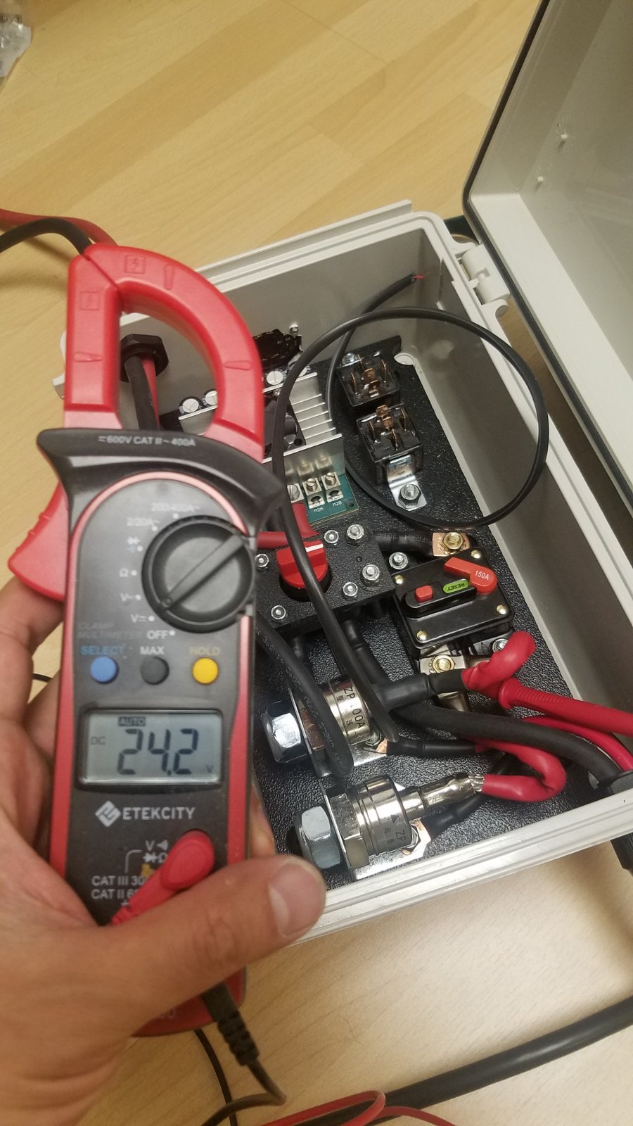

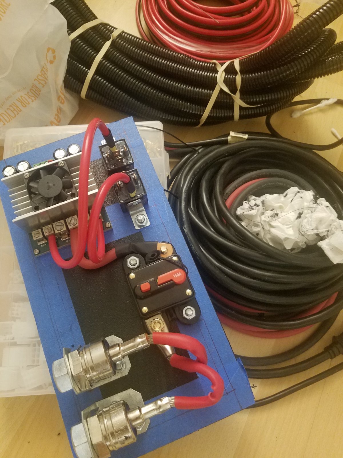

    working on the power section.
    but i have a question..
    im following the wiring for power similar to sixdegreesoflight..
    i am just wondering why he chose to have fuse protection for just power supplies instead of both the batteries and the power supples, since one side of the fuse block has both the batteries and sabertooth connected on positive...
    @wannabeaflyer2 @SilentChill @Flymen @pmvcda any idea?

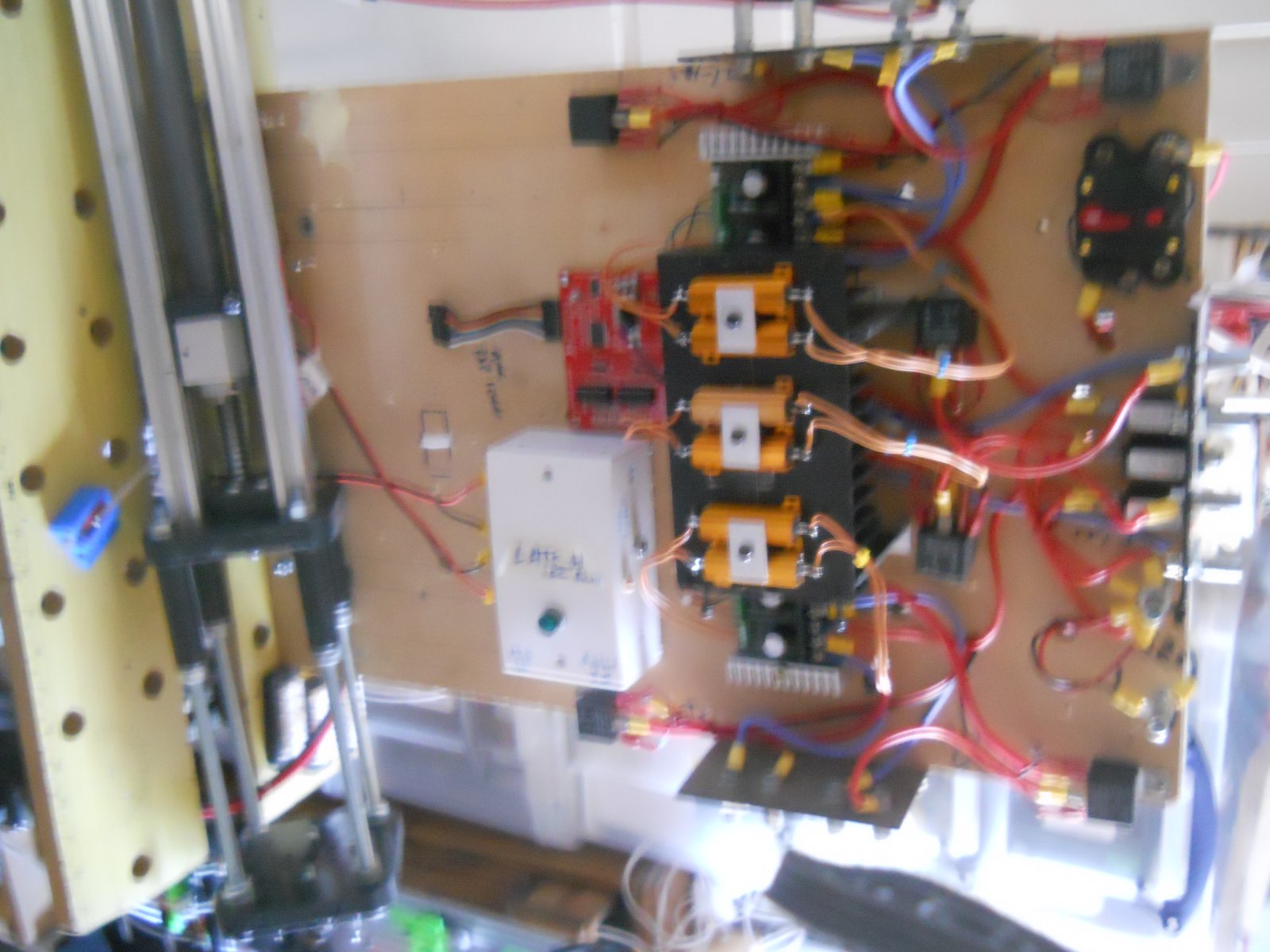

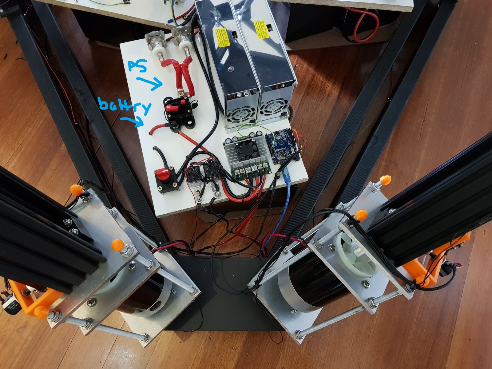

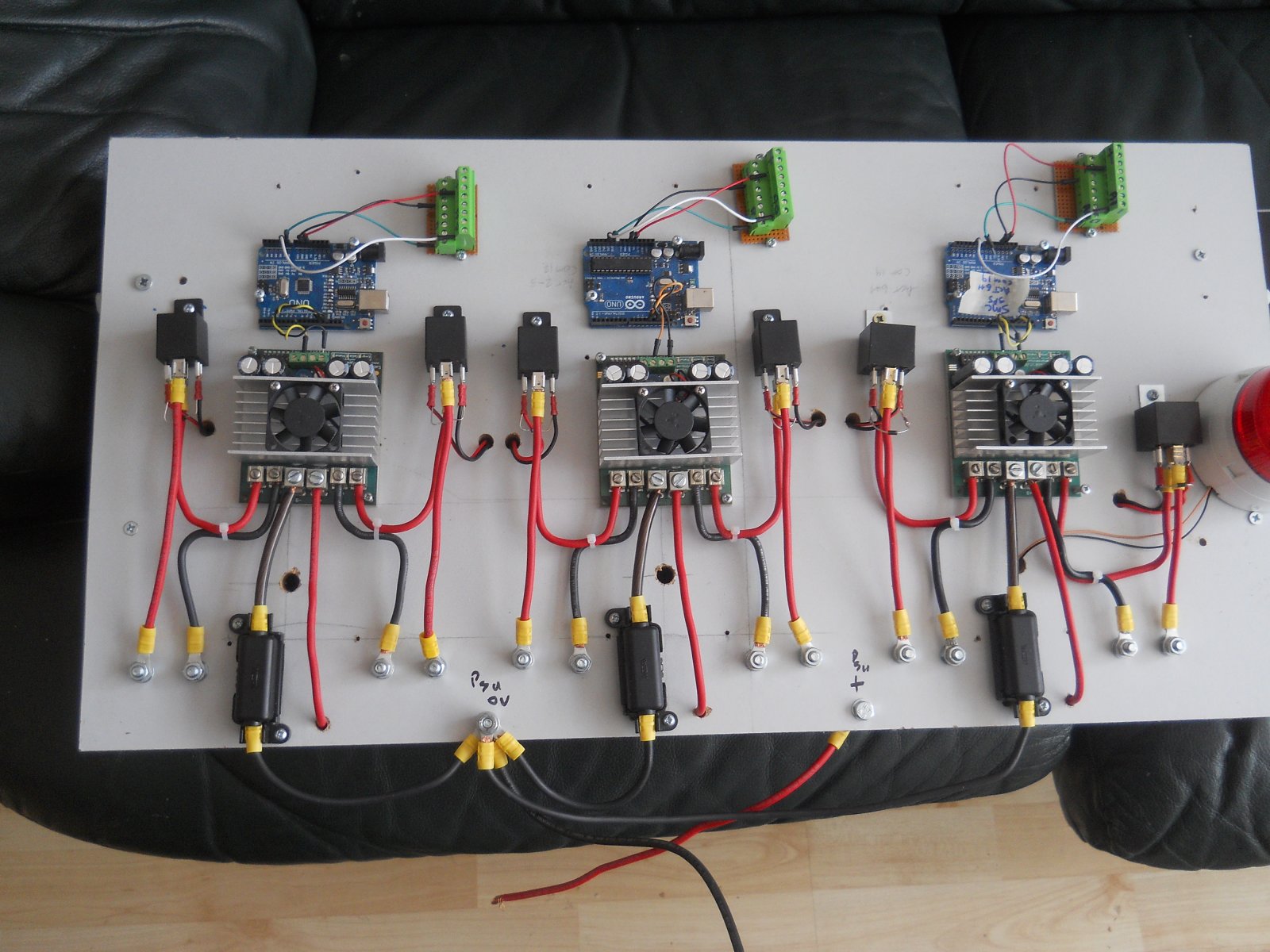

  18. wannabeaflyer2
    Jun 12, 2015
    724
    london uk
    8,359Coins
    +958 / 7 / -0
    Hiya @hannibal , well I'd have to say its a choice really depending on who you see for Electrical advice , I Have both Options on my layouts ,see dodgy pictures attached ,
    One uses a Main circuit breaker between Supply and shared Controllers . On the Other SMC version I opted for Fused connections to each Sabertooth and Only Main switch for 12Vdc supply .
    Either way the thought was any Overcurrent would obviously / Hopefully trip the fuse or Switch( with resettable Fuse ) before electrical damage due to excess current could occur ..
    But again I have not run my system for a long time but electrically those configurations should have been safe and fine ..
