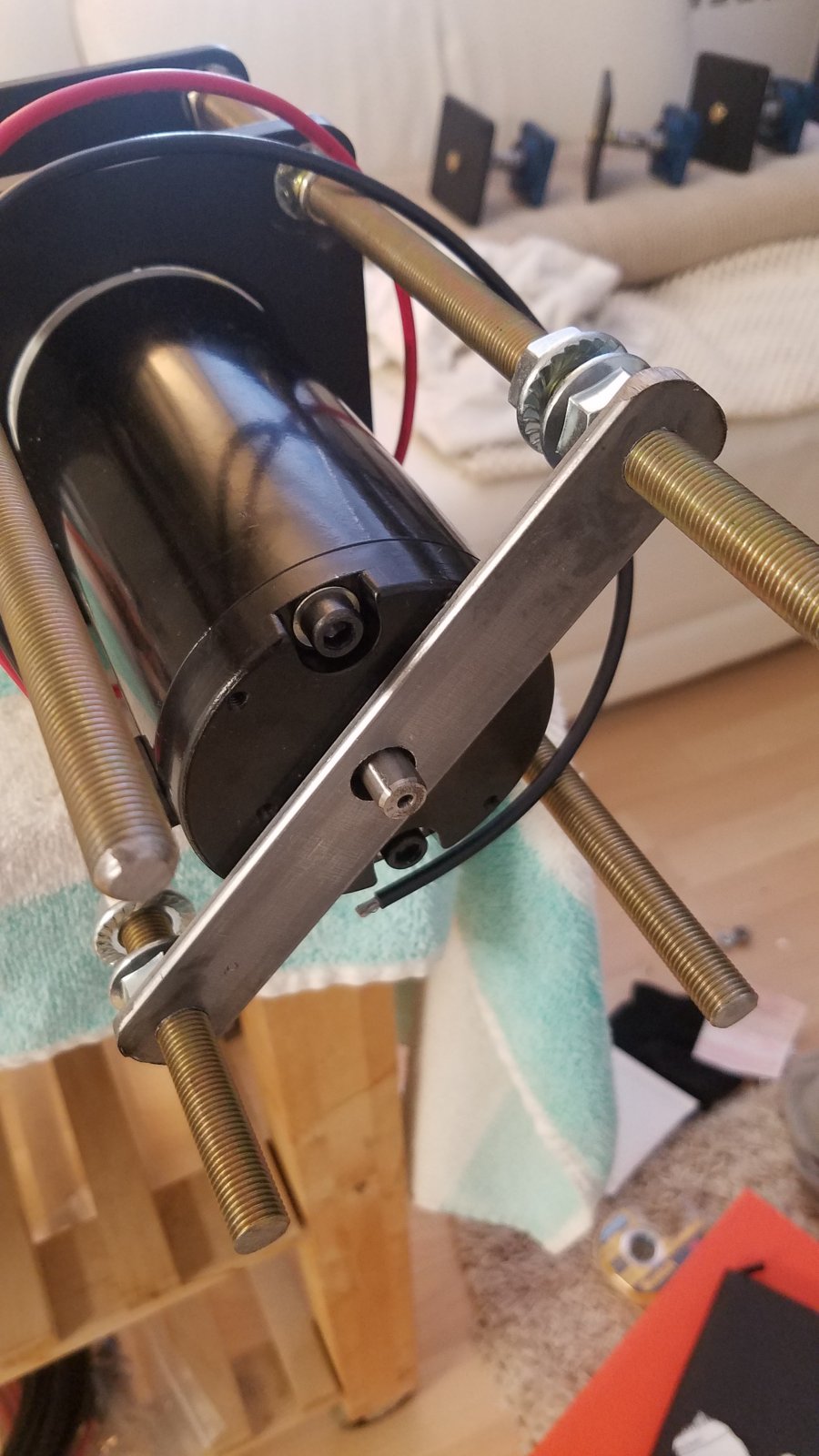

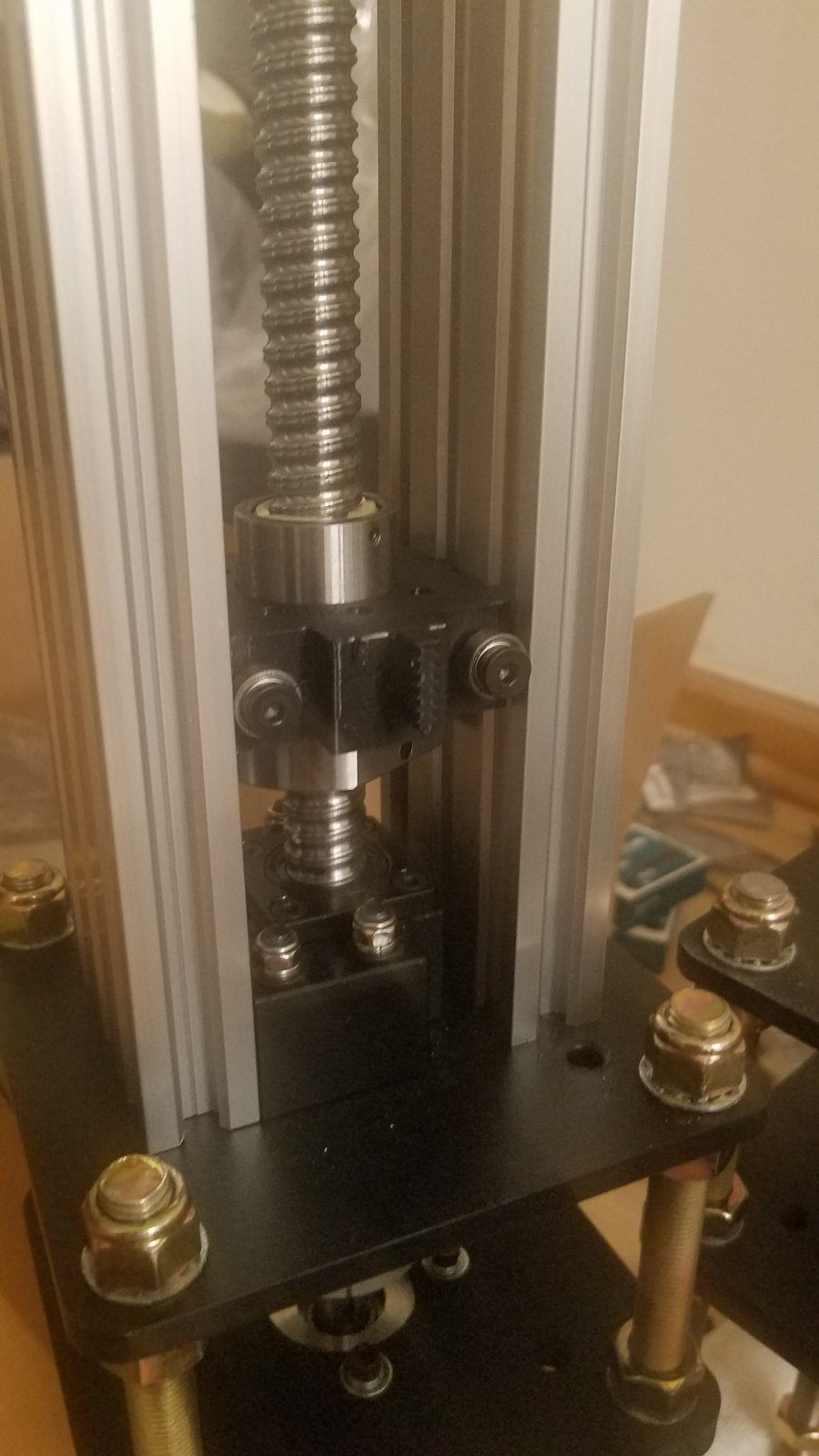

    Im trying to create my own anti rotation adapter...

    Tech Artist
    Quebec, Canada
    8,034Coins
    +945 / 6 / -0

  3. hannibal

    trying not to, rather ride the edge of the v-slot on 5mm x 10mm x 4mm bearings...

    Reinforcing the motor mount by additional 3/16 steel strap with 2x 6-32 bolts.. why so small ampflow??

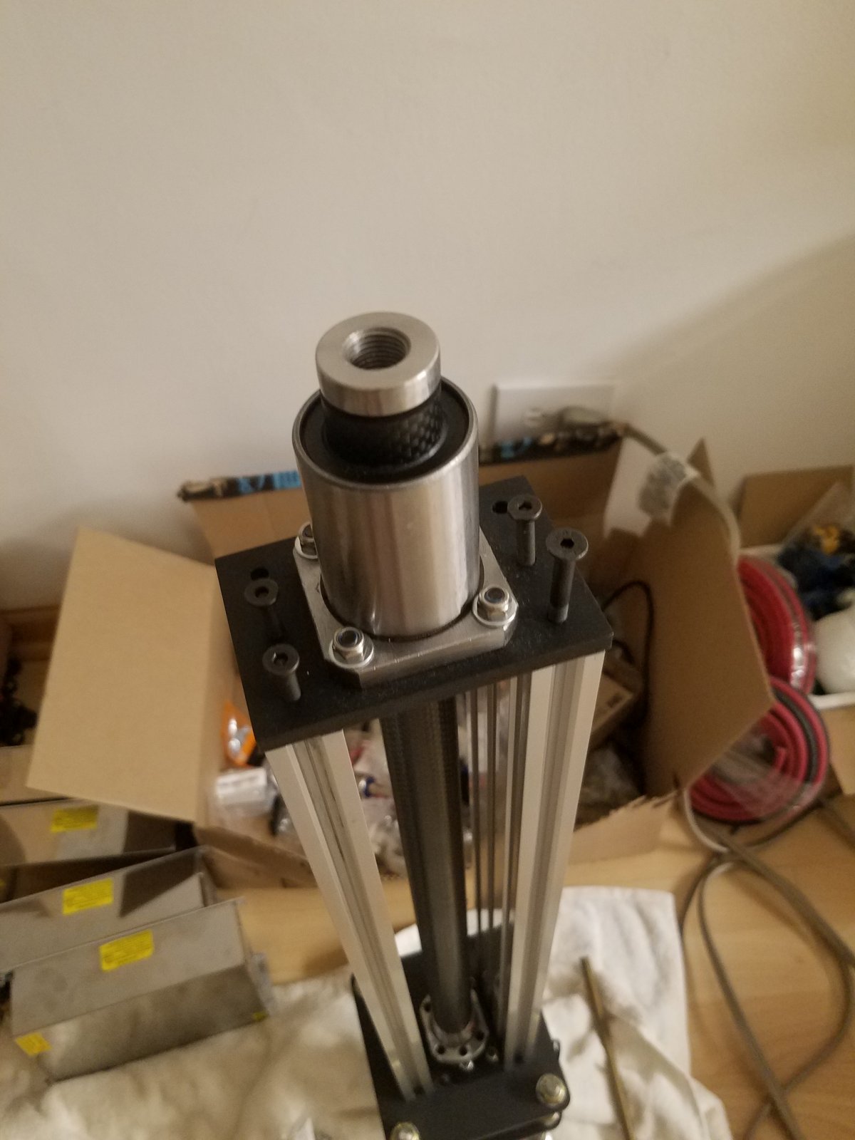

    its ok. the anti rotation.. i changed and went the conventional route, like everyone else... using 3d printers v-slot wheel.

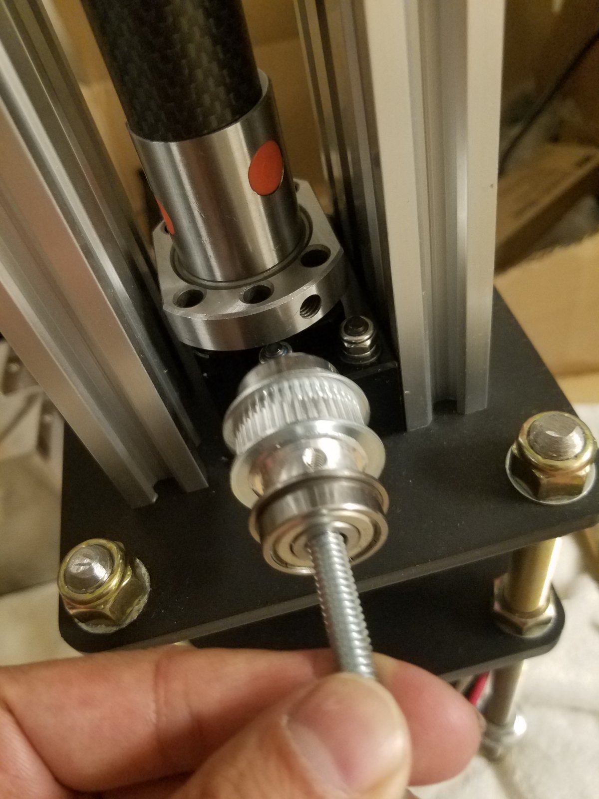

    Trying to finish the bottom section while figuring how to build pulley and pot assembly.. waiting for 22mm u bolts to come in.

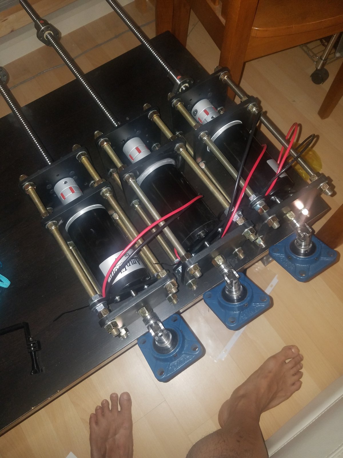

    Shot of bottom assembly

    Woah! Those look big and though. And I'm only talking about your feet. ;)

    lol.. it was late night.. i am now embarrassed... @Pierre Lalancette you just called me big foot! :p

    Waiting for 22m u bolts for my pot assembly along with hall sensors.

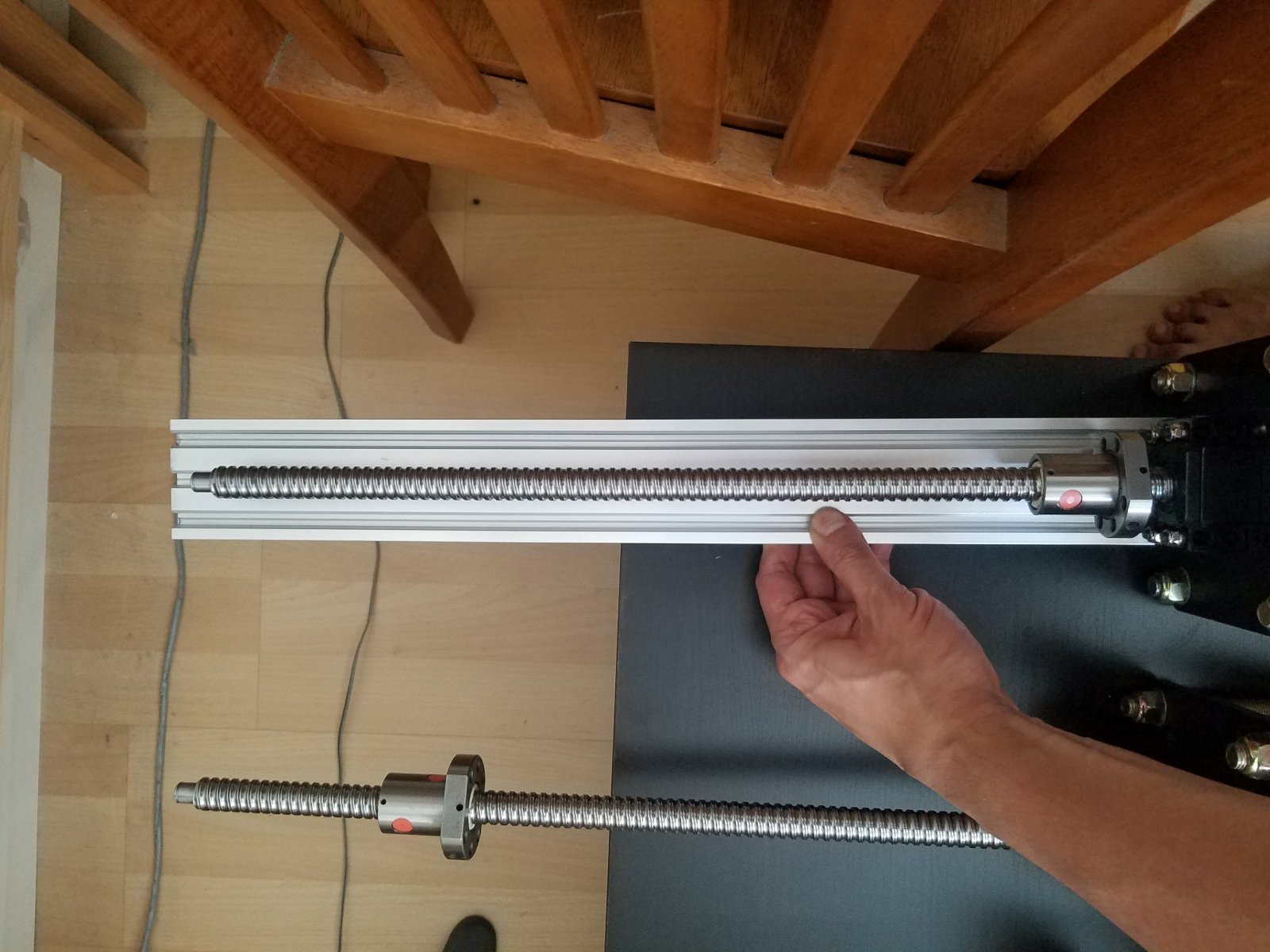

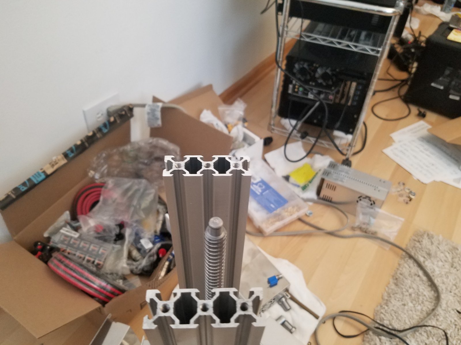

    its come to my attention that one of my actuator v-slot rail is not aligned with the ball screw...
    looking at shimming the bearing block...
    i dont think the screw is bent because there is no deflection when i rotate it.
    checking the v-slot rail, it seems more or less square 90 degrees..
    anyone has ideas to align screw parallel to screw besides shiming? perhaps i have a bad bearing block BK12?
    @wannabeaflyer2 @Pierre Lalancette @noorbeast @SilentChill @Flymen

    Have you a picture what you mean ? Mine arent alligned properly infact they are all skewiff but hey it works :D

    One of my actuators dont align to the top.. but checking 2 others they are pretty much around center...

    from looking at it, i feel it is the bearing block wasnt machine correctly to fit bearings. the base with motors and plates are with in my measurements.

    How are you planning on attaching the carbon fiber tube to the ballscrew? I'm having a hard time getting my head around how people are doing that...

    img going to use the nut housing. it will be epoxied with 3M 2216 A/B epoxy and using another piece of carbon tube 28mm OD 25mm ID as a shim... at the moment i am working on the power section, and the pot /pulley housing..

    +298 / 4 / -0
    im going at snails pace.. but i want to build it right the first time. if i dont have to go back and forth later, ill deal with it now. definitely need patience for DIY.
    right now 3 actuators are lined up properly, where as the other 3 are not.. trying to figure out what is the misalignment issue between V-slot and ball screw.
