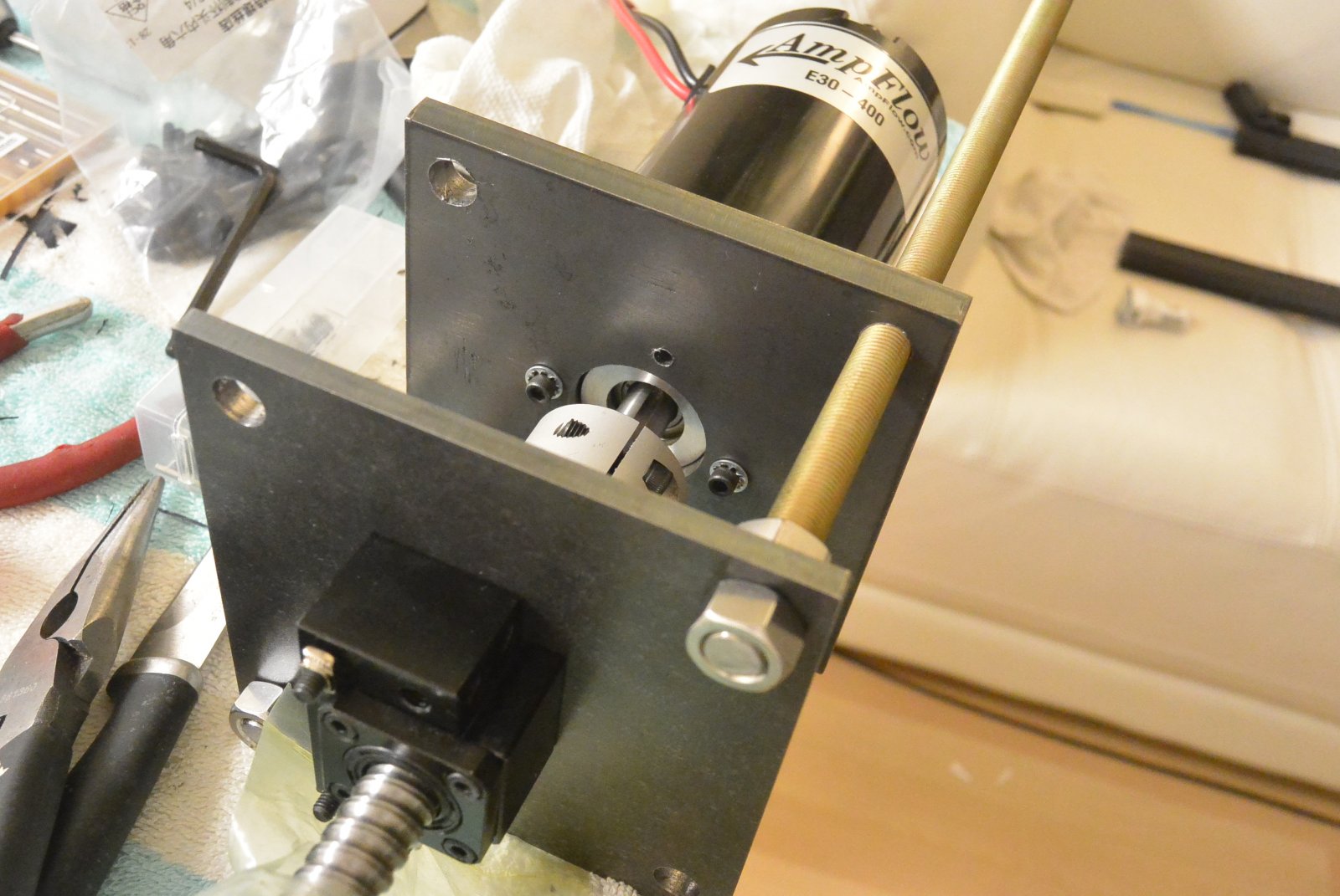

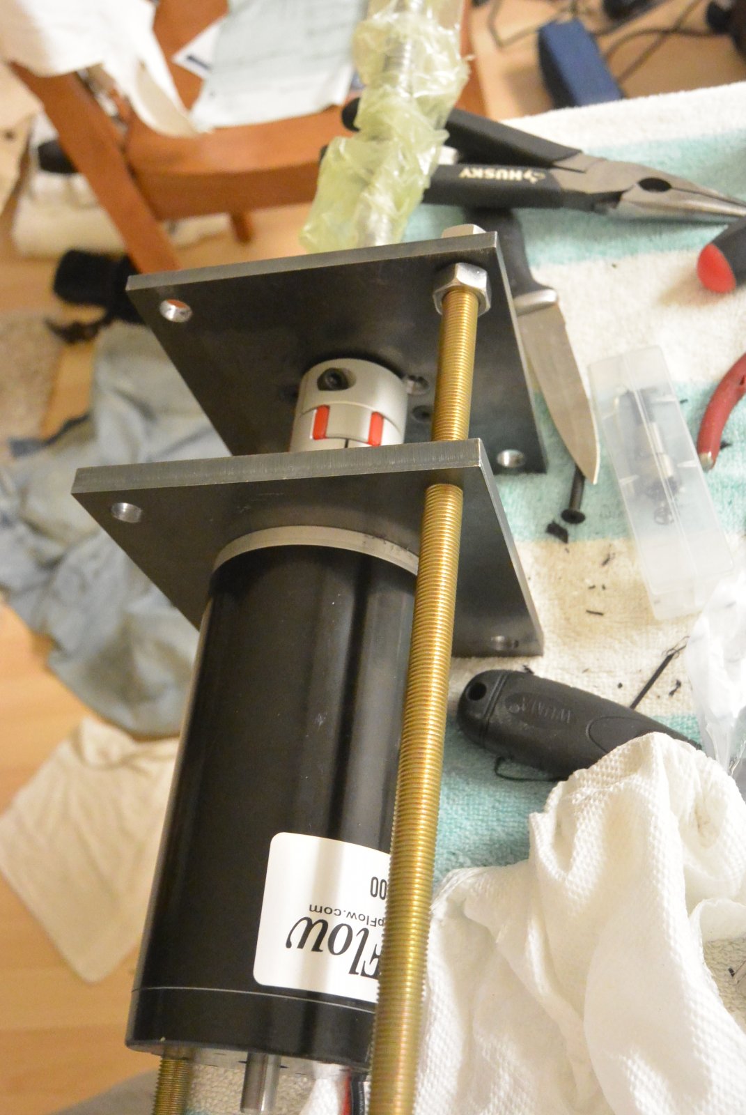

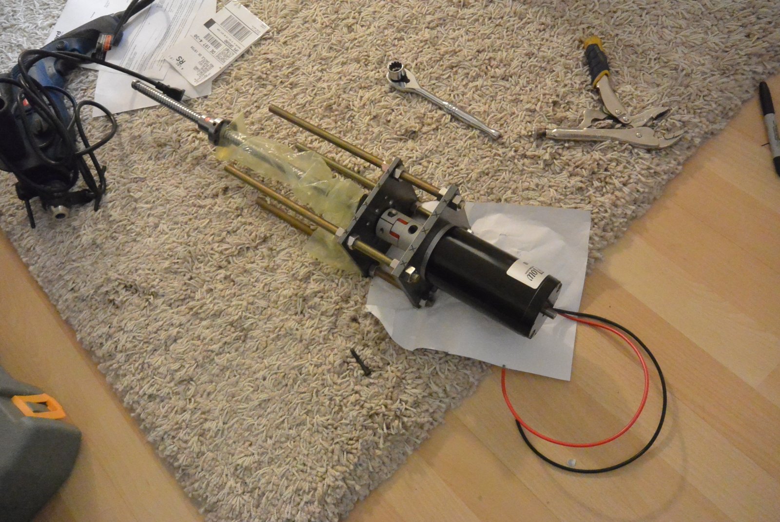

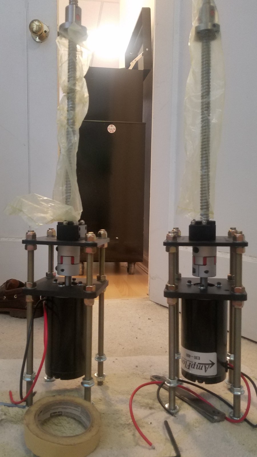

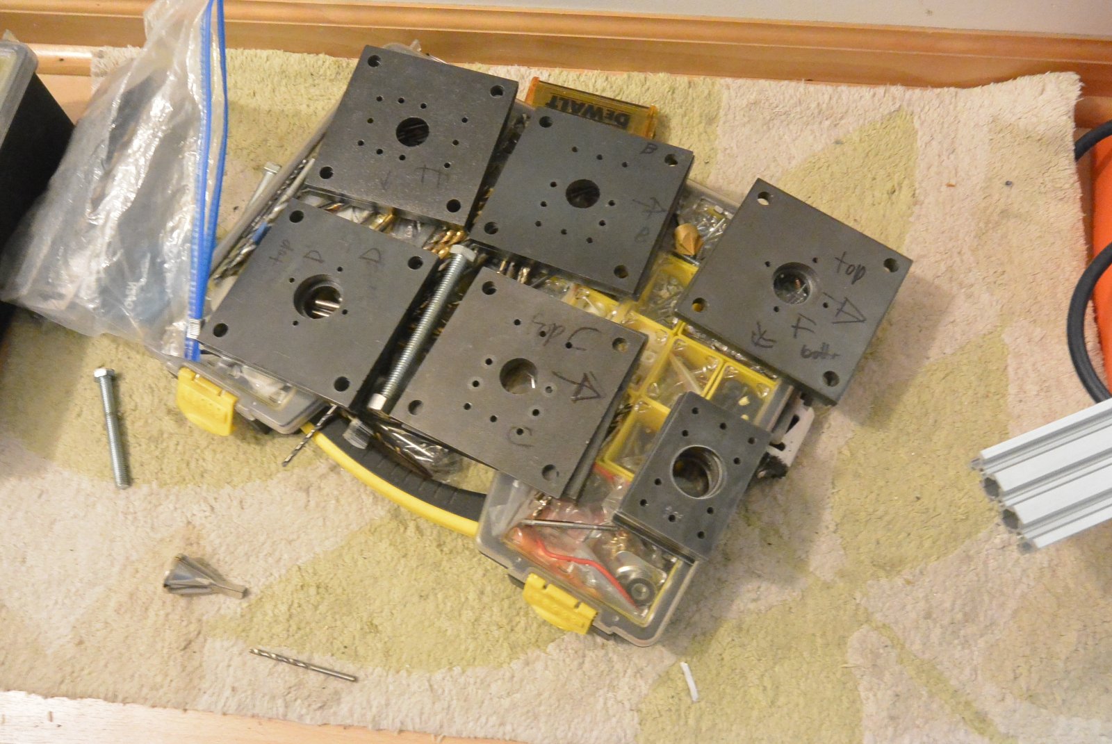

    just wanted to post photos of progress...

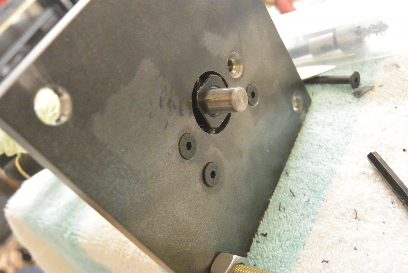

    just some updates...

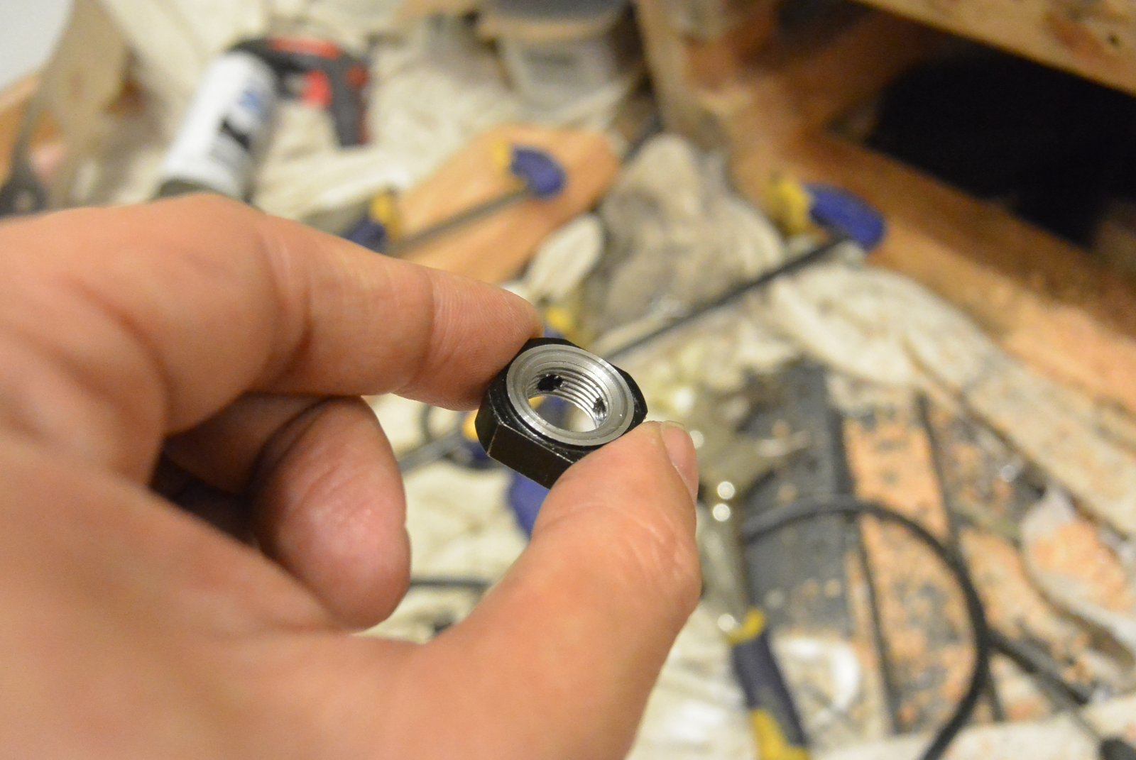

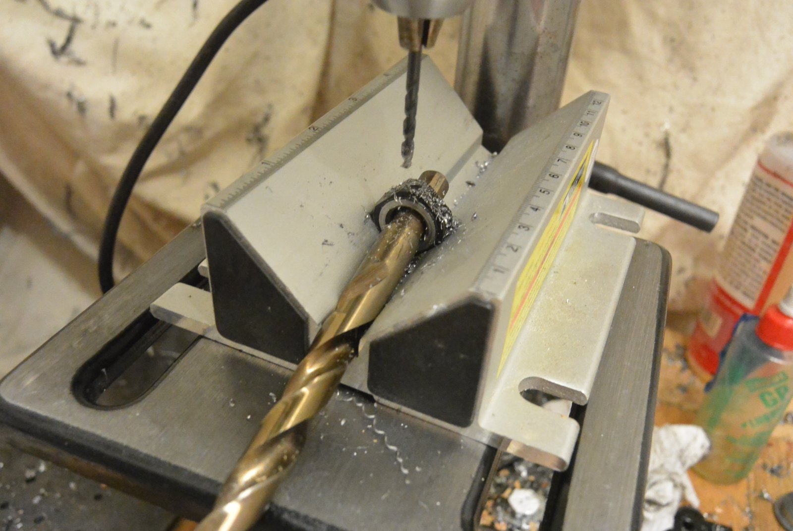

    trying to prevent ball screw nut failure, i decided to go triple attack.
    my triple attack method is as follows.
    a) drill and tap the securing ball screw nut with extra grub screw (M4 x 5.0 mm)
    b) use vice with paper towel to "grip" the ball screw without damaging threads of the ball screw so that you can apply more torque to the ball screw nut.
    c) apply threadlocker to the ball screw nut, and the grub screws,
    i dont know what "axial play" is from what @wannabeaflyer2 has mentioned, but seems like its not something i want to experience...

  11. hannibal
    hannibal Active Member
    Sep 29, 2018
    677
    4,492Coins
    +298 / 4 / -0
    Looking like something.

  13. wannabeaflyer2
    Jun 12, 2015
    724
    london uk
    8,359Coins
    +958 / 7 / -0
    Progress being made @hannibal small steps but the hair pulling part along with the massive grin of satisfaction will follow ( bank balance taking a hit goes with this territory LOL) ..
    The axial play I mentioned was noted because that nut you tapping came loose and so gravity and the coupler was keeping the ballscrew in place , Once I removed the Coupler I saw that situation .
    On you next actuator build if you tighten that nut and back it off say 3 mm you will see that in one direction the ballscrew is fine vertically but push on the coupler end of ballscrew and you see the axial play I mentioned ...
    Your method of securing this nut will get rid of that issue. I only mentioned it because we often forget ( make that I Often ) to add secondary locking medium to these m4 set screws .
    Luckily for me tis was on my Test bench actuator and not one connected to the Sim Platform ...Mind you it does now mean i'll have to take them off and double check that screw .. keep up the good work . it will be worth it that grin will be a million dollar ( monopoly Money Smile :) ) the real money has gone into the sim platform ..

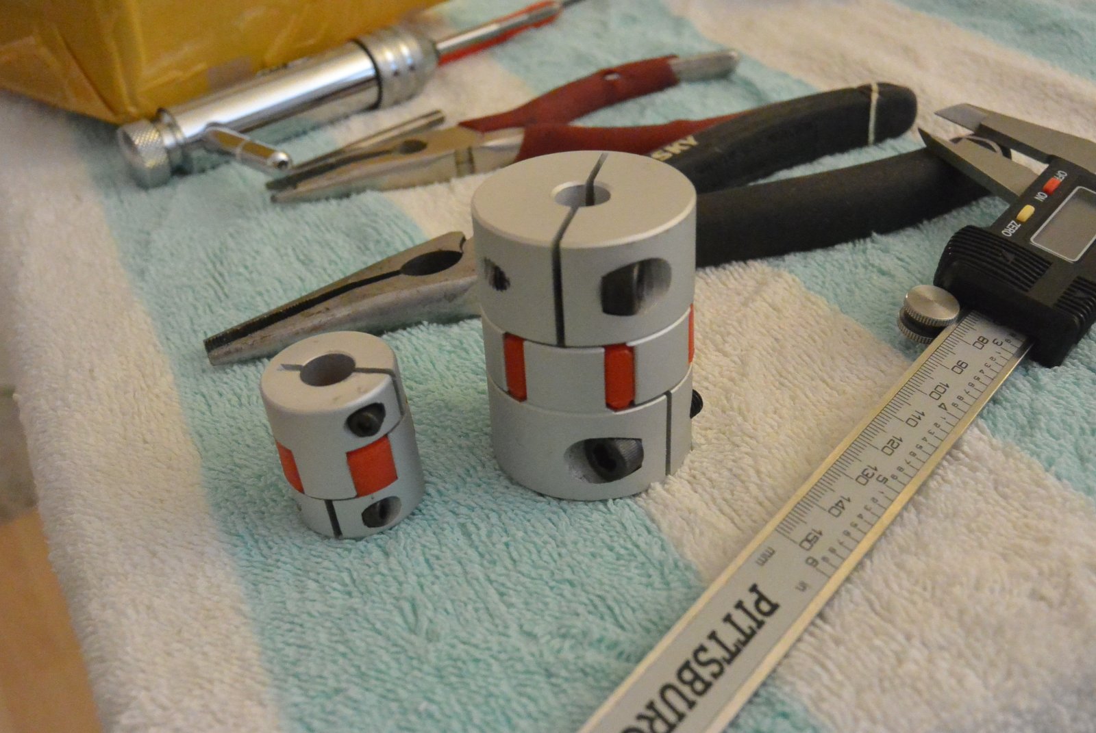

    the other day i find that not all sfu1605 are made the same.
    i order a balscrew recently, and found that the spacers were different from the original first 3 that i purchased. the spacers were smaller and thus had more shaft extended for the coupler to "grip" on. another thing this couple came with was a zerk fitting, so that prompted me to realize that the allscrews require greasing....
    learning something new about the parts everytime!

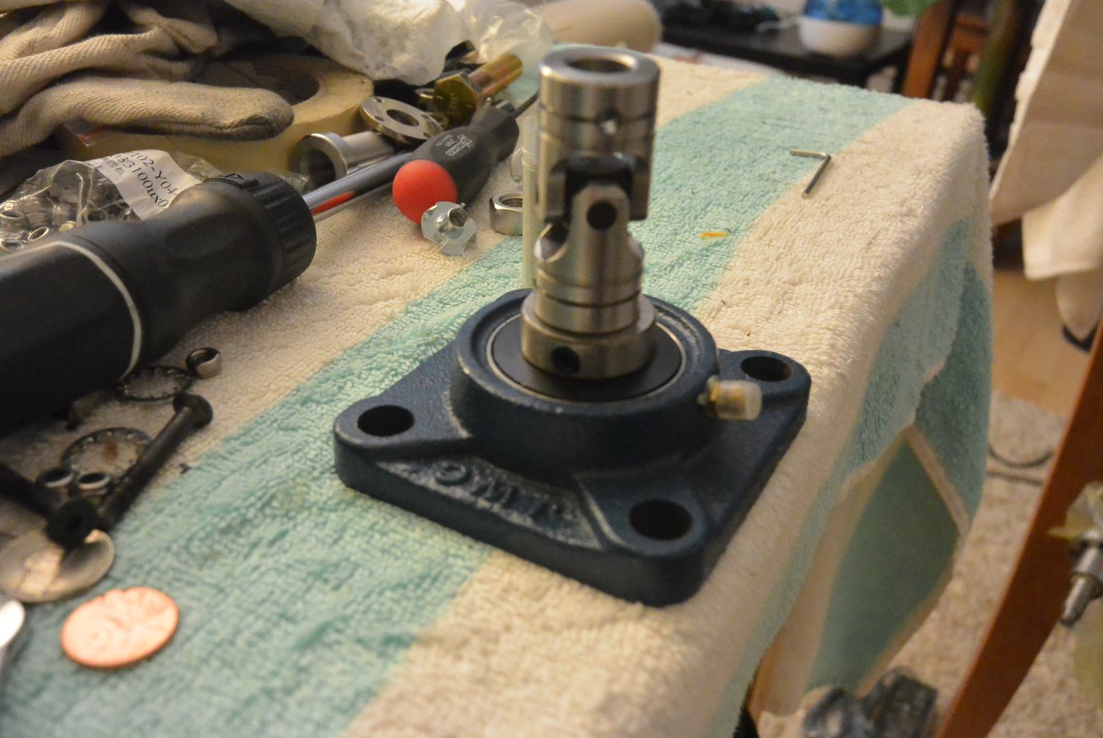

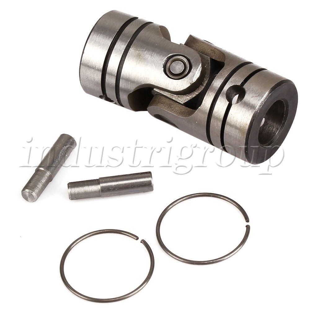

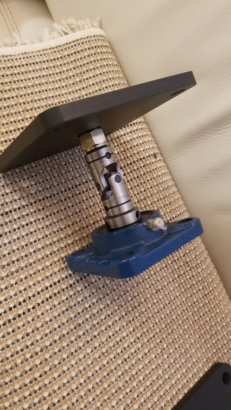

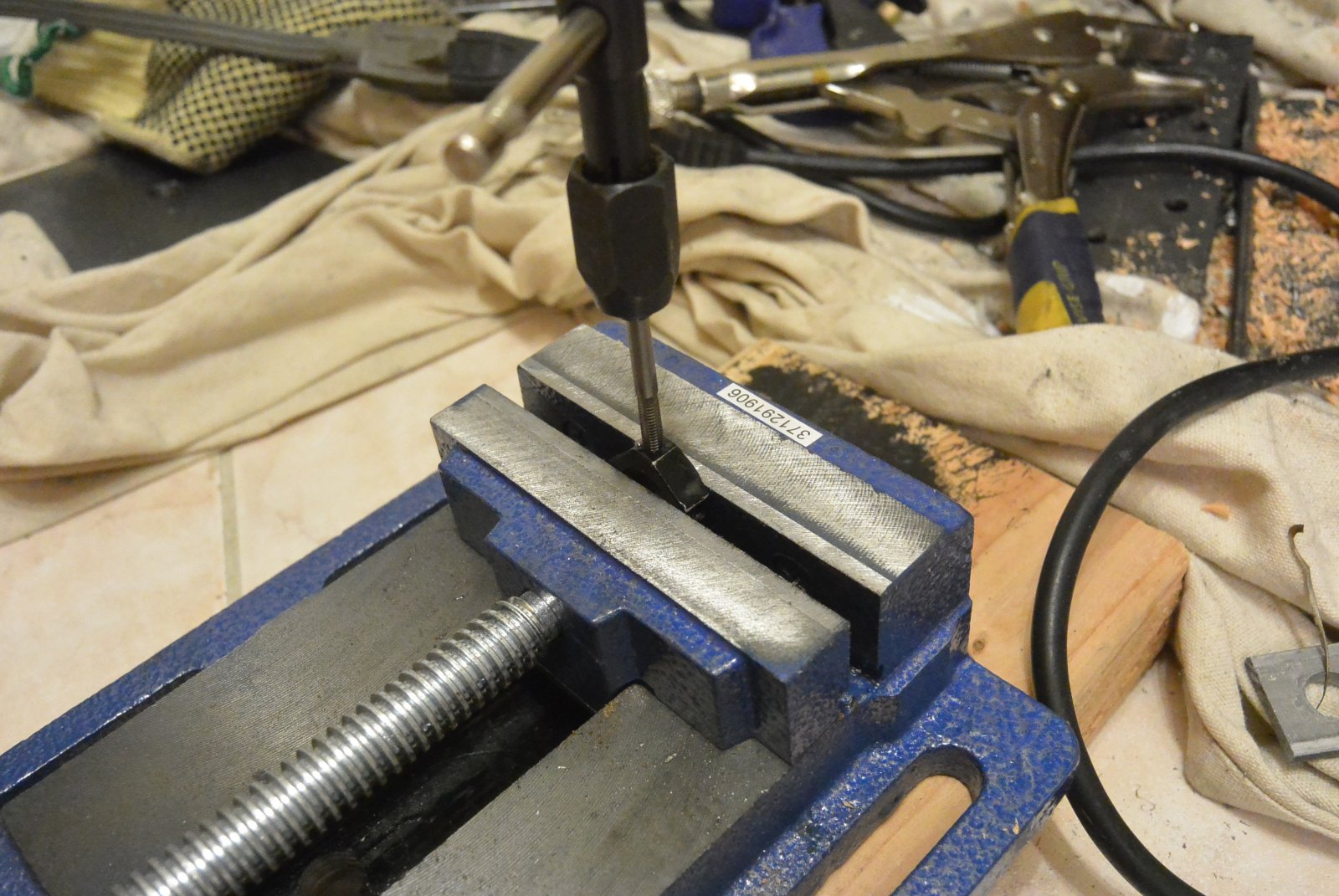

    guys, i just want to make sure if i am doing the right thing..
    dealing with the universal joint, the part comes with pins..
    i threaded the universal joint to fit 1/2 bolts..
    but it seems like i will have to drill a hole through the bolt to fit the pin..
    i just want to make sure that is required, and if anyone knows what size drill bit, most appreciated, i hate to end up making the hole so big that the pin goes through, because the pin is sort of odd where one side of the pin's diameter is small than the other, yet the universal joint's two holes has the size of the larger diameter... ( you would think one hole of the universal joint would be smaller to match the diameter ends of the pins???)
    @wannabeaflyer2 @SilentChill @Flymen appreciate advice.. :)
  16. SilentChill
    2,645
    20,604Coins
    +3,570 / 34 / -0
    I would say you want the hole to be the same size as the pin so it fits really tight maybe so you have to tap it in with a hammer tight. You don't want any play or else it will probably just end up snapping the pin if the is.
    I welded my joints to steel plates to make sure there was no movement however the pins started to fail in the actual UJ part , still not broken yet but there is a slight bit of twist going on.
  17. hannibal
    Sep 29, 2018
    677
    4,492Coins
    +298 / 4 / -0
    i placed my UJ on a bearing so it can twist.
    thank you for reply, i will make hole through the bolt the same as the hole in the UJ... just checking before i make any mistakes...
    i try to ask, before wasting time energy and $$$!
  18. hannibal
    Sep 29, 2018
    677
    4,492Coins
    +298 / 4 / -0
    Worked well.. used what ever the drill 15/64.

  20. Pierre Lalancette
    Dec 11, 2016
    1,012
    Tech Artist
    Quebec, Canada
    8,052Coins
    +947 / 6 / -0
    3DOF, DC motor, Arduino, 6DOF
    Only 20%, but I run 6 little 5mm metal rods all through the ball screw part.
