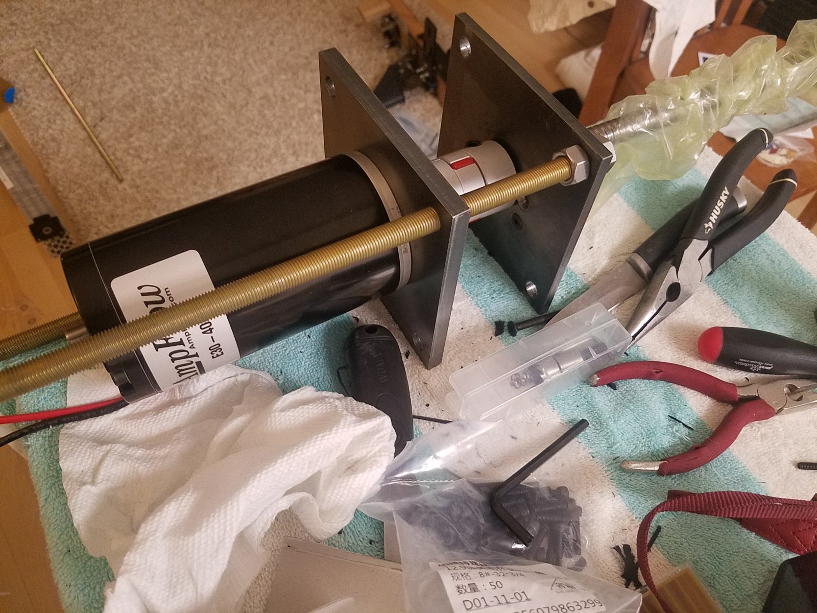

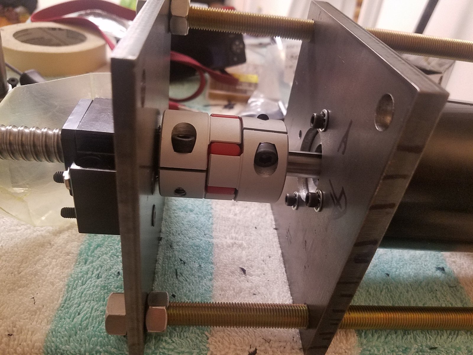

    i went with A36 steel... the last two weeks i have been trying to produce the plates. i pretty much drilled out the 25mm+ size holes. i just hope i dont make mistake.. i try to order spares just in case i mess up.
    everytime i think of whats needed to be done, i get overwhelmed.
    i have to reset my state of mind, and just focus on 2-3 tasks needed to be done hoping though the course it all adds up.
    at this time im just building out the linear actuator structures.
    my next major task is build some kind of anti rotation tube 2 ball screw coupler.
    i have to start to hone the 3d printing techniques. which i think i will tackle next week.

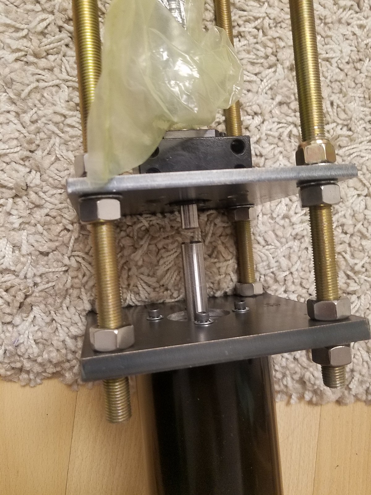

    Checking alignment

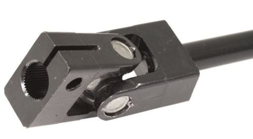

    Hiya @hannibal there are various options as you no doubt found during your research here , I fitted the type shown in the Middle Photo of some examples, These are strong but cant say with any real history how well they will cope @SilentChill and a few Others found the land rover Steering rack UJ;s and think they will be a little more robust , if you go to a car breakers yard you may find the real macoy's , the ones actually fitted to either ends of a car Propshaft , but they are way way way overspecced for what our actuators need, but if you can fit these, then they will be fit and forget cause the house would fall apart before these Did LOL ( and a few guys have had issues with smaller Uj's Breaking. as with most things in our projects it will boil down to budget available . in saying that though if you can get six at good price, i'll save you rework & reassembly further down the line ...Just my 2 cents worth , the guys here have so many great ideas your bound to find something that suits your needs . :)

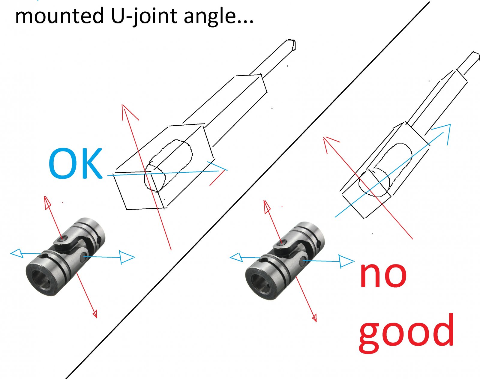

    @wannabeaflyer2 by the way, is the positioning of the Universal Joint on 90 degrees in respect to the actuator and base?
    i think from most steward platforms photos, the UJ is pretty much in line or parallel to the base and actuator..
    but i just want to check with you that it is not on any odd angles..
    i did a ms-paint drawing to pose the question for your verification?

    Hi @hannibal yes you are correct , the drawing was pictorial as at that point i did not finalise the mounting method and since changed to the tack welded plates .
    So they were lined up to achieve minimal twisting load whilst allowing the UJ to move freely over the range of movment for the actuator Min - Max Travel . the left side view of the picture you posted is the ideal alignment required , Cheers ( really need to get that drawing updated for you guys .. the new revised drawing will include some ideas i came across from other members Designs and should include some more Off the shelf parts to make construction easier for guys with minimal machining capabilities ( well thats the plan as of yesterday :) )
