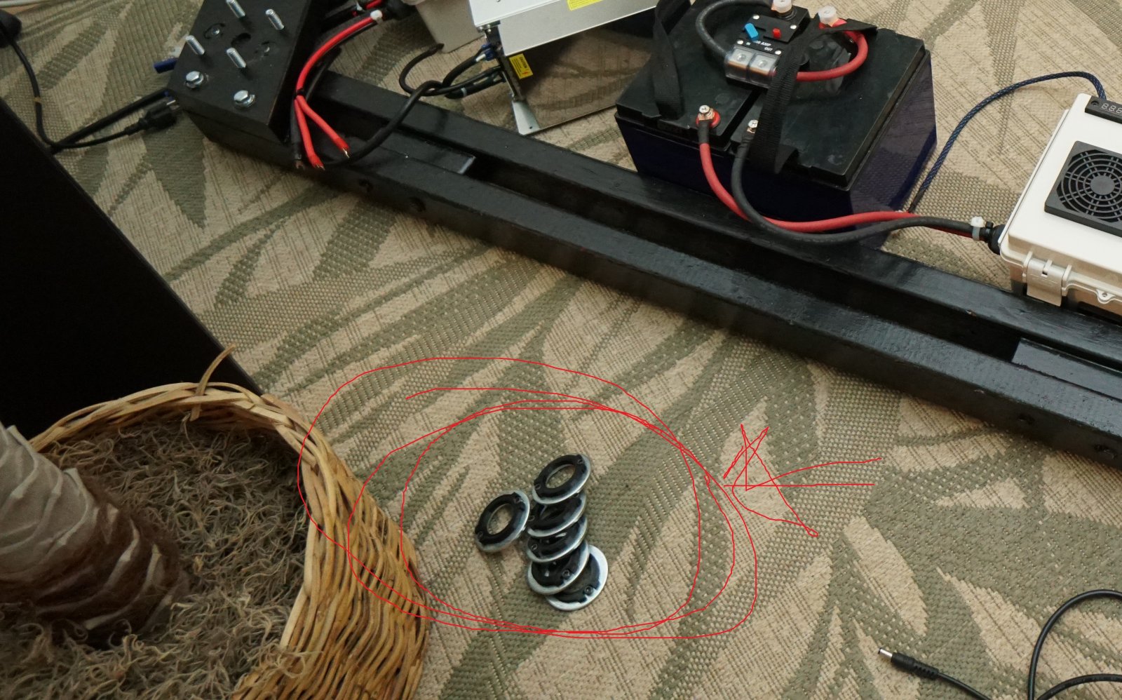

    Cheers man, yeah I knew it also but they were old and rusty and could barely get the bearing in so thought they wouldn't move. I was going to 3d print a spacer up to do the same but couldn't be bothered waiting haha. This happened as i sat in the chair so better than it happening mid race lol. So no harm done :)

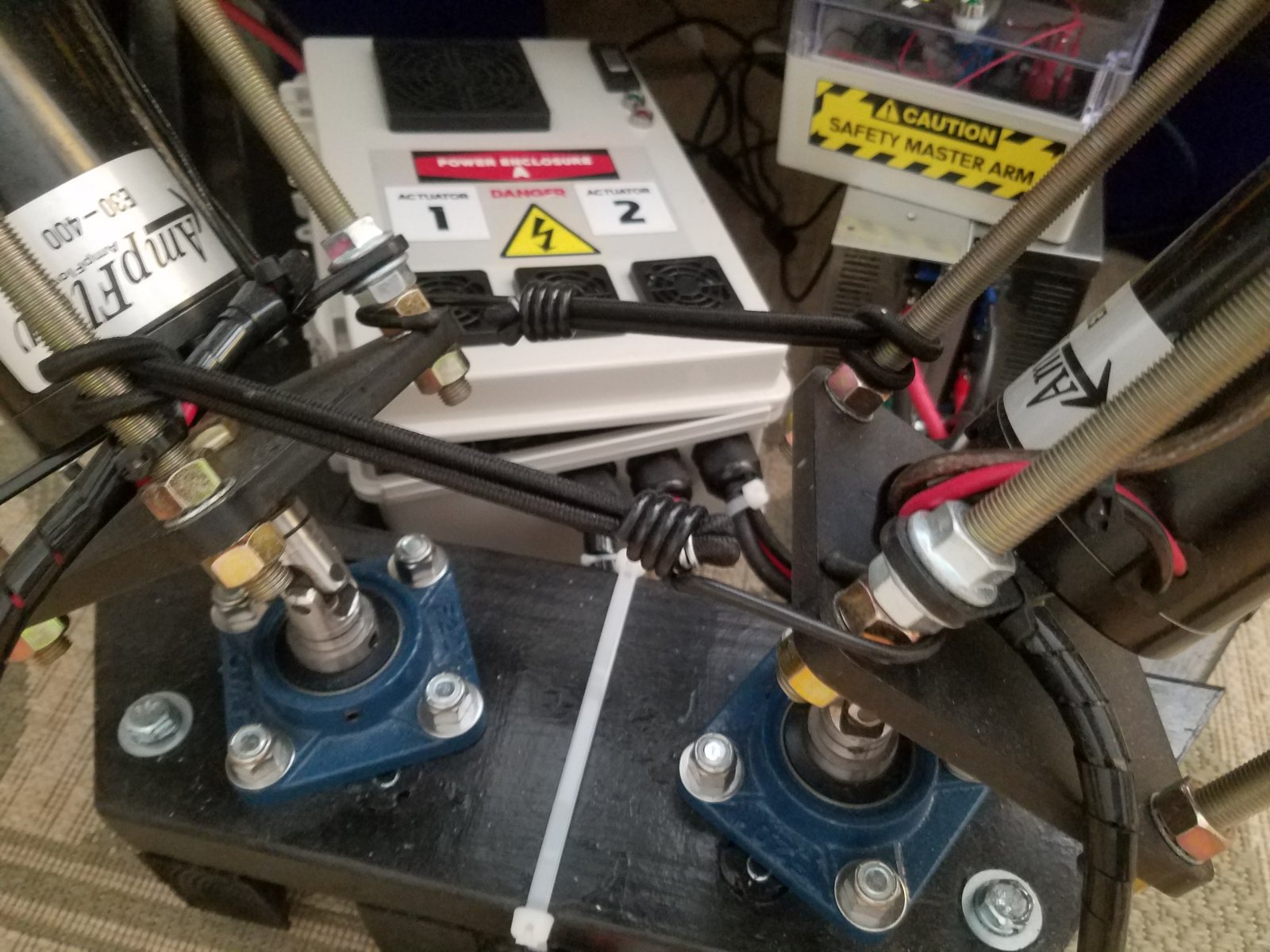

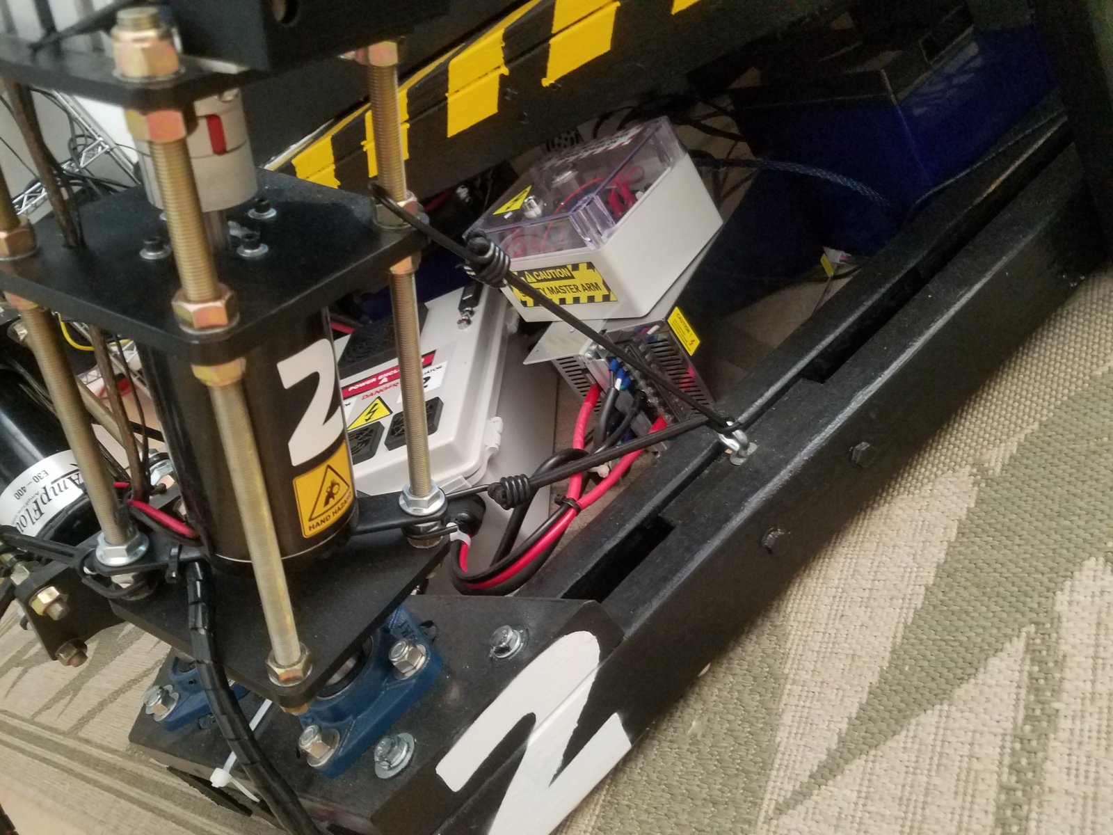

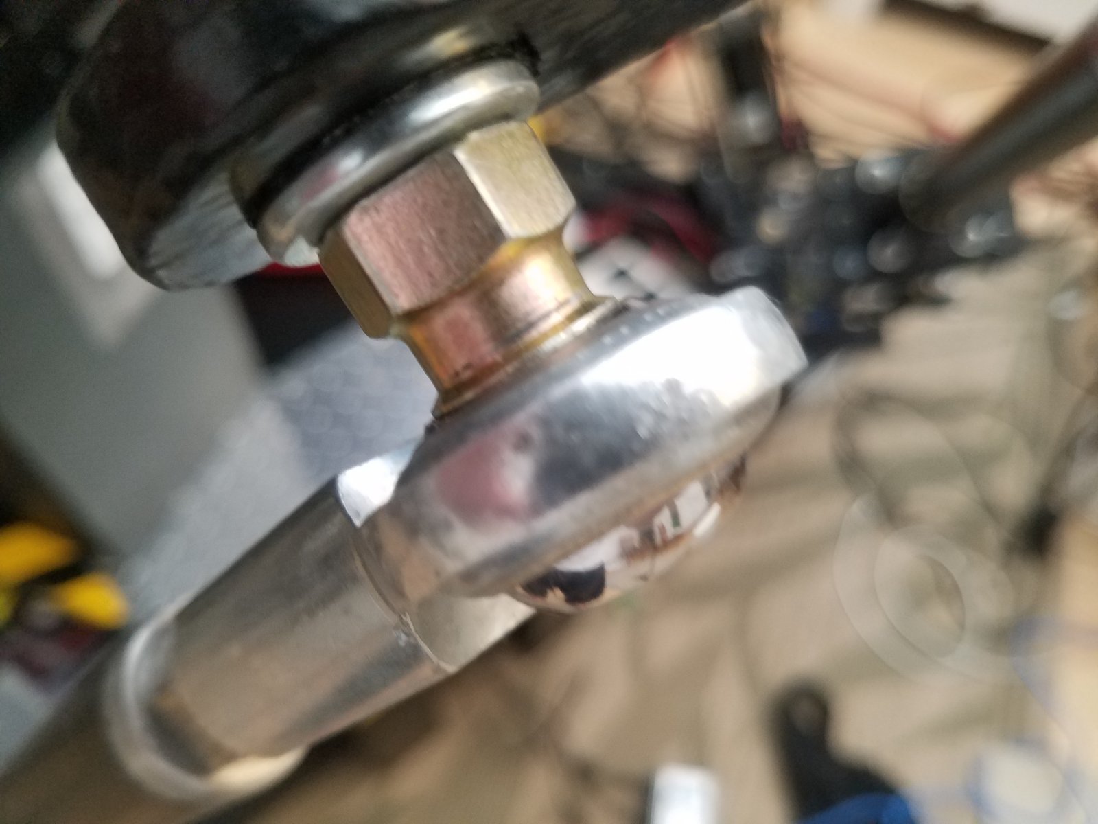

    by the way @Peacemaker105 if you have heim joints at the top and the UJ are at the base on rotating bearings and your actator arms can free spin. i suggest you bungie cord up your actuator arms to each other because damage on hiem joints can cause over time

    Haha yeah mine were spinning but because i have them bolted hard to the frame against the nut, they can't spin. They're good now, no spinnage :)

    i was talking about the bearing. not the bearing base...mine will free spin just in case i run into some weird pose causing servere binding. but with the bungie cords it keeps the actuators from too much free spin.... @Peacemaker105

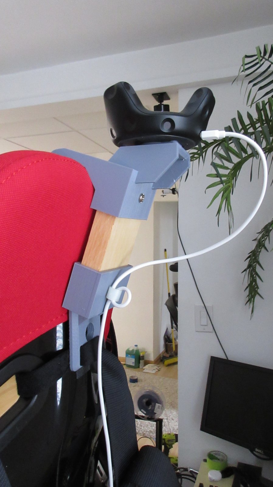

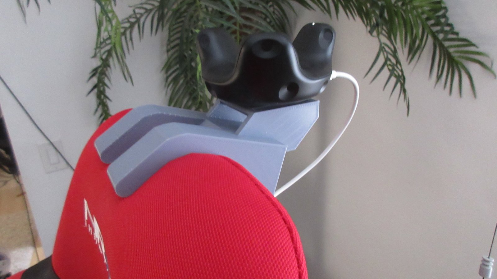

    but at this time, im trying to build yet another mount for the vive tracker, this time on the top of the seat to follow the best practice of placing tracker near you head position..
    i went back to this because some fellows in the motion compensation are finding good results...im hoping to implement M.C in my setup..i feel that this is the last problem that remains.

  9. Pierre Lalancette
    Dec 11, 2016
    1,012
    Tech Artist
    Quebec, Canada
    8,052Coins
    +947 / 6 / -0
    3DOF, DC motor, Arduino, 6DOF
    I really like the design. Since the Pimax motion cancellation does not have the pitch correction, a adjustable pitch would be usefull to me.
    But I do not have that type of tracker. :/

    at the moment, what ever i built is not functional with the hmd i have. i think i have to offset, since i am using a wmr hmd

    No need to use the Vive tracker. Just use any motion controller you have - Vive Wand, Valve Nuckles, they all work.

    Yes I know. It's just that attaching a controller is more challenging than those trackers. Especially if you want to be able to adjust the tilt of it.

    nice, im going to go back to try my version 1 WMR mount

    unfortunately motion compensation did not work for me via the HP Reverb. i tried using the vive tracker, and WMR controllers as the reference.. but as soon as the shakers go on.. motion compensation is out the window.

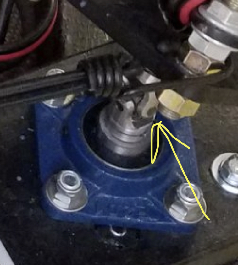

    I wanted to point out 2 things but @Peacemaker105 already made one about the bearing - I've actually learned from his case and that's why i made 2 bearings upside down in my build. They are dislocating on purpose - its so you can exchange the bearing itself actually.
    When it comes to the second point - i was initially inspired by @Peacemaker105 's build and wanted to use those joints but i had concerns with the diameter of the "pin" they have. I wanted to make everything at least 12mm and if you use 12mm threaded rod you end up with relatively small pin anyway:
    I'm not sure if that is a problem or 12mm is huge overkill but thats why i ended up with other joints (Which i now need to redesign a bit as they have too much play).
    Great build!

    the "big" threaded rod that goes inside the joint from the bottom and top is just fine (1/2" is roughly 12mm) what i'm more concerned about is those small ones pointed by yellow arrow. they are like 5x smaller in diameter and this is the weakest point of this whole bottom mounting point i believe...

    your right. but im not going back to re-engineer. when it becomes an issue, ill figure it out. and again, ill mention, silentchill ran his build with like u-joints with no issue
    if the platform weighted around 1 u-joint, of course thats bad.. keep in mind, its shared between 6 u-joints
