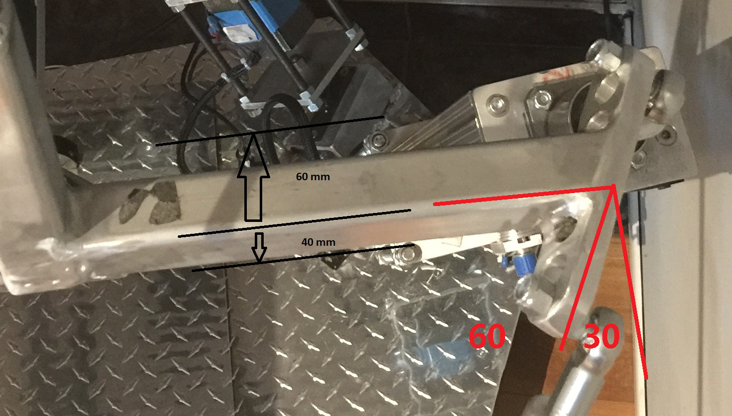

    Hi ,

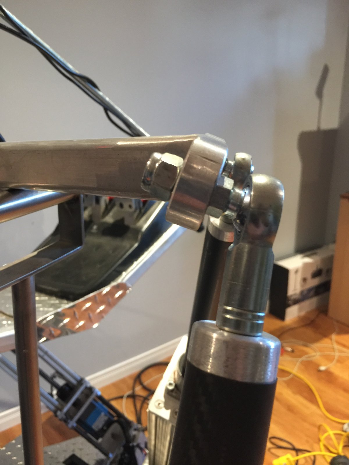

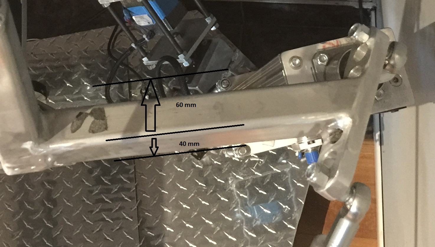

    Only for your info , if you want to do your top Rig like me ( thanks @pmvcda ),alu .. 40 mm square is perfect but if you found something like ( 60 x 40 mm) on the top is better for flex ( back and front) ( see pic).

  2. hannibal
    hannibal Active Member
    Sep 29, 2018
    677
    4,492Coins
    +298 / 4 / -0
    wow, i like how you connected your heim joints... i will either go that way, or use the L-channel like some of the other guys...
    yes, i was going to go 50mm x 25mm (11 guage) or 75mmx 40mm (14 guage)
    how thick are your metal tubes @Flymen
  3. hannibal

    i like to know your angles as well..? :) modf rig.png
  4. Flymen
    May 19, 2018
    353
    Montreal, Canada
    2,491Coins
    +195 / 2 / -0
    DC motor, 6DOF
    about 3mm

  6. Flymen
    May 19, 2018
    353
    Montreal, Canada
    2,491Coins
    +195 / 2 / -0
    DC motor, 6DOF
    yes 30/ 60 degrees like your red line .
    And I have angles for the feet at the end ! see pic
  7. hannibal
    Sep 29, 2018
    677
    4,492Coins
    +298 / 4 / -0
    ok. got it.. 30/60 both on top and side..
    ur joints are absolute perfection... @Flymen :o:

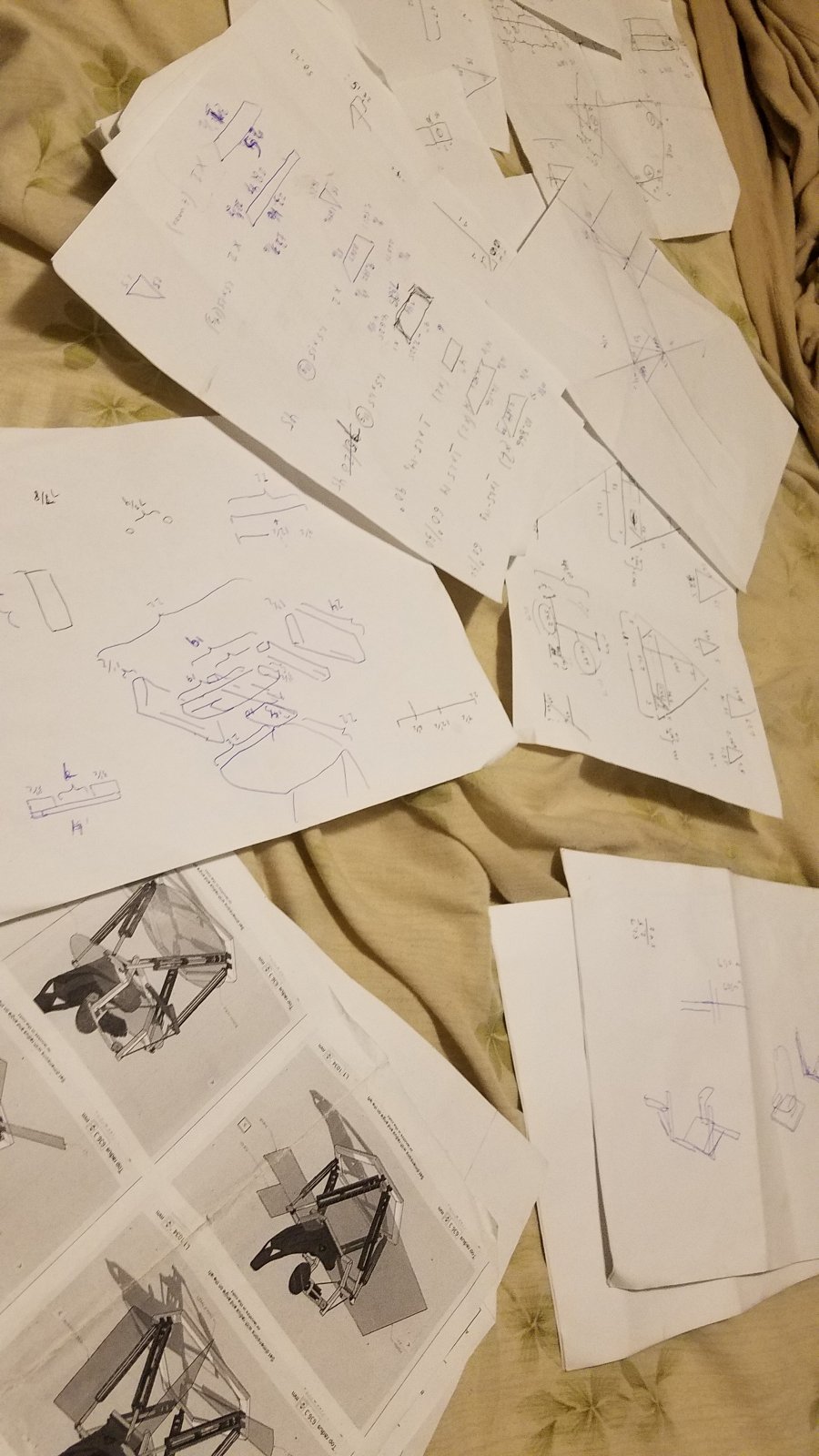

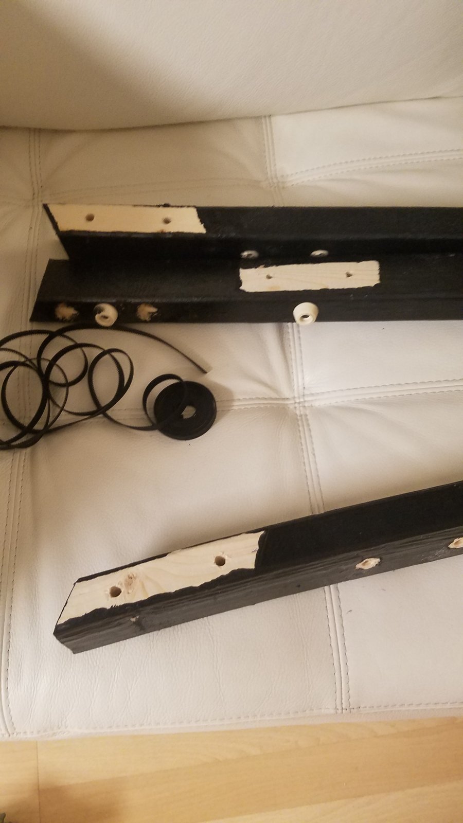

    this weeks antics...
    rebuilt bottom frame and almost finished painting. utlitmately each side was the length of an actuator at mid point plus the distance between two actuator heim joints... @pmvcda tried to make it simple in the diagram, but i was not sharp enough to catch that important dimension!
    went to microcenter to try chairs out. wow. many were super comfy. ended up picking a noble chair. even got a discount because of mispriced store label.

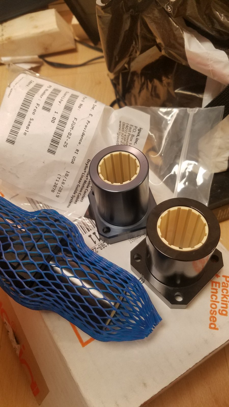

    my sample igus came in! but on impatient, chinese poly bearings came in also..

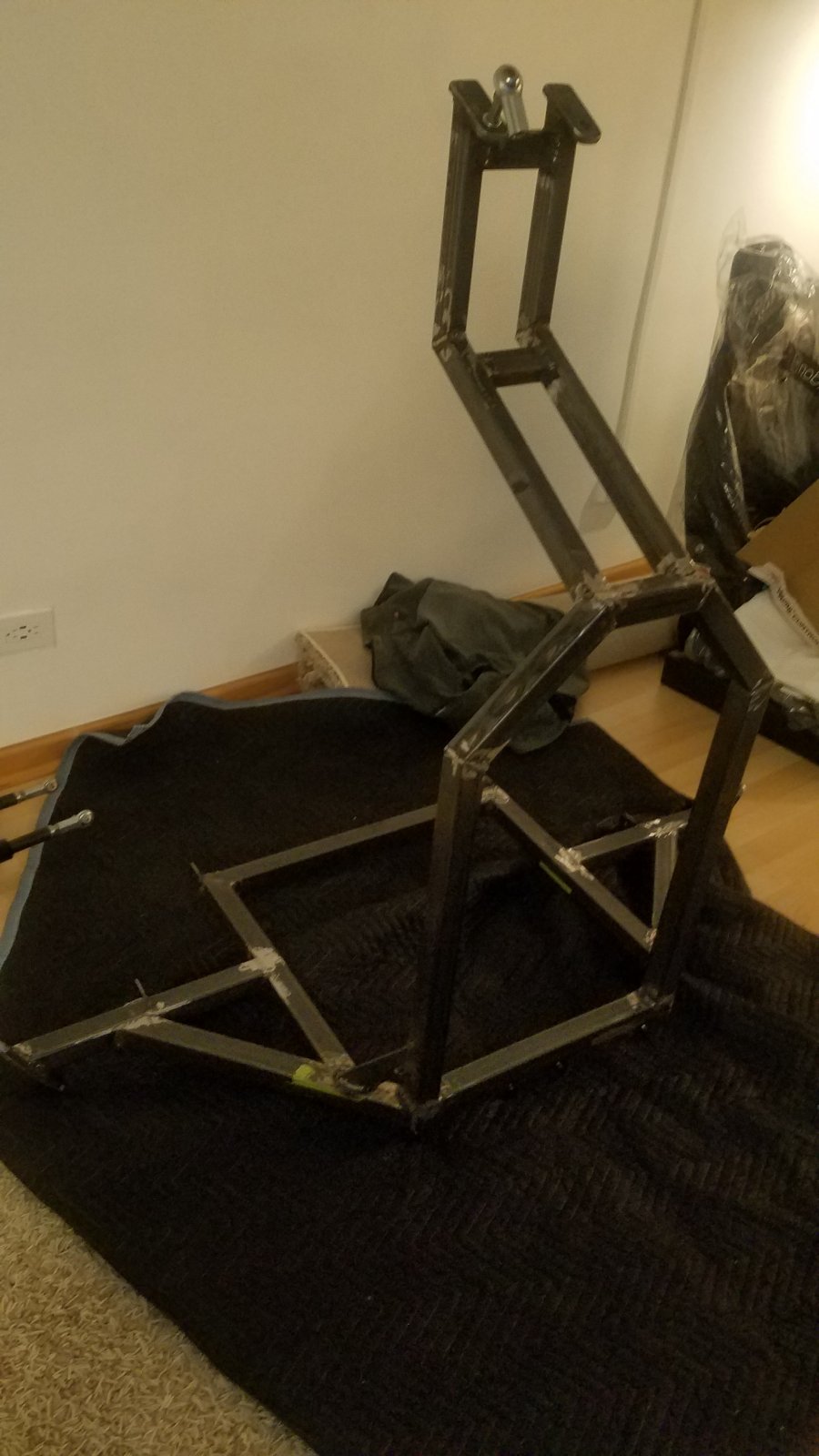

  17. hannibal
    Sep 29, 2018
    677
    4,492Coins
    +298 / 4 / -0

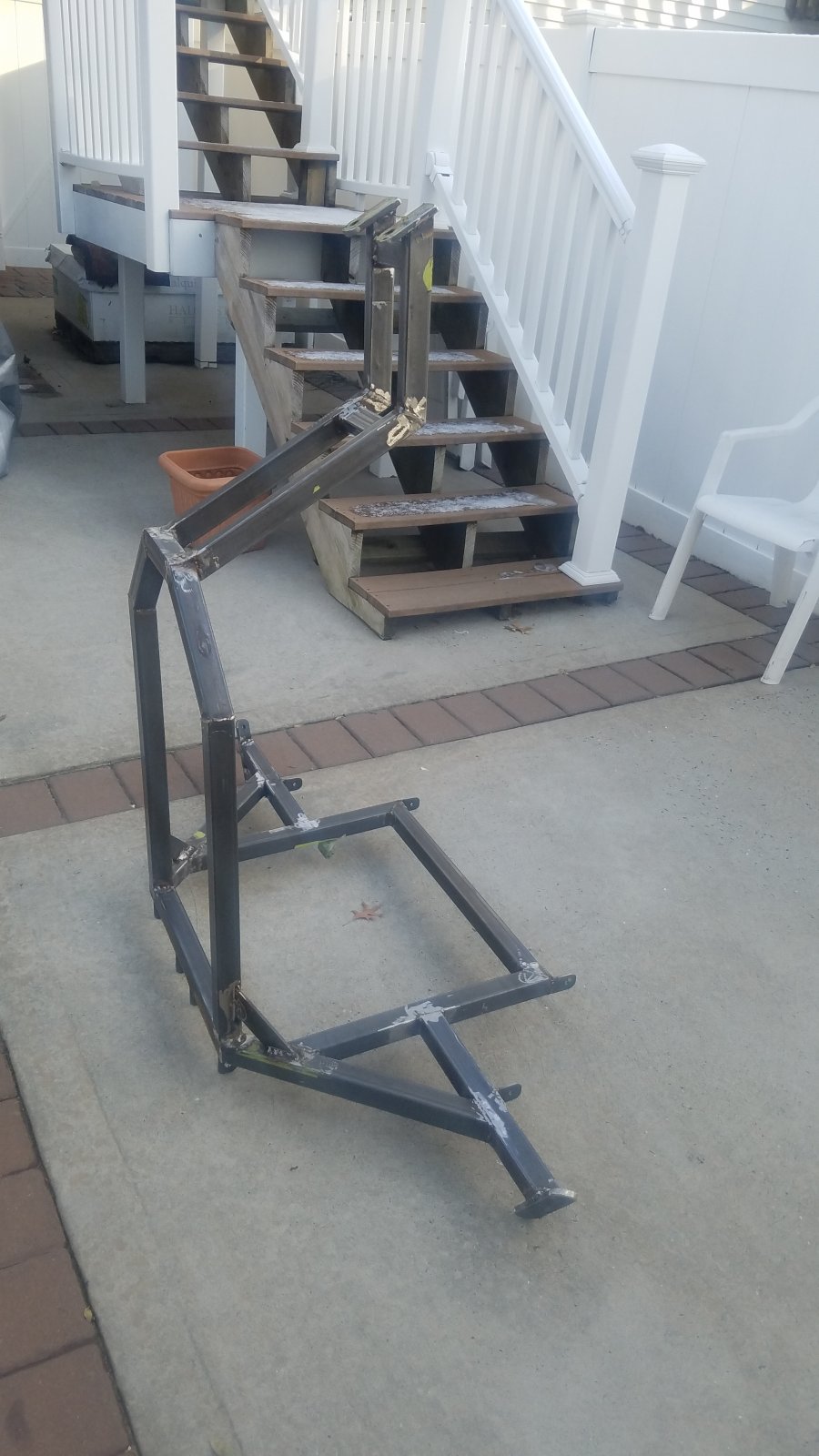

    behold.. the top frame! i dont know if building is just starting or almost over 20191213_072749.jpg 20191212_140543.jpg

  18. Pierre Lalancette
    Dec 11, 2016
    1,012
    Tech Artist
    Quebec, Canada
    8,052Coins
    +947 / 6 / -0
    3DOF, DC motor, Arduino, 6DOF
    Is it aluminium or steel? Hard to tell.
    Looks good.
  19. RacingMat
    2,234
    21,094Coins
    it looks like steel and arc welding...
    ha ha! it's a good stepstone, but only the beginning :grin

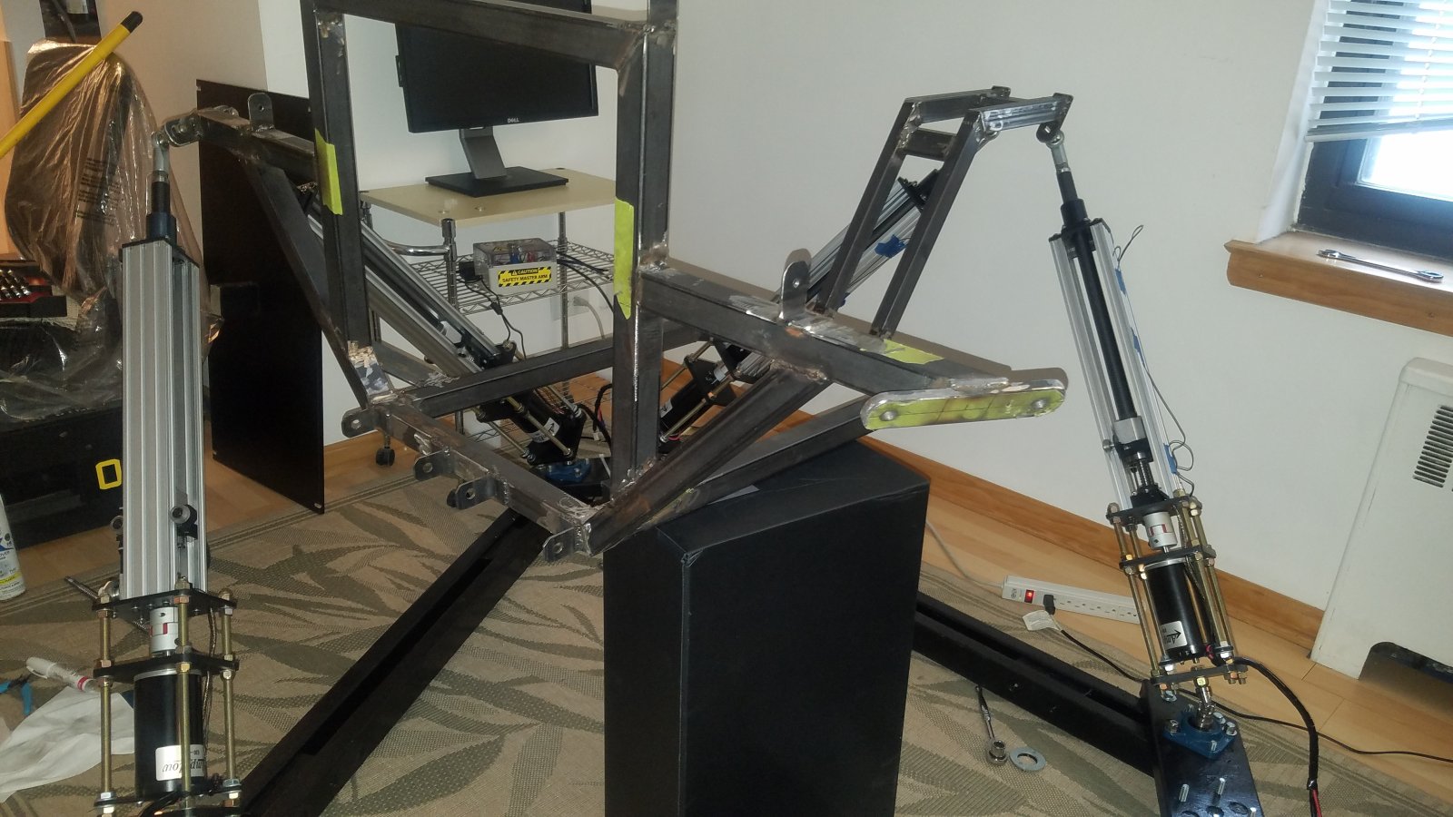

  20. hannibal
    Sep 29, 2018
    677
    4,492Coins
    +298 / 4 / -0
    steel.
    1-1/2 × 1-1/2 , 14 guage.
    im starting to attach to actuators.
    jeez @SilentChill makes it look easy..
