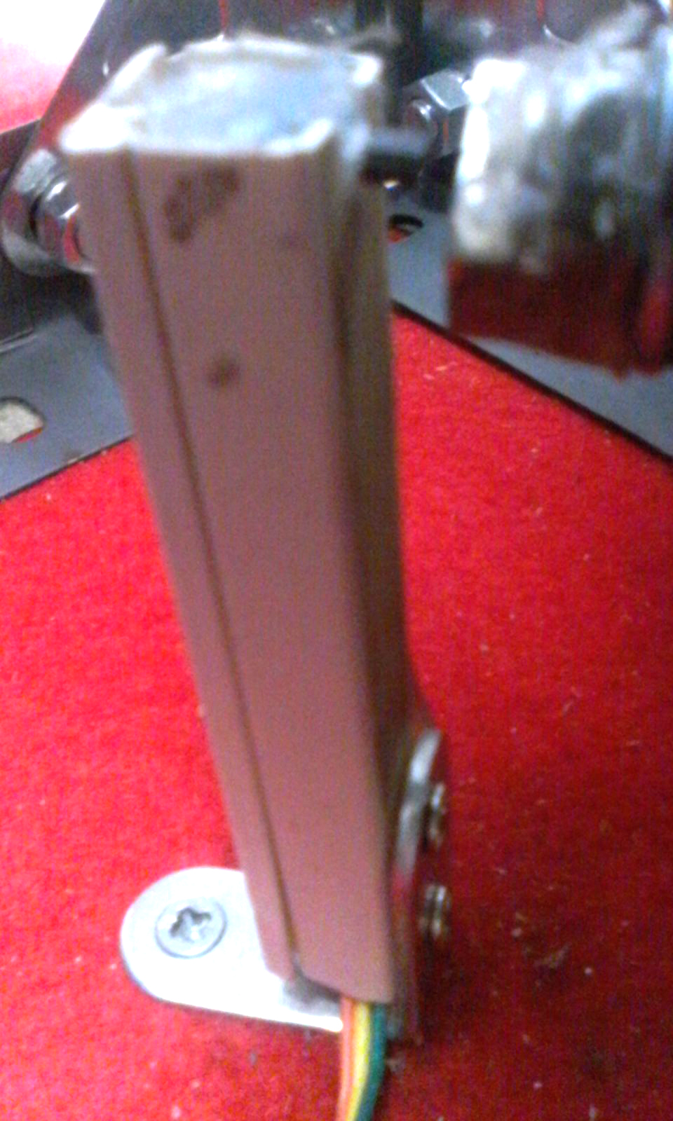

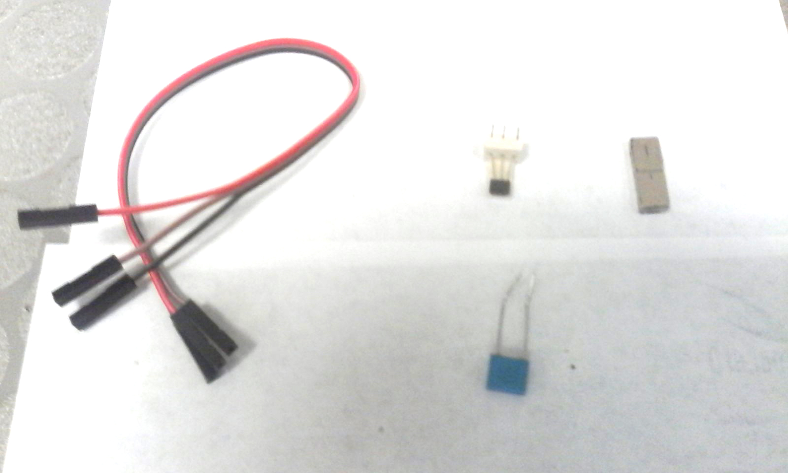

  13. chu
    chu 2dof racingseat
    Dec 2, 2015
    149
    tecnician
    VITORIA
    937Coins
    +34 / 0 / -0
    I built my own hall sensors and spend only 5$ they works fine and there is no contact with the wiper motor.

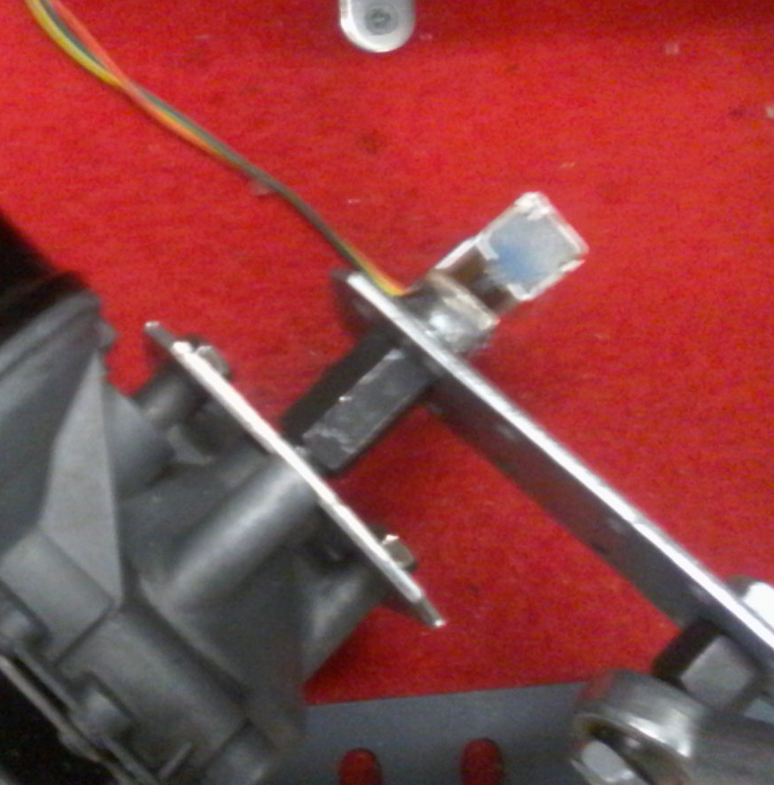

  14. chu
    chu 2dof racingseat
    Dec 2, 2015
    149
    tecnician
    VITORIA
    937Coins
    +34 / 0 / -0

    chu 2dof racingseat
    Dec 2, 2015
    149
    tecnician
    VITORIA
    937Coins
    +34 / 0 / -0
    Here a cenital view, as you can see there is a2-3 mm space between te magnets and the sensor, there is no friction. hall 2.jpg
