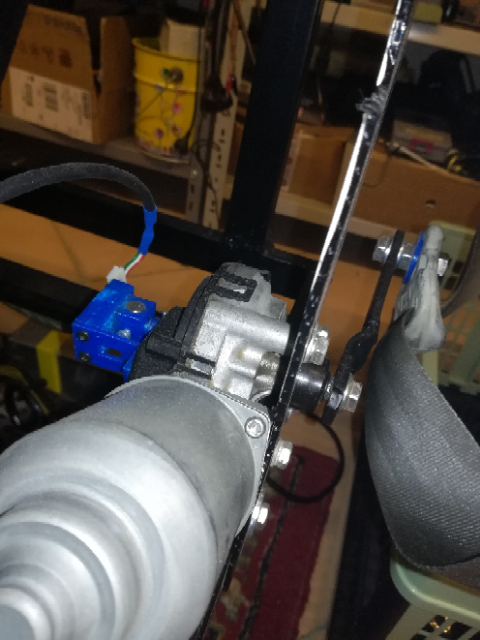

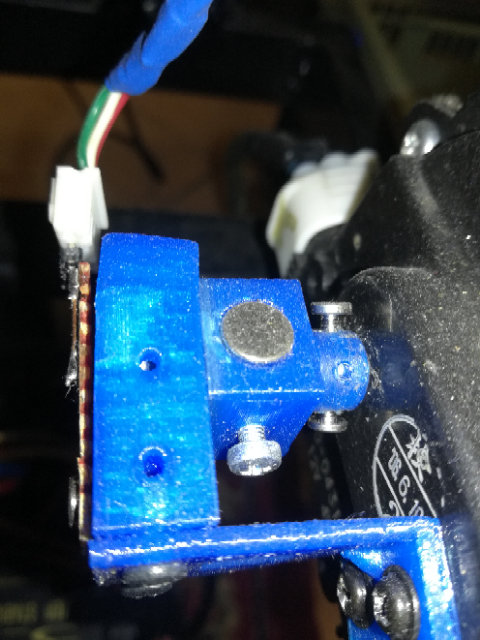

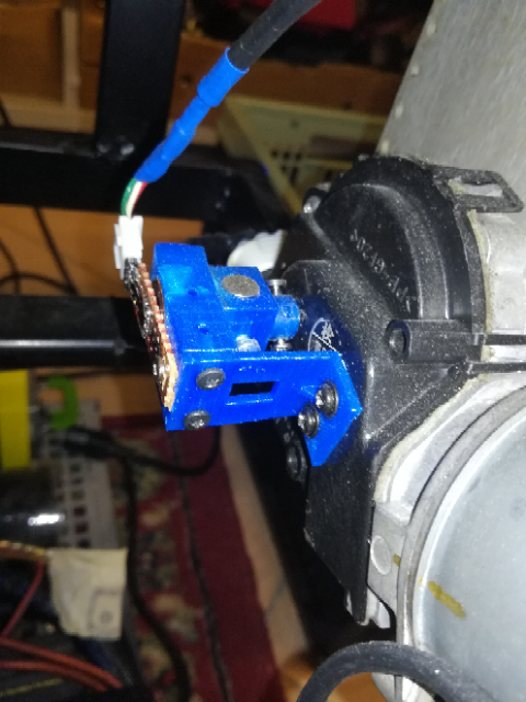

    hello NO to the motor no magnet must be inserted. there are only two magnets surrounding the Hall sensor. it then returns a voltage value in relation to the position of the measured magnetic field.
    it does not reach the 5vdc output due to losses in the semiconductors, but it is sufficient to then calibrate the movement system in its 180 * of rotation.

    besides I add that my design, has the possibility to be adjusted in the desired position through the rotation of the cube that contains the two magnets and then fix them with two screws in the desired position. a kind of fine tuning of the position of the rig
    in edit:
    I add some photos just taken. after more than a year that is not even looked at by how well it works.
    as you can see from the photos, you have to build the adapters to connect the potentiometer to your motor, and my motors are out of the standard used by almost everyone. so for the support you have to arrange to build it yourself.
    I hope I made you light.
    live in peace,
    Marco

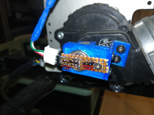

    IMG_20200126_100302.png IMG_20200126_100343.png IMG_20200126_100356.png IMG_20200126_100413.png the HAll sensor is then inserted into the hole until it reaches the magnets, you can help build the support with a breadboard and screw on the bearing base

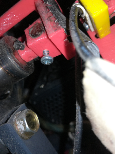

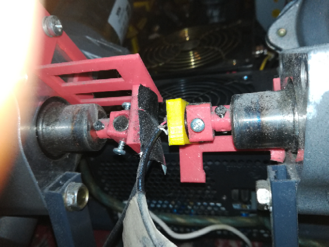

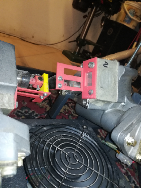

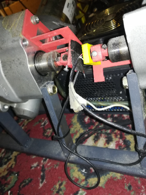

    IMG_20200126_102338.png IMG_20200126_102344.png IMG_20200126_102355.png IMG_20200126_102404.png Hall sensors are A1302
    ahha :)
    I forgot .. the third dof. built 6 months ago ..
    I used a common wiper motor to pull the belts.
    here you can see better how to install from the attached photos.

    rather you have to use a shielded cable for the connections from the potentiometer to the board, a stereo shielded cable is sufficient where the braid will be the negative (ground).
    the wiper motors are very dirty about EMF. therefore the Hall signal cable can be influenced by continuous spikes due to the very stressed motor.
    in my case I have very powerful motors and they work without warming up very relaxed, but I used shielded cable, this is the solution.
