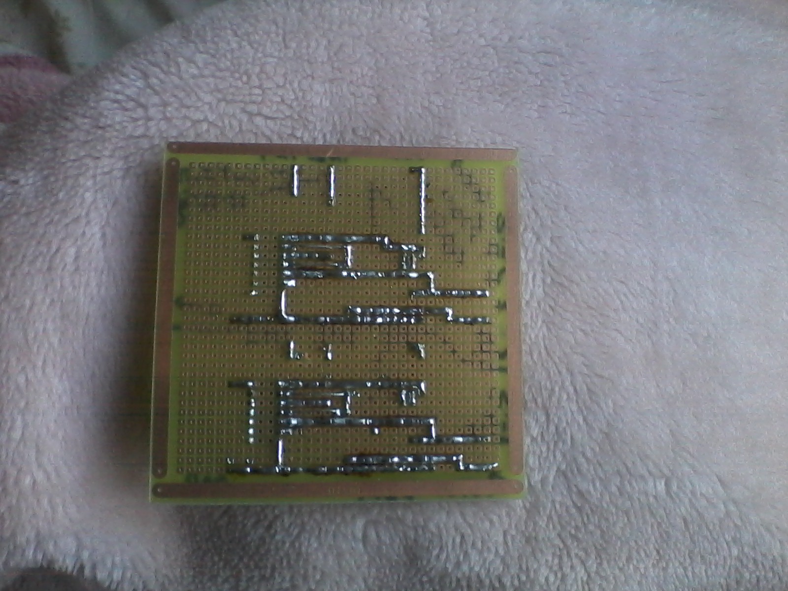

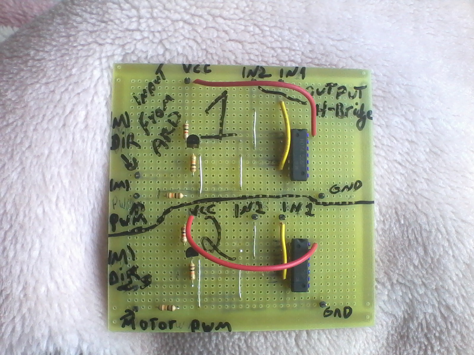

    as i promissed here are the pics of the small circuit.. it has 2 circuits in on board to make things more easy..
    can i join all the vcc of the 2 circuits in one sigle wire? and the GNDS?
    IF IM GOING TO USE AN EXTERNAL 5+ POWER IT HAS ONLY positive and negative.. theres no GND
    can i plug the negative in place of the GNDS?
    can arduino 5vcc and gnds handle this 2 circuits?
    thanks to all

  4. prilad
    Apr 29, 2012
    380
    Dubna, Russia
    9,666Coins
    +513 / 1 / -0
    3DOF, DC motor, Arduino, 4DOF
    YES
    YES
