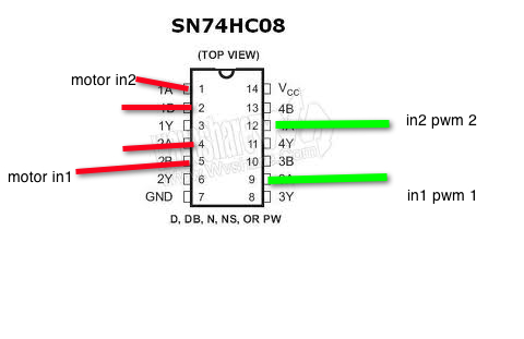

    hey guys one more thing.. i was looking to the diagram and it confuses me....
    what exatly are the controller pins that i must use...?
    the original diagram dont show really clear just some numbers..

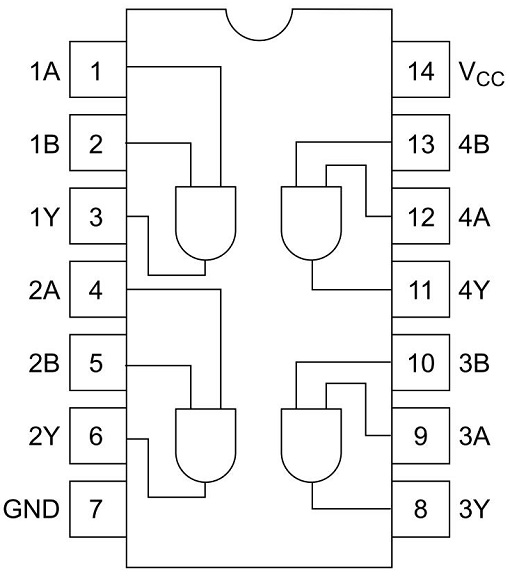

  6. eaorobbie
    20,503Coins
    +1,687 / 23 / -2
    ok numbering is the same as in pic supplied. This might help you better.
    As you will see you only use 1/2 of the 74hc08 to drive one H bridge and the other can be driven off the other side.
    Hope that helps you.

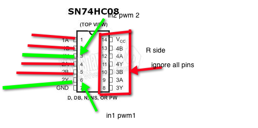

  7. trust928
    trust928 Member
    Sep 19, 2013
    152
    brazil
    435Coins
    +7 / 3 / -0
    can u tell me if those are the right pins? i have marked them...
  8. eaorobbie
    20,503Coins
    +1,687 / 23 / -2
    No - your outputs (green) are wrong
    Motor_IN2 to pin 1
    Motor_IN1 to pin 5
    Motor_PWM to pin 2 and 4
    Outputs to your Hbridge come off Pins 3 and 6.
  9. trust928
    trust928 Member
    Sep 19, 2013
    152
    brazil
    435Coins
    +7 / 3 / -0
    just to be sure im gonna be using only the left part of the controller
    like this? and ignore all the right side of the controller
  10. eaorobbie
    20,503Coins
    +1,687 / 23 / -2
    correct the other side can be used to control the 2nd hbridge a dual circuit can be created.
    I will do a schematic for you. Sorry should have done that first.

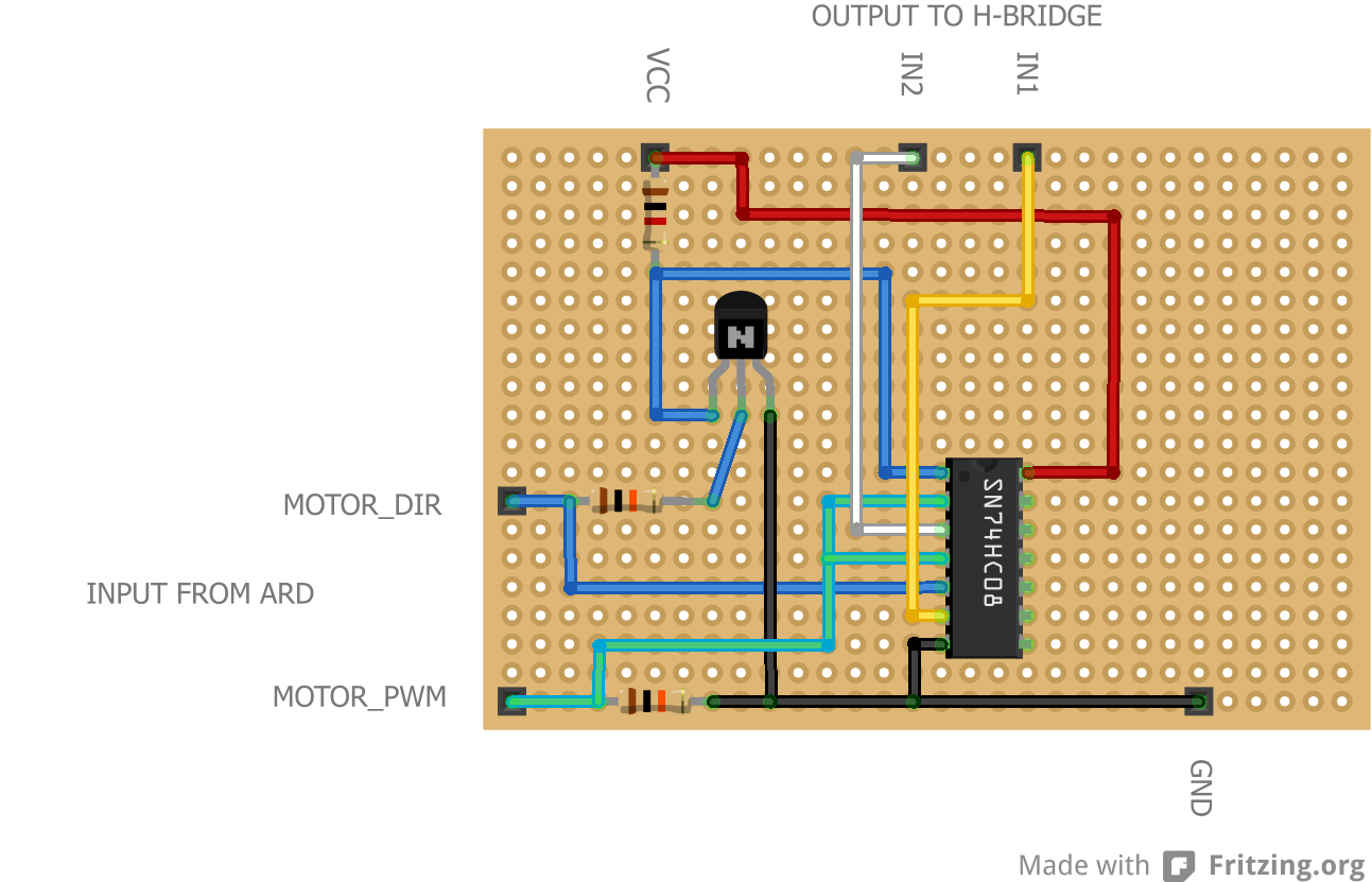

  14. eaorobbie
    20,503Coins
    +1,687 / 23 / -2
    This should help
  15. trust928
    trust928 Member
    Sep 19, 2013
    152
    brazil
    435Coins
    +7 / 3 / -0
    woow thats really good so i can use the 14 pin as 5v+ to power the vcc input is that?
    you have joined all the grounds.. i must just plug into arduinos gnd..(the resistor of the ground is right?)
    the original diagram seemes to be a little different
    the rest is more clear than water cheers

  17. trust928
    trust928 Member
    Sep 19, 2013
    152
    brazil
    435Coins
    +7 / 3 / -0
    eaorobbie can u make a draw like the one u have made, but showing me how to plug the pots in arduino and the right pins. just it is remaining....thaks
