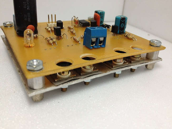

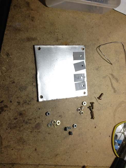

    hey guys after much work here goes all the procedure to make your own h-bridge
    thanks to
    prilad, historiker, Raceray, RacingMat, bsft, eaorobbie !!!! sorry if I'm forgetting some one all have helped me, and here goes my contribution
    the credit goes to
    http://www.robotizando.com.br/artigo_ponte_h_pg1.php
    this h-bridge ( mosfet) in theory could handle 105amps but because of the enclosure
    it drops to 75amps…… but now we have the materials resistance so lets drop it to 50amps
    and put a safe limit 40amps…..
    ps, the wires of power (input/output) its better to solder it directly to the board..otherwise i think that the small pins will not handle more than 20amps

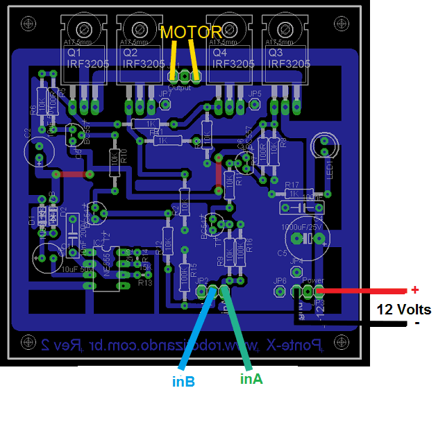

    it has IN1 IN2 and GND

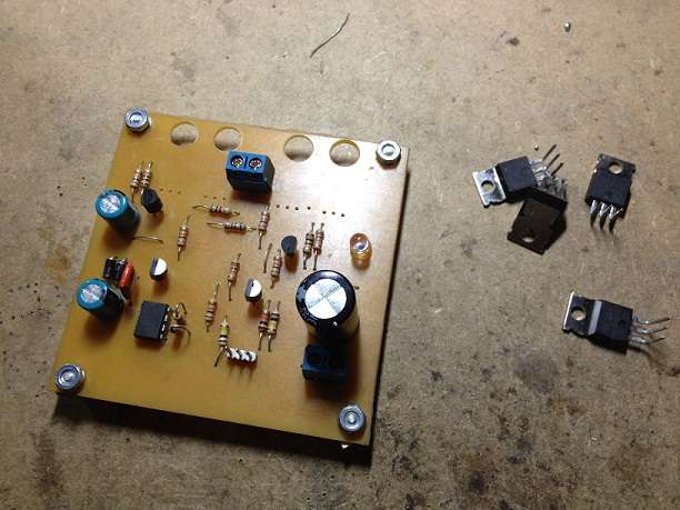

    here are the layout and all the stuffs that you guys should need…

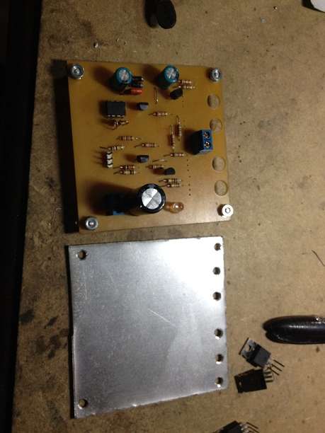

    follow how you should mount it

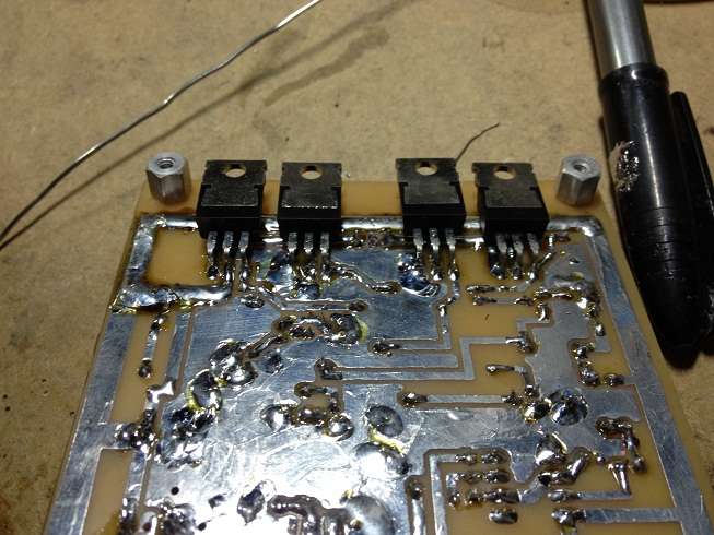

    notice that we have to put spacers in the edges of the board,,
    FOLD THE FETS TERMINALS AND PUT THEN IN THE OPOSSITE SIDE OF THE BOARD!!!!!
    notice that we have reinforced the potency track
    here is a video test the guy extracted 17amps.. (as i said solder the wires directly to the board otherwise i think it will not handle much more than it....)
    to power the h-bridge we should power it, with 5v in INA or INB can use signals pwm too to control the speedy
    another test now with 20amps... he can't pass it because of his multimeter it reads only until 20amps.
    u see that it got off scale
    (ATTENTION if INA and INB be powered at the same time it will fire up...so becarefful
    here are all the files that you guys need
    http://www.4shared.com/zip/4W3OYZPb/ponte-h-arquivos-1.html?
    i hope you guys like it,,,:thumbs

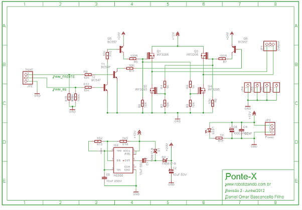

    no im not using amc, i was planning to build one, but im gonna check Simaxe, coz some parts of amc its difficuty to find in my country.. so lets say im gonna using sintaxe here are some pictures and diagram...
    if we could use this one. would be awsome, coz its etremaly easy to build and handle 40amps...

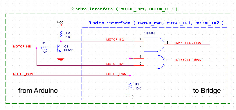

    Hi Trust, as I mentioned in Prilad's Ardiuno thread; your setup would be very much like my own.
    The three input pins you have are for PWM, DIR and logic ground. The potentiometers are connected to the Arduino, NOT the H-Bridge. Prilad provided all the documentation that you need to set up and connect an Arduino. What you need to figure out is which is the DIR pin and which is the PWM on your H-Bridge. I cannot tell as I do not have the experience reading the schematics.

    u show me half of the light in the and of the tunnel loll... very good to know that u have some thing similar.. it makes the this more easer.. so i thought i would need use only these 3 pins.. but u said i have to figure out whats the pwm this confuse me,, i just know that inA and inB are for direction. and it can work with pwm.. they guy who made it.. describe...u can connect this bridge to an arduino and use pwm signal to operate...
    im not an expert in find how to figure this stuff of pwm...if some one can help

    pwm is quick simple fellas it controls the duty cycle of the motor which controls the speed at which the moves in the direction chosen by the INA and INB pins
    So PWM controls the speed. Needed to create a motion sim, not for an arcade sim thou.

    hey guys look reading the website were the guy made it his says it
    (with this h-bridge we can use pwm signals in your input pins, and control the speedy for the directions)
    so he doesn't have direction pins.. he take pwm direct and put in the input.. so no direction wires with pwm,, only pwm for the direction) makes sense?
  15. Historiker
    2,161
    9,208Coins
    +2,168 / 19 / -1
    I found the website where you are getting your information on this H-Bridge:
    Interesting read. It looks as if the author only wanted to make a circuit that could drive an electric wheelchair through direct user input so used an Arduino controlled by buttons. One button would turn off PWM A and one would turn on PWM B allowing polarity change and therefore reversing direction. This circuit does not indeed have a DIR input type as it looks like both inputs are "live" and having them both active high would result in magic smoke being released.

    As both Prilad and Eaorobie just showed you; you just need to add a small circuit in front of the other to use that H-Bridge with Simtools.

    sorry,, i haven't notice that its was designed to add in front of the h-bridge, yeah its is a really simple circuit...
    i can mount it.. thanks to all.. here in brazil this electronic sttufs cost your eyes, your face and all your body loool
    so monday I'm gonna build it... but before it just,, got some questions.... about it...
    one circuit can control both ways is that? i know how to mount but don't know how it works properly loll...
    i have to build 2 h-bridges.. one for each motor.. and 2 circuits one for each bridge is it?
    and one more thing,,
    the vcc is a positive 5v (right?)
    the r3 10k resistor( is it ground?) negative?
    and q1bc547 (is it ground > it goes to the arduino ground? or what?
    sorry this noob questions. but if i don't ask i will never know

    Why build plenty of drivers off the shelf work, been tested and for what ya get strong. 20-30amp peaks in 12v. 240 - 360w plenty for a good sim.
    Ok yes two circuits and 2 hbridges needed for 2dof
    q1 to gnd on ard
    r3 to gnd on ard
    r2 to 5v on ard
