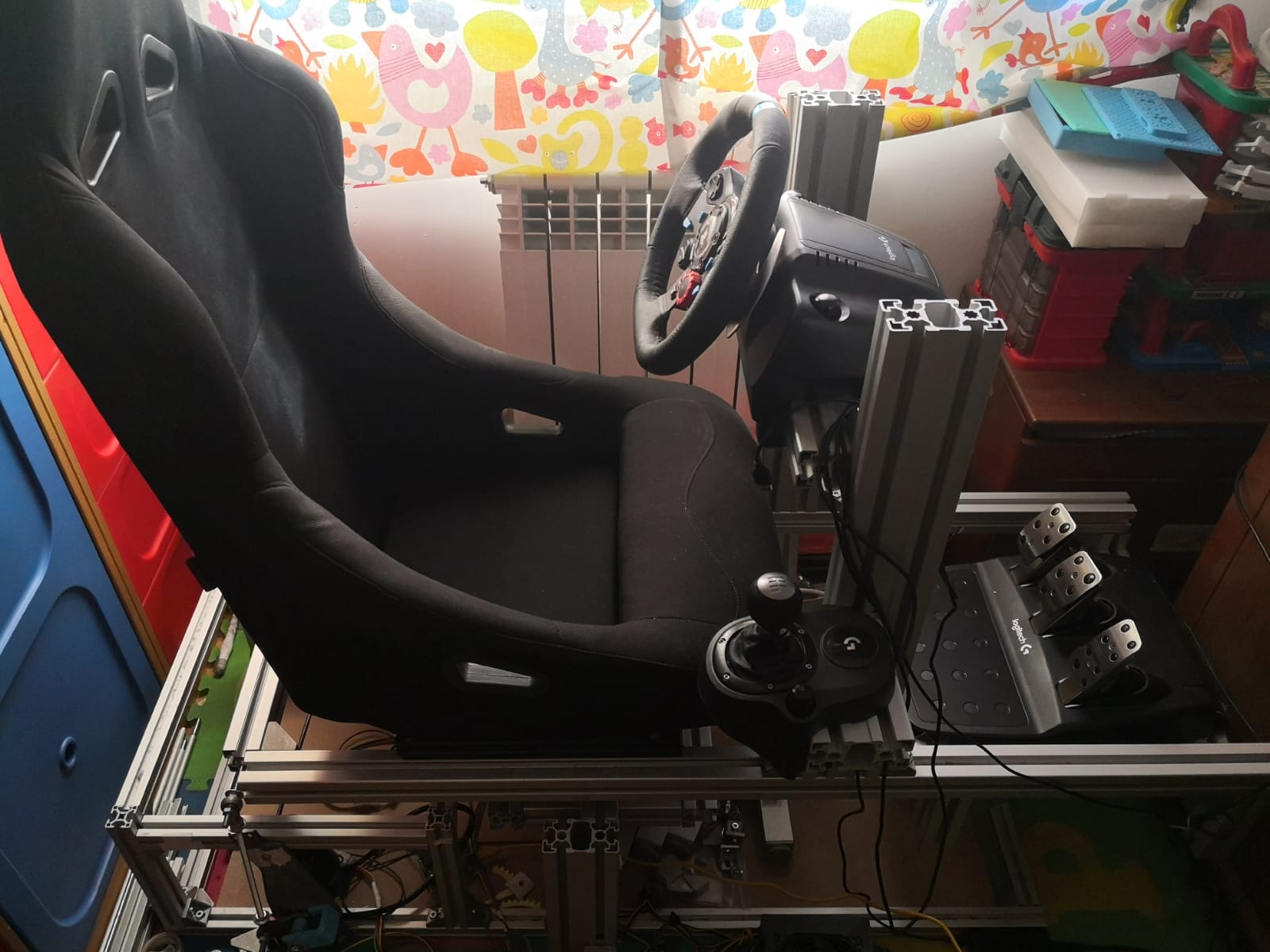

    This is my 2dof sim.
    I started to build it a few years ago, although due to time issues I couldn't make it work perfectly until now.
    This is the end result after many changes and improvements, but I'll keep upgrading it and my plans are to make it a 3dof.

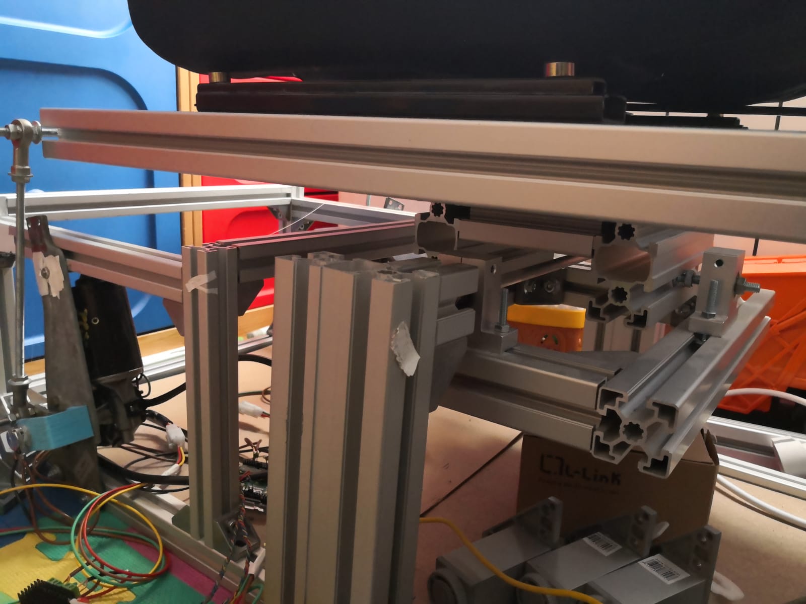

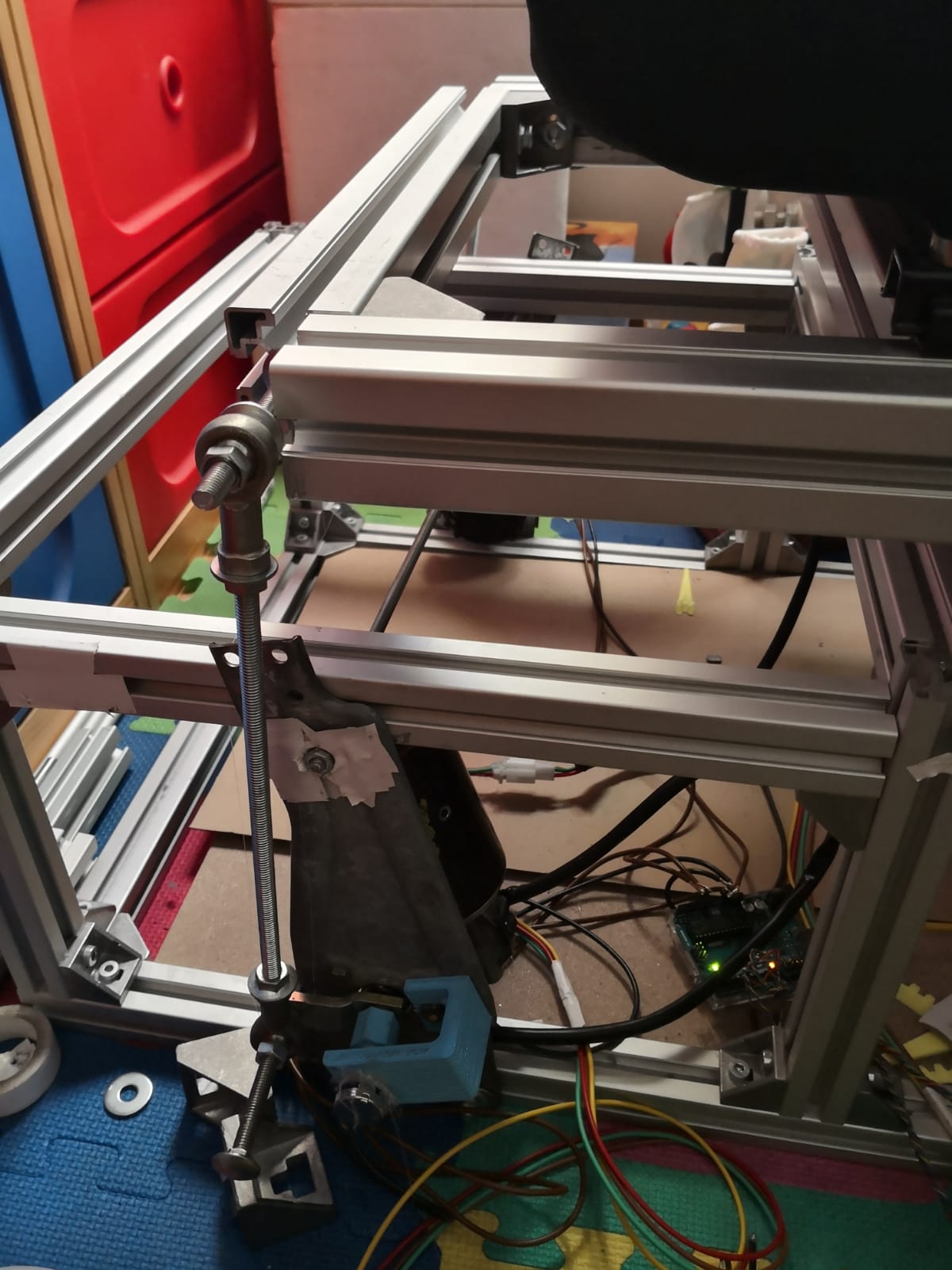

    I'll try to explain every detail and problem I encountered in further posts!

    I started my sim in 2017, and in that moment I wanted a sim that could simulate the most movements possible in a reliable way at a relatively low budget.
    So, I evaluated the possibilities I had there.

    As you can see I opted to integrate the pedals and steering wheel into the moving frame. You can separate them, but I wanted to mount my monitor in the moving frame and considered this was a better solution.
    To make this model I took into account some requirements that I set and some that were needed.
    First of all I wanted to make it fully adjustable and versatile, so I opted to build it using aluminum slot profiles.
    As I wanted to be able to change the frame dimensions everytime I needed, I made even the central axis out of aluminum profiles.
    Using this type of structure made it more expensive (only the profiles were 61.5% of the budget), but as I planned to improve the whole sim I wanted a solid base that I could modify later.

    I used 2 wiper 12V motors from a Citröen Xsara, so far they work fine and have good torque. On the hardware side I used an Arduino with 2 monster motor shields, one for each motor (I had some problems with them that I'll try to explain in a further post). Right now my limiting factor is the power supply that is from a pc and has a maximum current of 25A that turns off when the motors have to work too hard, anyway this is no problem as I can avoid it with smc3.
    My plan with the power supply is to buy another one and run these two, one for each motor. Could this work fine?

    Personally I prefer a PSU per motor, as our rigs can generate some pretty big power spikes.
    LED and server PSUs are both pretty cheap and preferable options, LED PSUs are a bit more tolerant of power spikes than server PSUs.
